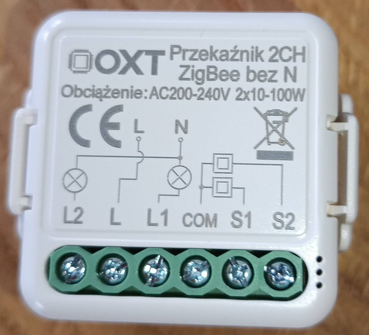

    Would the following relay be good?
    ZigBee relay OXT 2CH
    ZigBee OXT 2-channel relay without neutral wire, showing connection labels.
    TUYA 2CH ZigBee Inductive Relay without N . . . . (I gave the auction link as an example)
    Are you going to recommend something completely different for me?

    Matheu wrote:
    TUYA 2CH ZigBee Inductive Transmitter without N . . . . (I gave the link to the auction as an example)
    And maybe you can recommend me something completely different?
    Will the maximum allowable current load of the above relay be sufficient?

    Lamp I will install:
    - if LED then max 30W
    - if ordinary (i.e. traditional light bulb, i.e. resistive load) then 200W - I give a large margin.
    (the load capacity of the relay according to the manufacturer is max 2x100W LED, or max 5A )

    Matheu wrote:
    I need to control the lamp via WiFi
    You suggested a link to the ZigBee version. This will only work with a ZigBee gateway (ZigBee-Ethernet/WiFi adapter). Look for the WiFi version.

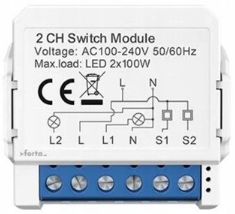

    2) The following modules (Forta) should be compatible with popular software?
    1) Forta P2N-.W WiF Forta dual-channel switch module with cable connection points. Load range: 10-100W per circuit
    Wifi standard: 2.4 GHz 802.11 b/g/n Compatible with: Tuya Smart / Smart Life / Google Home / SmartThings
    transmitters: 2 TRIAC BTA16-800 thyristors
    capacitor included: module - 2 CBB22 205J400V capacitors, total capacitance 4uF
    Module dimensions: 39 x 39 x 19 mm
    Capacitor module dimensions: 40 x 30 x 22.4 mm (can be exchanged for a smaller one)
    This module has an "N" connector, but I guess it can work with and without the Neutral wire attached:
    - When pairing with the TUYA app - the load is to be at least 10W.
    - In an installation without a neutral wire, a capacitor is to be connected in parallel to the load (capacitor is included).
    - In case of blinking light, it is recommended to replace the existing capacitor with a stronger one (e.g. 10uF)

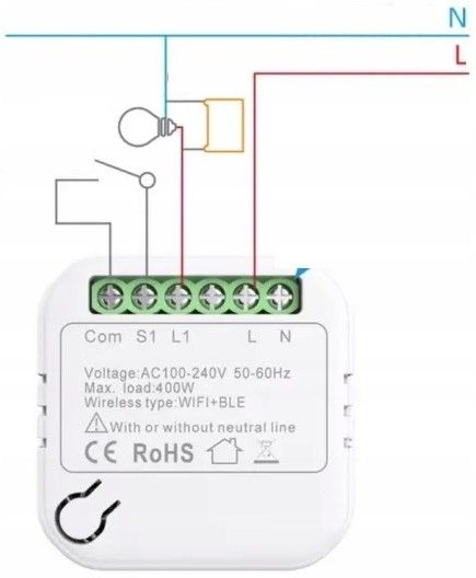

    3) Forta PBN-.W WiFi Connection diagram of the Forta PBN-W WiFi module with technical description. Power max. 400W
    Storage after power failure
    Wifi standard: 2.4 GHz (only) 802.11 b / g / n
    Compatible: Tuya Smart / Smart Life / Google Home / SmartThings
    Size: 47 x 47 x 20 mm
    In an installation without a neutral wire, connect the capacitor in parallel to the load (capacitor included).
  • WiFi module works without neutral using capacitor

    Matheu wrote:
    1) I understand that if the module has a WiFi connection it no longer needs to use an additional ZigBee gateway, right?
    You do not need a ZigBee gateway connected to the internet. You need a WiFi router with internet connection.
    In the description it has compatibility with Tuya.
    - When pairing with the TUYA application - the load is to be at least 10W.
    - In an installation without a Neutral wire, a capacitor should be connected in parallel to the load (capacitor is included).
    - If the light flickers, it is recommended to replace the existing capacitor with a stronger one (e.g. 10uF)
    According to the description, it works without "N". By default it requires current flow to have energy to operate. Therefore the pairing of the device is best done with the light (relay) switched on :-)
    You should also immediately add a capacitor at the light source if the lighting is e.g. LED type.
