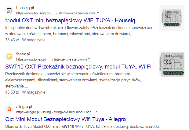

    Purchase OXT SWT10
    I got the OXT SWT10 in a package from a reader, along with other Tuya gadgets for which I had to change the firmware for him, because he is a person who does not even have a soldering iron. The product itself, in turn, is quite popular on the web and is easy to buy in our country. Around PLN 40 is not such a big price at all.

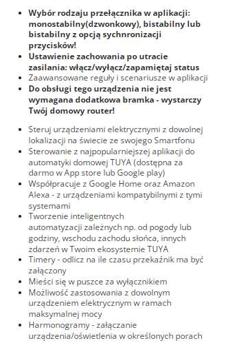

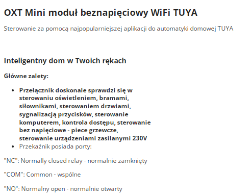

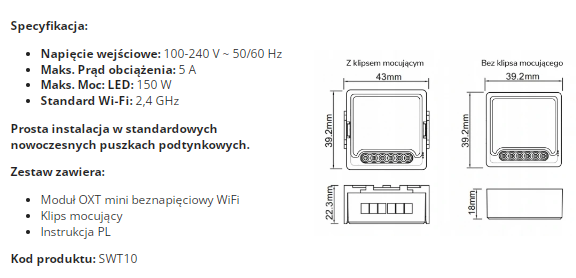

    A few screenshots from the sale offer:
    Voltage-free WiFi relay - OXT SWT10 - interior, programming
    These schedules etc. are in the Tuya application, but I have described it many times, so I will skip it today. Just parameters:

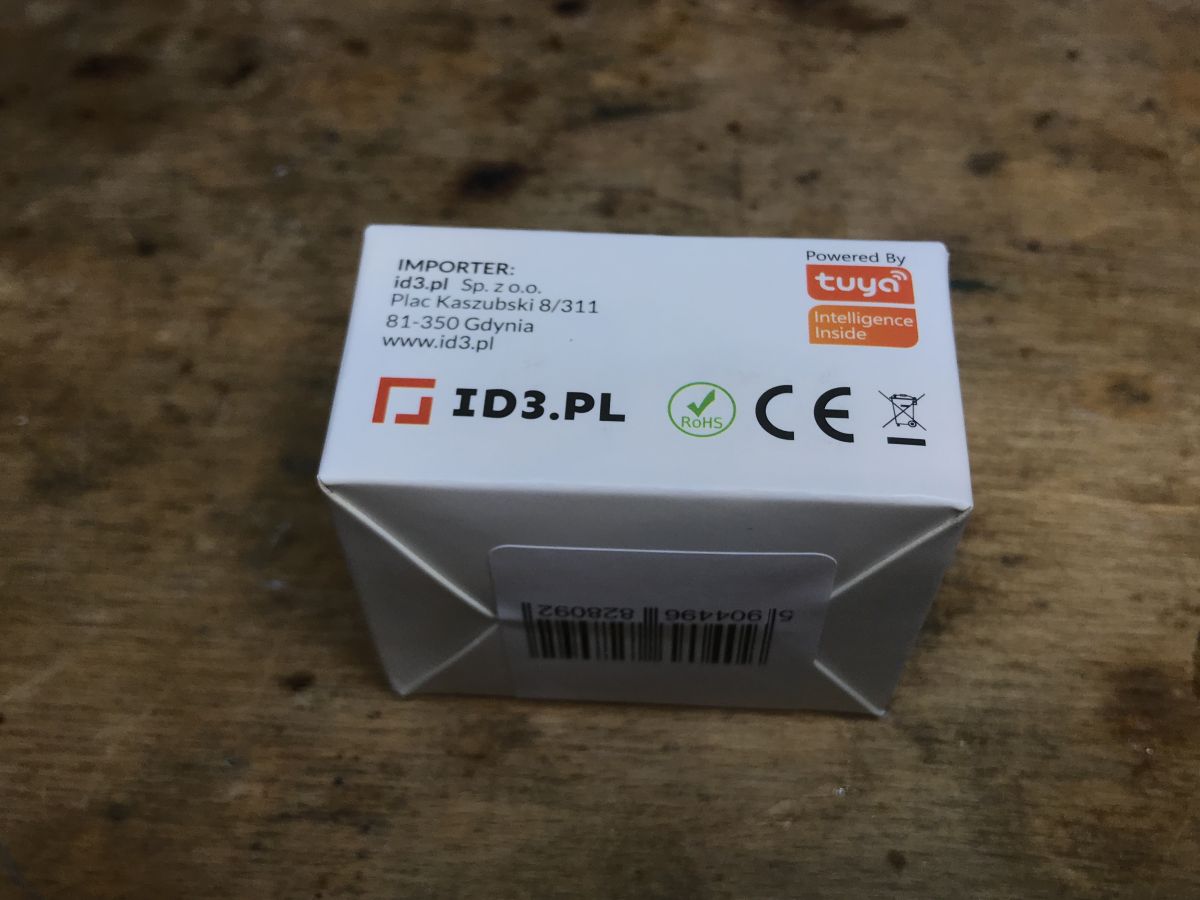

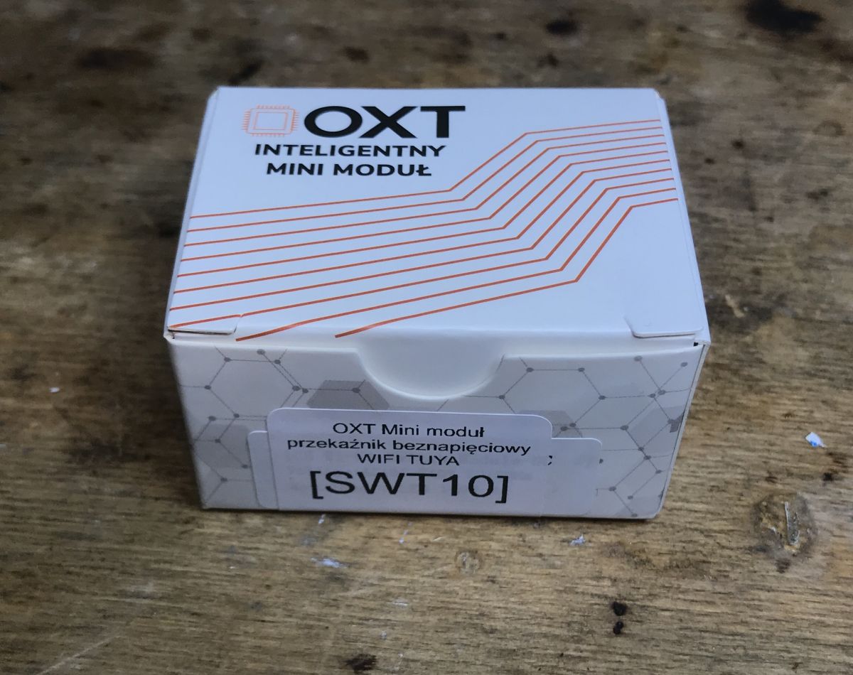

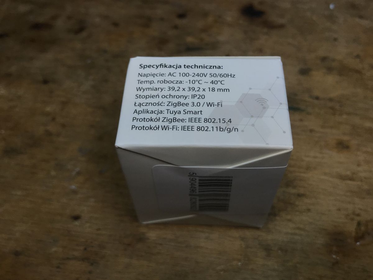

    Kit contents
    Here are some photos of the packaging (with markings) and the contents of the set:
    Voltage-free WiFi relay - OXT SWT10 - interior, programming Voltage-free WiFi relay - OXT SWT10 - interior, programming Voltage-free WiFi relay - OXT SWT10 - interior, programming Voltage-free WiFi relay - OXT SWT10 - interior, programming
    This time quite poor. They didn't even provide screws and double-sided tape.

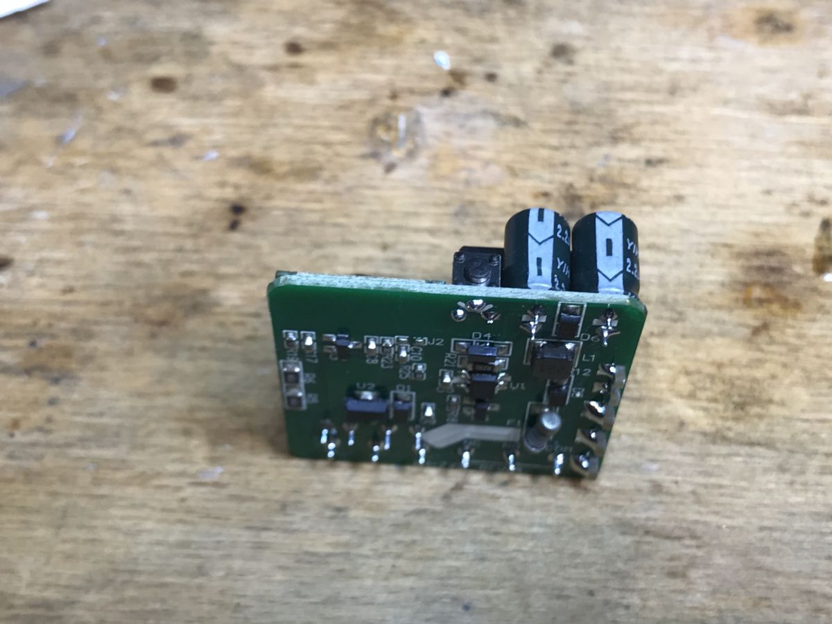

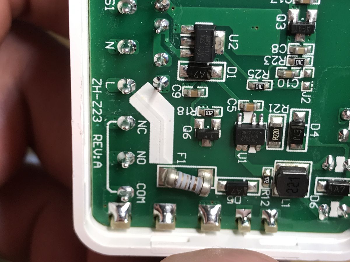

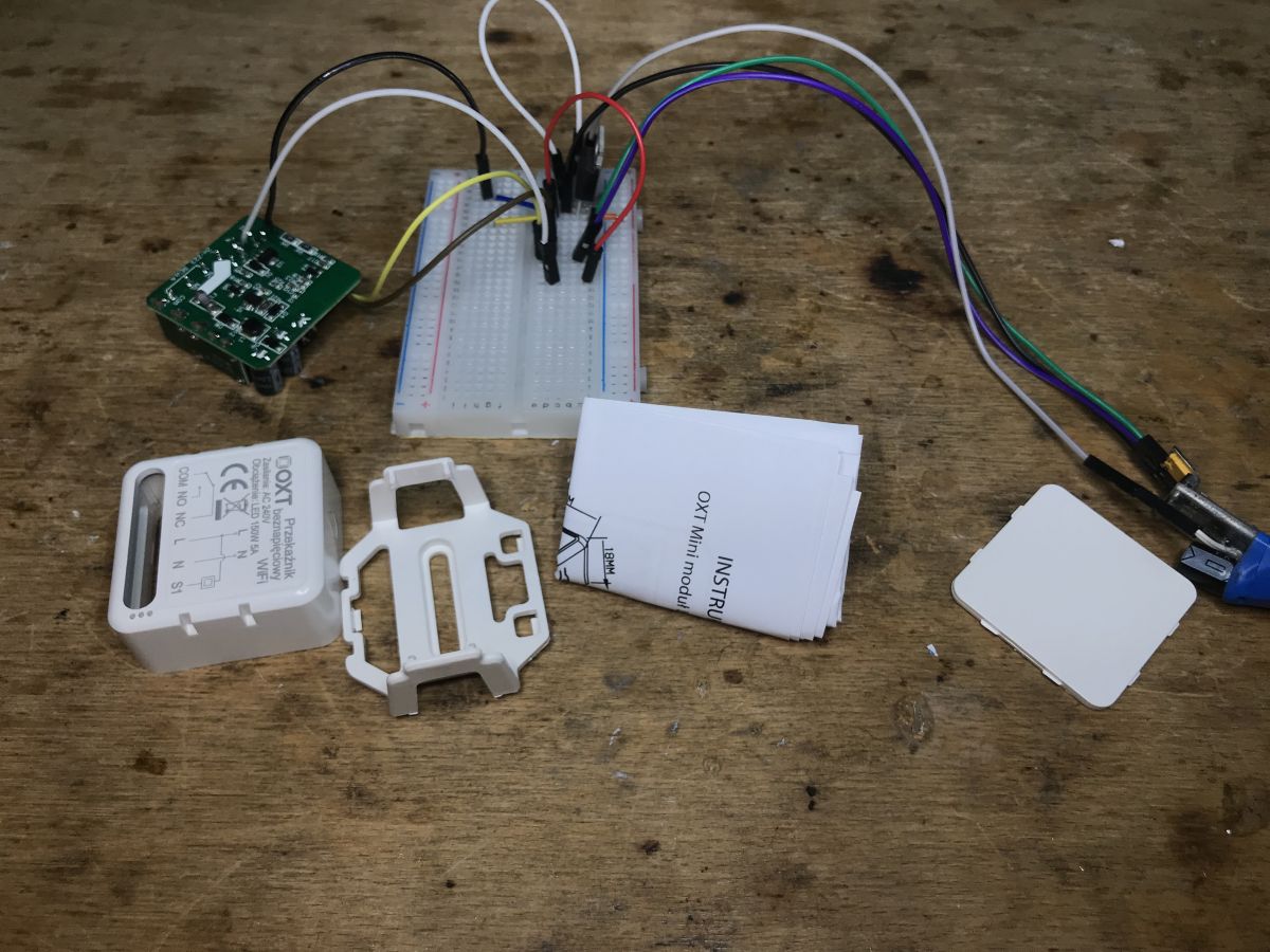

    OXT SWT10 interior
    It's time to look inside and upload OpenBeken to free this product from the cloud.

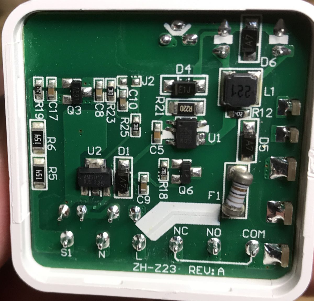

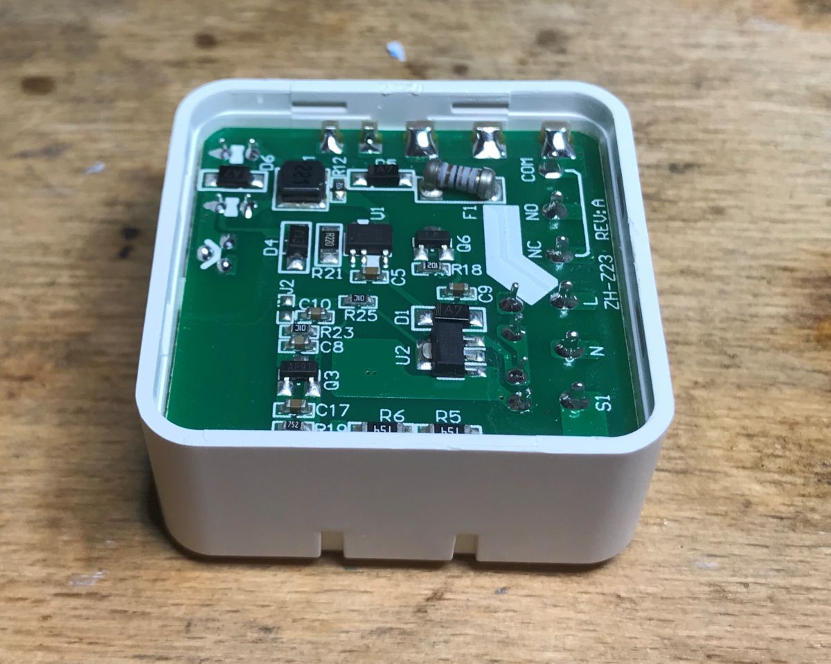

    We start by prying the cover:

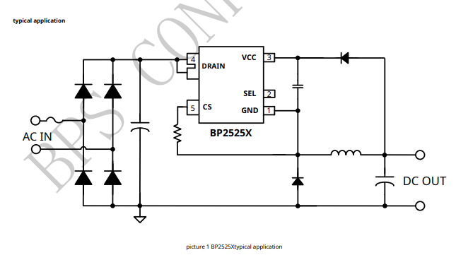

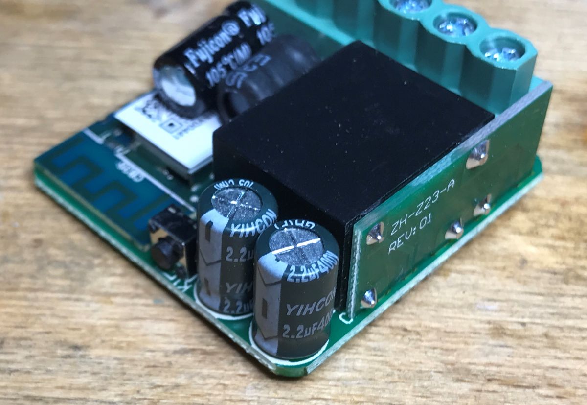

    Inside there is a standard power supply for BP2525 and AMS1117-3.3V that gives a stable power supply for the WiFI module.

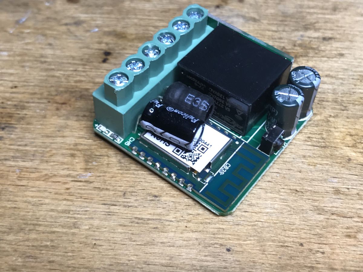

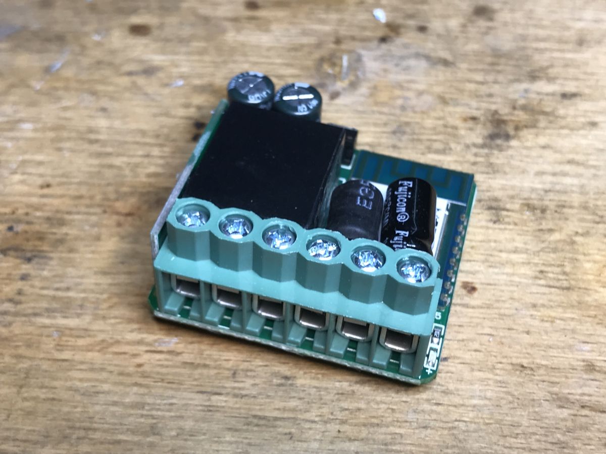

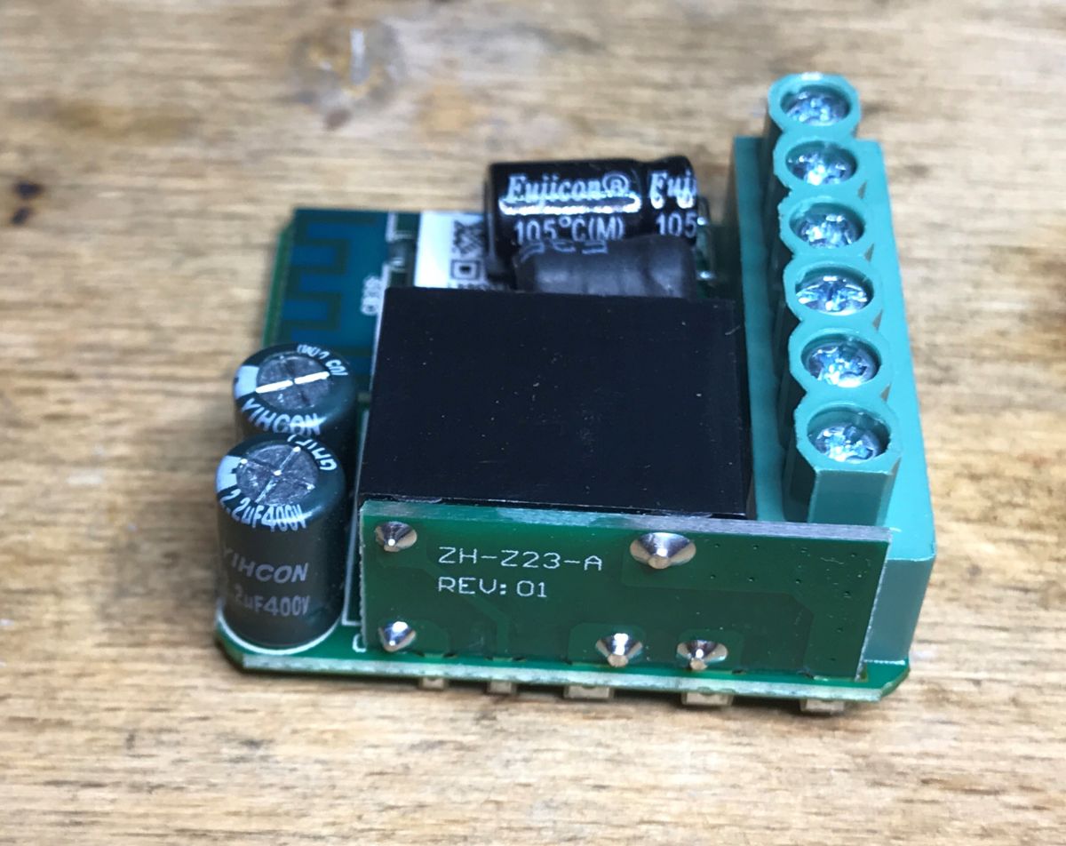

    The relay is mounted quite interestingly, because on an additional small PCB:

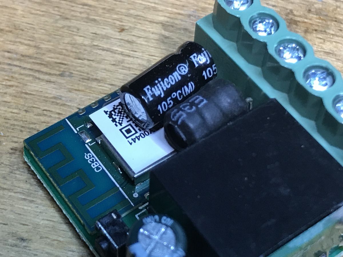

    The product is based on the CB3S WiFi module. This time, however, not CB2S. It's probably because the CB2S would be too tall for this case.

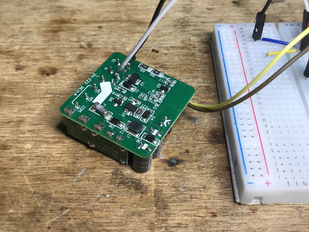

    Wgrywanie OpenBeken
    Programujemy moim BK7231 GUI flasherem:

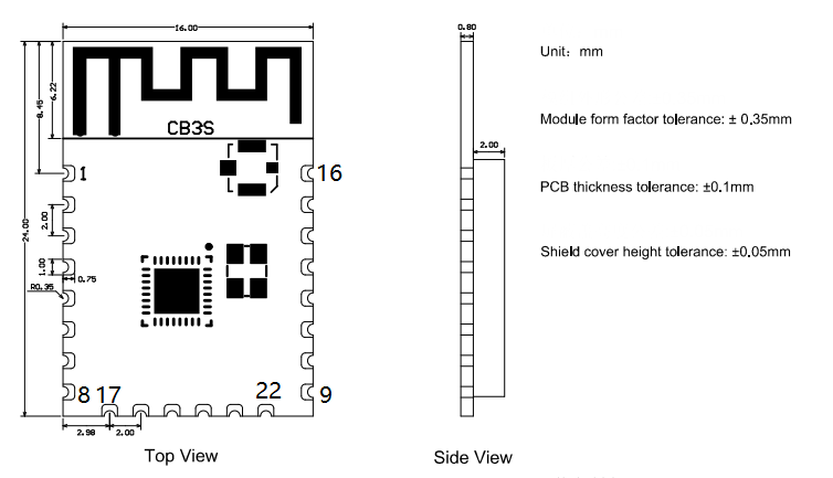

    Dokumentacja CB3S szybko nam powie, gdzie są interesujące nas sygnały.
    Pin number Symbol I/O type Function
    8 VCC P Power supply pin (3.3V)
    9 GND P Power supply reference ground
    15 RXD1 I/O UART1_RXD (user serial interface), which corresponds to P10 of the IC. Do not connect it to the VCC. By default, the MCU serial port should be in low-level or high-impedance state.
    16 TXD1 I/O UART1_TXD (user serial interface), which corresponds to P11 of the IC. Do not connect it to the VCC. By default, the MCU serial port should be in low-level or high-impedance state.
    In this particular case, no external LDO regulator is needed because the AMS1117-3.3V is on board. You can solder in front of him.
    I did not solder the CEN either, I did the RESET by cutting off the power supply (5V) for a moment. Programming went smoothly.
