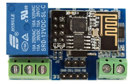

    Is the NO/NC connector of a wifi relay for example such:
    Control of 12V voltage via NO/NC connector of WiFi relay in SmartHome system .
    It is possible to supply 12 volts and then this connector can be used to voltage control other devices, or can such a connector only be a voltage free connector?
    Thanks in advance for your help, as I would like to use this relay to control a 12 V air freshener in a SmartHome system.

    The relay has a contact current capacity of 10 A at 250 V AC. Consequently, it can make a contact of some device, or switch the power supply on and off. ;) This is probably what the author had in mind?

    You can apply 12 V to the contacts to control the switching on or off of, for example, a light bulb.
    The current capacity of the contacts when supplied with DC is 10A at 30V.

    It depends whether it's a voltage-free contact or a voltage contact.
    What does it look like?
    What kind of kit is it?

    Since it has 3 terminals inserted, these are definitely voltage-free contacts
