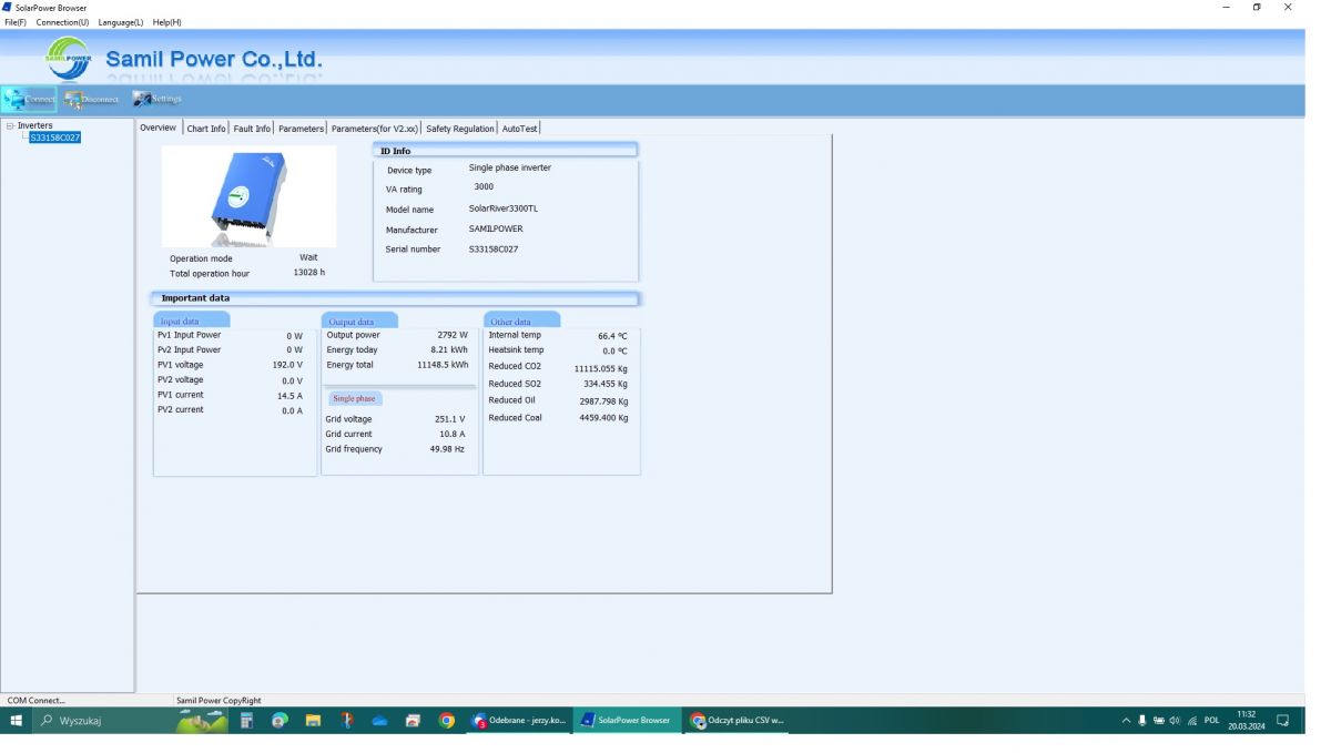

    Tests completed successfully.
    ESP NOW has been working for 2 days with no problems.
    Here are the results of the USB <-> ESP32ESP32 <-> RS232 bi-directional connection.
    Screenshot of Samil Power Co., Ltd. software displaying inverter data. .

    Well, that's great. What baudrate is it running at?
  • #16 21013246
    globalinfo
    Posts: 430
    Rate: 30
    I set 9600 - the same as the inverter sends.
