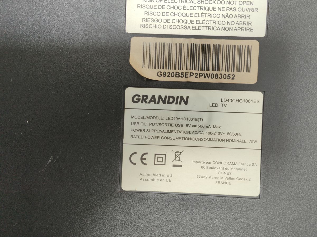

    Bom dia.
    Tenho uma TV grandin LD40CHG1061ES e aparece iniciação em curso e não passa daí.
    Alguém me pode ajudar por favor? Identification label of a Grandin LD40CHG1061ES TV with technical details.

    Attached is the requested software.
    If the software does not start, change SIS506_62.bin to SIS506_SOS.bin
    • CH_XA9B_FR_V20.0062_40D1060_C400F14-E8-C(G2).rar (3.11 MB) You must be logged in to download this attachment.

    Coloque os 2 ficheiros numa pen, introduza no lcd e depois ligue este à corrente, se o lcd ficar em stand by pressione a tecla para sair de stand by

    Sim a pen tem que ser FAT32.
    Tem que alterar o ficheiro SIS506_62.bin para SIS506_SOS.bin

    rename the file SIS506_62.bin to SIS506_sos.bin
    and copy only this file on an empty usb stick fat32 formatted
    (the file SIS506_62_MD5.txt isn't necessary)
    insert the usb stick in the tv, then plug the power cord
    look at the standby led, at the beginning it flashes slowly, after about 1 minute it doubles the speed, update completed
    unplug the power cord, and then the usb stick
    reconnect the power cord and turn on the tv: it starts in first installation mode
    if it doesn't work with usb recovery, you have to replace the spiflash with a new one and program it with the file SIS506_sos.bin

    Atualizacao de software e problema resolvido
