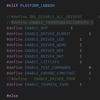

    Zain00 wrote:
    Does Device Groups work with this chip ?
    If this is the right place (obk_config.h) then no, device groups is not currently enabled
    Configuration code snippet with various macros in C language.

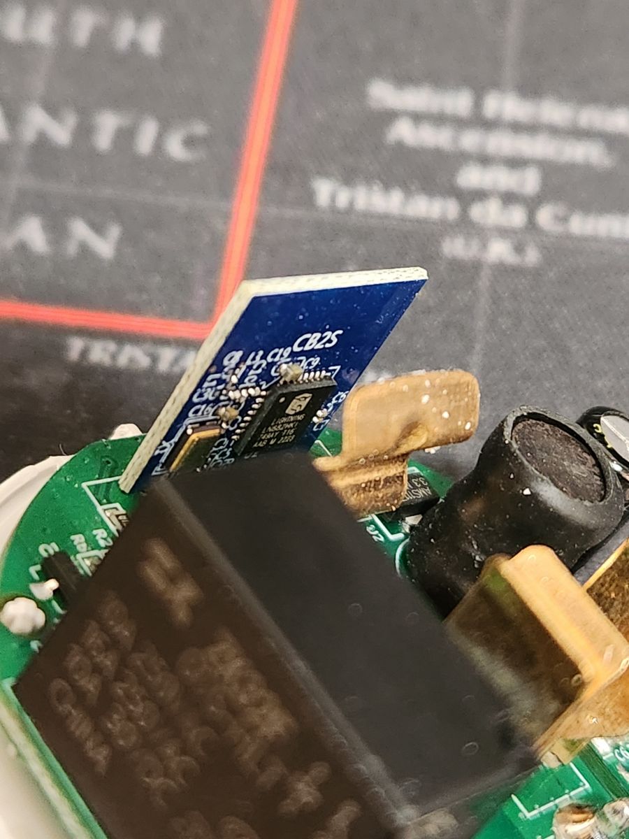

    Also, it seems in my device it's written CB2S but with LN882H.
    Electronic module on a circuit board labeled CB2S and LN882H.

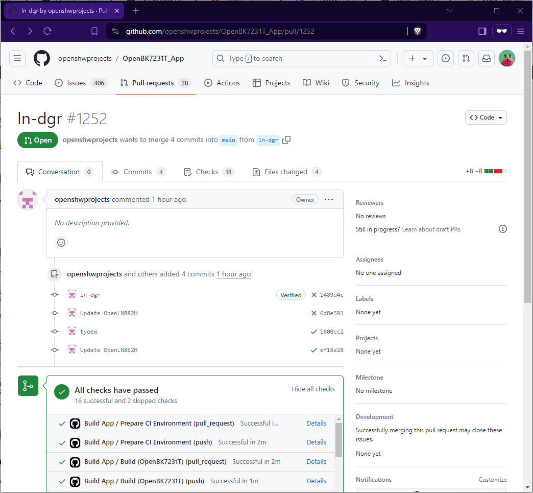

    Ok can you check if it works?
    https://github.com/openshwprojects/OpenBK7231T_App/pull/1252
    @divadiow @max4elektroda who has more than 1 relay device to check?
    I've not seen this before.
    can do. will need to learn about device groups first! can do this evening
    Added after 19 [minutes]:
    >>21098247
    no. builds created off the back of a pull request can be downloaded and flashed
    Screenshot of a GitHub pull request page in the openshwprojects repository.

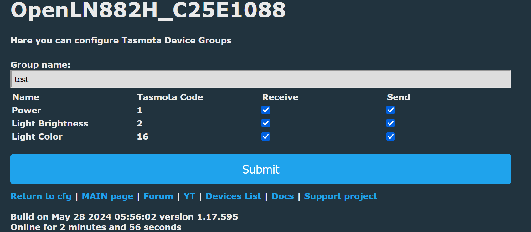

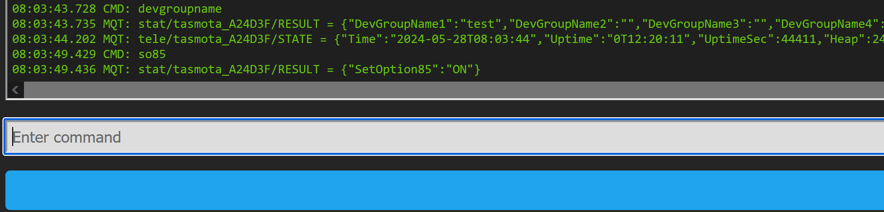

    I just tried it and it doesn't work.
    OpenLN882H settings :
    Tasmota device group settings screen with group name test and checked receive and send options.
    Tasmota Settings:
    Tasmota interface screen with command input field and system logs.

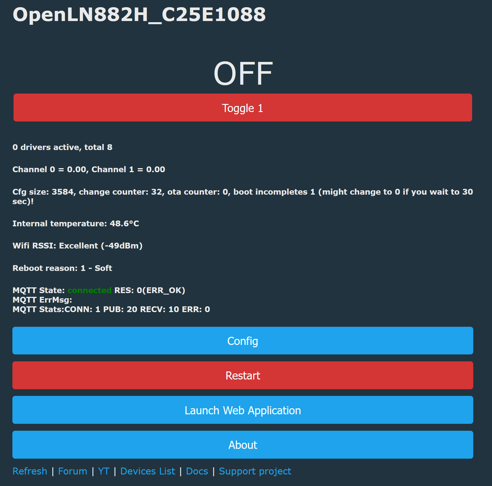

    Oh, I did the update again.
    Configuration of Tasmota device groups on the interface screen.
    But with it didn't work.
    And I see no DGR driver active
    OpenLN882H_C25E1088 controller screen showing an off state and various technical parameters.

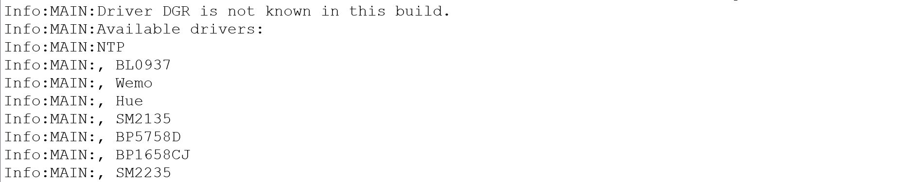

  • #12 21098301
    Zain00
    Posts: 61
    Rate: 20
    I did try (backlog startDriver DGR) it says OK but doesn't start
    Error message indicating an unknown DGR driver and available drivers.
  • #13 21098308
    Posts: 14743
    Rate: 12839
    We need to add correct defines for array for DDP/SSDP/DGR entries...
    Ok, try the build now.

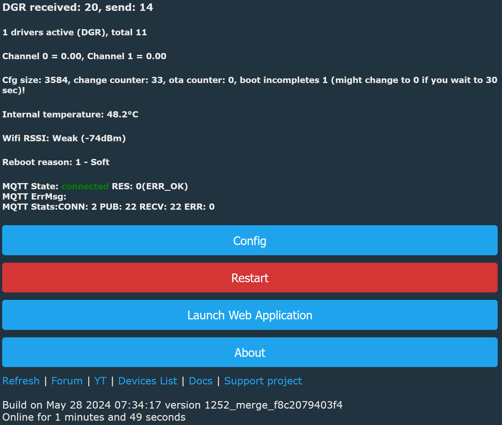

    Thank you. It's working now with the new update
    Can we enable Tasmota Device Groups for LN882H OpenBeken port?
  • #15 21098316
    Posts: 14743
    Rate: 12839
    Are the packets correctly received and sent as well?
  • #16 21098324
    Zain00
    Posts: 61
    Rate: 20
    It seems to be working correctly, I'll update you when it misbehaves
