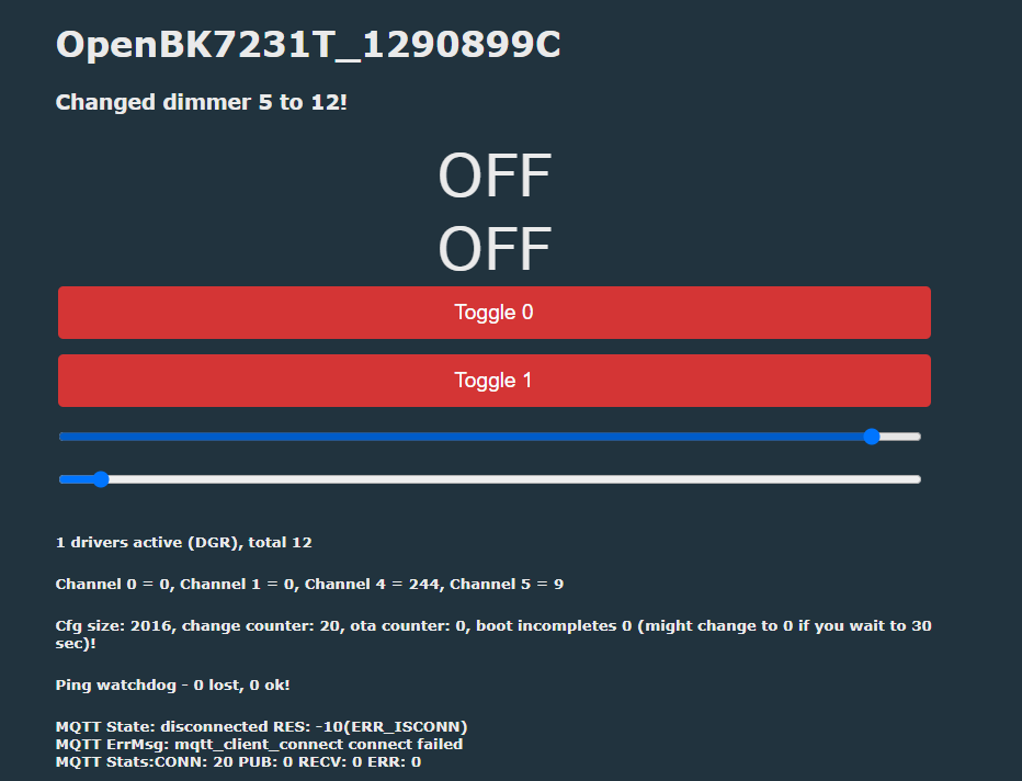

    SetChannelType 4 Dimmer256 will make the bar appear:
    Tasmota Device Groups - connection of OpenBeken (BK7231T / BK7231N) with Tasmota
    The OnChannelChange event, on the other hand, will cause each change of channel 4 to send its new value to the DGR. Also one with GUI. So we can control all LEDs with one web panel.
    NOTE: If we send a new channel 4 value via MQTT, it will also be transferred to DGR.

    setChannelType 5 dimmer256
    addRepeatingEvent 1 -1 addChannel 5 -1 0 10000
    addChangeHandler Channel5 == 0 setChannel 4 0
    We add this to the previous configuration.
    From now on, the second bar is the time in seconds - you can also change it to minutes (we change addRepeatingEvent 1 to 60 - an event every 60 seconds instead of one) - after this time the lights turn off.
    It is a bit lacking to sign what's what - it will be added soon.

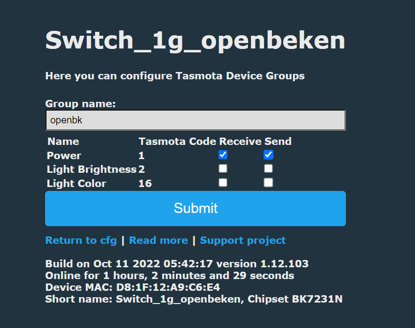

    Hi, thanks for the detailed write up
    I'm testing it again with switches only this time -> 1 gang N device and 3 gang Tasmota device but still not working for me
    Group name : openbk
    On the 3 gang switch I've enabled all this and additional setoption88 (to tie only relay 1 to 'openbk' group)
    The relay is pin 8
    Another question, does device group still work for openbk devices only without tasmota devices?

    Hey @ferbulous , first of all, I do not understand your config now - are you trying to use DevGroupTie, which is not supported yet, or just a simple Devices Group?
    Are you able to check if OpenBeken sees any packets in the log?
    Here, anything?
    What happens if you do (to set relay 1 to 1 of device with 1 relays):
    DGR_SendPower openbk 1 1
    or (to set relay 1 to 1 of device with 3 relays, remaining relays to 0):
    DGR_SendPower openbk 1 3
    Is Tasmota reacting to this packet?
    The DGR should work between OBKs.

    Hi,did some more testing on a new N device (downlight led) that I just received.
    Device Group Enabled:
    If I enable device group on openbk, toggling relay from tasmota -> openbk works. But not from openbk -> tasmota.
    But with device group enabled, if I publish any mqtt payload (toggle, change colors) the device stopped responding,web ui inaccessible
    Device Group Disabled:
    Publish any mqtt payload (toggle, change colors) just works.
    Also, I'm not quite sure why autodiscovery isn't working this time, I can see openbk device listed when I'm using mqtt-explorer.
    I've also tried adding openbk on fresh new HA installation but it's still the same.
