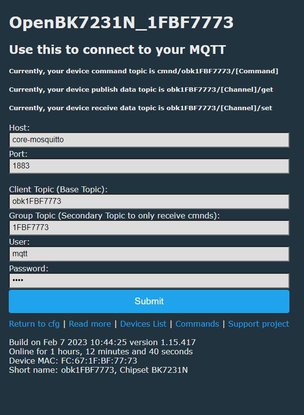

    hello, I have configured the pins the relay is working, my problem is that the homeassistant does not see the device, maybe I have not configured everything
  • #4 20430264
    Posts: 14728
    Rate: 12814
    Well, maybe first check if your password and username are correct. Then maybe try using IP instead of core-mosquitto (so enter 192.168.0.100 or anything like that)

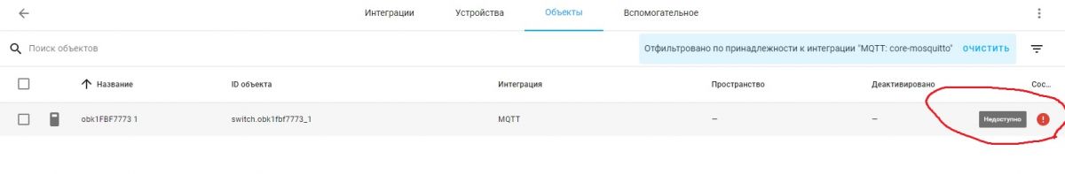

    thank you friend! now my HA sees the device, there are 7 objects, but among them I do not see the network status, the ability to turn on and off the LEDs on the device
  • #8 20430387
    Posts: 14728
    Rate: 12814
    What is your pins configuration of the device?
    I am not sure if we have network status (RSSI) in Discovery, but we can add it if you want

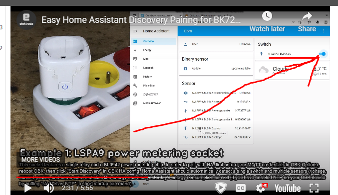

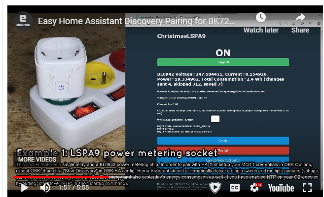

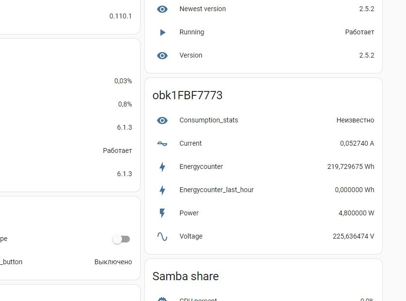

    Power state - are you 100% sure? We just tested it on video, look:
    Home Assistant Not Detecting OpenBeken Device: Manual Setup & Pin Configuration Guide
    So you don't get that on HA?
    Remember that you must first configure pins/device, then do HA discovery.

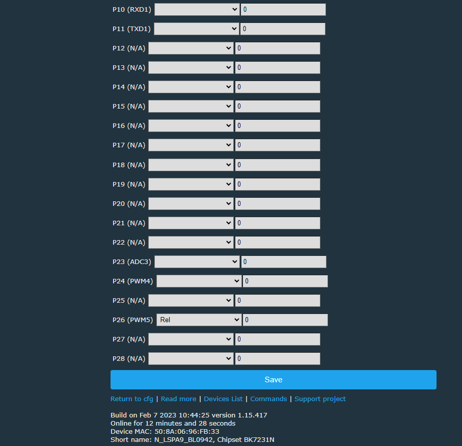

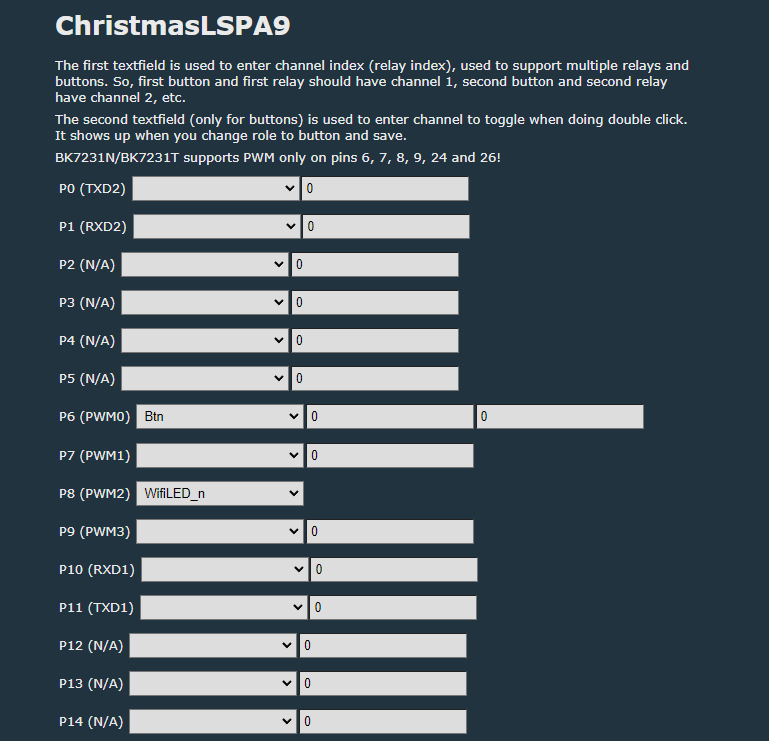

    Leds are configurable by user. Usually, one LED is for power state (relay state) and second for WiFi state. Do you have them configured? What is your pins configuration/template? What is not working?
    Pin roles are different between devices and not all devices have two leds. There are also devices with single LED, etc.
    Example, here is part of my config:
    Home Assistant Not Detecting OpenBeken Device: Manual Setup & Pin Configuration Guide Home Assistant Not Detecting OpenBeken Device: Manual Setup & Pin Configuration Guide
    I have only WiFi LED. The power led is connected to relay electrically.

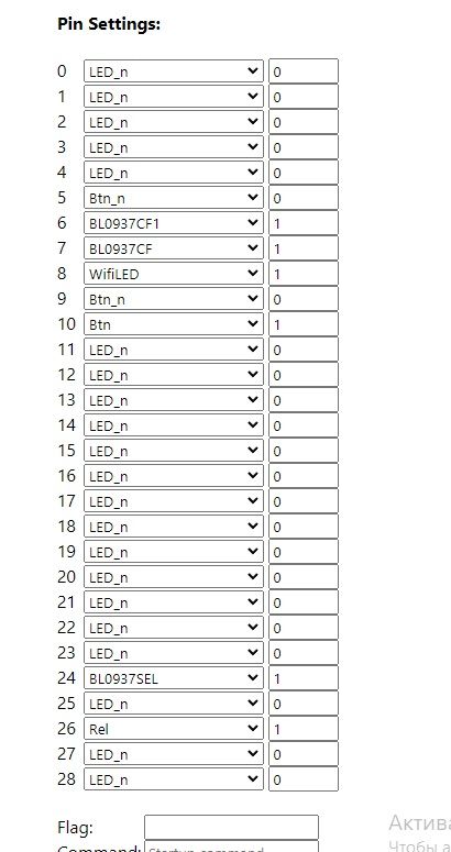

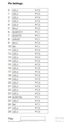

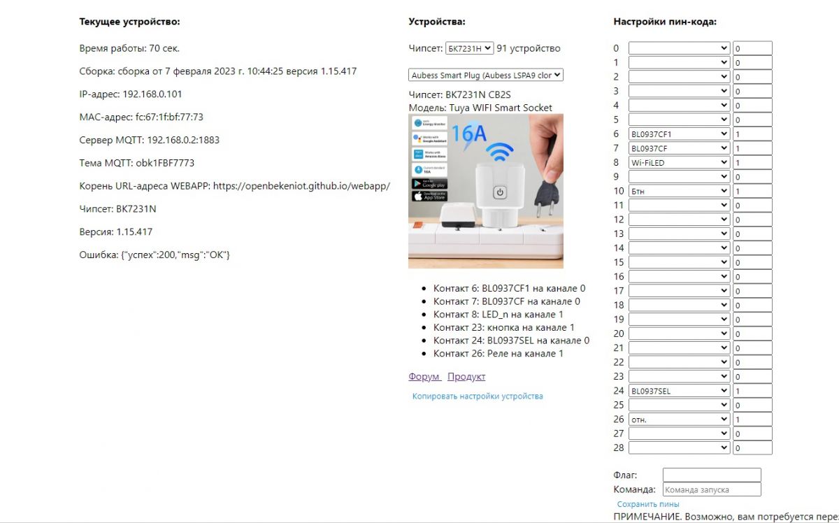

    network status, blue LED found, red not yet. ((, the ON switch did not display only sensors
    socket as in the photo pins in the table
  • #14 20430519
    Posts: 14728
    Rate: 12814
    Well, you have two options:
    1. open device case and check with multimeter where red LED is connected
    2. check in configuration each pin one by one (you can, for the time of testing, set LED channel to 2 and manually toggle channel 2 from www panel and check if it blinks, if not, set LED to another pin, etc, etc, try several times)

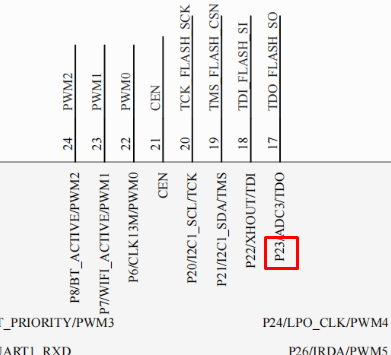

    The blue LED is connected to output #24 PWM2, the red one is connected to pin #17 TD0 flash SO

    № 24 PWM2 --- 8
    № 17 TD0 flash SO ------ ??
    What's the number? and why does it glow like a pwm?
    #20 20430806
    Posts: 14728
    Rate: 12814
    BK7231 datasheet, pinout, programming, specification, wiki (BK7231T, BK7231N)
    TDO is P23, if that's what you mean.
    What kind of WiFi module you got there? CB2S? WB2S?
  • #21 20431887
    pogadaevalecsey
    Posts: 32
    thanks! figured it out! pin 23 inversion. but the LED lights up very dimly, almost invisible. what can influence?
