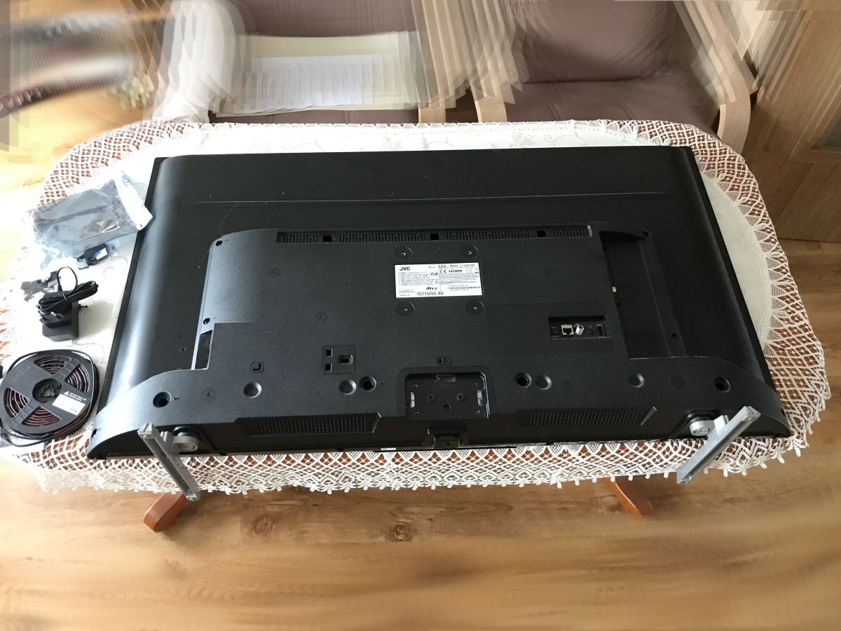

    First you need to lay the TV safely on the screen - this must necessarily be on a flat surface, otherwise you risk damaging the matrix.
    TV lying screen-down prepared for Govee LED strip installation

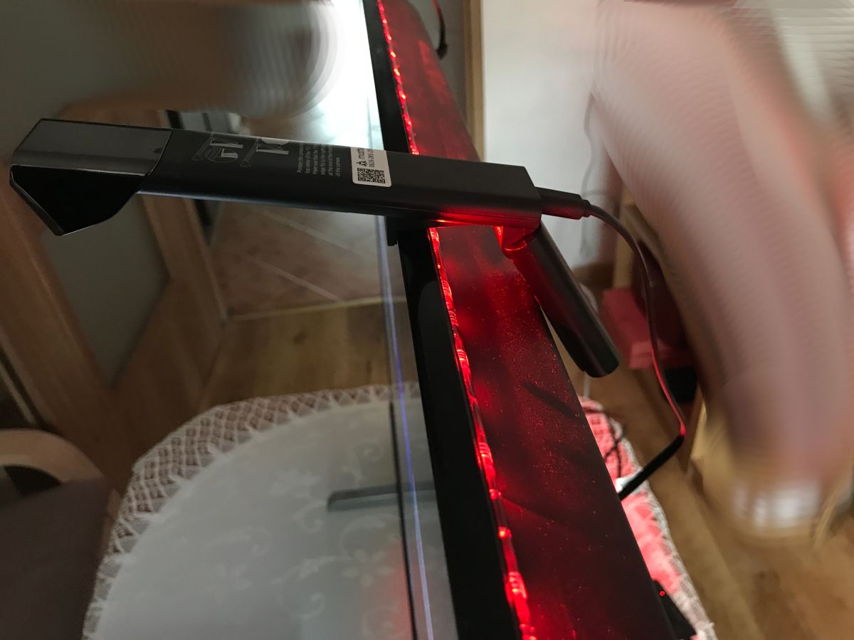

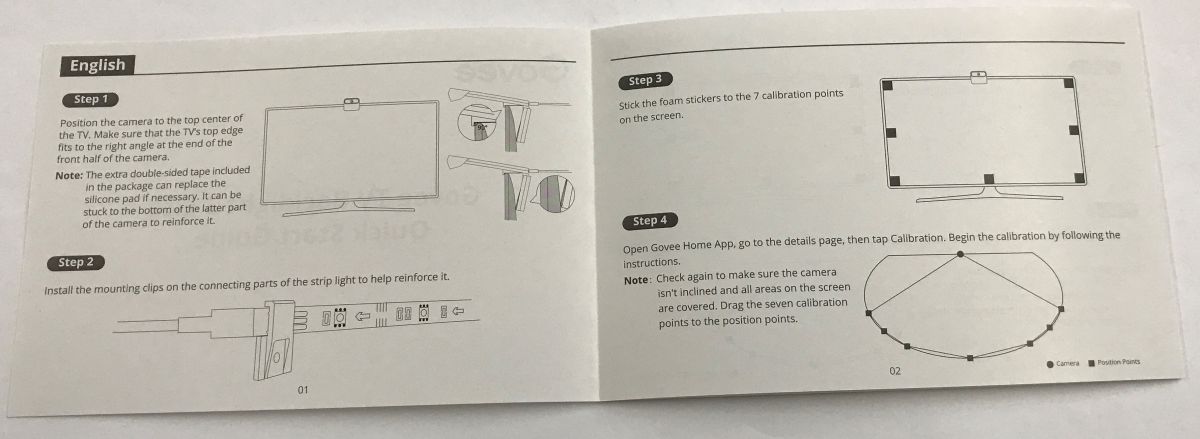

    The camera must be mounted so that its foot holds a right angle to the TV screen:
    Camera mounted on top of a TV and red LED strip on the back panel.

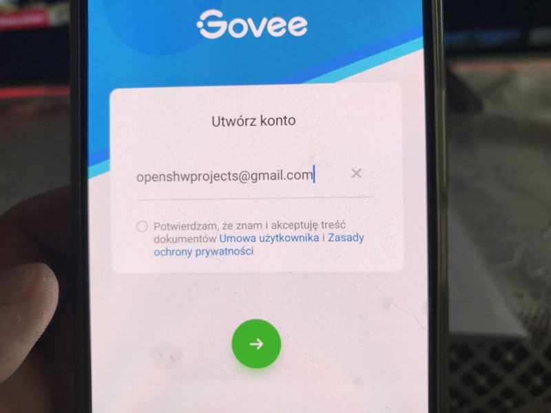

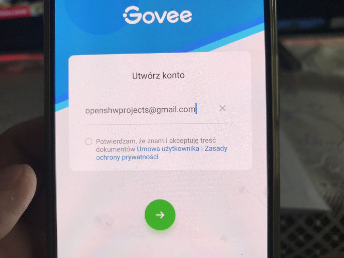

    You then need to set up an account, but this is not a problem - you just need to have an email address, no phone number. I tried to pair the device without an account, but although the hardware was detected, the pairing would not go any further.
    Account registration screen in Govee app on smartphone with email entered

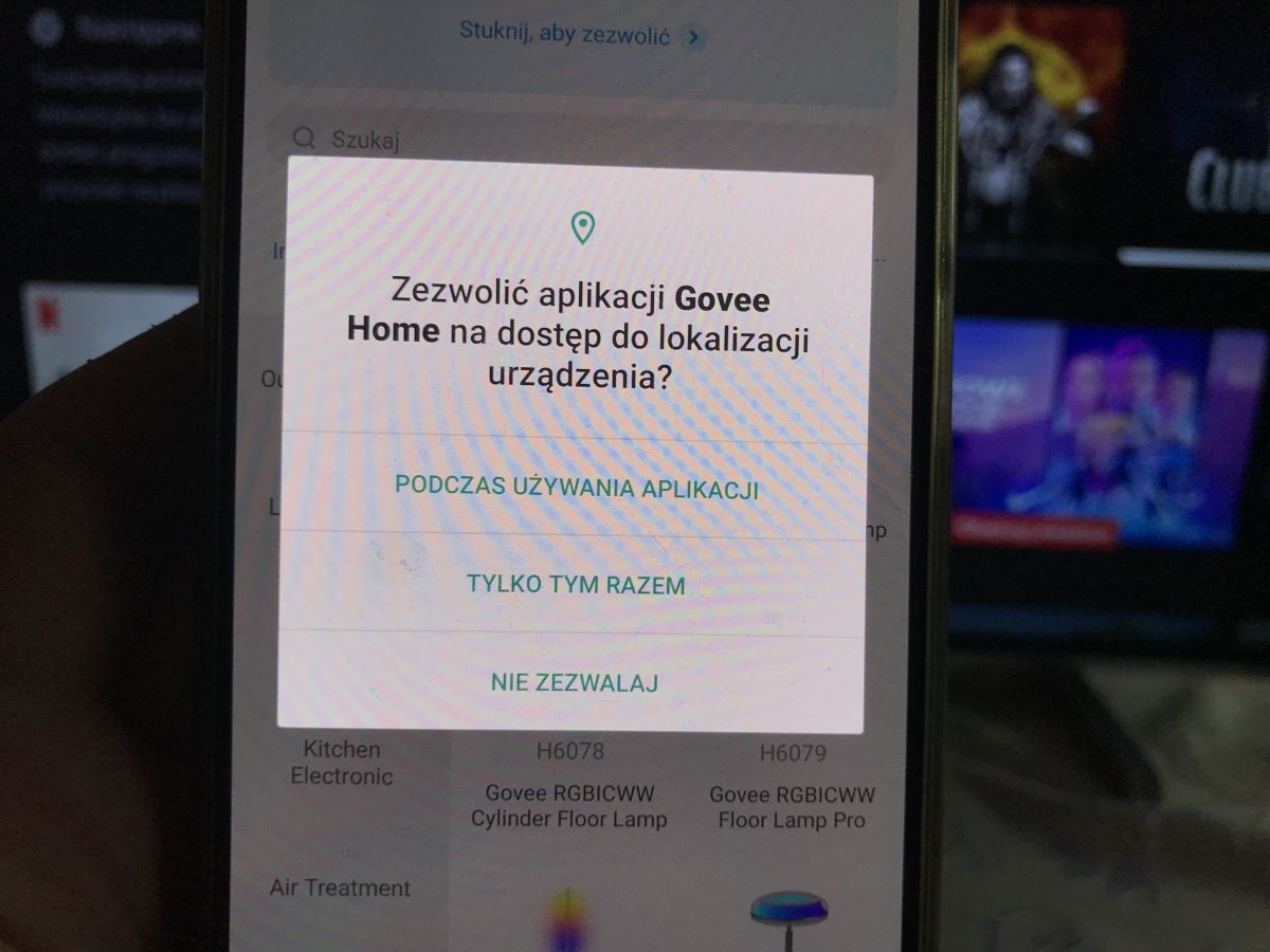

    We enable Bluetooth, WiFi. We allow the application to access.
    Govee Home app prompt asking for device location access on smartphone screen

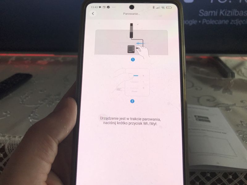

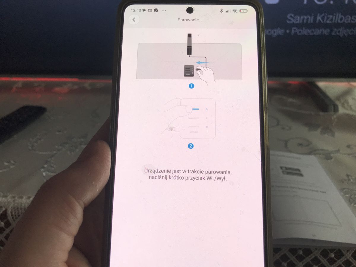

    The whole pairing process is an afterthought - you have to confirm it by pressing a physical button on the device, so your neighbour can't 'pick up' our equipment.
    Govee app pairing screen on smartphone with button press instruction

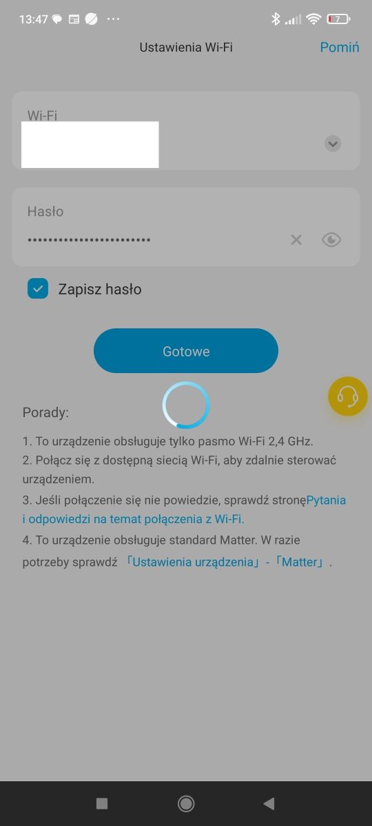

    You will also need to enter the name and password of our WiFi - the 2.4 GHz standard is supported.
    App screen showing Wi-Fi setup for Govee device, password field filled in

    I mentioned at the beginning that the orientation (order of overlap) of the bar doesn't matter - oh well, here's an explanation of how it works. The app highlights two segments and we choose which edges of the screen they are mounted on:
    App screen with LED strip orientation options for TV setup

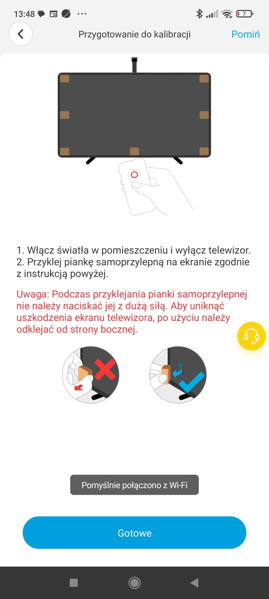

    The second part of the calibration is to stick the orange calibration blocks on the screen. We proceed gently, without pressing. The TV must be switched off, while the light in the room must be on so that the camera can recognise these blocks.
    Govee app screen with LED calibration instructions and foam placement diagram
    I was sure it would be a bit of fun with this - but nothing could be further from the truth!
    Govee calibration screen showing camera view with corner points on TV screen. Govee app screen showing calibration points placement instructions for TV lighting
    Calibration is very simple. Simply adjust (drag) the virtual points to those set on the screen. In practice, there isn't even much of this adjustment - with me, the default setting almost perfectly matched already. In addition, we have a preview of the camera view, which makes everything even easier.

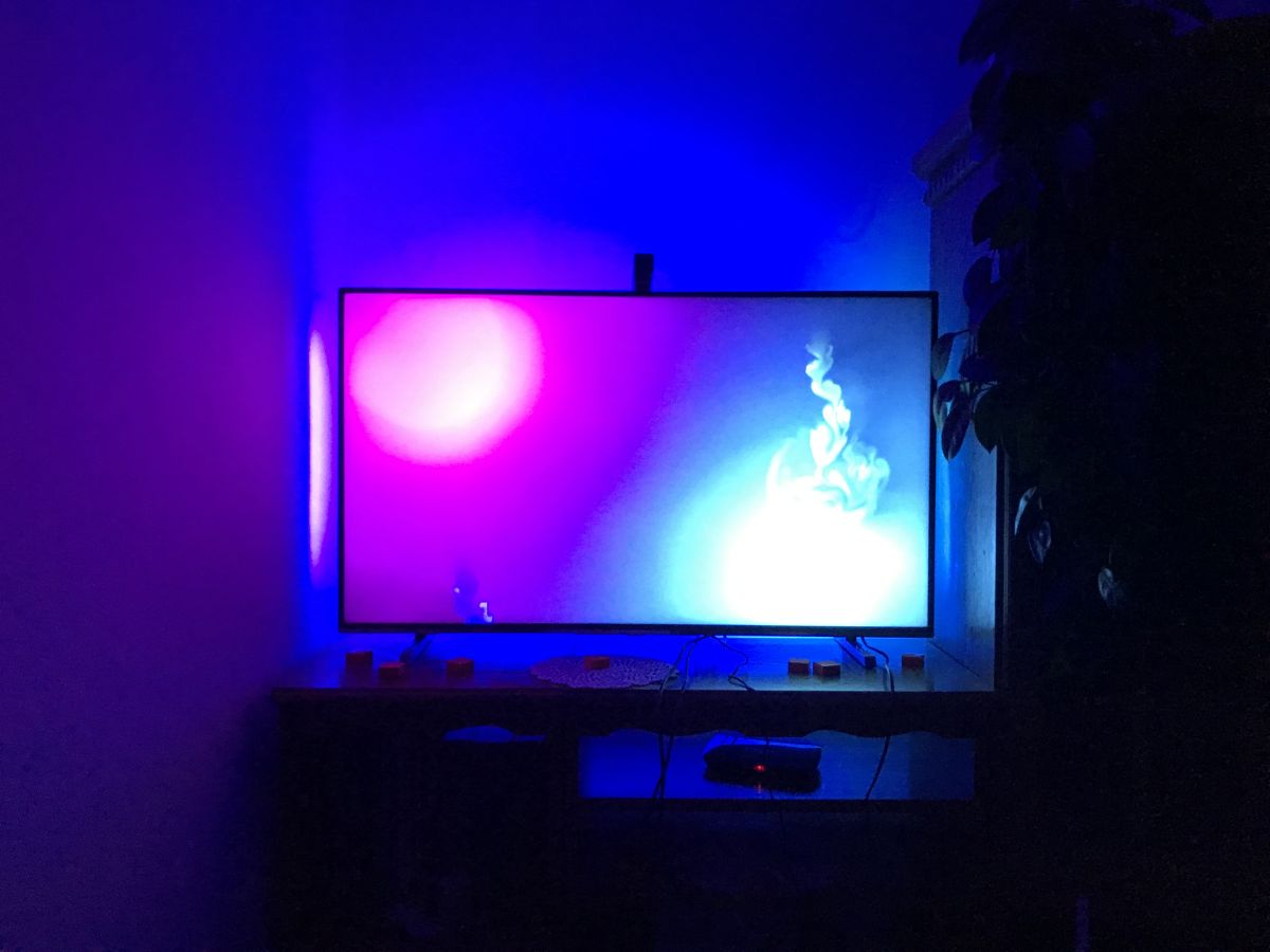

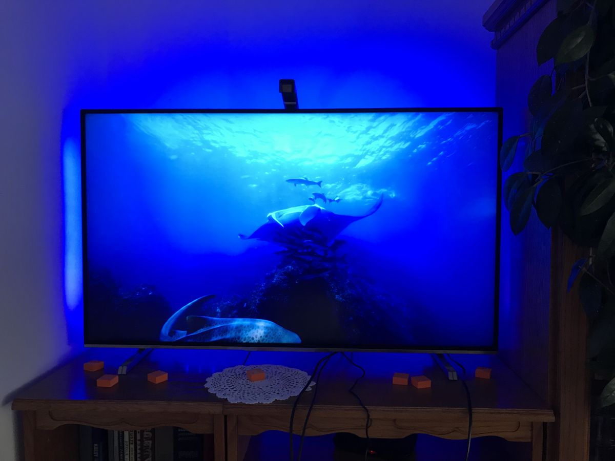

    To start with something simple - the colour test. Just search on Youtube for a suitable video. This is also useful for colour calibration - more on that later.
    Now for something better - the animation of the 'fireflies', you can very well see how the bar instantly reacts and adjusts its colours to what is happening on the screen:
    Now a longer test - more colours:
    Tests with sample video:
    TV screen with Govee LED backlight and calibration camera on top TV with active LED backlight and orange calibration blocks on the surface TV with active LED backlight and orange calibration blocks on the surface TV with blue LED backlight and a calibration camera mounted on top

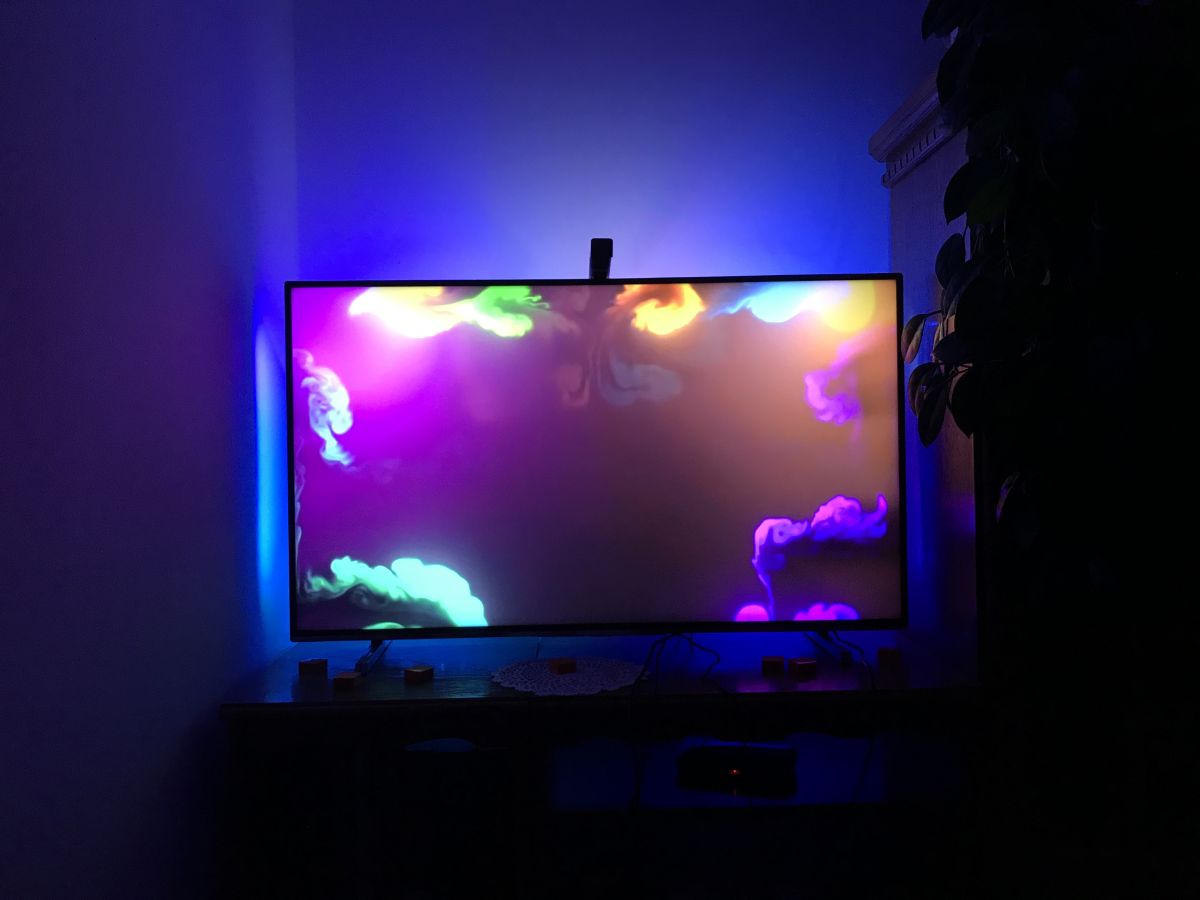

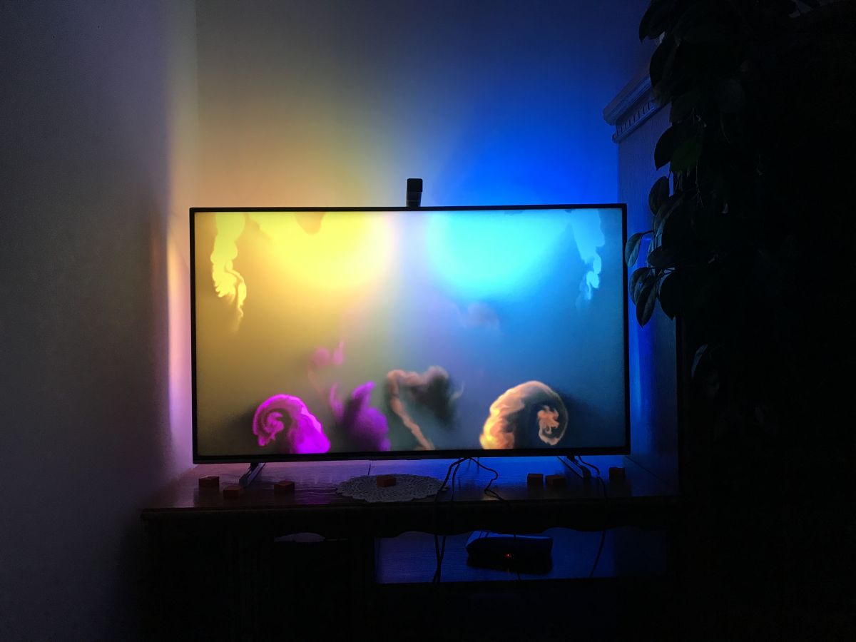

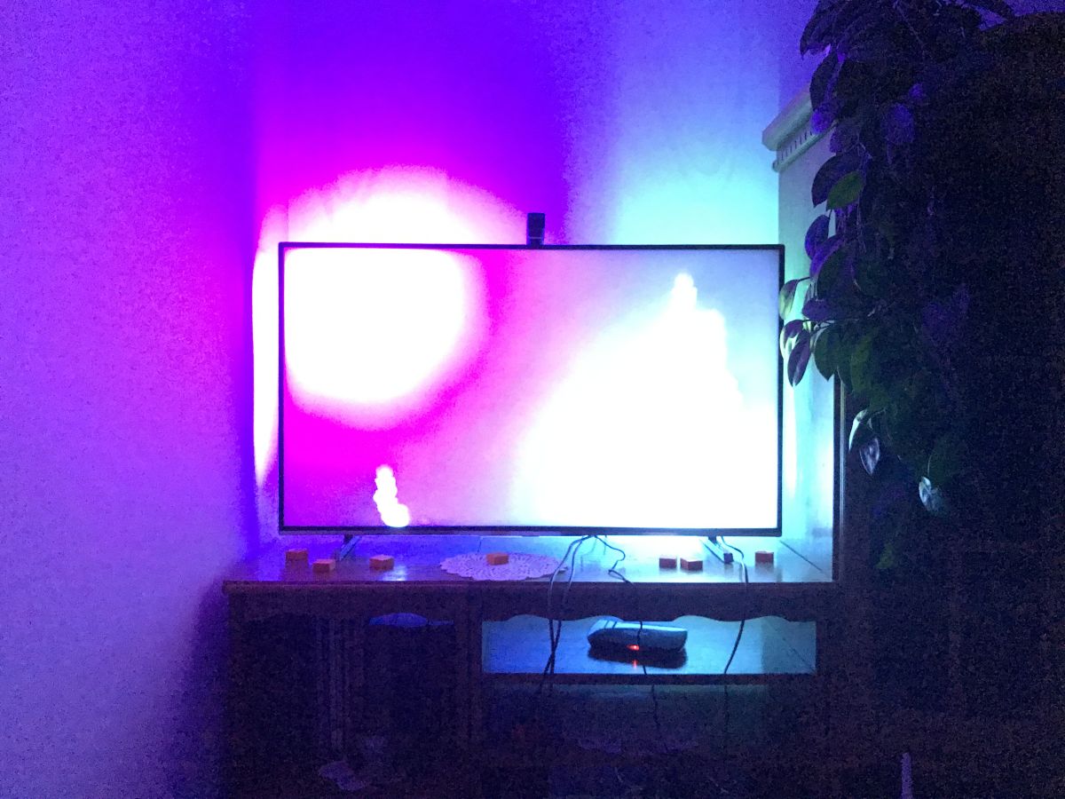

    Gallery of images taken at night, with the lights out:
    TV with dynamic LED backlighting in purple, pink, and yellow tones TV with colorful LED backlight Govee mounted behind the screen TV with Govee LED backlight displaying colorful animation on the screen TV with active LED backlight glow in purple and yellow colors behind screen TV with active LED backlight glow in purple and yellow colors behind screen
    TV with blue and purple LED backlighting mounted on the wall behind it TV with colorful LED backlight glowing in purple and blue hues. Backlit TV with dynamic LED lighting in blue and purple tones in a dark room

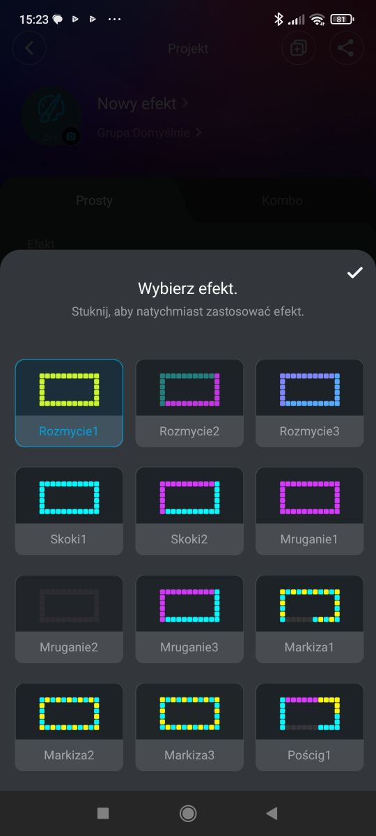

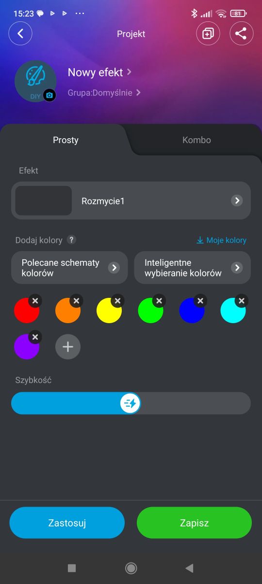

    Custom animations .

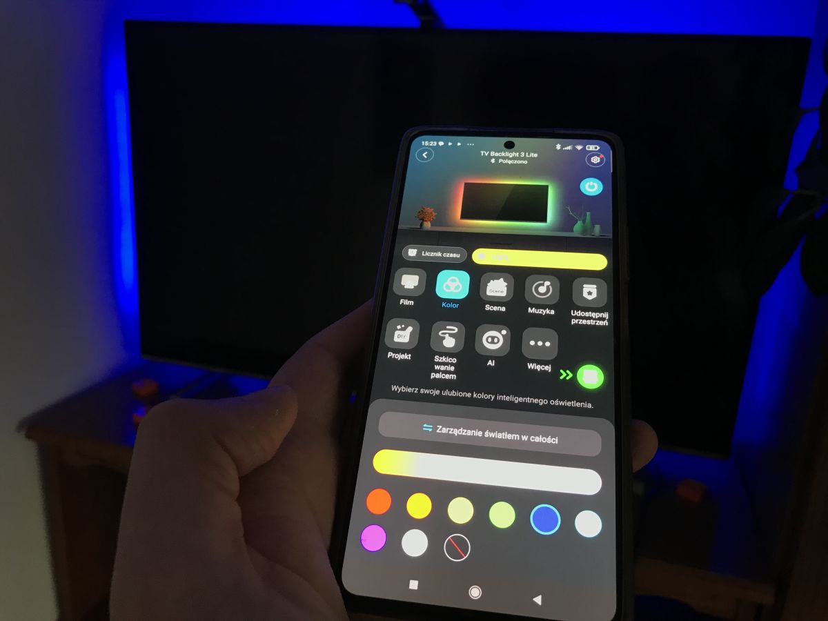

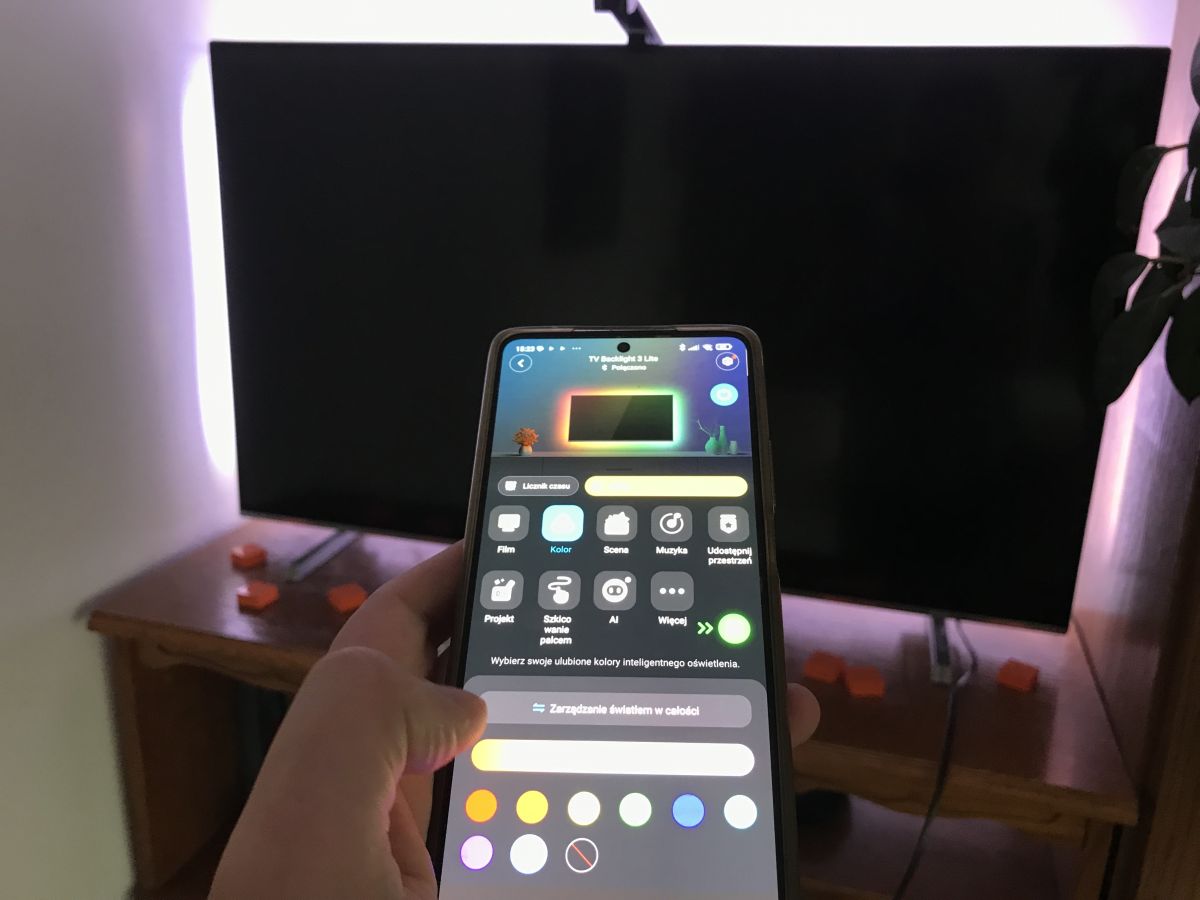

    The strip can also act as an ordinary LED strip. We can set predefined colours, play animations, and there is also a music mode (animation to the rhythm of music) and an animation configurator where we choose the LEDs and their colours ourselves.
    Mobile Govee app screen showing LED strip settings: color, direction, animation modes. Govee app screen with LED backlight active around the TV Govee app screen showing lighting effect editor and color selection App screen showing selectable LED lighting effects for a TV backlight.
    Example effects:
    Smartphone with Govee app in front of a TV with backlight LED turned on Smartphone with Govee app and red LED backlight behind TV Phone with Govee app in front of a TV backlit in blue Phone with Govee app in front of a TV backlit in blue .
    Smartphone with Govee app in front of TV with active LED backlight TV screen on wooden cabinet with RGB backlight and visible cables

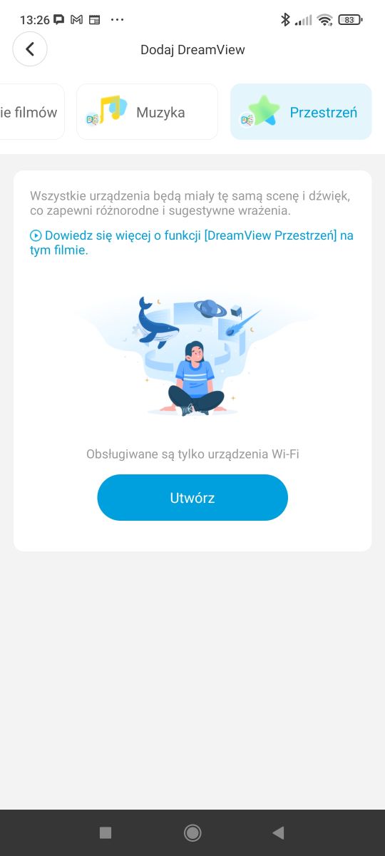

    Multi-device synchronisation - DreamView effect .
    The device also supports the Govee DreamView system that allows external lights to be synchronised with the LED strip discussed here. Simply add another device to the app and then select it in the Synchronisation Centre.
    Govee app screen showing LED light control features and DreamView mode. App screen showing DreamView lighting sync settings and connected device info. App screen showing DreamView setup with Create button highlighted App screen showing DreamView setup with Create button highlighted

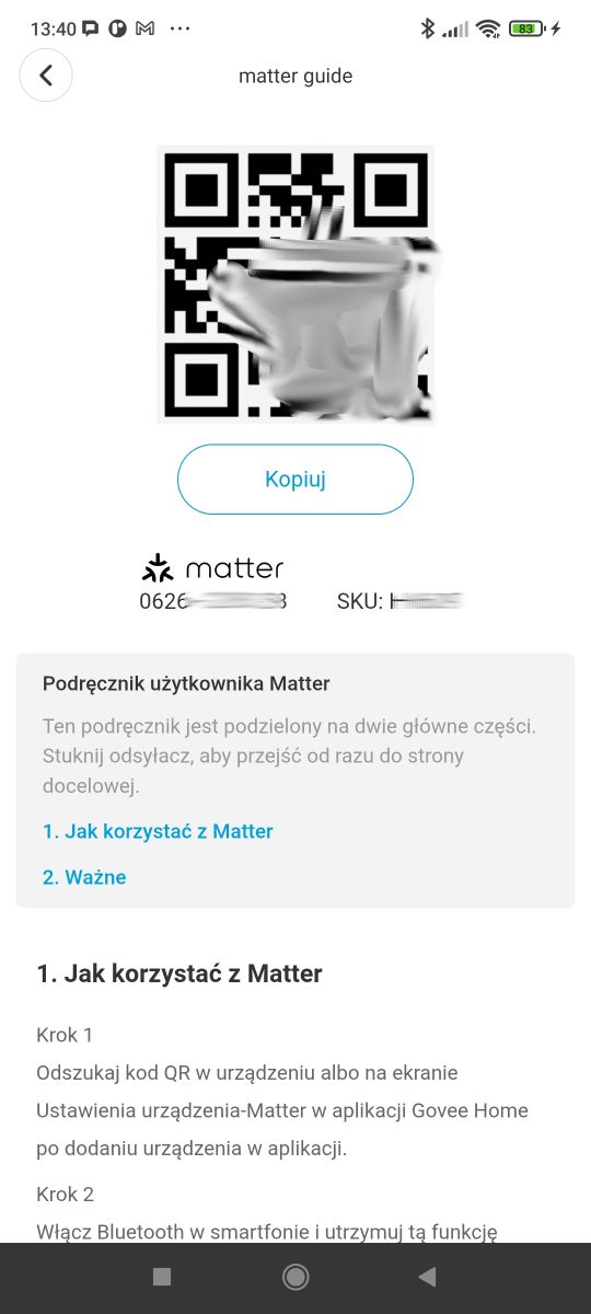

    Support Matter .
    In the options, too, you can find the QR code needed to pair the device with the Matter. This allows you to make it available on Amazon Alexa/Google Home/Apple HomeKit. Detailed instructions can be found in the screenshots below.
    App screen with a Matter guide, QR code, and setup instructions in Polish Smartphone screen showing instructions for setting up a Matter-compatible app

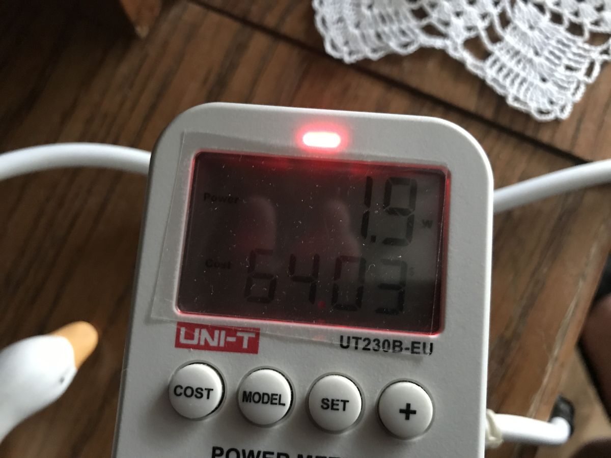

    Power consumption measurements .
    Finally, a brief measurement - how much does it cost us to use such a belt? I show separately the maximum power I was able to record (cold white - the whole strip) and the standby power:
    UNI-T UT230B-EU power meter shows 1.9 W usage and cost value of 64.03 UNI-T UT230B-EU power meter shows 17.3 W usage and cost of 64.03.
    The actual output during normal use is much lower, as only LEDs of one or two colours are usually lit.
