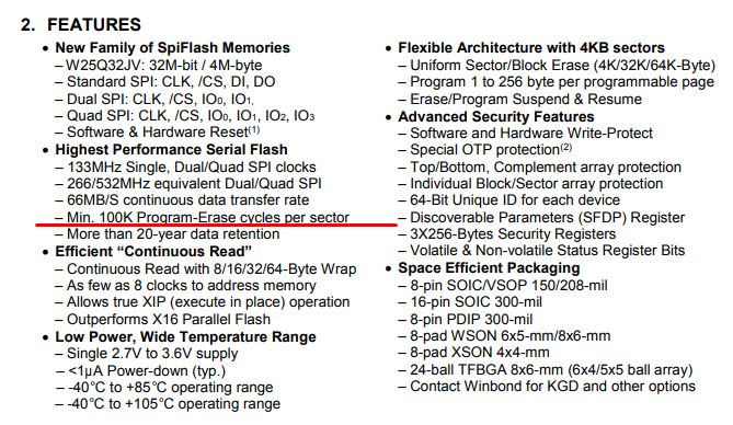

    Flash memory usage warning .
    In this topic I present the recording of results in Flash memory. It's simple and accessible, so as tempting as possible, but it can also be deceptive. Flash memory gets used up quite quickly due to the erase cycles performed.
    Let's assume that our module with ESP8266 has W25Q32 memory on board, this is the memory connected to it via SPI, in this memory our program is stored, but we can also write measurements there.... however, this memory has some limitations. The datasheet says one line about them, sewn into a lot of other information:
    Screenshot of the technical documentation for W25Q32JV Flash memory. .
    100,000 erase cycles per sector.... assuming the worst case scenario that we write measurements to one sector, and assuming that each write is preceded by an erase, then we have 100 000 measurement write events.
    100 000 measurements, how many is that? Let's assume one measurement per hour.
    100000/24 is about 4166 days. That is about 11 years...
    Not likely to be a very good result if we want to create something more than a simple program to play with. And with e.g. 10 times the recording frequency we already drop to 1 year.... (minimum).
    However, I will solve this problem in the third part, for now let's try to skip it and just learn the simplest way to write to Flash .

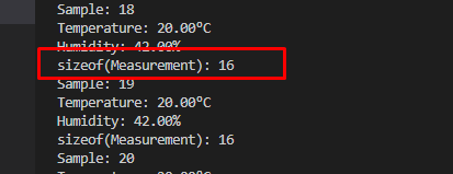

    This has 16 bytes with us, by the way, let's check, sizeof the truth will tell us:
    Code: C / C++
    16 bytes:
    Console showing measurement sample data and size of measurement structure. .
    Since this is the case, this structure will fit a whole 256 times in 4096, but we still want to be able to store the index of the last measurement, so let's assume we will store 255 samples:

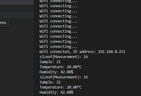

    It remains to be seen whether this works. For this purpose I have additionally given a display to the console of the index of the last sample:
    Code: C / C++
    We upload and observe the changes in the console:
    Temperature and humidity measurement results in the console. .
    When the board is restarted, will the sample countdown resume from the saved index?
    Console displaying temperature and humidity from ESP8266 .
    Yes, it looks like the save works .

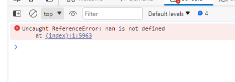

    The graph does not display! .
    We get an error in the console:
    Screenshot of JavaScript console error .

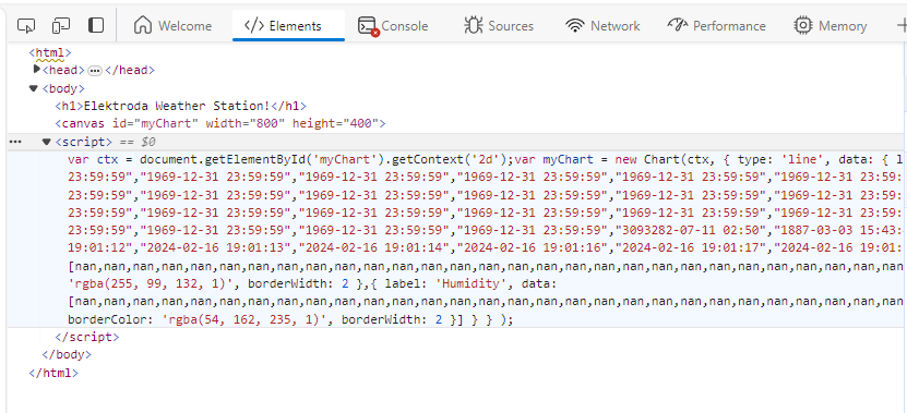

    We execute "Examine Source" on the page to see what went wrong:
    Error on Elektroda Weather Station page with nan values. .
    We have a bunch of values in memory nan , meaning "not a number". This needs to be fixed.

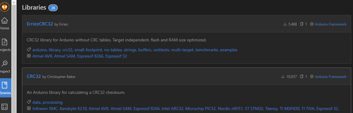

    A checksum is a special value which is calculated from more data in memory. The checksum function is designed so that a small change in the data results in an immediate change in the result of this sum. Thus, if we calculate the checksum for an array and flip even one bit in that array, the checksum should already have changed. Of course, this is not an ideal solution, as there are so-called collisions, but for this application, let me ignore that....
    A popular checksum system is CRC32. Just right for 4 bytes, 32 bits, we also have a library ready for it:
    Screenshot of a list of CRC32 libraries on the Arduino platform. .
    Example from the author of the library:
    Code: C / C++
    We need to count the checksum of the entire data block each time it is written, and write it then to the EEPROM:
    Code: C / C++
    For simplicity I don't count the checksum for the index of the last sample either, but in general I should do that too.

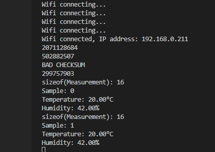

    At program start, when reading samples, we have to read the "old" checksum and count the same for the loaded data. We then compare these values and if they are the same, we assume that no unwanted change has occurred. If they are different, then surely something has gone wrong or there were no samples in memory:
    Code: C / C++
    If we already know that there is no valid data in memory, we also need to manually clear that memory, count the correct checksum and write that data to it:
    Code: C / C++
    It is time to test the mechanism developed. At this point there are unexpected values in memory, so we will expect a bad checksum message once, and then with each reboot of the board this checksum should be fine.
    Arduino console showing WiFi connection status and DHT11 data .
    After pressing RESET:
    Console display with information about Wi-Fi connection, checksum, and current temperature and humidity readings. .
    Indeed, on the second reading the checksum was already correct. The system works:

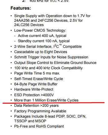

    Of course, you could also just use an external EEPROM.... the code would be easy to flip on that. Let's look to the datasheet note of some EEPROM how many cycles it will last. For example the 24LC256:
    Partial technical documentation of the EEPROM 24LC256. .
