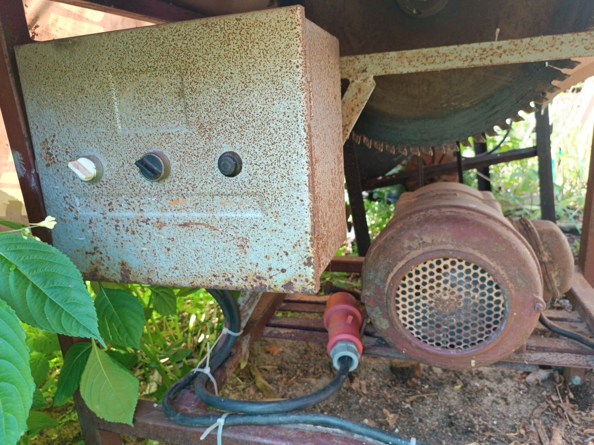

    Gentlemen good day, I bought a working saw, at the seller it worked beautifully, it has a 5 pin power connection, at my place an old extension cord for 4 pin, I bought an adapter, connected and the motor buzzes not starting. How do I get around this? Second question, if the motor has such a control "cabinet", can I connect it bypassing the cabinet and make a normal force switch?

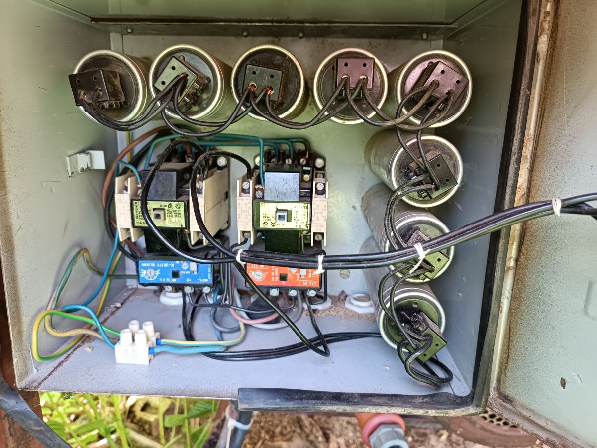

    aszachnowski998 wrote:
    the engine has such a control "cabinet"
    Why is there that cloud of capacitors and two contactors? Does the saw have two motors or one?
    Those capacitors suggest that the power supply is single phase.

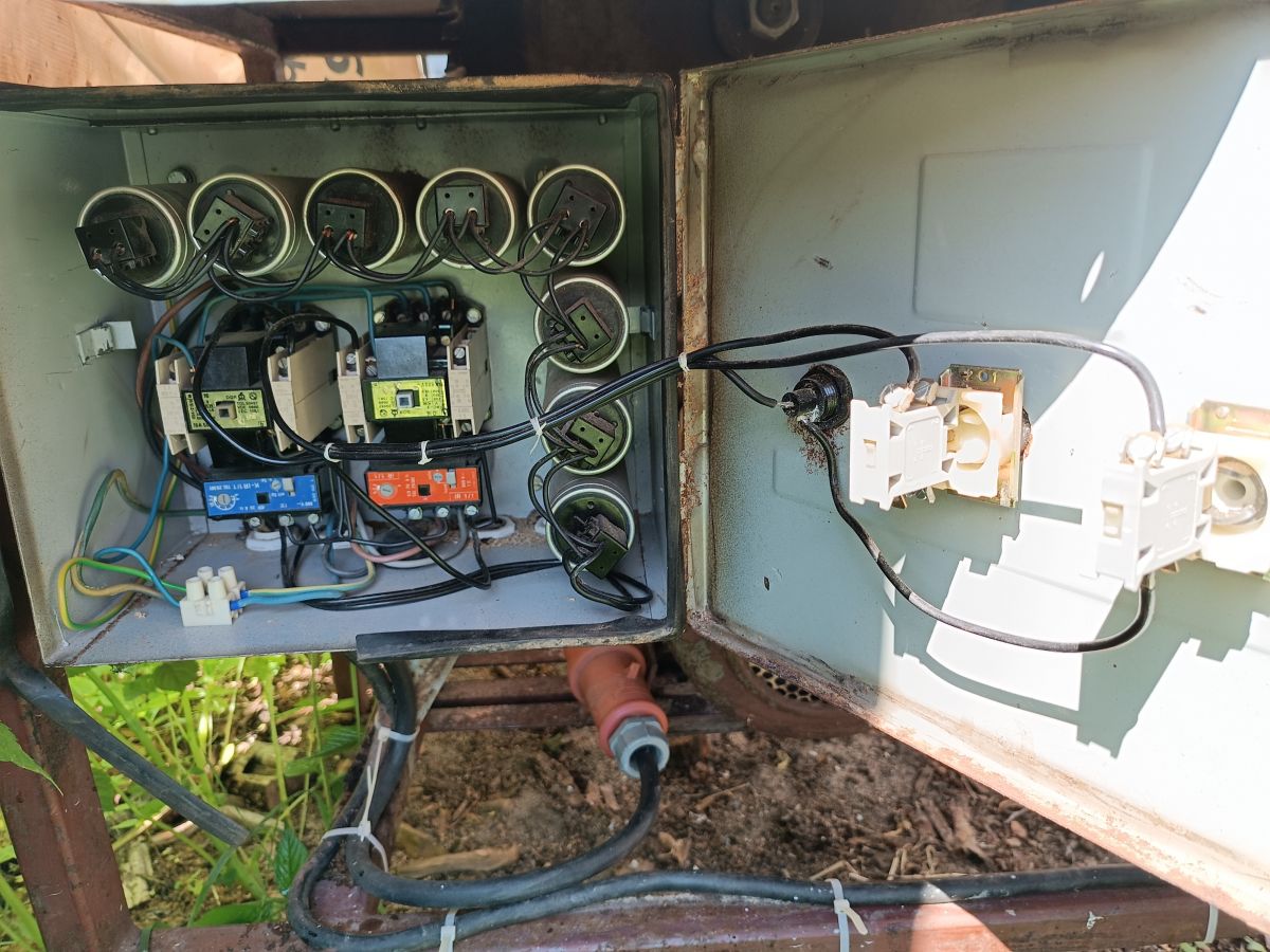

    It is too much to know what has been contrived and concocted here. Some kind of a self-creation.
    Previously, this could have been a right-left control with two contactors and the capacitor bank used to power a single-phase motor.
    What I see there is that only the right contactor is used to switch on the motor, power input from the bottom to the right contactor, output to the motor at the top by the left contactor. Only the left switch in white works (via the interlock on the left contactor). Contactor coil control uses N wire, coils must be 220 volts.
    In this situation a 400/230V supply is required with a separate neutral wire - 5p socket.
    To be able to supply from a 4p socket, the control system needs to be upgraded - fitting a trafo from 400V to control (230V) or safety (24V) voltage + replacing the DDR contactor coil, or finding a 380V coil and supplying the control from two phases. There may be a problem with the price of the transformer and availability of the coil for the contactor.
    A unit with a manual override does not meet safety rules, there must be a pushbutton start-stop system and a mushroom safety button. This means further modification of the control system. It may be simpler to knock out this whole box and use a ready-made circuit breaker on a contactor made by Kedu or Tripus with a 400V coil, with the possible addition of a separate motor switch or thermal relay.
    The fact that the motor is humming and will not start is probably due to the lack of a phase in your electrical system.

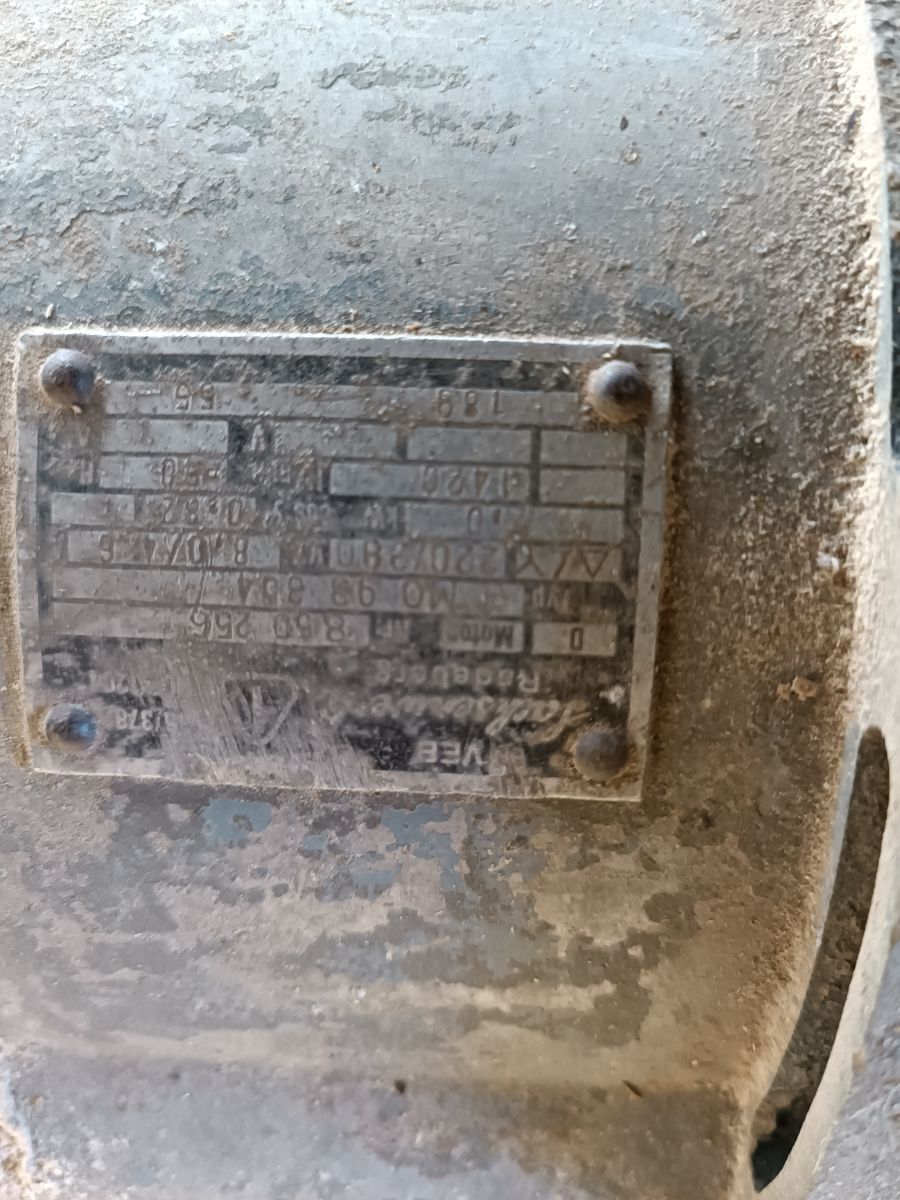

    emarcus wrote:
    The plate says it is 2 kW;
    So what?
    So much for direct starting.

    emarcus wrote:
    the label says it is 2 kW;
    So what?
    On top of that, only 1420 rpm.
    And the saw ~700mm diameter / 80 teeth and from what you can see from the rust on it, it extends no more than 100mm above the table

    jdubowski wrote:
    Or the fact that the contactor does not switch on all phases
    Possibly, but I don't know if DDR contactors caused such problems.
    I rescued an Elester SLA16 recently because there were burnt contacts on one track, but as it turned out there is a plastic wedge between the core and the element with the moving contacts, the plastic crumbles over time and without it there is 2mm missing to press the contacts together.
    As for the subject. On Allegro a Breve TMM 400/230 V transformer starts at PLN135 for 50 VA, for this you will definitely need holders + fuses for the primary winding (two fuses, for one and the other phase) and possibly the secondary winding. I think a minimum 30 VA transformer would be necessary for this contactor, stronger ones are more expensive.
