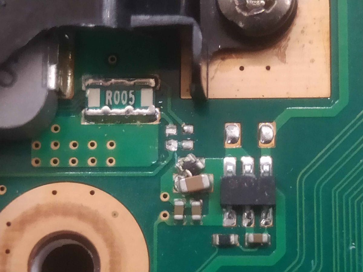

    When you say (There may be a problem with the power supply PCH) you mean the power that is supplied to the PM965 might have a problem
    edit : I found some components near the PM965 chipset that seem to be in the wrong place
    Close-up of a circuit board with visible electronic components, including a resistor marked R005.

  • #7 21132596
    _car123
    Posts: 16
    I found the problem it was the 2 components. I put them back in the correct place now the laptop powers up but it says PCI Express error.

    Posts: 16
    The problem was caused by two components on the motherboard being out of place. After putting them back in, everything is working fine.
