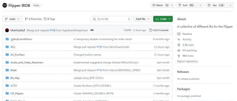

    Flipper Zero supports a wide range of popular formats, such as RC5, RC6 or NEC, for example, but also supports the raw format - that is, the universal 'raw' (unprocessed) signal format. This allows essentially any device to be controlled, and without knowledge of the signal encoding itself. It also allows the community to create open IR code bases, such as Flipper-IRDB, for example:

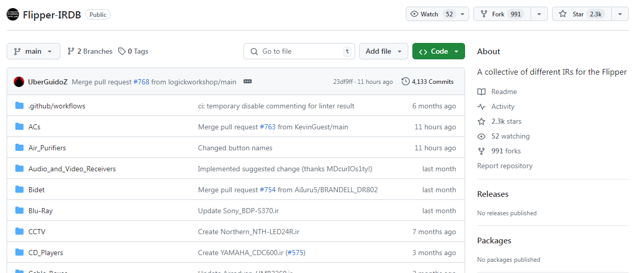

    https://github.com/Lucaslhm/Flipper-IRDB/
    Inside, we have a range of captured signals to choose from.
    Screenshot showing the Flipper-IRDB repository on GitHub. .
    For example, here signals from Samsung TVs:
    https://github.com/Lucaslhm/Flipper-IRDB/blob/main/TVs/Samsung/Samsung_AA-00721A
    The protocol here is Samsung 32, this is what the example signal looks like:

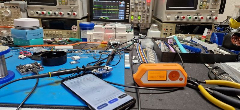

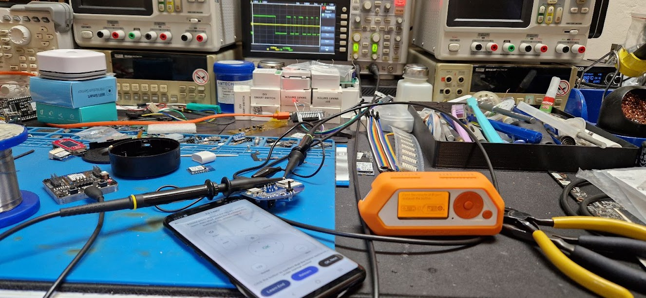

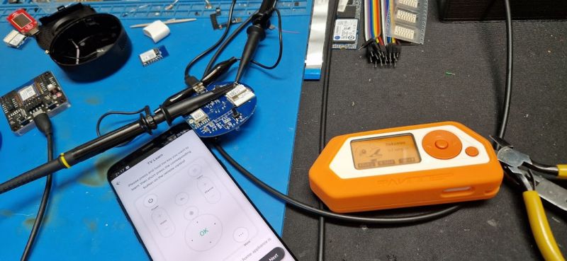

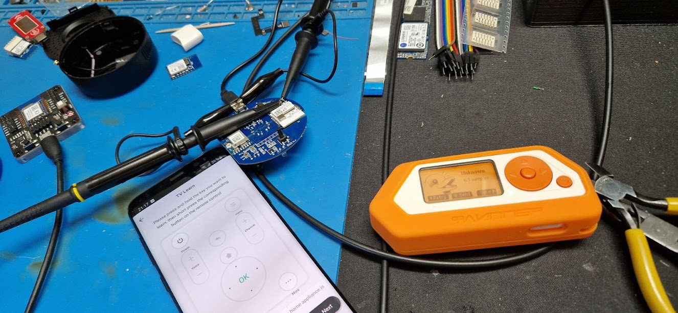

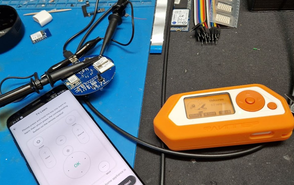

    Let us perhaps leave these repositories of codes captured by other users and try to catch some signal ourselves. We just happened to have a "Smart IR Remote" from Tuya, a WiFi-controlled gadget capable of sending and receiving various IR signals. As a test, we decided to send something from it to the Flipper:
    Laboratory with electronic devices, an oscilloscope, and a Flipper Zero on the table. .
    Flipper Zero on a desk with electronic devices and a smartphone. .
    After saving the received signal on Flipper, we received such a file:
    type: raw
    frequency: 38000
    duty_cycle: 0.330000
    data: 3190 1291 951 502 902 1292 903 546 901 640 902 545 903 548 900 545 902 641 901 546 902 546 901 546 902 639 903 1294 901 65009 2376 549 903 1293 1007 1283 901 640 902 1294 901 546 902 546 902 545 902 640 902 546 901 639 903 546 901 639 903 546 902 546 901 1293 902

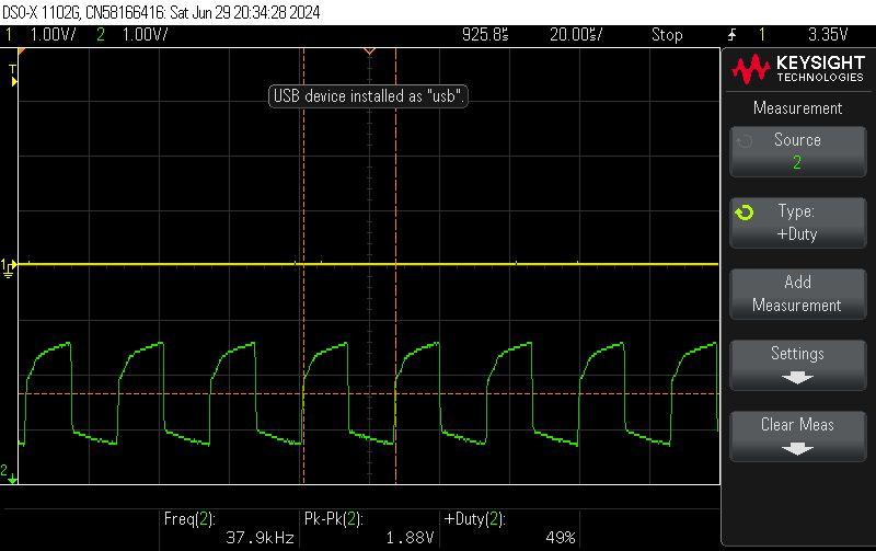

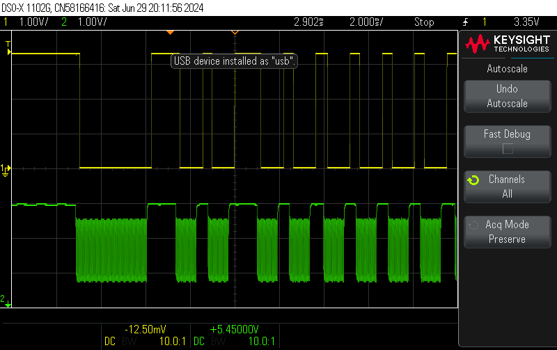

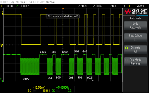

    It is now time to see what the same signal looks like on an oscilloscope. The trigger function was used to capture the data, i.e. triggering the capture with the edge of the signal.
    Let's look at the green signal (the yellow one is after processing):
    Oscilloscope view with green and yellow IR signal waveforms. .
    You can see essentially two logical levels here, only that one of them is 'jagged', what does this mean?
    Oscilloscope screen displaying a modulated IR signal
    This "jagged" signal is a 38kHz carrier wave, the signal here has been modulated. In the first screenshot from the oscilloscope, the demodulated signal is shown in yellow.
    We now know what these two parameters mean:
    frequency: 38000
    The first is the frequency used (usually around 30-60kHz) and the second is the fill cycle.
    What's left is the raw format data. These are not bytes, but times in microseconds:
    Simply plot their values on the oscillogram and we can already see that everything agrees:
    Oscilloscope screenshot showing infrared signal. .
    These numbers are the times of the high and low states sequentially, so that the raw format is able to reflect the different signals, regardless of the coding used further down in them.

  • Przykładowy zapis Flipper RAW z wątku używa frequency: 38000 i duty_cycle: 0.330000, czyli nośnej 38 kHz i wypełnienia 33%. [#21137604]
  • Pole data zawiera czasy w mikrosekundach, np. 3190 1291 951 502, a nie bajty ani słowa protokołu. [#21137604]
  • Autor wskazuje typowy zakres nośnej IR jako około 30–60 kHz, z 38 kHz jako pokazanym przykładem praktycznym. [#21137604]
  • W przykładowym nagraniu widać długą przerwę 65009, czyli około 65,009 ms, co rozdziela kolejne części transmisji. [#21137604]
  • Flipper-IRDB w wątku pokazuje dwa style plików: type: parsed dla Samsung32 oraz type: raw dla uniwersalnego odtwarzania bez znajomości kodowania. [#21137604]

How should I interpret the timing values in a Flipper Zero raw IR recording, and how do they map to high and low states?
Interpretuj te liczby jako kolejne czasy stanów wysokiego i niskiego, zapisane w mikrosekundach. Autor wprost wyjaśnia, że nie są to bajty. Sekwencja 3190 1291 951 502 ... odpowiada kolejnym odcinkom widocznym na oscyloskopie. Długi odstęp, np. 65009, oznacza przerwę między częściami transmisji. To właśnie dlatego RAW potrafi odwzorować różne sygnały niezależnie od dalszego kodowania bitów. [#21137604]
What does the jagged 38 kHz waveform on an oscilloscope mean when measuring an IR signal?
Poszarpany przebieg oznacza nośną 38 kHz, na której nadawana jest informacja. Na zielonym śladzie autor pokazał dwa poziomy logiczne, ale jeden z nich jest „ząbkowany”, bo dioda nie świeci ciągle. Ona miga z częstotliwością nośną, a dopiero to miganie jest włączane i wyłączane zgodnie z danymi. Żółty przebieg na zrzucie to już sygnał po demodulacji, czyli uproszczona obwiednia. [#21137604]

What is a demodulated IR signal, and why does it look different from the carrier on the oscilloscope?
Sygnał zdemodulowany to uproszczona postać sygnału IR bez szybkiej nośnej 38 kHz. "Demodulated IR signal" is a processed signal representation that removes the carrier, leaving the slower command envelope, so timing analysis becomes easier and the oscilloscope trace looks smooth instead of jagged. Dlatego żółty ślad na ekranie wygląda prościej niż zielony. Zielony pokazuje miganie nośnej, a żółty tylko momenty jej obecności i braku. [#21137604]

What is Samsung32 in Flipper-IRDB, and how is a parsed IR file different from a raw one?
Samsung32 to nazwany protokół IR pokazany w repozytorium Flipper-IRDB. W przykładzie plik type: parsed ma pola protocol: Samsung32, address i command, więc opisuje znaczenie danych na poziomie protokołu. Plik type: raw nie opisuje adresu ani komendy. Zawiera nośną, wypełnienie i czasy impulsów, dzięki czemu da się odtworzyć sygnał bez rozumienia jego struktury logicznej. [#21137604]
Where can I find ready-made IR codes for Flipper Zero, such as TV or Dyson remote commands?
Gotowe kody znajdziesz w bazie Flipper-IRDB wspomnianej w wątku. Autor podał przykład dla telewizorów Samsung oraz osobny przykład dla oczyszczacza Dyson. W repozytorium są zarówno pliki parsed, jak i raw, więc możesz wybrać opis protokołu albo czysty zapis do odtworzenia. Taki plik można przesłać do Flippera przez USB i użyć do nadania opisanej komendy. [#21137604]
