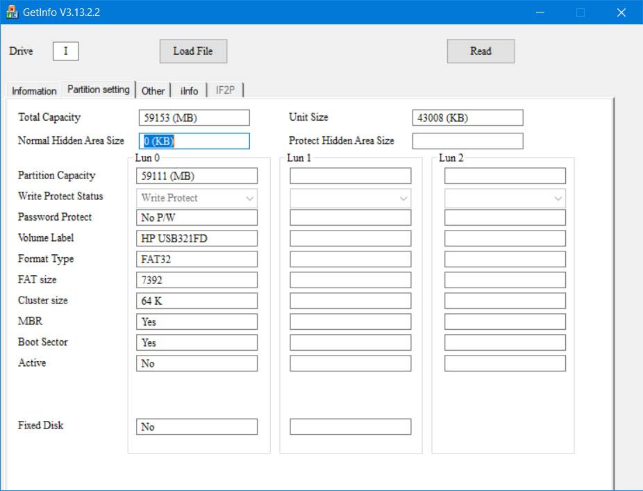

    I have an HP USB 3.2 flash drive that I was running ATTO on to benchmark it when the power went off. When the power came back on, the flash drive was set to write protected. I have tried many tools that are supposedly able to fix this issue but none of them will do a thing to it.

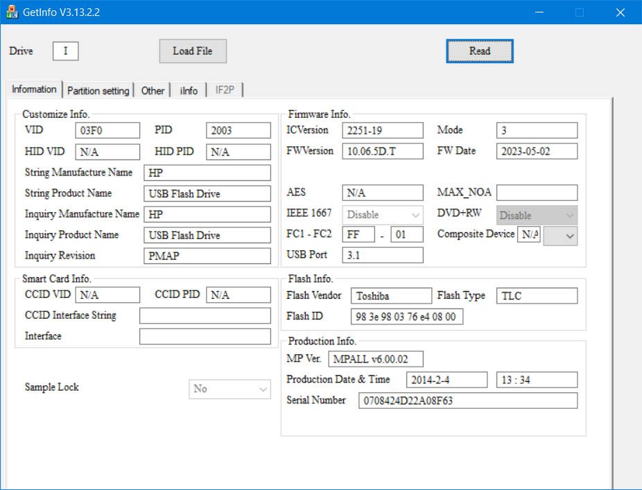

    Here's the ChipGenius info
    Description: [I:]USB Mass Storage Device(HP USB Flash Drive)
    Device Type: Mass Storage Device
    Protocol Version: USB 3.20
    Current Speed: High Speed
    Max Current: 504mA
    USB Device ID: VID = 03F0 PID = 2003
    Serial Number: 0708424D22A08F63
    Device Vendor: HP
    Device Name: USB Flash Drive
    Device Revision: 0110
    Manufacturer: HP
    Product Model: USB Flash Drive
    Product Revision: PMAP
    Controller Vendor: Phison
    Controller Part-Number: PS2251-19(PS2319) - F/W 10.06.5D [2023-05-02]
    Flash ID code: 983E980376E4 - Toshiba [TLC]
    Tools on web: http://dl.mydigit.net/special/up/phison.html

    GetInfo V3.13.2.2 program interface displaying technical details of a USB device.
    Screenshot of GetInfo V3.13.2.2 showing USB memory partition details.
    Other tab has
    MP F1 F2 is F1+F2
    ID_BLK Ver. 1.5.38.0
    World Wild Name N/A
    iInfo tab is all blank. IF2P tab is greyed and can't be opened.
