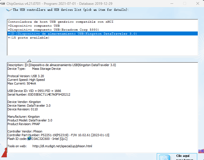

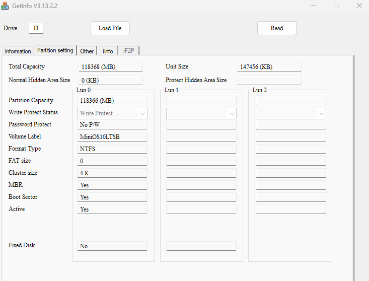

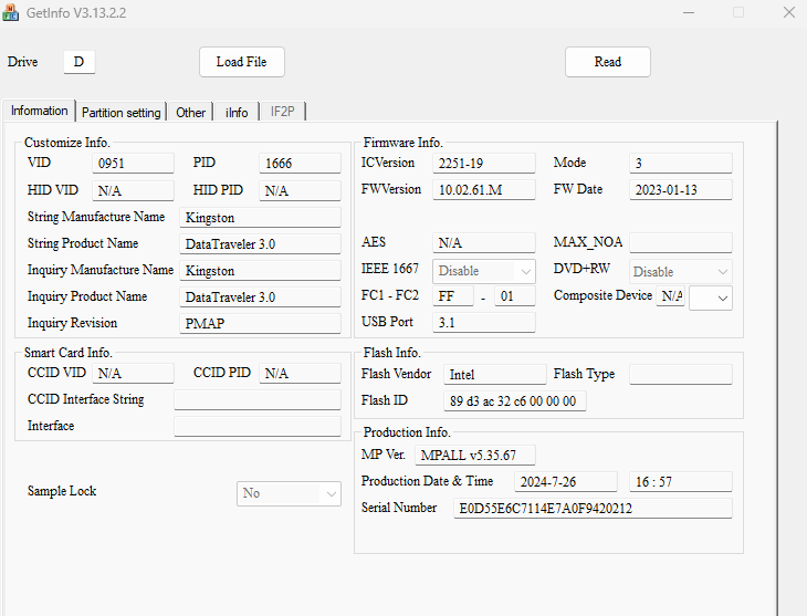

    Hello, I'm new and I saw that you provide help and tools to repair USB flash drives with write protection. I have a flash drive, but I can't find the right tool or it doesn't exist. I've tried everything, and nothing works. What can I do to recover said flash drive? I'm leaving an image of the information on said flash drive with two tools.

    AI: Could you please share the brand and model of your USB flash drive?
    Kingston DataTraveler 3.0 128GB
    AI: Which specific tools and methods have you already tried to remove the write protection, and did you encounter any error messages or specific behaviors during those attempts?
    I have already tried MPALL v5.35.67, and also tools like diskpart and STTOOL, as well as the Phison restore tool.
