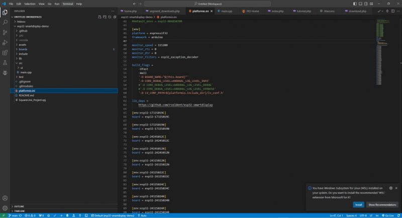

    We download the repository as a zip or "clone" it via Git.

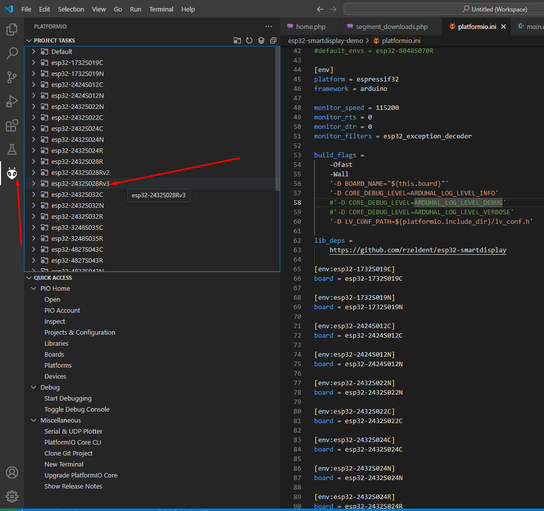

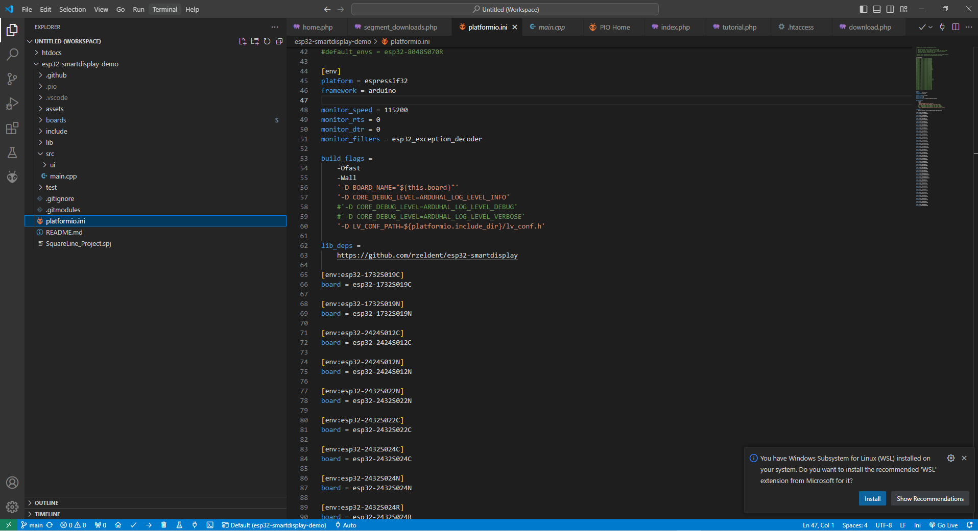

    We open it in PlatformIO:
    ESP32 and touch display - part 5 - LVGL in SquareLine Studio .
    This project supports a wide range of boards with a variety of displays. Most importantly, however, it also supports our ESP32-2432S028R.

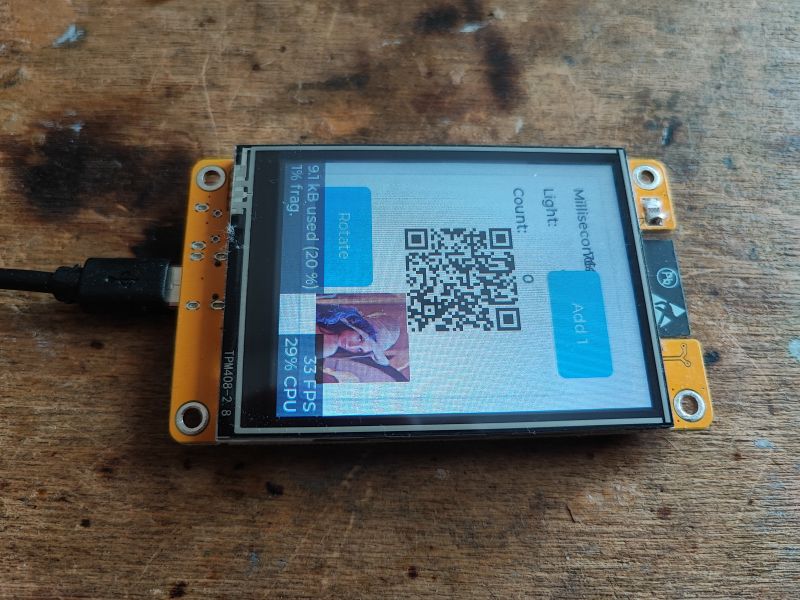

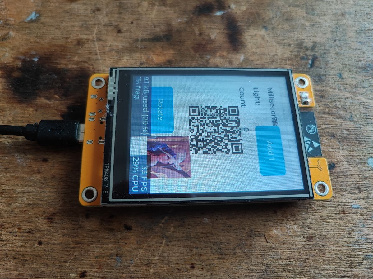

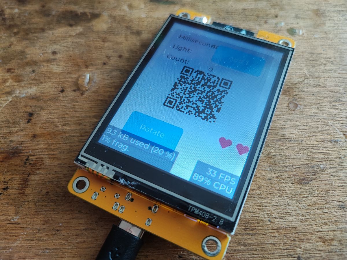

    At first I was a bit confused about which version I should run, as there is esp32-2432S028R, esp32-2432S028Rv2 o esp32-2432S028Rv3. In my case, only the third option gave a picture. Just compile and upload and see what the effect is:
    ESP32 and touch display - part 5 - LVGL in SquareLine Studio ESP32 and touch display - part 5 - LVGL in SquareLine Studio ESP32 and touch display - part 5 - LVGL in SquareLine Studio ESP32 and touch display - part 5 - LVGL in SquareLine Studio .

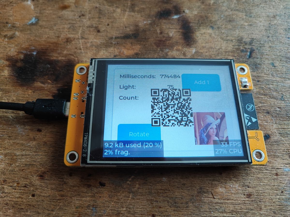

    Well it doesn't look neat, but the effect is there, the graphics, the QR code and even the interactive button.

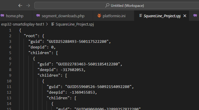

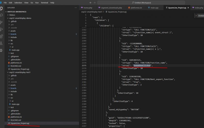

    But that's not all... this project is not based on C code alone, we also have an SPJ file here:
    This is a UI project made in SquareLine Studio. SquareLine Studio then converts it into C code, which we only then compile normally under ESP. Clever! Here there is no UI "intermediate format" like HTML or XML, we have the code straight away.

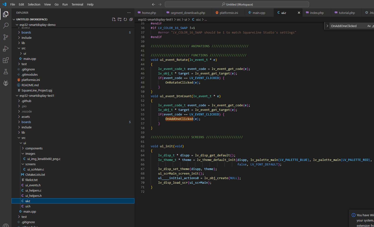

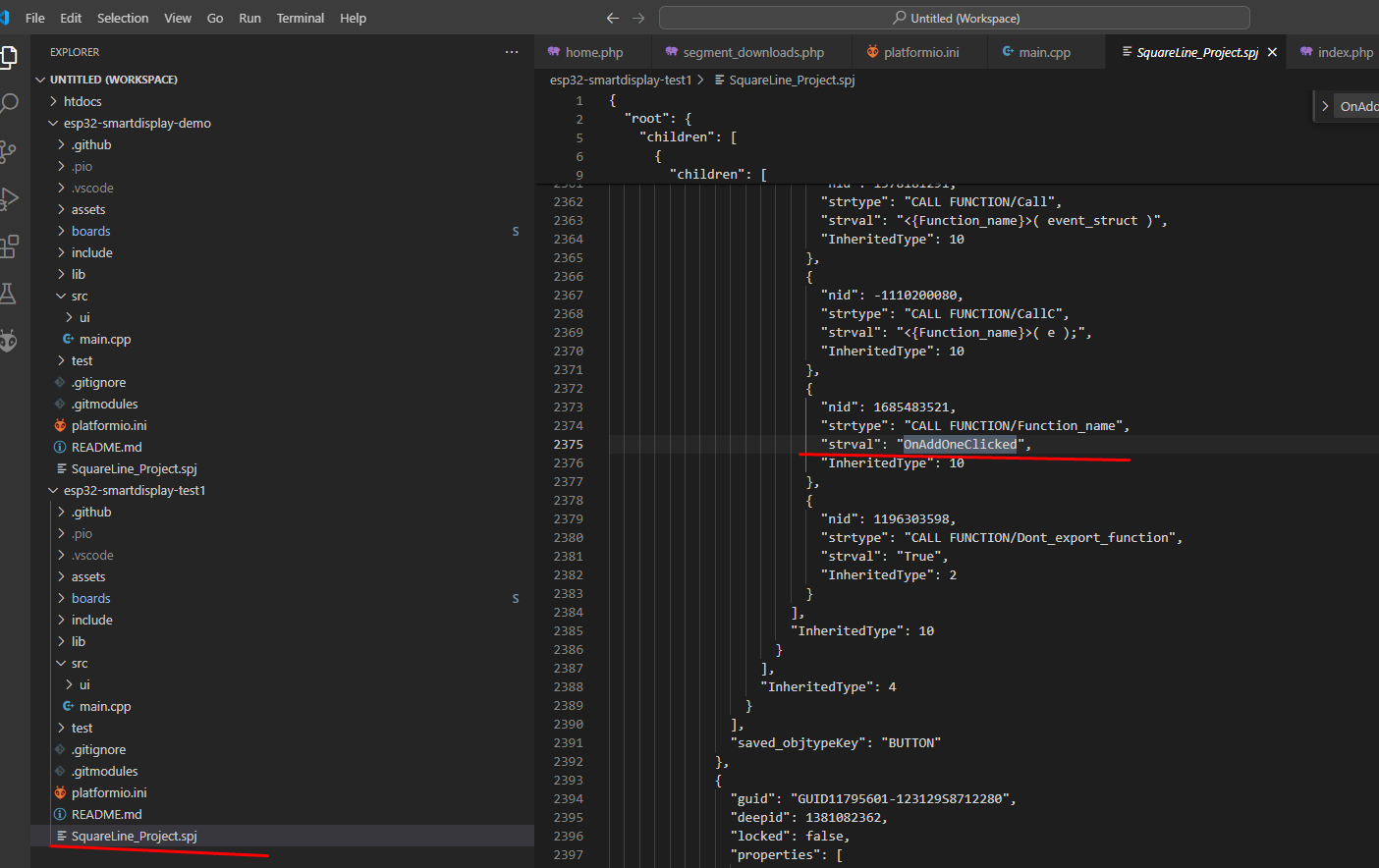

    So let's consider where the button press event is set, for example OnAddOneClicked?
    This is automatically plugged in by SquareLine Studio:
    The code above shows how the interface is created in C code. The panels and the relationships between them are created separately and the event handler functions are plugged in.
    But this code is automatically generated from the aforementioned SPJ file, below is the relevant excerpt:
    But we are still missing something. What does the callback ui_event_btnCount set?
    This in turn is in the 'screens' folder, creating a 'screen' sets the callback:
    Code: C / C++

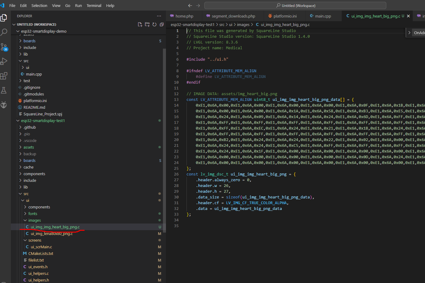

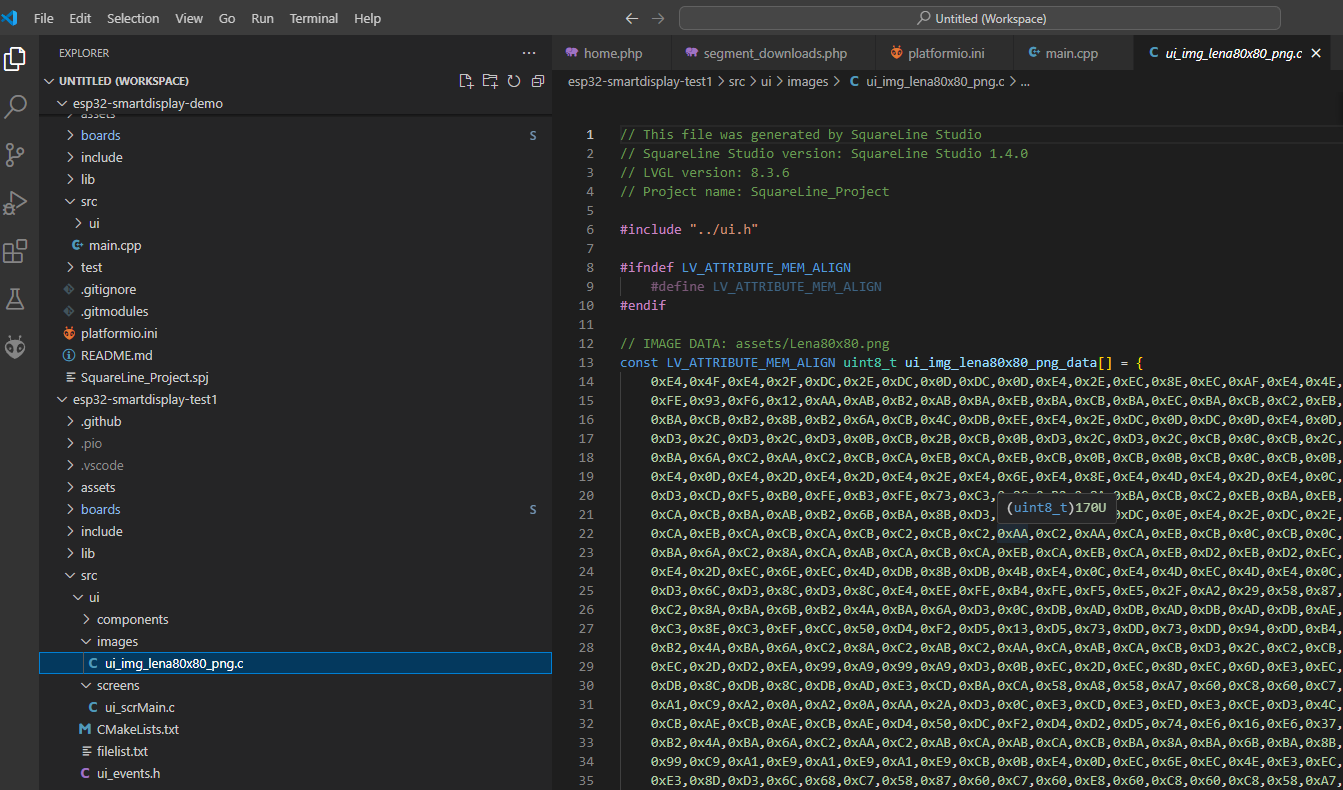

    Similarly with images - images are converted directly into bytes in memory:

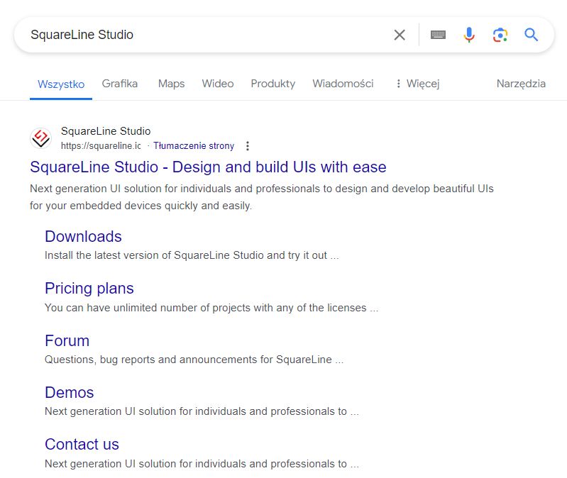

    It is time to conclude our programming 'investigation' and to try SquareLine Studio in practice. The program is paid, but a free trial version and a free but truncated Personal version (not for commercial use) are available:
    https://squareline.io/pricing/licenses#licenseTable
    Is it worth giving it a chance? Let's find out.

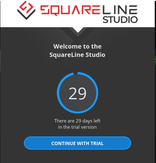

    Trial enough for 30 days:

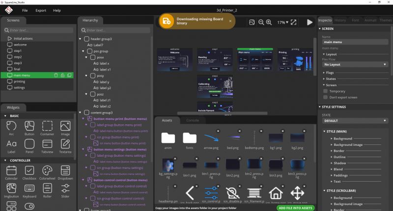

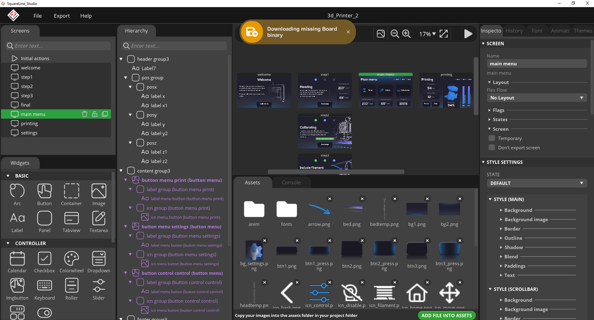

    Upon start-up, we are greeted by an almost blank screen, but fortunately a bit of examples are available:
    They look really good...

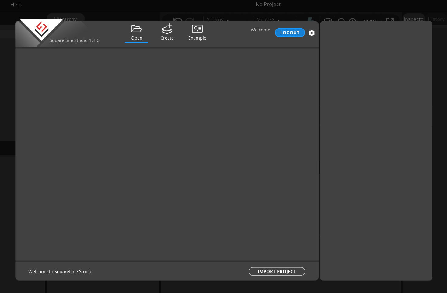

    Repairing the SquareLine Studio project .
    At this point I wanted to simply open the aforementioned SPF project from Github and try to refactor it, but surprisingly SquareLine failed here. It simply did not respond to opening the project. So far I don't know what's wrong there, but I managed to fix it in a simple way:
    1. I created another SquareLine studio project
    2. I saved it in a separate folder
    3. I overwrote its SPF file with a file from Github
    4. I copied the assets folder manually
    We fired it up and... it works:
    I don't know what was wrong with the previous project, maybe some metadata file was missing, someone added too many files to the .gitignore? One can speculate.

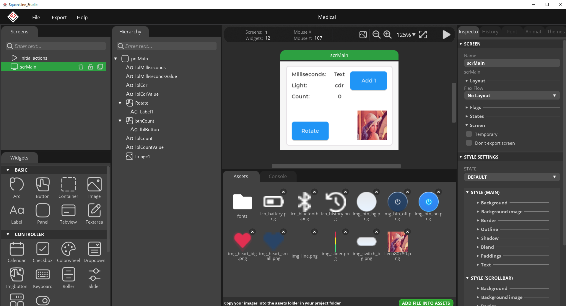

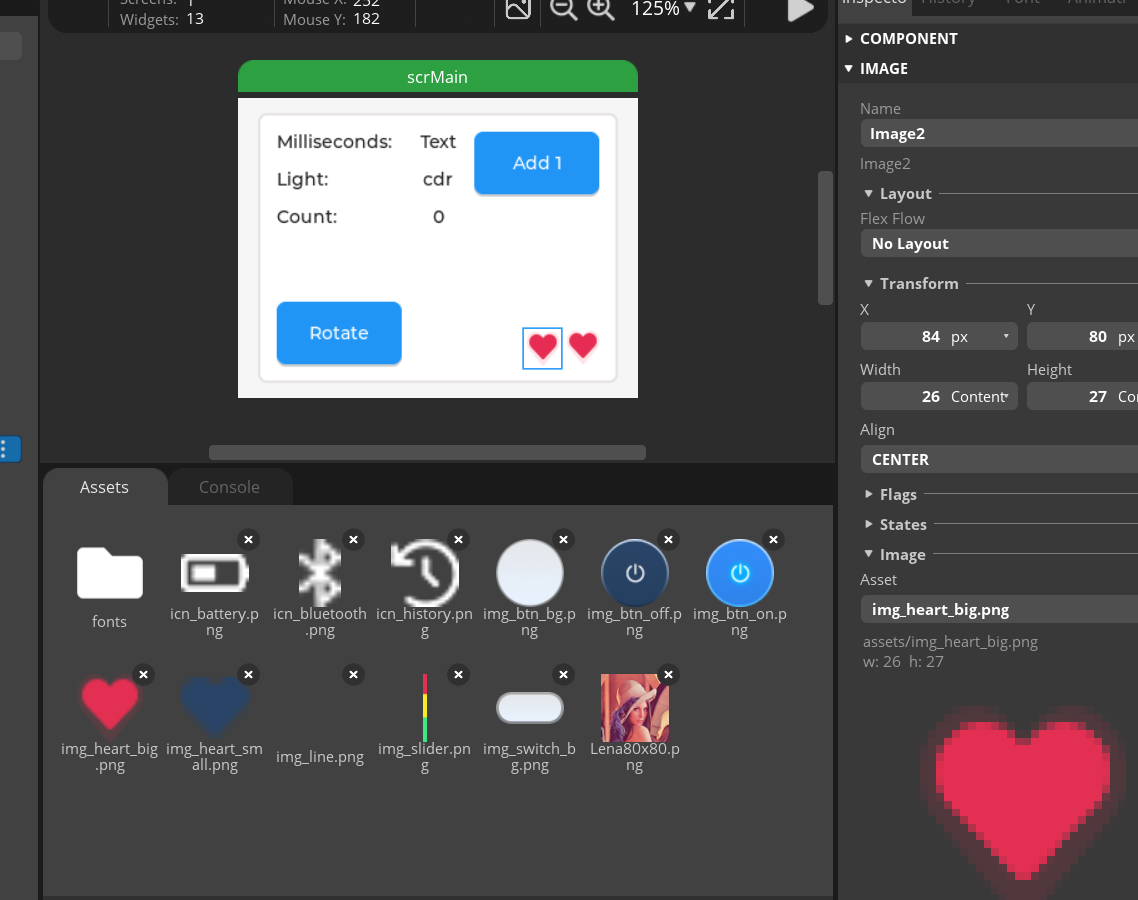

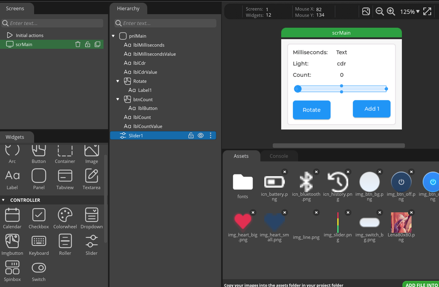

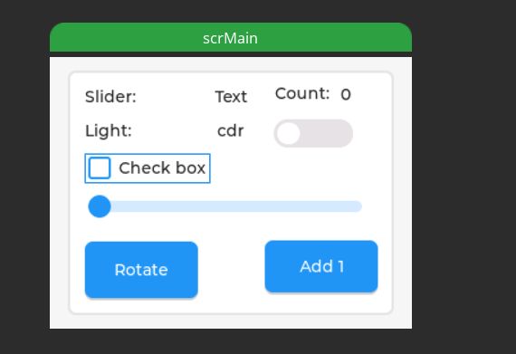

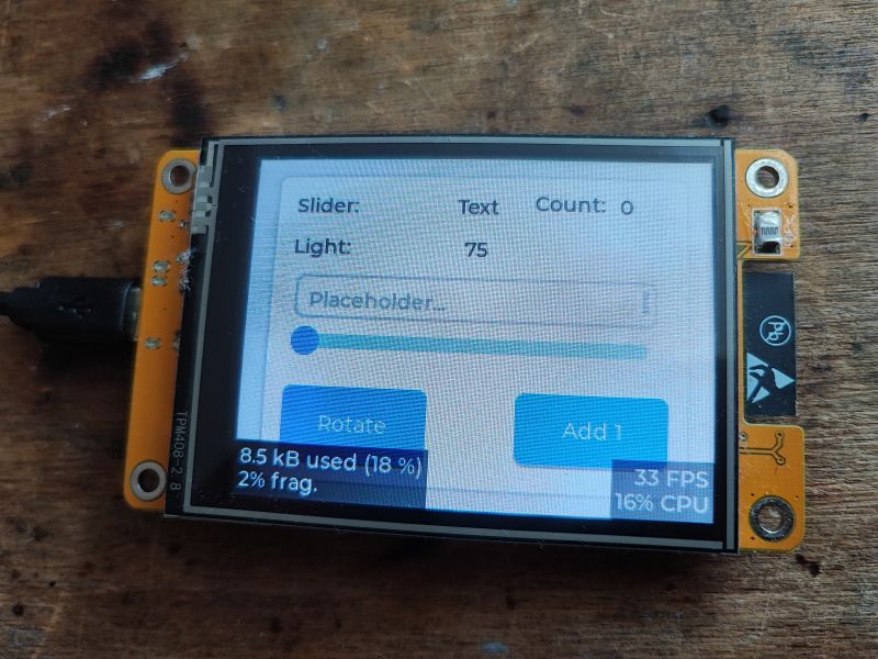

    Basics of SquareLine Studio .

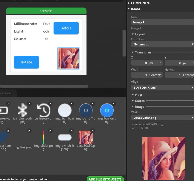

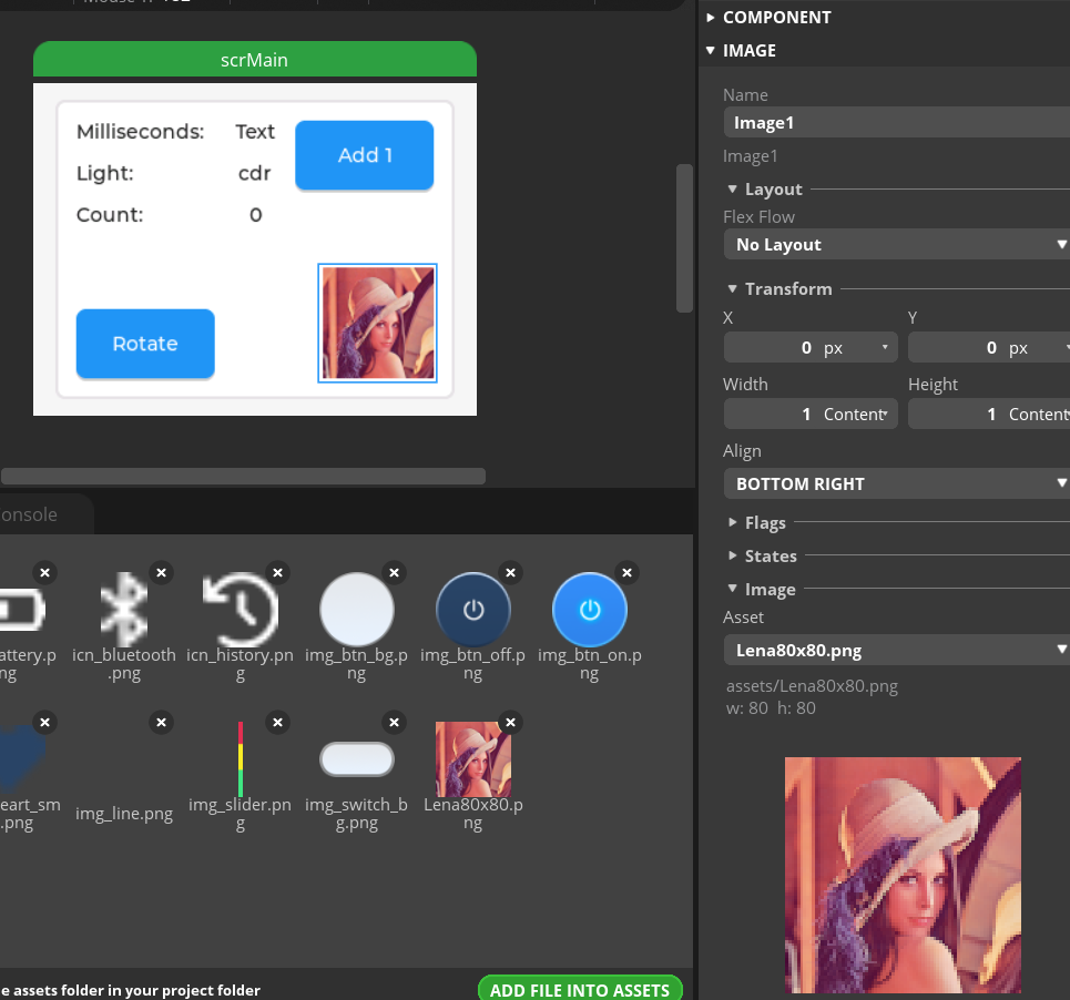

    Finally we have an open-source SquareLine Studio project so it's time to try to modify it somehow.
    Let's see what exactly this program will allow us to do. We'll check out what it's like to create different elements in it, plug events into them, etc.
    Each element can be moved, edited and configured:
    Other icons can be inserted here, also interactive of course (they can then be edited from within the code):

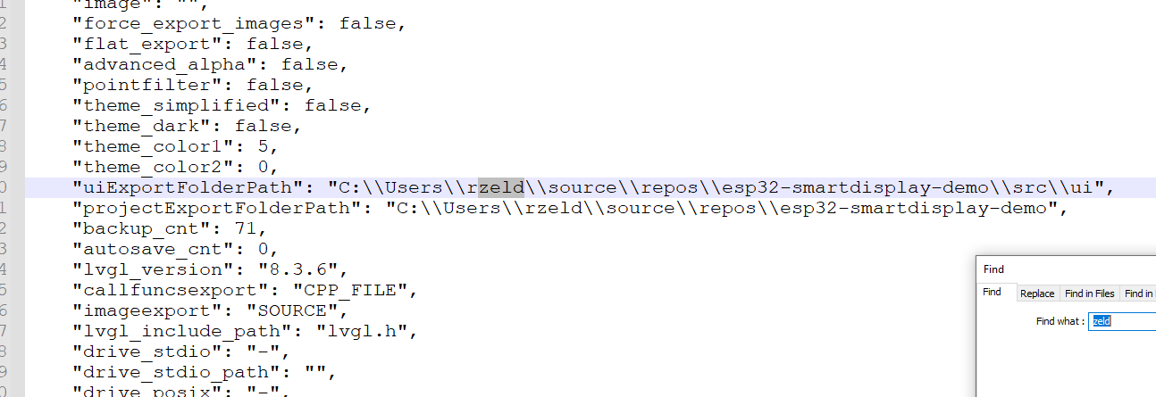

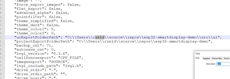

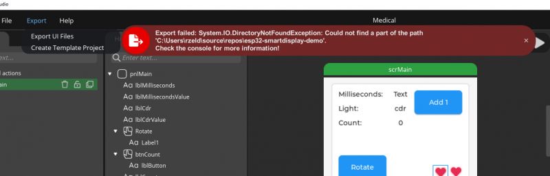

    Then you can save and export the project, but.... there is the problem again :
    What kind of path is this? It is not mine. The project remembers the path of the previous user. I opened the SPF file - indeed, it is sewn in here:
    I pasted the path there, which is appropriate for me (inside the PlatformIO project).

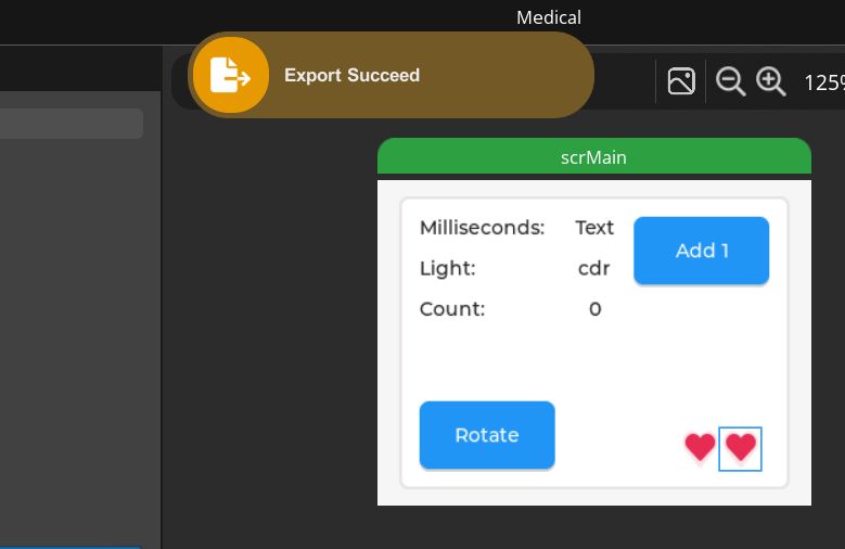

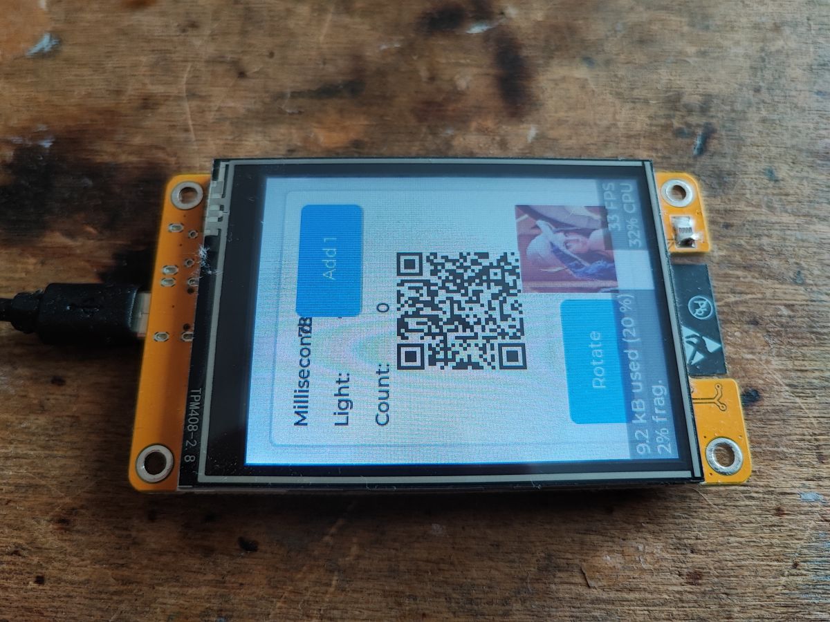

    The export was successful:
    An image appeared in our PlatformIO project:
    We compile and upload:
    It works! It's really simple, you have to give them credit for that much.

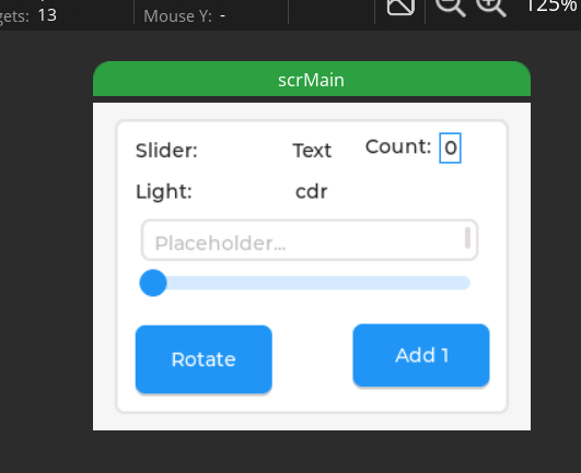

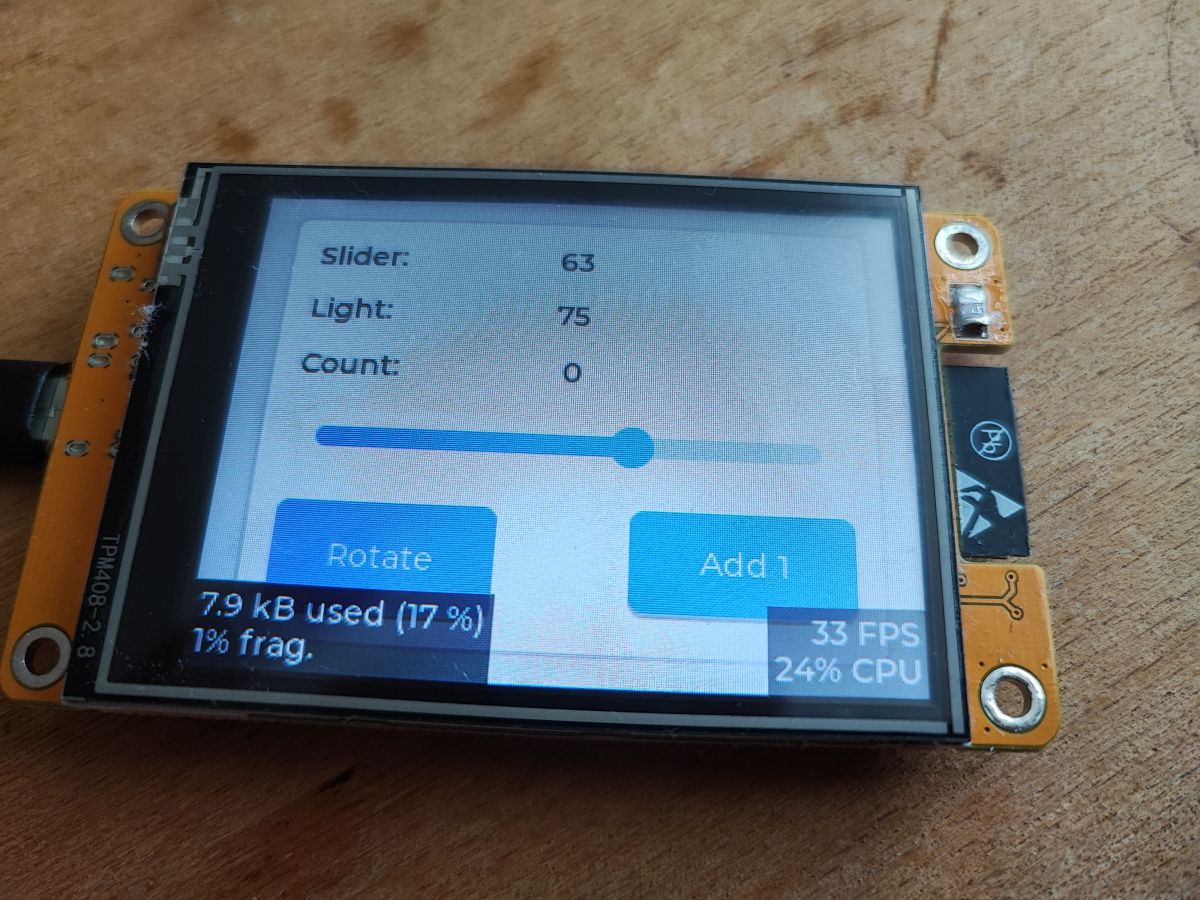

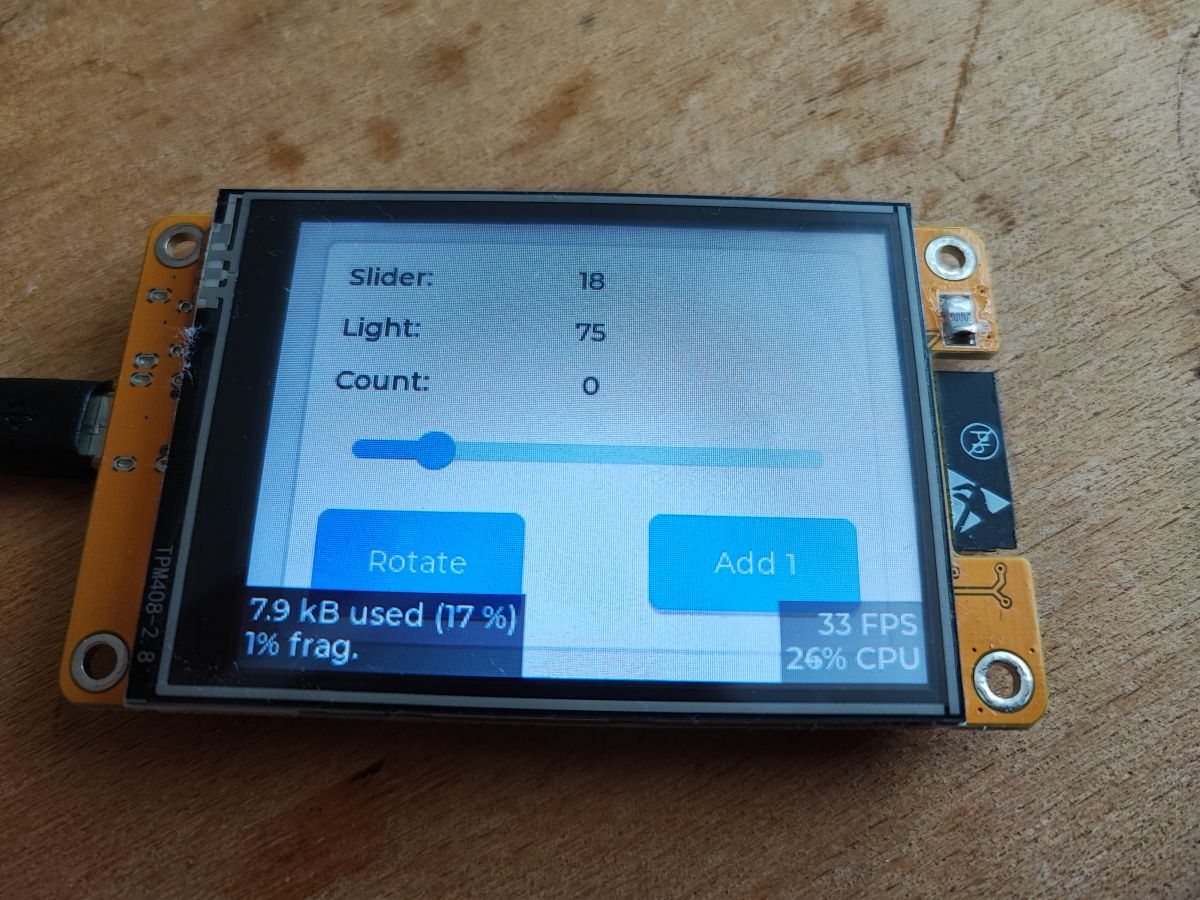

    Perhaps let's start with the slider element, or Slider. The slider can be 'grabbed' and moved, which has the effect of triggering its change event. Additionally, its values (current, min, max) can also be set and read.

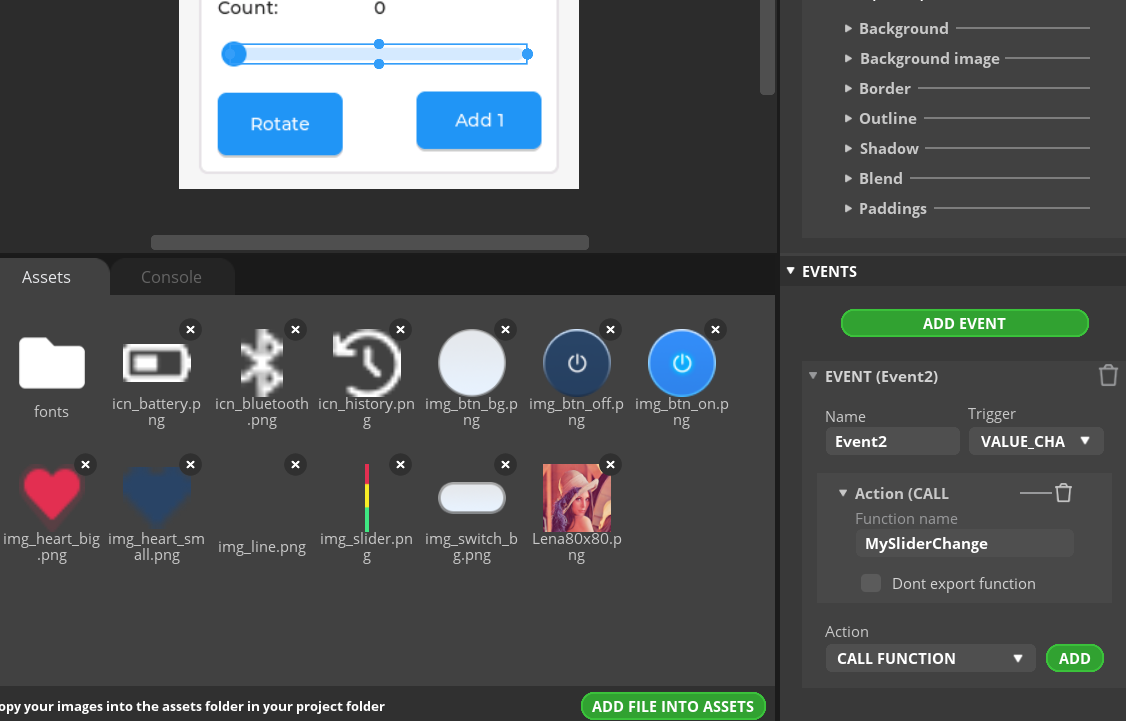

    Once the slider is selected, we can edit its parameters and add events. One of the possible events is "VALUE_CHANGED", which is a change of value. There we enter the name of our function to be called. The field "Don't export function" allows us to use an existing function, otherwise SquareLine Studio creates it.

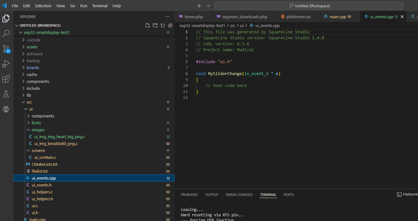

    We export...

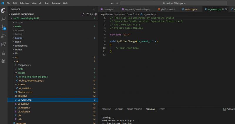

    Indeed, the function has been generated. We can add something to it. Maybe we could try displaying the value from the slider on one of the labels?
    Code: C / C++
    By the way, you can see a cool way to get an object from an event - lv_event_get_target ..
    The get and set functions are also described in the documentation. We upload and test:
    Our bar works:

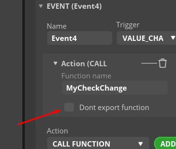

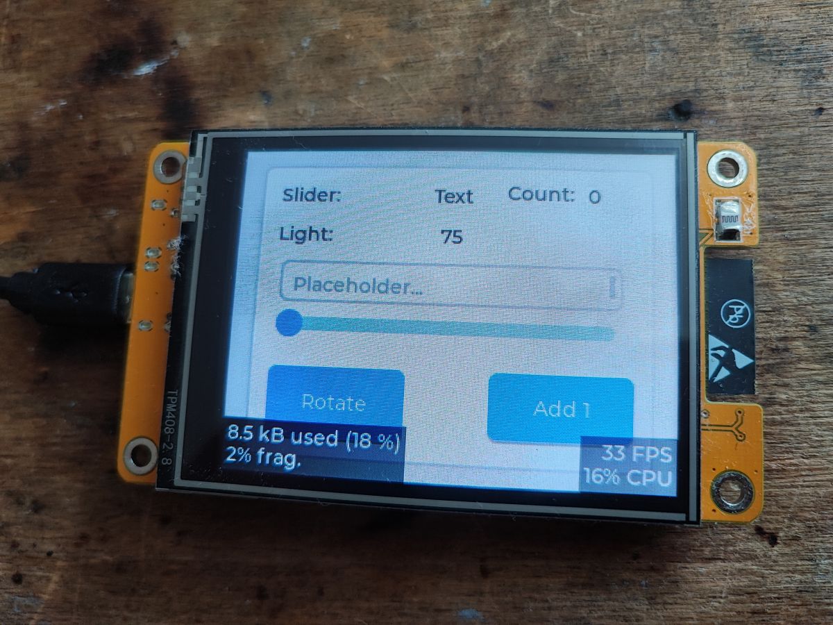

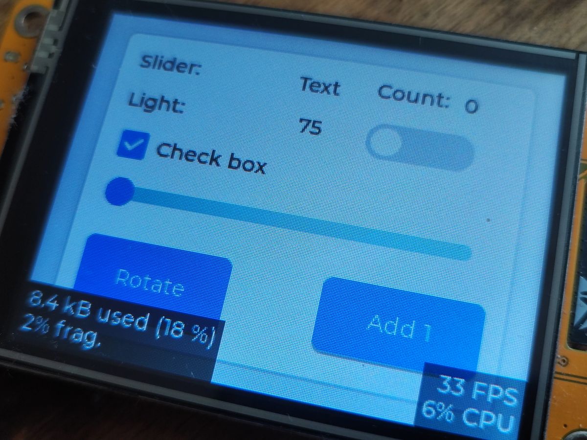

    Similarly, we have, for example, a checkbox component - a box to be ticked. We select it from the list and drag it into our view.

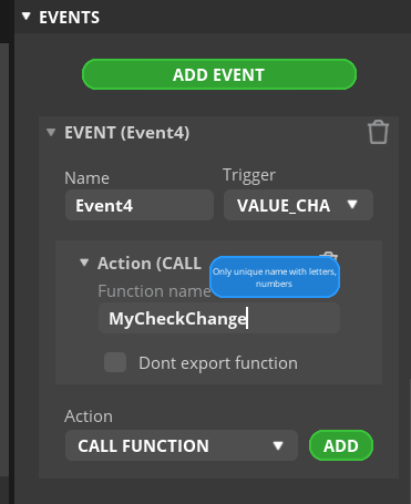

    We add a change event to it:
    Handle the event in code - just check the state of the object:
    Code: C / C++
    This is how it presents itself in practice:
    Clicking on a checkbox changes its status:
    [  8680][I][main.cpp:49] MyCheckChange(): Checkbox is checked
    [  9340][I][main.cpp:51] MyCheckChange(): Checkbox is unchecked
    [ 11110][I][main.cpp:49] MyCheckChange(): Checkbox is checked
    [ 11620][I][main.cpp:51] MyCheckChange(): Checkbox is unchecked

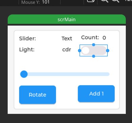

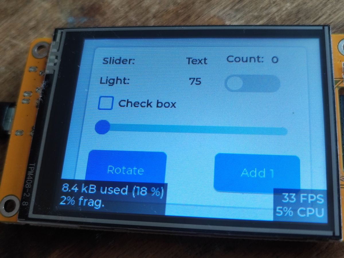

    Similarly, we have the Switch control - or switch. Here, too, there are two states. Similarly, we select it from the list:
    We add:

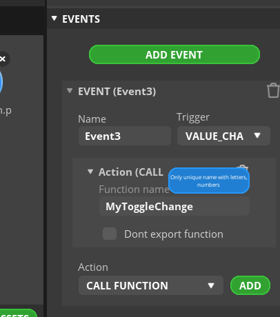

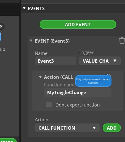

    We set the event:
    Similarly we add a function (change handler ) and test, it works:

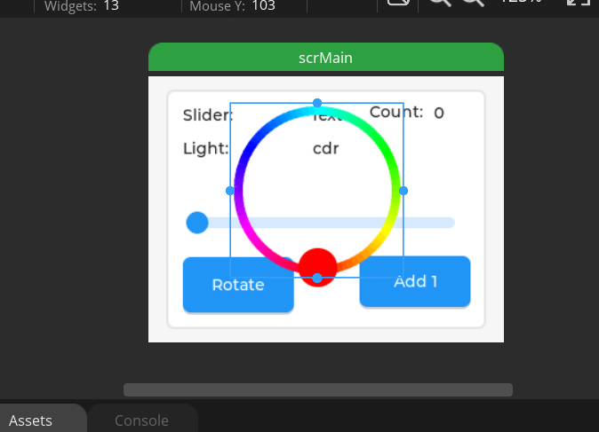

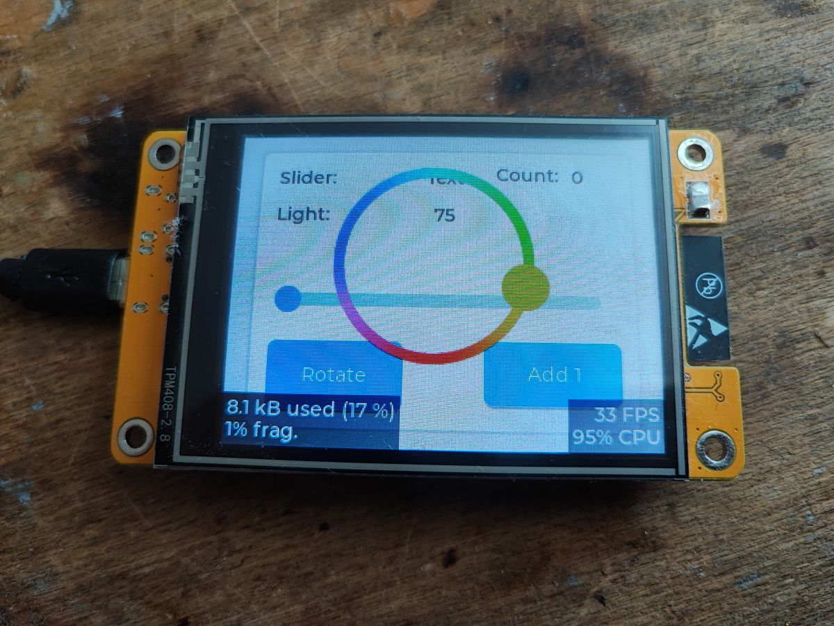

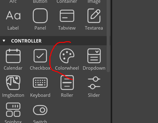

    Basics with basics, but there are more advanced controls here too. For example, there is colour selection:
    We drag it onto the screen:

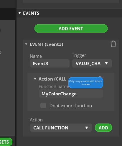

    As before, we add a state change event to it:

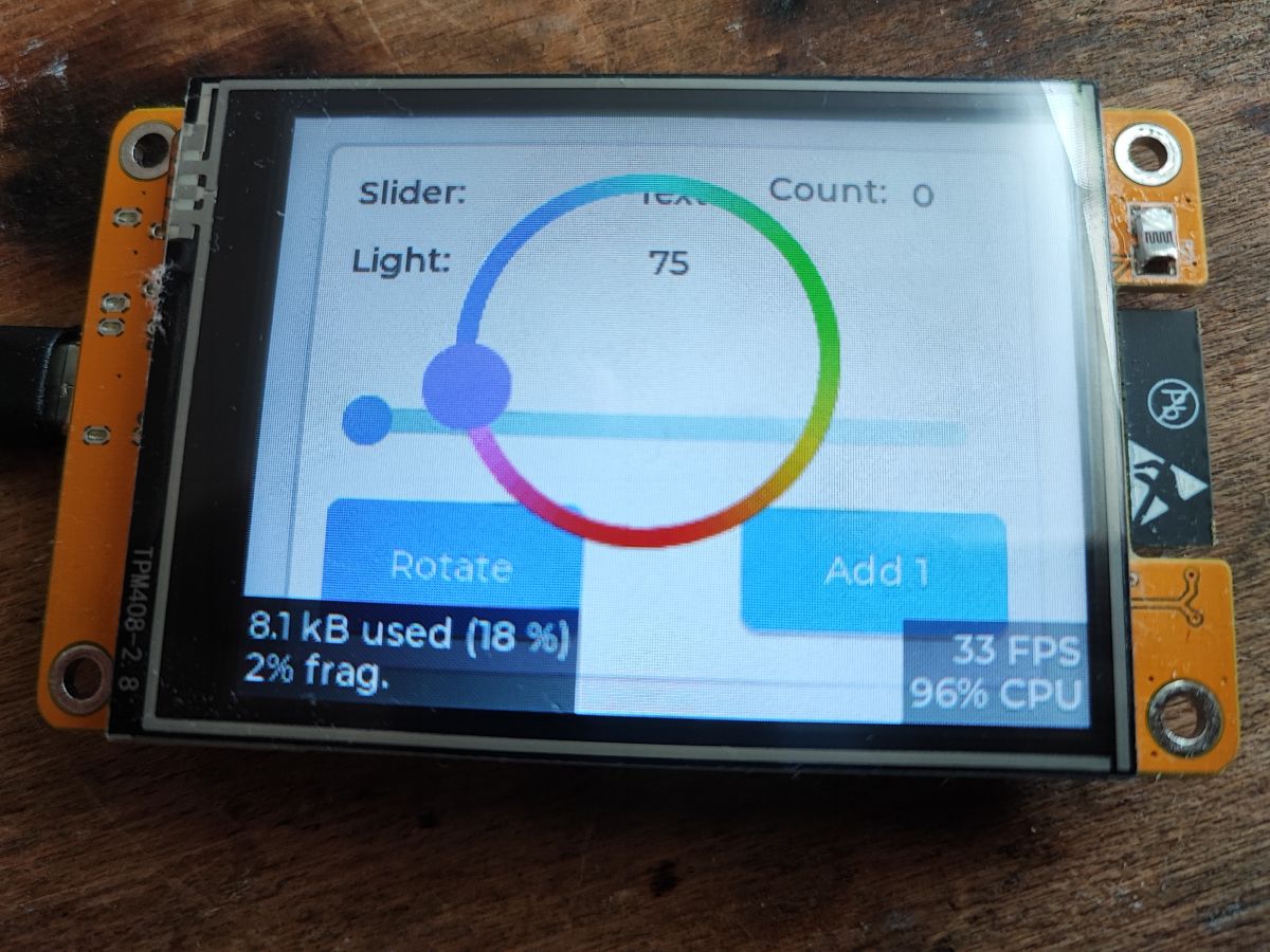

    As a test, I uploaded it as such to the display:
    Now you just need to think about how to receive the colour information. On this platform the colours are 16-bit, below is an insight into the union/structures from the header of the library used:
    Code: C / C++
    In our project we have LV_COLOR_16_SWAP defined as 1, so the green colour is split into two areas in memory. Taking this into account, I wrote a function that brings the colour values into the same range and displays them when the control changes:
    Code: C / C++
    Testing:
    [259878][I][main.cpp:41] MyColorChange(): Selected color: R=28, G=63, B=0
    [259960][I][main.cpp:41] MyColorChange(): Selected color: R=32, G=63, B=0
    [260041][I][main.cpp:41] MyColorChange(): Selected color: R=32, G=63, B=0
    [260092][I][main.cpp:41] MyColorChange(): Selected color: R=32, G=63, B=0
    [263961][I][main.cpp:41] MyColorChange(): Selected color: R=62, G=6, B=0
    [264012][I][main.cpp:41] MyColorChange(): Selected color: R=62, G=4, B=0
    [264071][I][main.cpp:41] MyColorChange(): Selected color: R=62, G=6, B=0
    The colours correspond to what the control shows, although I could still flip them to full bytes (to the range 0-255).
    Now perhaps something more interactive - a text field. Let's try simply adding it, dragging it into our view. The text field here is TextArea.
    We compile, here is the result:
    Unfortunately the keyboard doesn't show up on its own.... looks like this requires some additional configuration in the code though. A quick check of the documentation confirms my concerns:
    https://docs.lvgl.io/master/widgets/keyboard.html
    But about that another time...
    Finally a little tip .
    If you don't want the function called from the GUI to be created in the event file all the time then just tick:
    This way we can create it once in our code in another file and only use it.

    Here I have presented the basics of LVGL in combination with SquareLine Studio. LVGL offers a wide range of ready-made controls and mechanisms from which we can quickly create the UI of our project. SquareLine Studio offers a convenient, visual interface view editor for our application, which can then be exported directly into C code, which we compile at least in PlatformIO just like any other code we would write ourselves. SquareLine Studio even converts images to byte arrays in C files, and even with this there is no problem.
    Unfortunately, SquareLine Studio is only available for free in a truncated or 30-day version, and the price of the full version is rather out of reach for hobbyists. For this reason, in the following sections we will probably already be creating interfaces manually, i.e. we will simply be writing code ourselves in the style of what we suspected today.

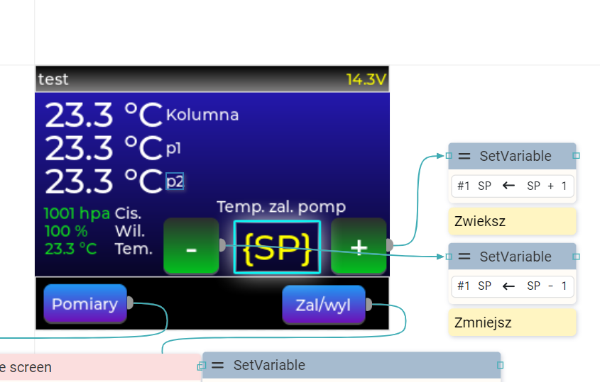

    Very interesting suggestion, I will definitely test it out:
    https://forum.lvgl.io/t/free-and-open-source-eez-studio/12954

    A couple of observations like this:
    1. I'm testing both SquareLine Studio and EEZ Studio and unfortunately (I don't know why) but EEZ Studio generated code that exceeded the ESP32 memory !!!, and by just one screen.
    2. EEZ Studio looks quite interesting after all.
    3. SquareLine Studio is missing e.g. the alignment function to elements, now you have to position manually.
    4. LVGL is working on a new editor (but it is supposed to be official in a year !!) .
    5. it shows me that I have a "supposed" activation until 2038. , of course free of charge.
