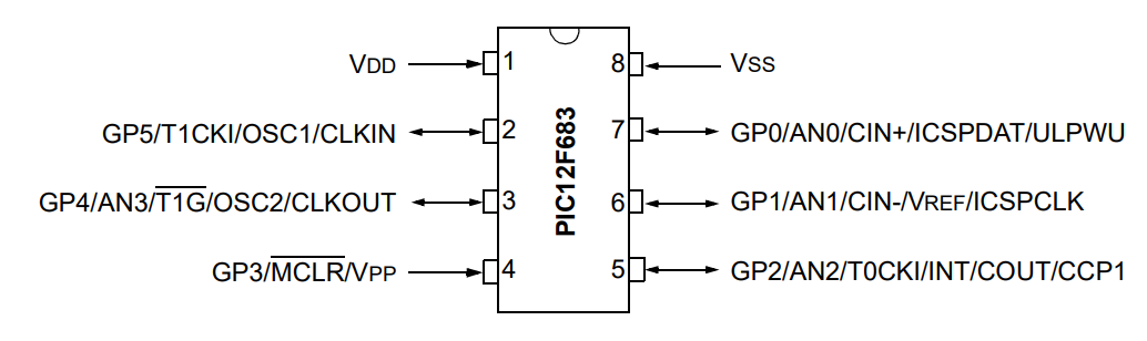

    Selected MCU and programmer connection .

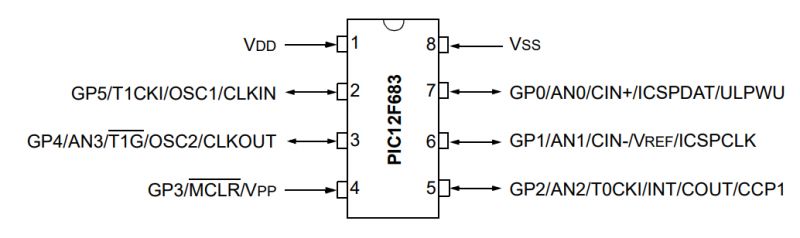

    This time the choice was the PIC12F683 - a small 8-bit MCU in a DIP08 chassis running on 5V, offering 6 GPIOs, 2048 Flash words, 128 SRAM bytes and 256 EEPROM bytes.
    Pin diagram of the PIC12F683 microcontroller .
    It is programmed in a similar way to the PIC18F2550. I just happened to have a PICKIT2 on hand, although it could also be a clone:

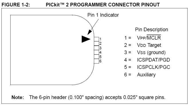

    The MCLR, power supply, PGD and PGC need to be connected:
    Diagram of the pinout for PICkit 2 programmer. .

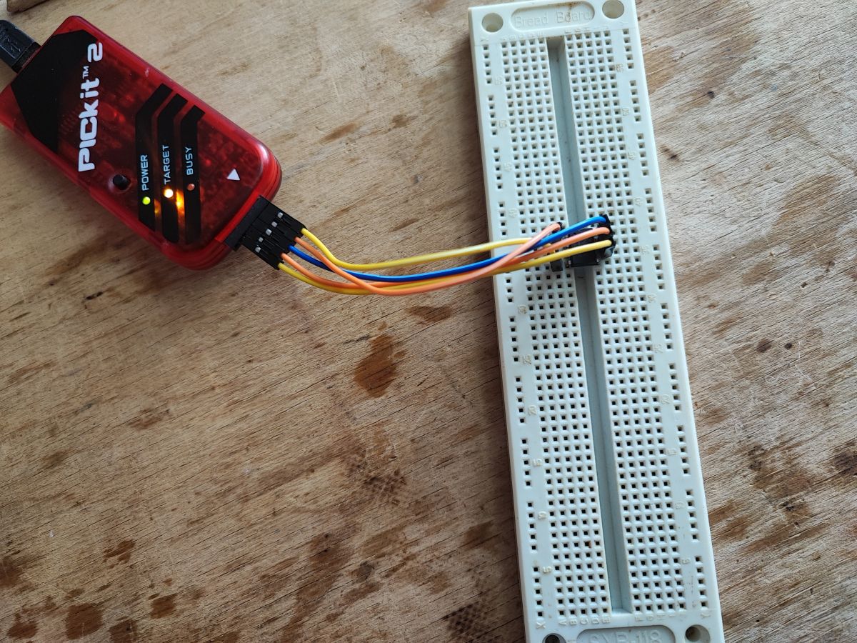

    Completed connection:
    PICKIT2 programmer connected to a breadboard. .

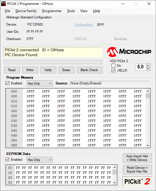

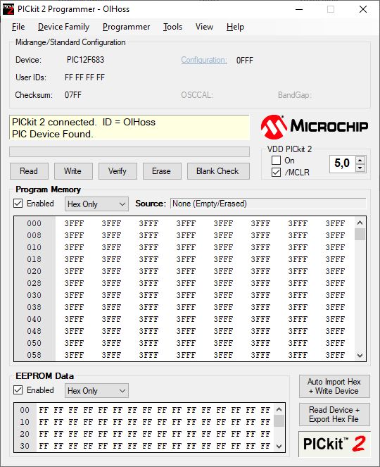

    At first I ran the PICKIT2 program but the programmer was not seen - it turned out to be the culprit mouse , which I had to rewire to another USB port. Then it just started up:
    PICKIT 2 software interface with connected PIC12F683 chip. .
    Minimum connection required .

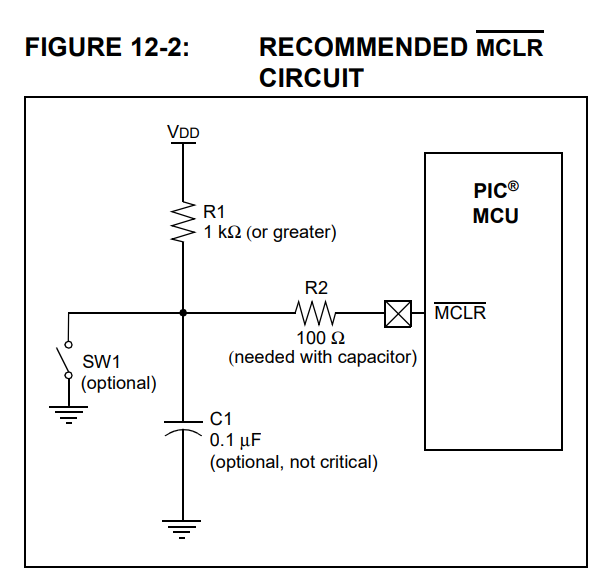

    The programmer already sees the PIC, but did we forget something? Definitely about power supply decoupling - some 100nF ceramic capacitor between ground and power supply is useful. Without it, the MCU can operate unstably and unpredictably. But that's not all:
    Recommended MCLR circuit diagram for PIC microcontroller. .
    You still need a 1k (or larger) resistor on the MCLR (a.k.a. RESET) pin. Without this, the PIC will not start, although the programmer will see it.

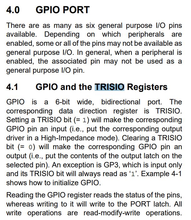

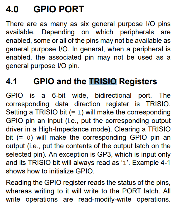

    We look at the datasheet - here we do not have separate A, B, etc. ports like in the PIC18F2550, so there is no TRIS, TRISB, etc. register.
    There is simply TRISIO and GPIO:
    Excerpt from documentation on GPIO port and TRISIO registers. .

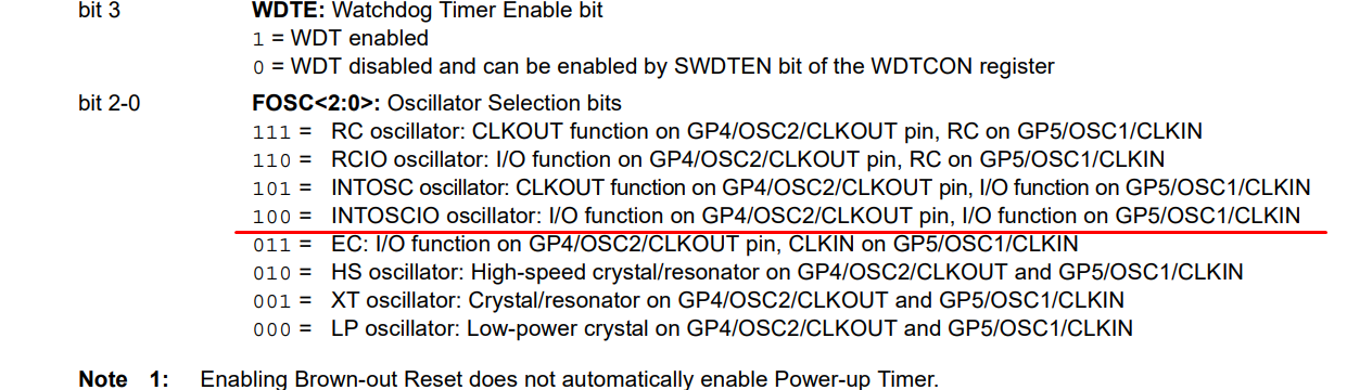

    A lit bit in TRISIO makes that pin an input, while a turned off bit means an output. So we want to write zeros there. And then we're going to manipulate the GPIO register to sequentially set the low and high states on the pins.

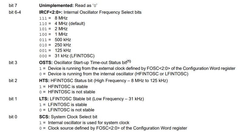

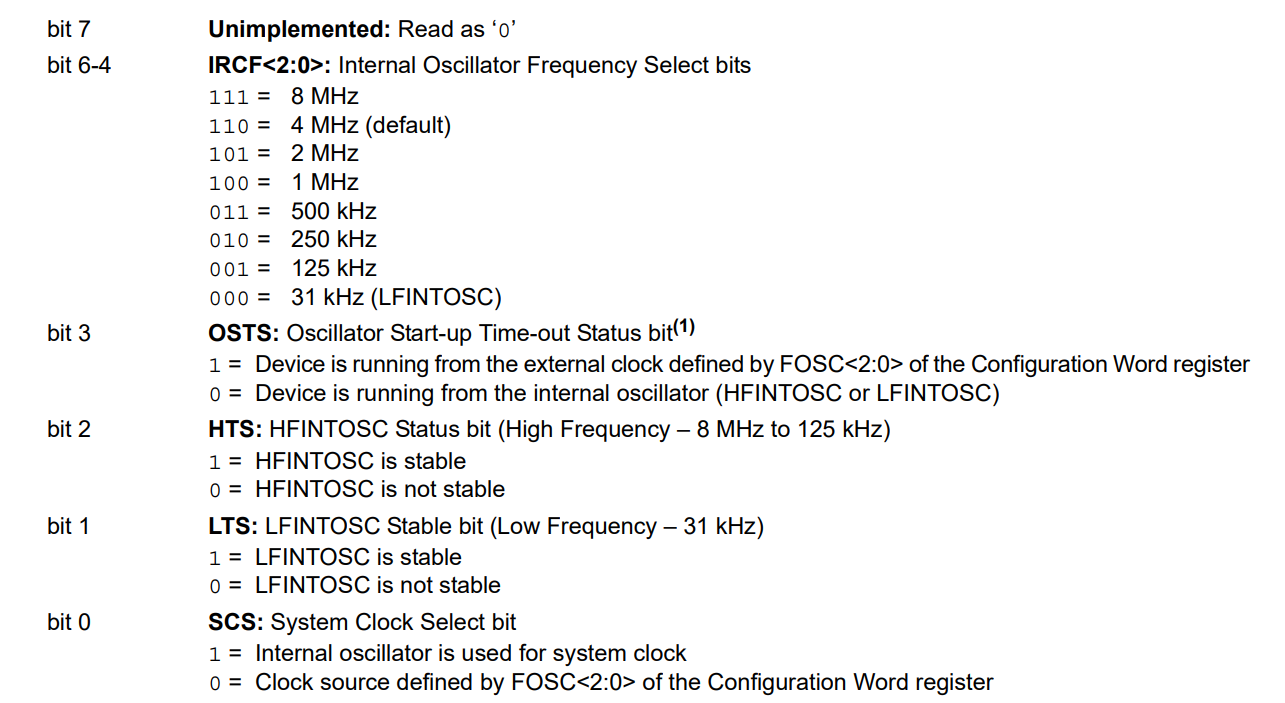

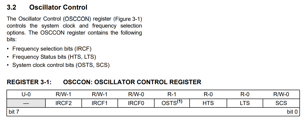

    We still need to configure the internal oscillator - we don't need an external one. This is again the responsibility of OSCCON:
    Table showing the oscillator control register in a microcontroller. .
    Internal oscillator settings table for PIC12F683. .
    As a test, I entered 0x71 there, which is binary 0b01110001 - looking above this is the 8MHz IRFC and enabled Internal oscillator is used for system clock .
    Code: C / C++

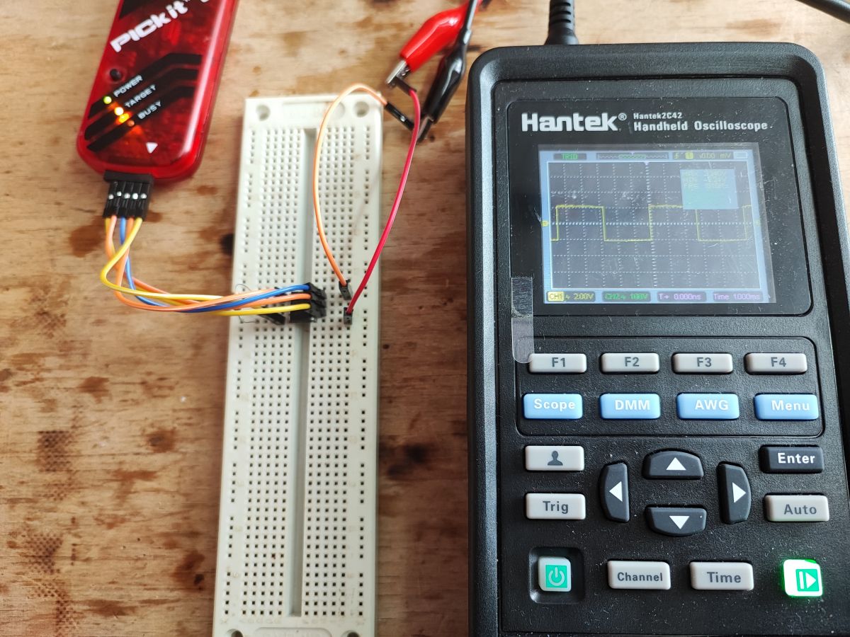

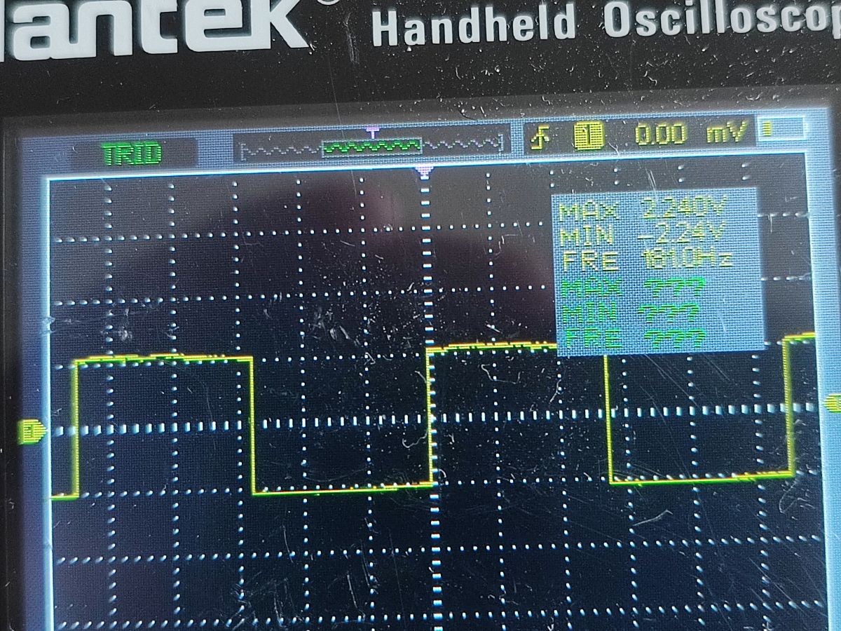

    I connected an oscilloscope to the GPIO to check that the program works:
    Top view of a handheld Hantek oscilloscope and a breadboard with prototype connections.
    181Hz - meaning something is blinking, but fast. I'm not going to correct it here though.
    Oscilloscope displaying PWM signal at 1810 Hz frequency .

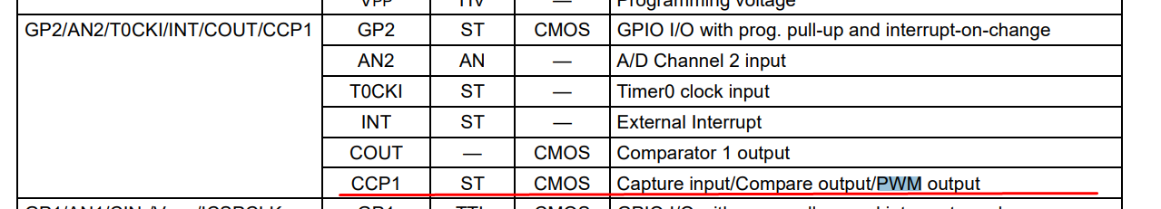

    In this PIC, the PWM can only have an output to one selected pin:
    Excerpt from the PIC12F683 microcontroller datasheet with a description of the GP2 pin functions. .

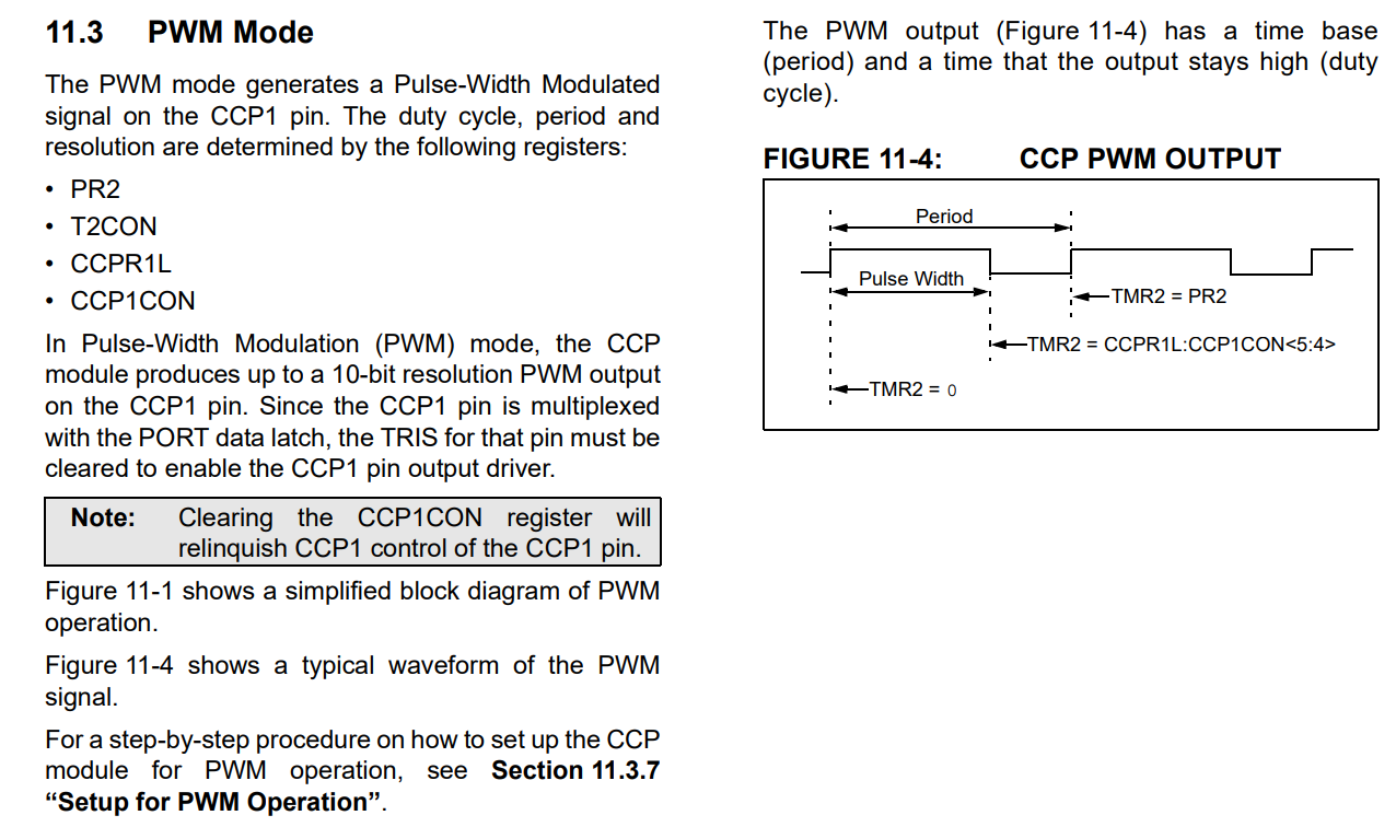

    Refer to the relevant section of the datasheet note:
    Documentation excerpt about PWM mode for PIC. .
    A lot of these registers are... PR2, T2CON, CCPR1L, CCP1CON.... AND let's not forget to set the output mode for the PWM pin on the TRISIO.
    Contrary to what you might think, however, this is not that difficult.
    PR2 is basically the number of clock cycles (after using the prescaler/postscaler) that determines the PWM frequency.
    CCPR1L is the number of cycles in which the signal is in the high state (followed by a switch to the low state). So if we have PR2 = 40 and we want a fill of 50% then CCPR1L is set to 20, and if we want a fill of 75% then CCPR1L should be 30.

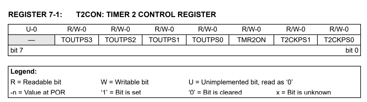

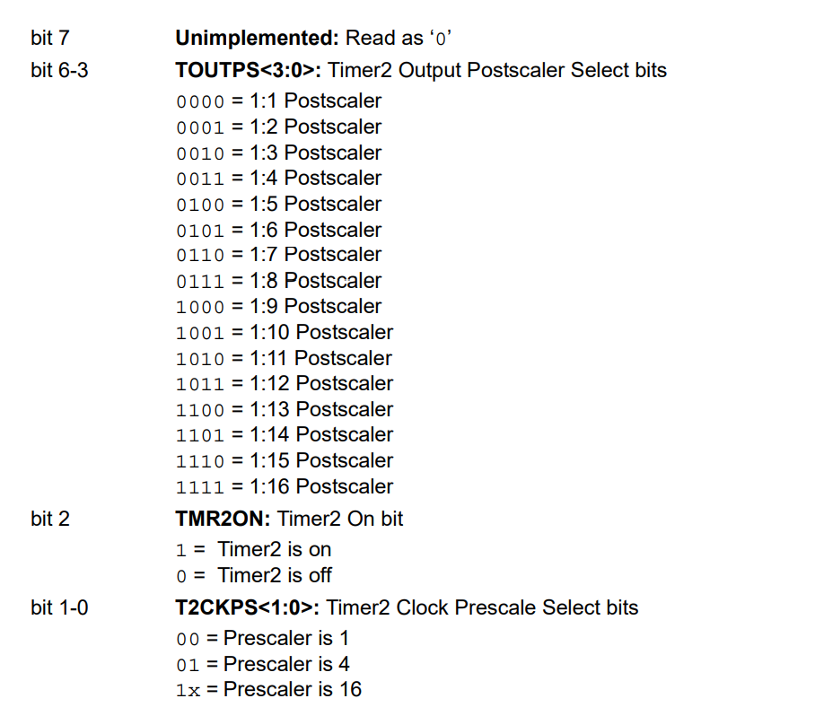

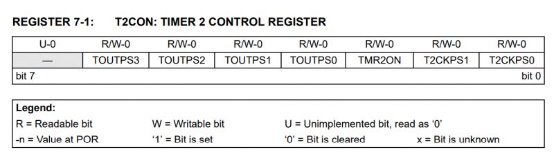

    That leaves T2CON:
    Table showing the T2CON register of the PIC12F683 microcontroller. .
    Excerpt from a datasheet on configuring Timer2 in PIC .

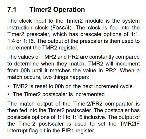

    In T2CON, we set the poscaler and prescaler and switch on the timer. This timer (timer 2) will be used by the PWM. One more question is what these "scalers" scale. - Their input is the main clock of the Fosc/4:
    Fragment of documentation explaining Timer2 operation for PIC. .
    That is, we have to select the prescaler/postscaler so that we can then select the PR2 value corresponding to 1kHz .

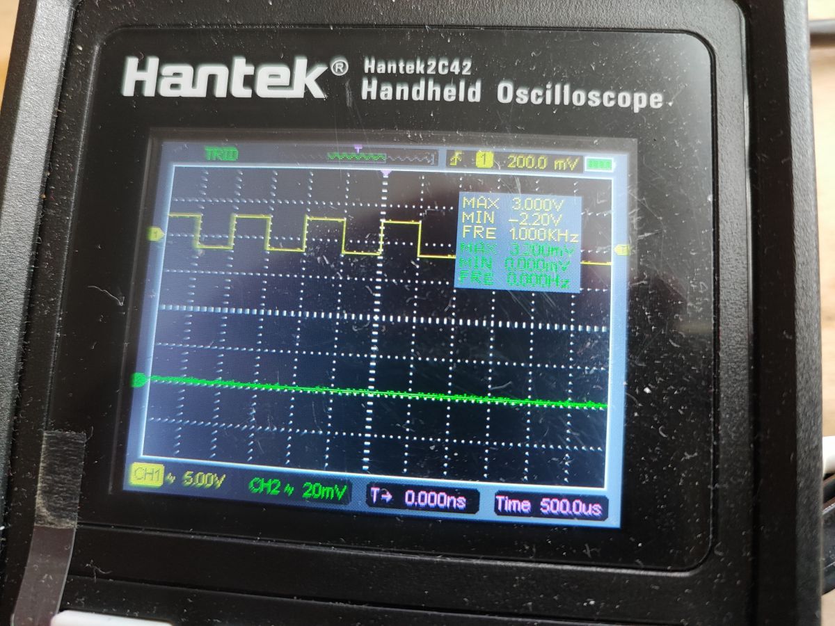

    Since Fosc is 4MHz, then Fosc/4 is 1MHz. A frequency of 1MHz corresponds to a period of 0.001ms. If we use a 1:4 prescaler:
    Code: C / C++
    This then increases Timer2 by 1 every 0.004ms.
    To how many then must we count Timer2 to have 1kHz?
    1kHz is a period of 1ms.
    1ms divided by 0.004ms gives us 250.
    0xFA is 250, so we need to enter 0xFA into PR2.
    That still leaves CCPR1L - there we will enter 0 to 0xFA to vary the signal fill.

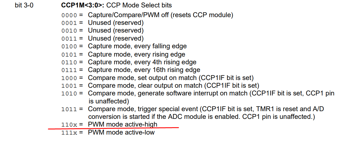

    So much for the most important configuration, but we still have CCP1CON. There we will fortunately not count anything anymore:
    Fragment of technical documentation regarding the CCP1 mode configuration in a microcontroller. .
    We enter 0b00001100 to enable the PWM in active-high mode (if we want to invert the signal, we can enter 0b1110.
    All code:
    Code: C / C++
    Beautiful 1kHz:

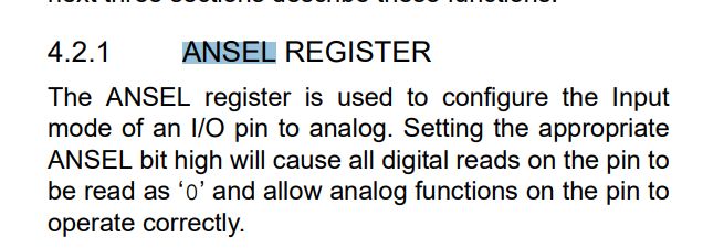

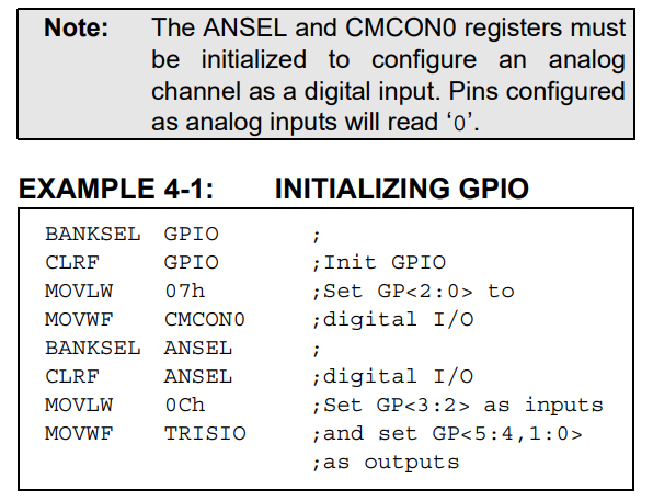

    Now you still need to be able to change the fill of this PWM. As I have already written, this boils down to changing the value of CCPR1L from 0 to PR2+1. For convenience, I have decided to implement this using two buttons.
    To activate the button, you need to:
    - make sure that the ADC/comparator roles are disabled
    - set the corresponding bit of the TRIS register to 1
    Information from the datasheet note:
    Example of GPIO initialization with assembly instructions. .
    If we forget, all digital read operations will return zero!
    Screenshot showing the description of the ANSEL register from a datasheet. .
    Then you can read the state of the button via e.g. the GP1 bit for GPIO 1. There are no separate ports here!

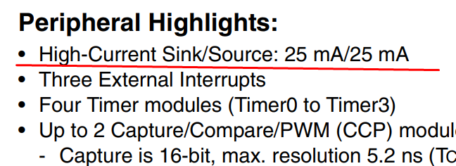

    Unfortunately, we cannot connect the LED strip directly to the GPIO of the microcontroller. It's far too low current capability doesn't allow us to do so - we could light one LED from the GPIO (with a current limiting resistor), but there's not enough current for the whole strip. See the datasheet note for details, for example for the PIC18F2550:
    Screenshot of technical documentation highlighting peripheral specifications. .
    25mA is not enough, we want from 1A-2A, so some kind of transistor will be useful. Preferably a MOSFET, as such is voltage controlled.

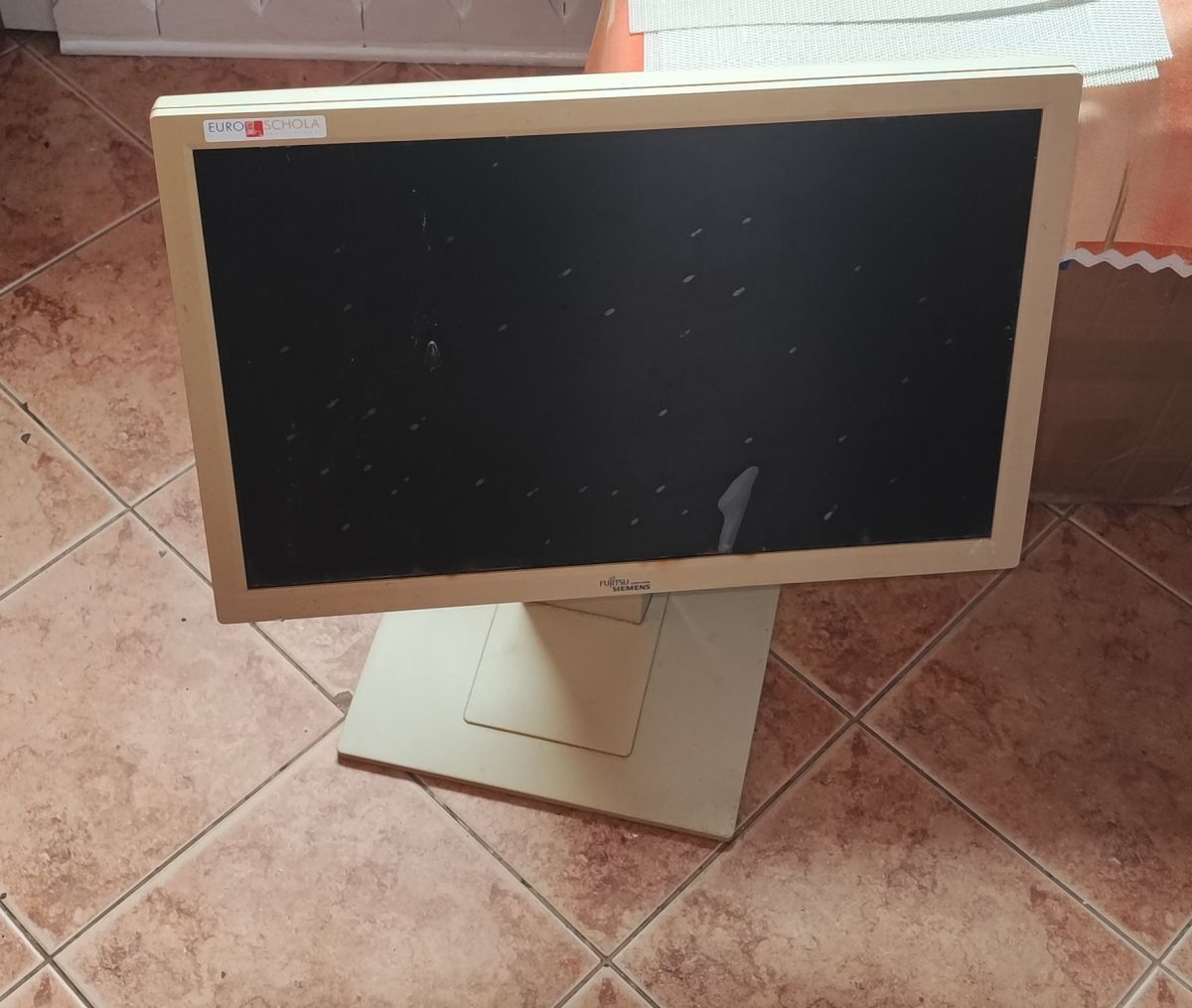

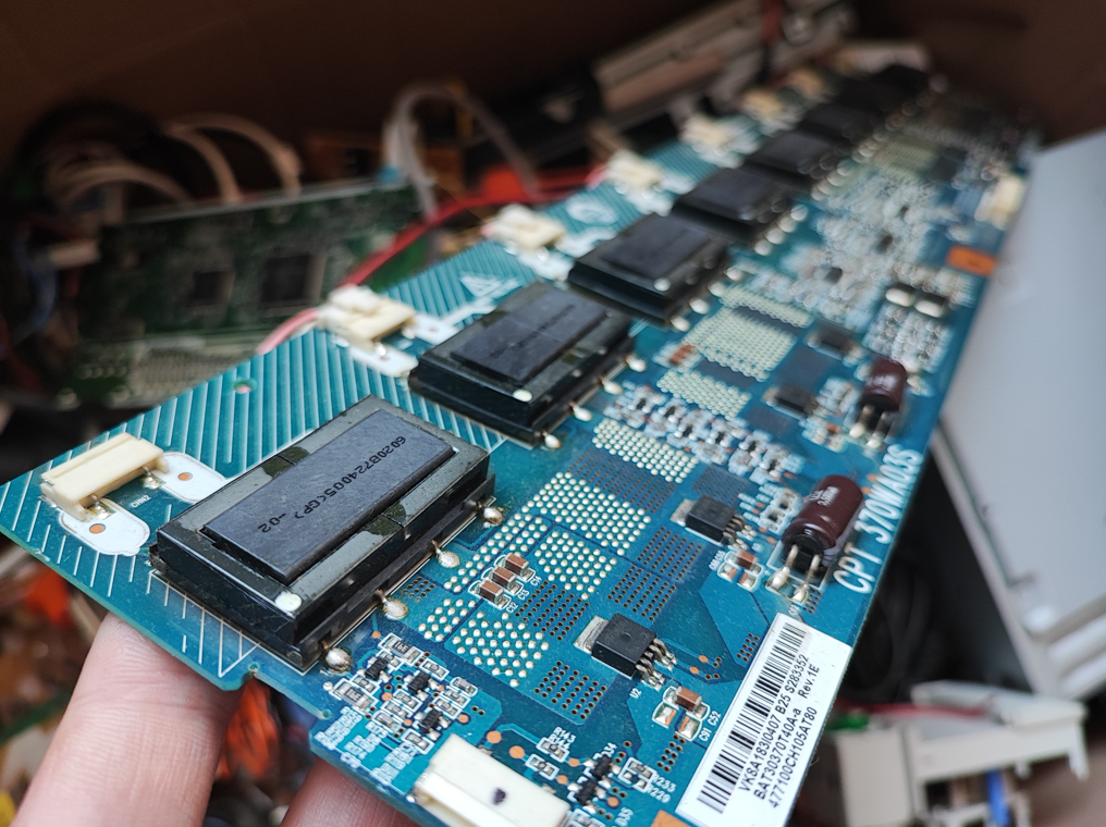

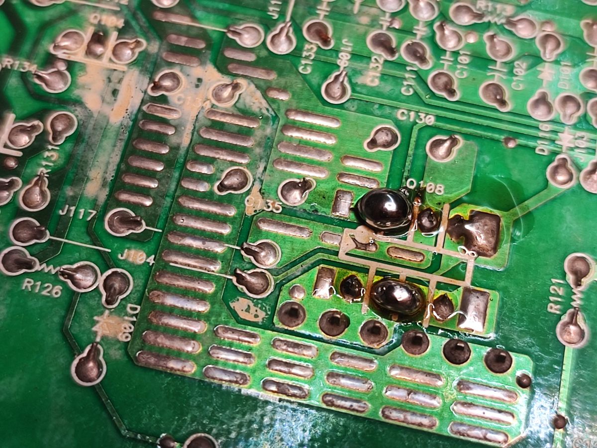

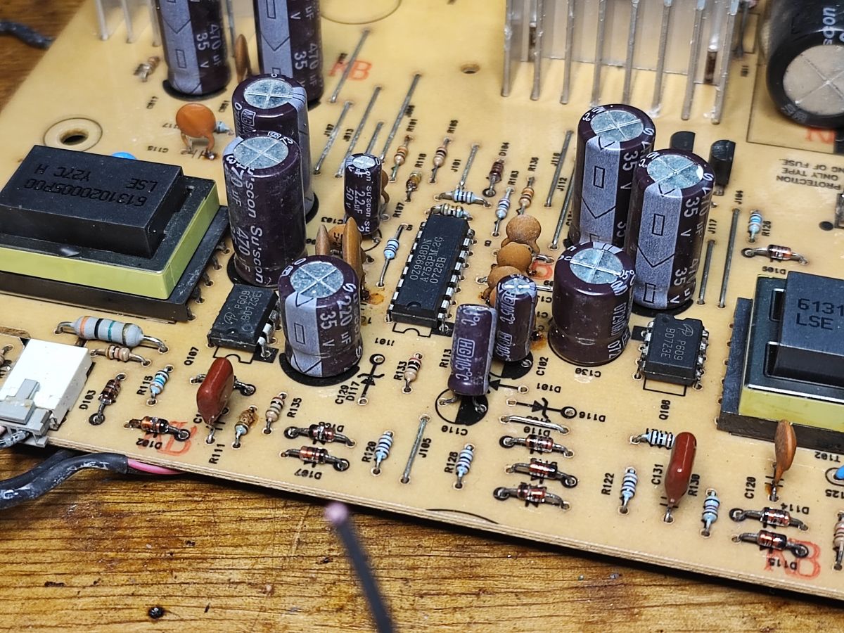

    I sometimes scrap equipment for this purpose:
    Old Fujitsu Siemens computer monitor on the floor. .

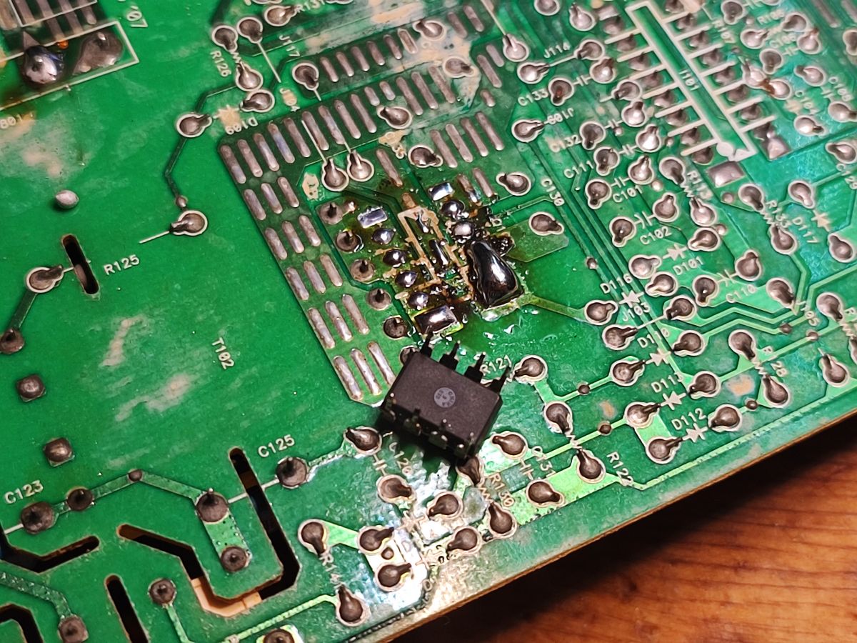

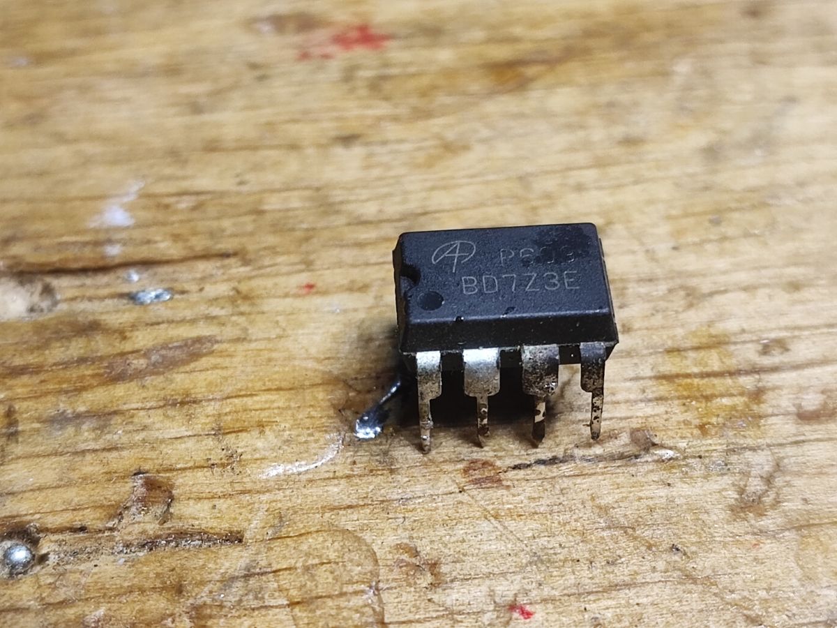

    I found two interesting pairs of MOSFETs in the inverter circuit feeding the fluorescent lights of this monitor:
    Electronic circuit board with various components, including capacitors and resistors. .
    They are controlled by an OZ9938DN.

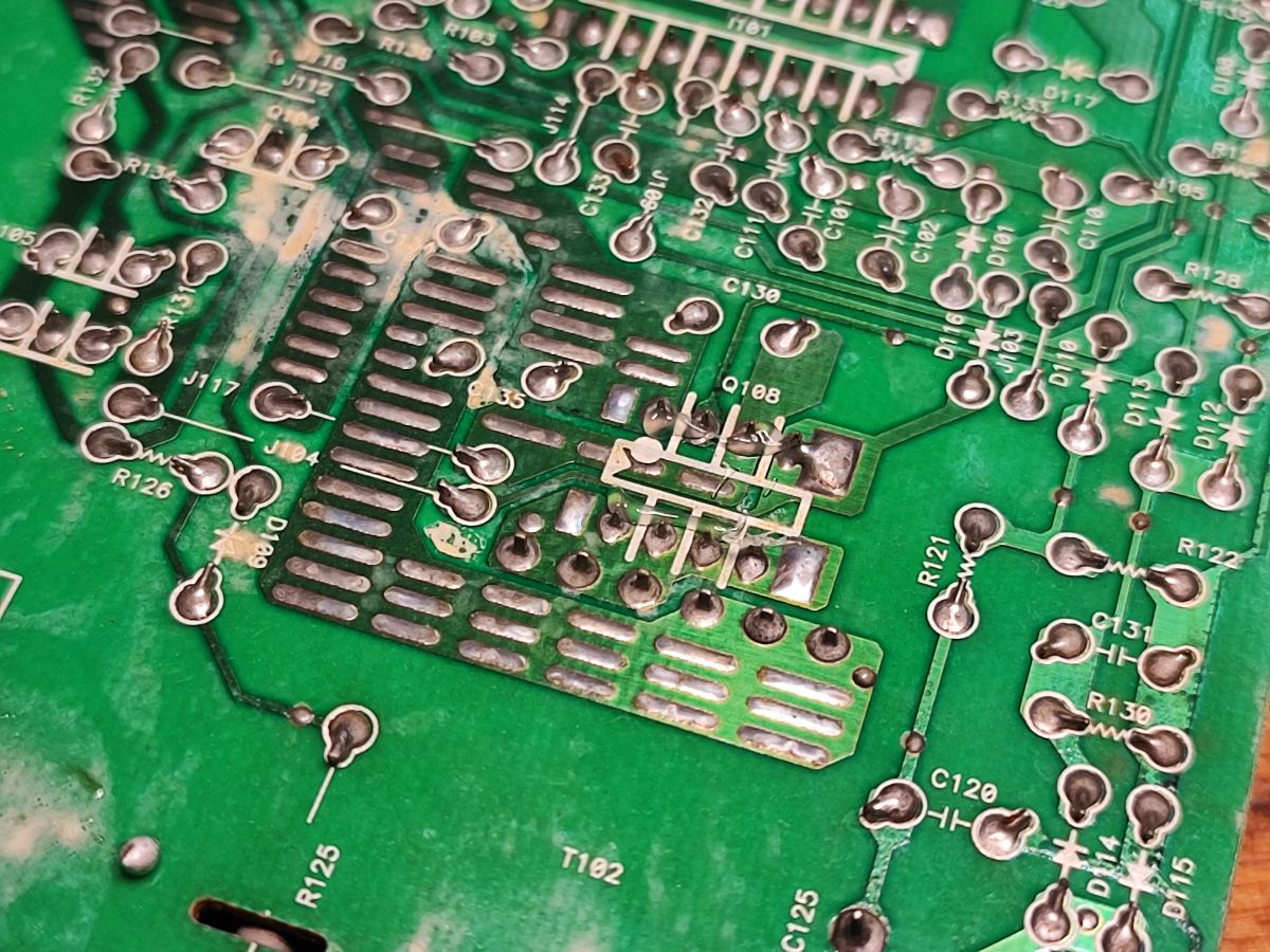

    All in DIP housings. A bit of flux and solder on the pins, and the circuits fall off the board by themselves:
    Close-up of an old circuit board with soldered electronic components Close-up of a circuit board with electronic components and solder residue Close-up of a circuit board with a soldered integrated circuit. Close-up of BD723E integrated circuit on a wooden surface .

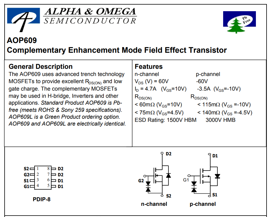

    This is the AOP609 - two MOSFETs in one housing, N and P. Complementary pair:
    AOP609 transistor datasheet with technical specifications. .

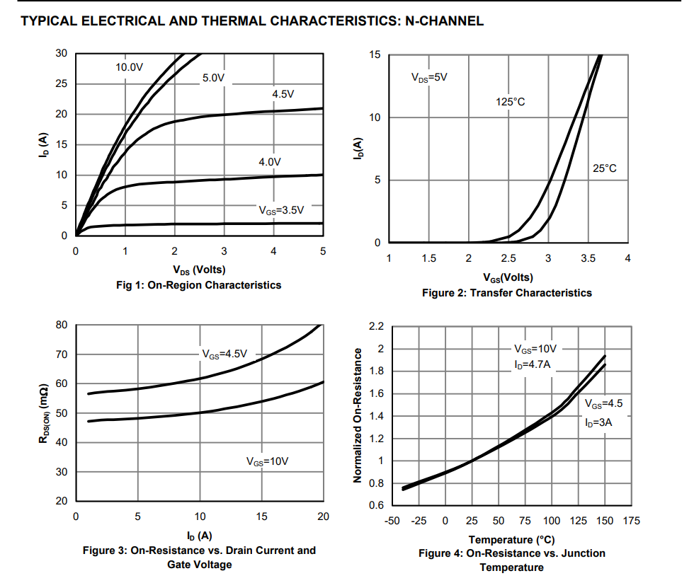

    I will only use one of them, the one with the N-type channel. Its parameters look promising, RDS(on) (resistance in conduction state) for Vgs (gate-source voltage) 4.5V is supposed to be less than 75mΩ, but here it is still worth looking at the characteristics:
    <span class="notranslate">Electrical and thermal characteristics of N-channel transistor .
    It looks like this MOSFET will fit - 5V from the PIC will be able to drive it. Not every MOSFET would be suitable for this.

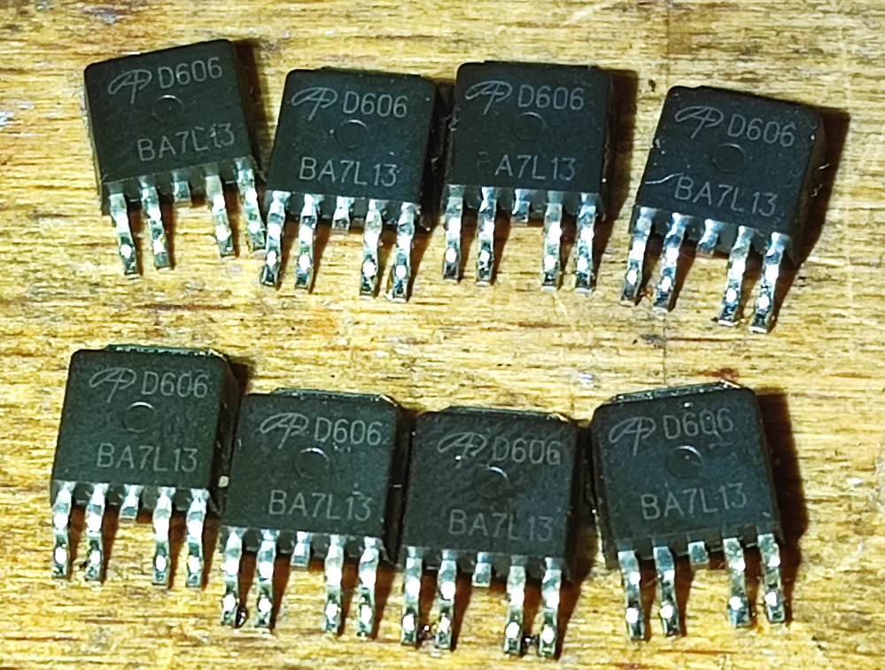

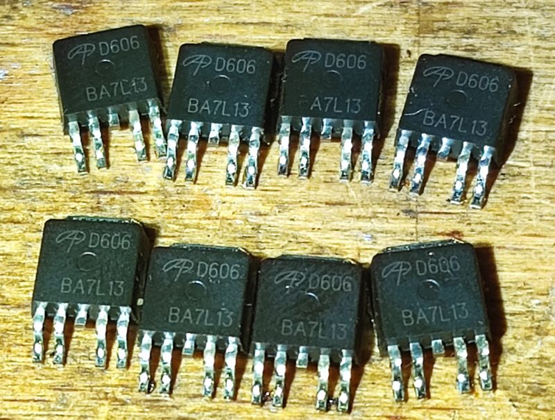

    By the way, there are a lot of cool MOSFETs like this on the TV PCB:
    Circuit board with electronic components including capacitors and transistors. .
    Here I recovered as many as 8 D606s!
    Seven D606 transistors with BA7L13 markings on a wooden background.

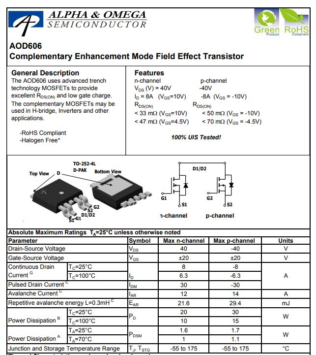

    AOD606, again a complementary pair but with slightly better heat dissipation:
    Datasheet of AOD606 transistor featuring specifications and diagrams. .

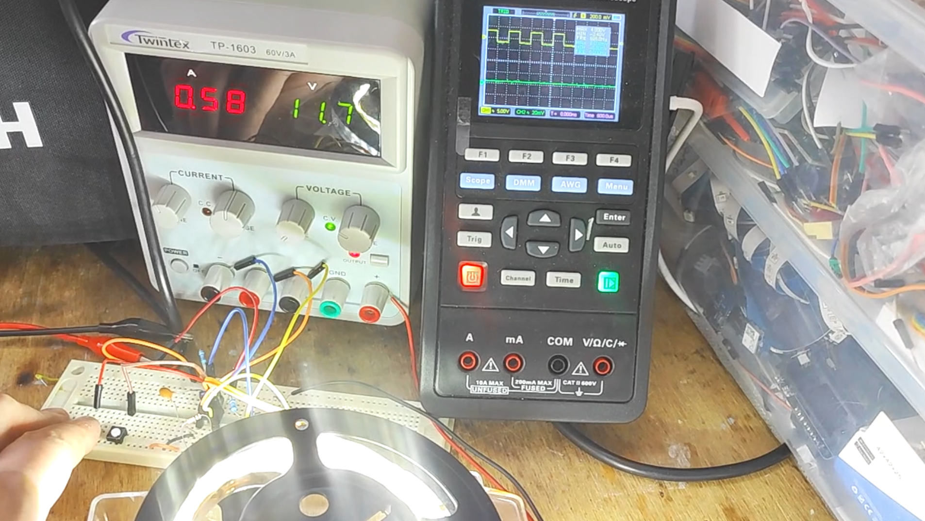

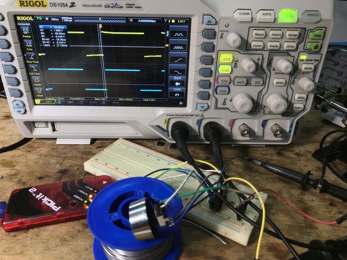

    Test with oscilloscope .
    I put everything together to test - I connected the MOSFET source to ground, the gate to the signal output via a 1k resistor, and connected an LED strip between the drain and 12V+. I ran this with a lab power supply, the waveform is shown on an oscilloscope for reference:
    You can see very nicely here how the brightness of the bar changes with the signal fill.

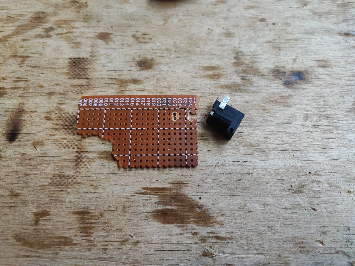

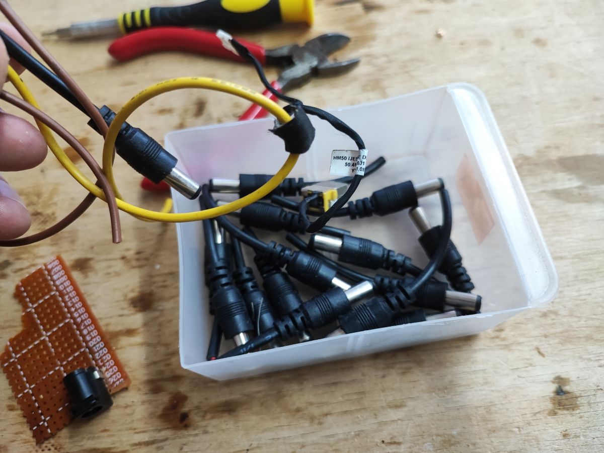

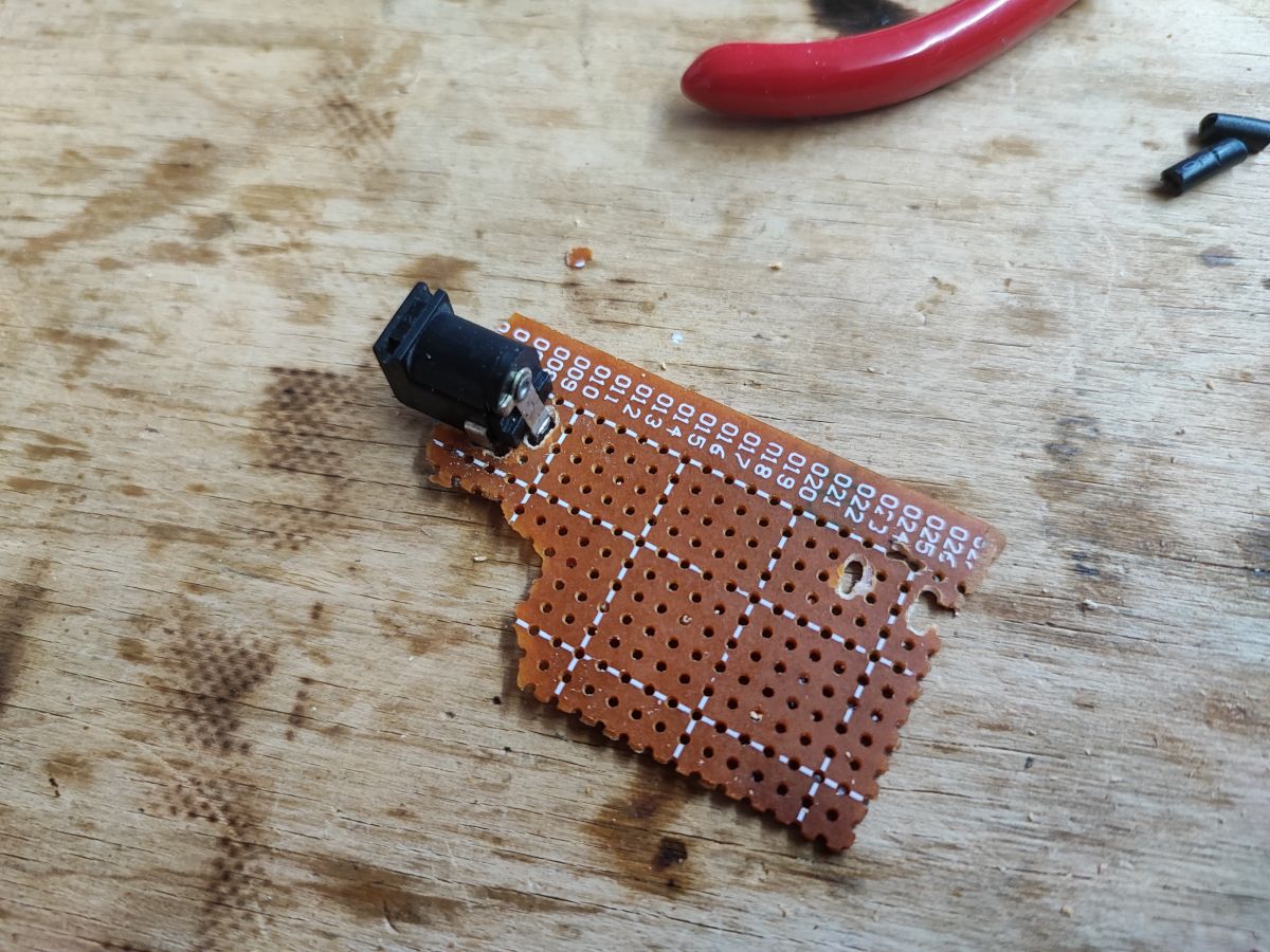

    I use a ready-made single-sided drilled board to quickly assemble the prototype. It is comfortable to solder on, but you have to lower the temperature of the soldering tip a bit and use flux, otherwise the pads fall off quickly after overheating.
    Perforated prototype board and DC jack connector on a wooden table. .
    I found a bag of DC jack terminals discarded by some company the other day, one of these will be as good as found:
    Box of DC power connectors on a workshop table. .
    Folding:
    Prototype circuit board with mounted DC jack .

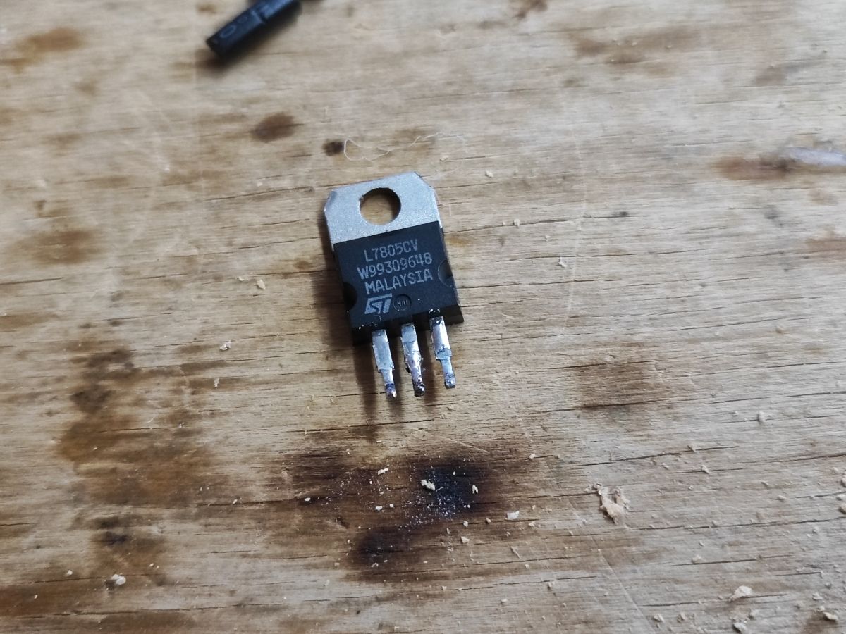

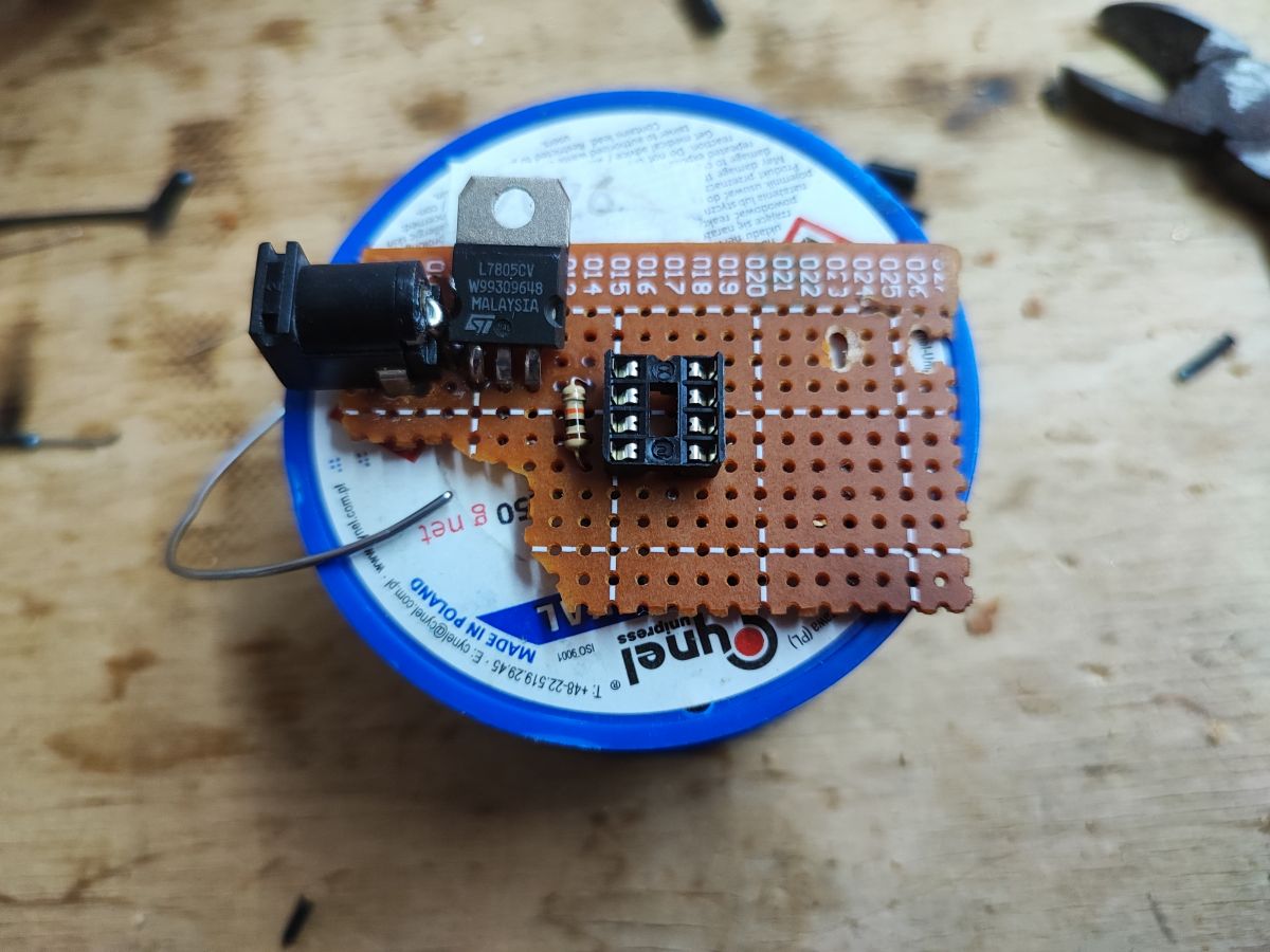

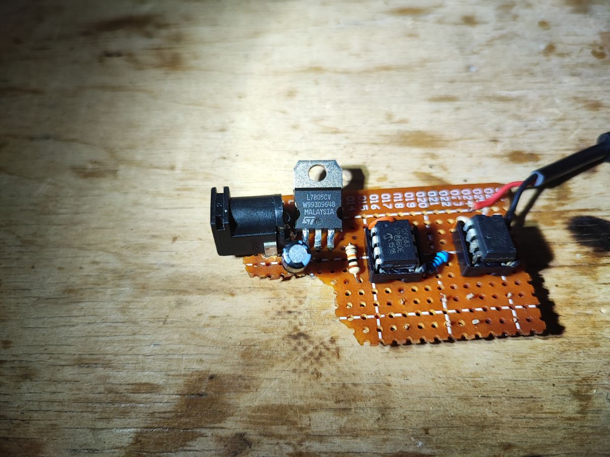

    The PIC requires 5V and the strip is powered by 12V, so a 7805 will come in handy, from electrical junk of course:
    L7805CV voltage regulator on a wooden surface .
    Progress:
    Prototype of a LED dimmer on a perforated board with power supply. .

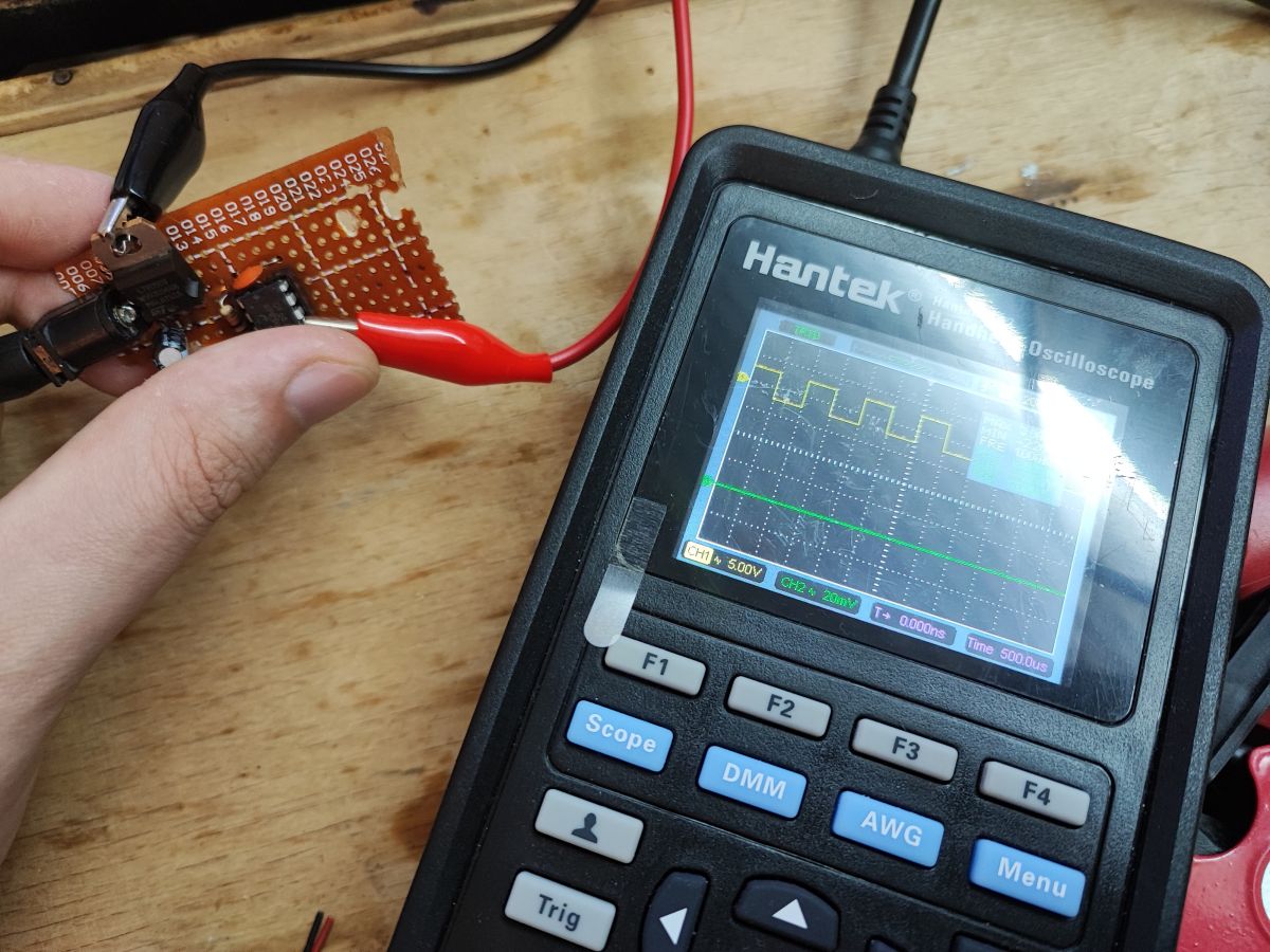

    Test, you can also see the capacitors added (essential for stable operation, literally without that 100nF I could see my MCU resetting):
    Hantek oscilloscope displaying a PWM signal next to a circuit prototype on a board. .

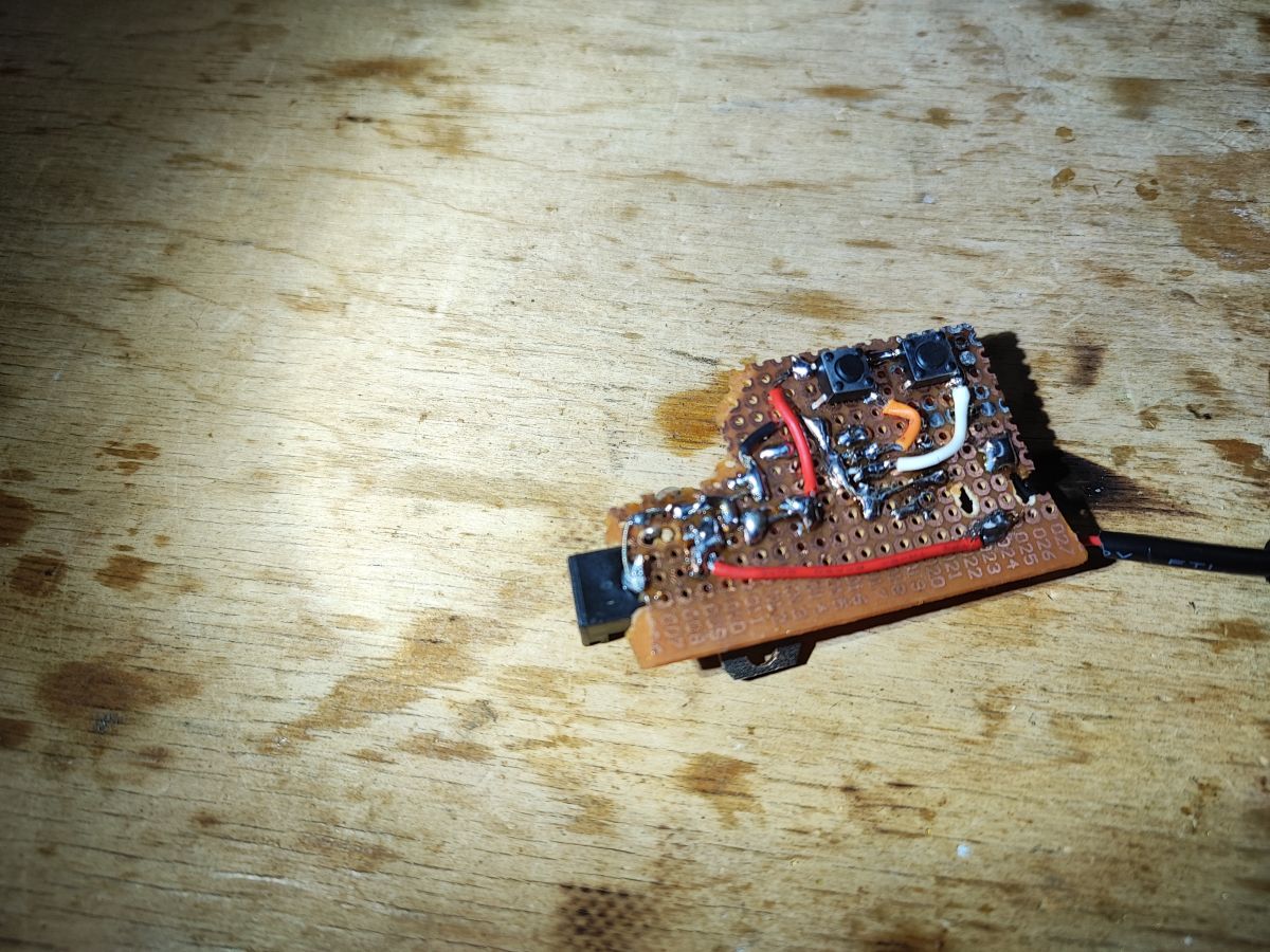

    Added buttons and barely visible SMD pull-down resistors from buttons:
    Prototype LED dimmer on a perforated board with two buttons and soldered wires.
    Final test .
    The MOSFET used is quite weak compared to other strip controllers, but I only needed to handle 2-3 metres of LEDs taking up to 2A in total. A full-day test showed that at full load the MOSFET is only slightly warm. It looks like it will perform well in its role.

    - a more powerful MOSFET could be given
    - solder, etc.. - you know
    - you could make better use of this PIC because basically it doesn't do much now but I wanted to come up with something as part of a practical tutorial....
    Interiors of factory LED controllers .
    If you want to see, on the other hand, what the dimmers available on the market look like, I have already described them in several topics. It is also worth checking what MOSFETs are inside - this is covered in the topics:

    Things that can be improved:
    1. the modules configuration code should be in a separate function, called in the main loop once, it's nicer that way.
    2. After configuring the oscillator, add: while(~HTS); to make the program wait for the oscillator to stabilise.
    3. Use timer and interrupts for debouncing and button handling . Bad practice should be avoided, one of which is the overuse of any empty loops to waste time.
    4. it's worth measuring the current draw behind the 7805. you may be able to replace it with a Zener diode and resistor or a TL431, which you'll find in many switching power supplies.
    Why aren't you using an XC8?
  • Explains skipping debounce and timer reduction points

    In principle, the remarks are right, although I skipped point 3, as I am trying to create simplified mini-projects/tutorials, and the introduction of buttons with debouncing on the timer is basically a matter for a completely separate topic, also to be discussed nicely. However, if we were talking about a "complete" project, such a final one, then point 3 should be applied.
    As for point 4, it would also help to reduce the timer, by the way, I have already tested the current consumption with different ones, it was in the topic:

    Measurement 1 - current draw at 31 kHz internal oscillator: .
    Program: p18f2550_pinSwitch_intOsc31kHz.c
    Measurement:
    PIC12F683 and SDCC - tutorial - how to create a simple dimmer (and read datasheets) .
    Measurement 2 - current draw with internal 1MHz oscillator: .
    Program: p18f2550_pinSwitch_intOsc1MHz.c
    Measurement:
    It is possible that according to your comments I will make a "better" version of this dimmer, although for now I was thinking to take the same PIC in the next part and also try to start charlieplexing the LEDs from 0 and make a dice, Either on 6 LEDs or on a single digit 7-segment display.

  • Zener shunt regulator wastes constant power
    #7 21208041
    acctr
    Posts: 4554
    Help: 389
    Rate: 2021
    I will try replacing the 7805 with a Zener diode as @Urgon rightly advised
    Why the mushroom? A completely misguided idea.
    For such a primitive stabiliser to do its job, the same current must always flow into the circuit, equal to the maximum current drawn by the circuit downstream of the stabiliser, at an equal DZ voltage.
    And constant current and constant voltage means constant power losses. Solutions found in communist-era poor equipment.
  • Zener or TL431 better than 7805 for microamp loads
    #8 21208102
    Urgon
    Posts: 7281
    Help: 197
    Rate: 2632
    AVE...
    @acctr
    As usual you demonstrate your ignorance. It makes no sense to use a 7805 family stabilizer for a circuit that draws a few mA at most. As the circuit draws several microamperes, the 7805 may not even stabilize properly. A Zener diode or TL431 in this situation will be a better solution. Plus, the loss power will be the same whether you are wiping out 7V on the stabiliser circuit or on the circuit with the Zener diode. The microcontroller itself will accept voltages from perhaps 2.8V to 5.5V, so a Zener diode with a 50uA polarisation current will pass the test very well....
    BTW, in a circuit that draws ~1.6uA I used a TPS7A02175 stabiliser so that the circuit would have a stable supply from 1.8V to 5.5V. The scaler works from zero microamperes, drawing 25nA for itself....
  • #9 21209313

    @Urgon , what PICs are you programming exactly? I ask because from my subjective experience it's not so bad:
    - I managed to get JDM working on an old PC, 100% DIY of course:
    JDM by DL4HF - not programming any of the ds* series .
    - A PICKIT2 clone is also easy to make (once you have programmed the PIC18F2550 or have a friend to do it):
    A simple PICKIT2 clone (USB PIC programmer) from readily available components .
    PIC/AVR programmer on USB including coasters
    - PICKIT2 has a device editor which allows you to add new chips:
    https://sites.google.com/site/pk2devicefileeditor/ thanks to this my PICKIT2 has embraced the PIC16F1459 with USB:
    PIC16F1459 runtime board with USB .
    - PICKIT2 ( but important - in a version of logic levels 3.3V, so original, or reworked accordingly ) also embraces PIC32 thanks to pic32prog : PIC32MZ USB runner board with programmer and drawer (see paragraph "Mini-programmer from board - base concept")
    - in addition, the PICKIT2 and PICKIT3 clones are relatively cheap, probably PLN60 each (I ended up buying both anyway)
    That was basically enough for me, admittedly there is no debugger, but I manage without that as well.

  • PIC12F683 issues when powered from programmer
    #16 21209869
    Urgon
    Posts: 7281
    Help: 197
    Rate: 2632
    AVE...
    The problems in question are related to the situation when the microcontroller is powered from the programmer, it is also possible that it is the hardware version of the programmer itself...
    The PIC18F45K50, on the other hand, has never caused me any problems. Once I even loaded it with Pinguino firmware, the Arduino for PICs. At the moment, however, I prefer to use the XC8, and I am strongly annoyed by Microchip's policy of pushing their Harmony software platform by force. I understand the idea of using an extra layer of abstraction and ready-made libraries to support hardware on 16- and 32-bit chips, but for eight-biters it's an unnecessary complication, and the solution itself is uncomfortable and unintuitive. It's a shame, because their bootloader is a nice thing, but without Harmony it's impossible to add it....
  • Low-quiescent regulator recommended over 7805 or zener
    #17 21210322
    acctr
    Posts: 4554
    Help: 389
    Rate: 2021
    Urgon wrote:
    There is no point in using a 7805 family stabiliser for a circuit that draws a few mA at most. As the circuit draws several microamps, the 7805 may not even stabilise properly.
    The electronicist is based on facts, i.e. real properties of electronic components, not imaginary properties, which are just your invention here.
    The 78xx stabilisers require no such thing as a minimum output current and work well at zero output current. This is evident from the datasheet but also from the knowledge of stabiliser construction and simply from logic.
    Urgon wrote:
    A Zener diode or TL431 in this situation will be a better solution. Plus, the loss power will be the same whether you are wiping out 7V on the stabilizer circuit or on the circuit with the Zener diode.
    They may be better for you, but the facts say otherwise.
    It consists of poor dynamic resistance of Zener diodes, high power losses, the need for modifications when changing the circuit, high value of decoupling capacitance especially in pulsed circuits, large time constant means long vcc rise, which mcu do not like.
    The mcu output alone at 5V and 25mA is a 200 ohm resistance. To limit the current to 5mA at 5V from 12V you need a resistance of 1400 ohms.
    In short using such a stabiliser is pushing yourself into problems. If you're playing Greta and fighting for every uW then don't write this kind of crap because just spreading and rectifying it generates a bigger carbon footprint, bigger than the operation of this crap stabiliser on the DZ.
    More pertinent advice here is to use a stabiliser with low quiescent current capability, if this PWM regulator is somehow supposed to be particularly energy efficient.
  • Configuring GP4 and GP5 as outputs on PIC12F683
    #18 21288162
    Posts: 14699
    Help: 656
    Rate: 12744
    Today I was playing around further with the PIC12F683 and needed to run another GPIO, namely:
    - GP4/OSC2/CLKOUT
    - GP5/OSC1/CLKIN
    Both in output mode. In the default configuration, however, they don't work, only the catalogue note clarified the situation:
    Fragment of technical documentation for PIC12F683 regarding oscillator configuration. .
    In the CONFIG: CONFIGURATION WORD REGISTER
    I entered this in SDCC via the keyword __code - here is the full blinker code on all gpio:
    Code: C / C++
    Maybe someone will find it useful.

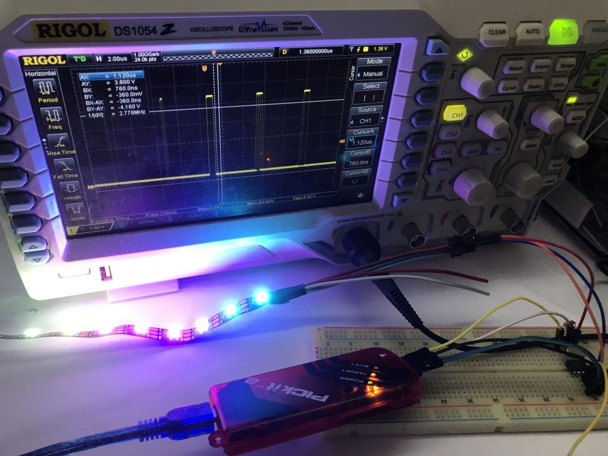

    I dusted off my little PIC and am preparing another DIY, this time with an encoder:
    Rigol DS1054Z oscilloscope connected to encoder and microcontroller on breadboard
    I'm also experimenting with how much the WS2812 can handle on these 128 bytes of RAM:
    WS2812 LED strip connected to a breadboard and analyzed with Rigol DS1054Z oscilloscope
    Details soon on the forum - in separate topics.
