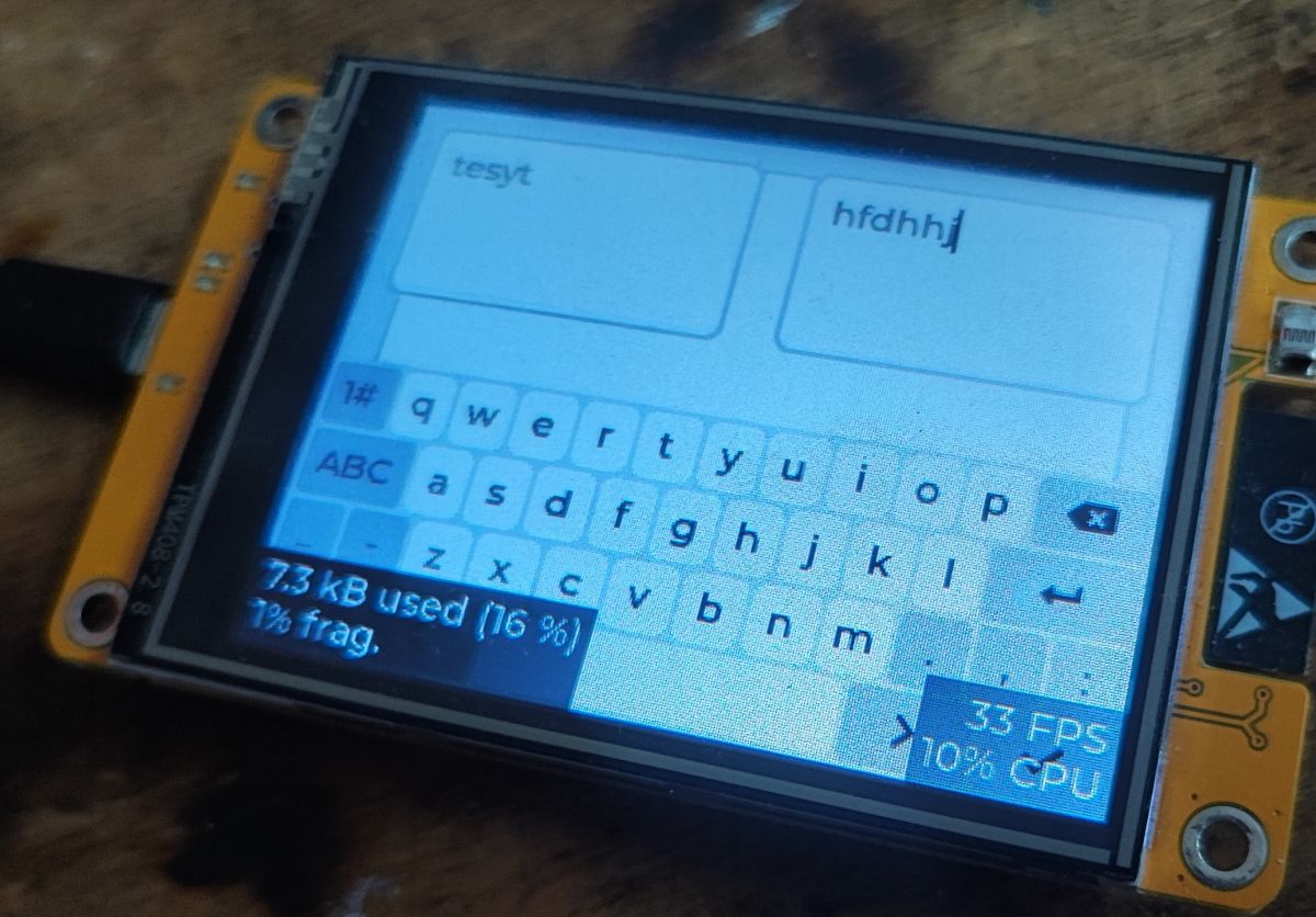

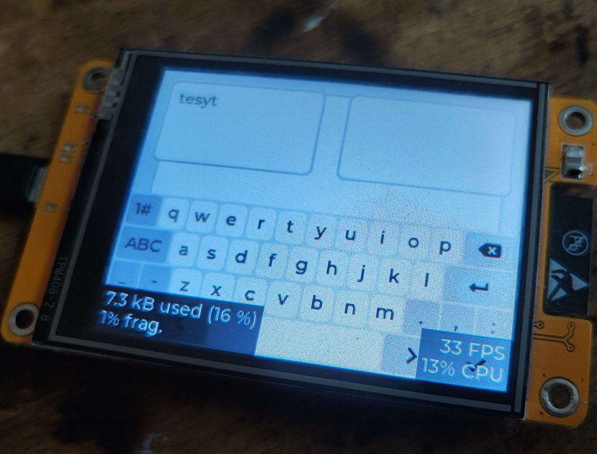

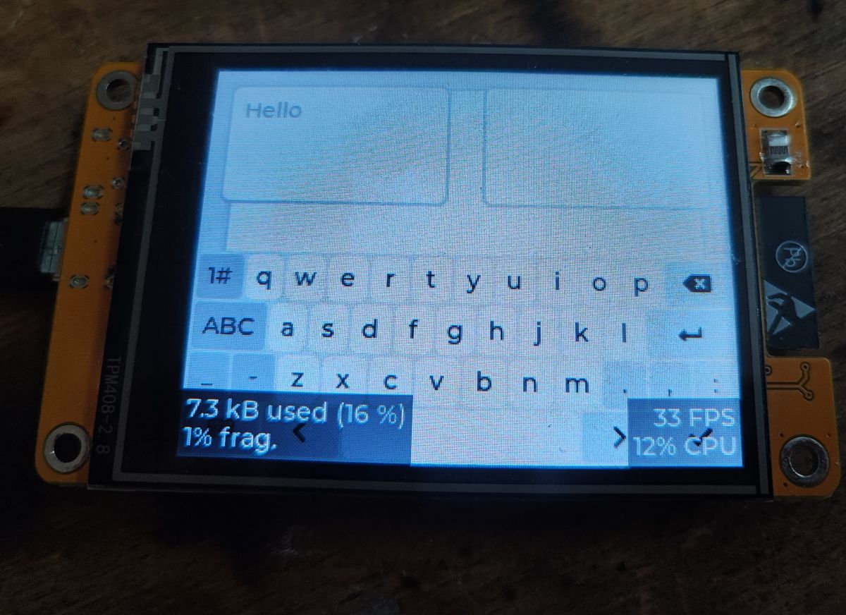

    We compile and upload. As a result, we have a keyboard that automatically adds characters to the selected field.
    ESP32 and touch display - part 7, how to make a keyboard in LVGL? Login. ESP32 and touch display - part 7, how to make a keyboard in LVGL? Login. ESP32 and touch display - part 7, how to make a keyboard in LVGL? Login. ESP32 and touch display - part 7, how to make a keyboard in LVGL? Login. ESP32 and touch display - part 7, how to make a keyboard in LVGL? Login. ESP32 and touch display - part 7, how to make a keyboard in LVGL? Login. ESP32 and touch display - part 7, how to make a keyboard in LVGL? Login. ESP32 and touch display - part 7, how to make a keyboard in LVGL? Login.

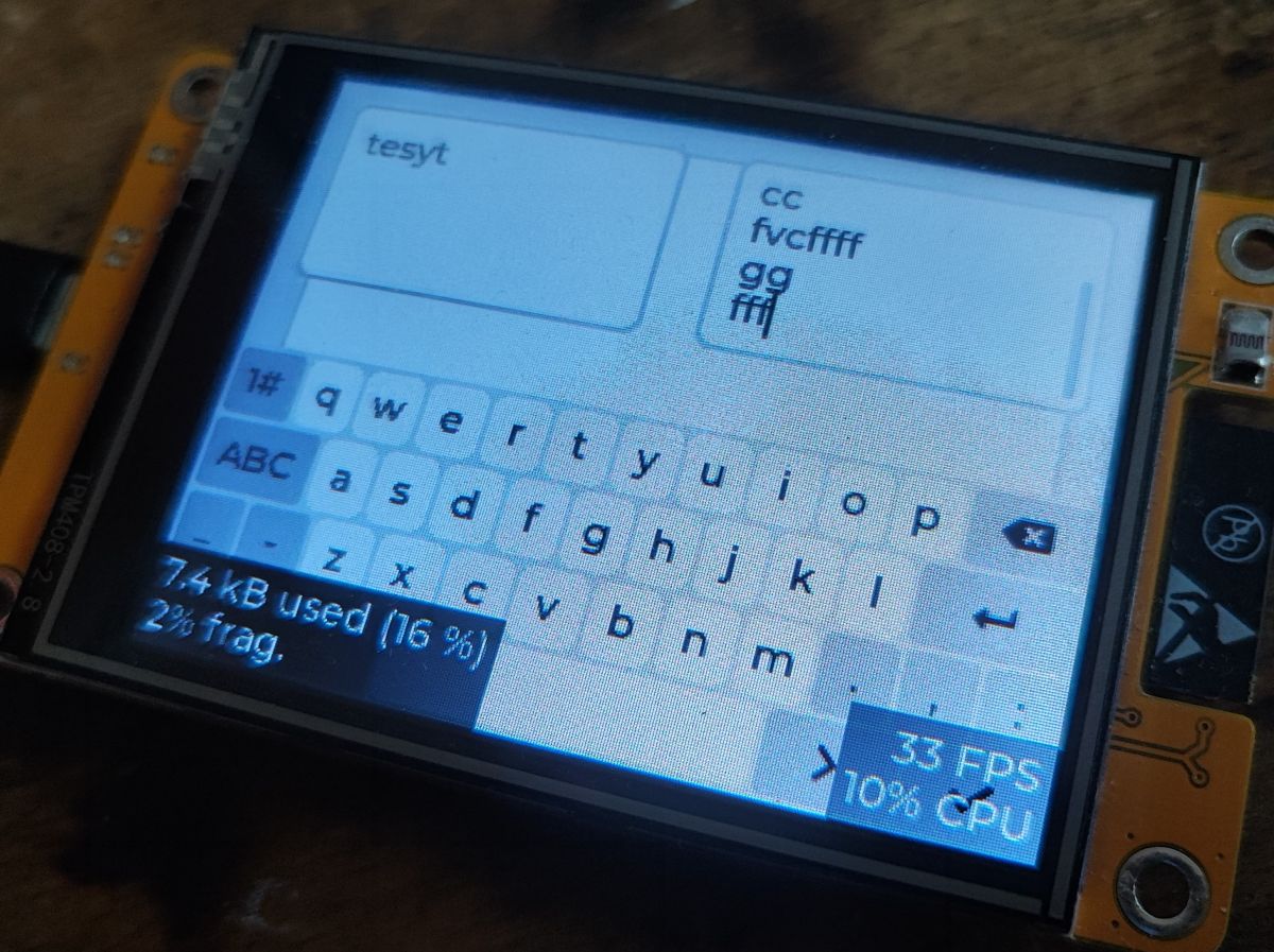

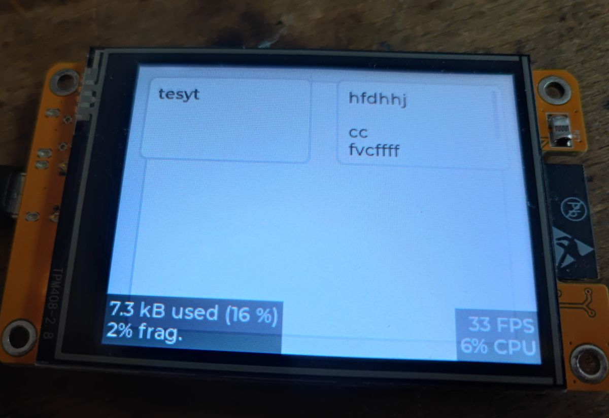

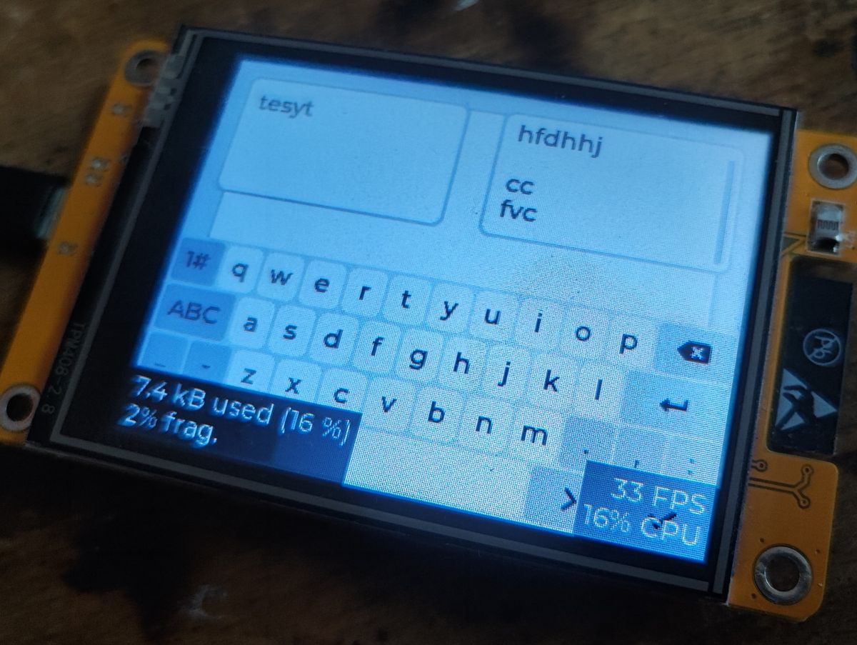

    Ok, but what about the second field? Why is it not possible to write to it?
    It's because we have to manually rewrite the keyboard to that field, which is active.
    Let's convert our example into a login form. To do this, we add an event handler for each of the fields. When a FOCUSED event occurs (activating a field), we rewire the keyboard to that field. At the moment of losing FOCUSED, we retract this keyboard.
    Code: C / C++
    I have also slightly modified the creation of fields. LVGL even offers ready-made functions for creating login forms, including a password field - lv_textarea_set_password_mode . More information in the documentation .
    The mentioned event handler must be pinned to both fields. A single function is sufficient. All code:

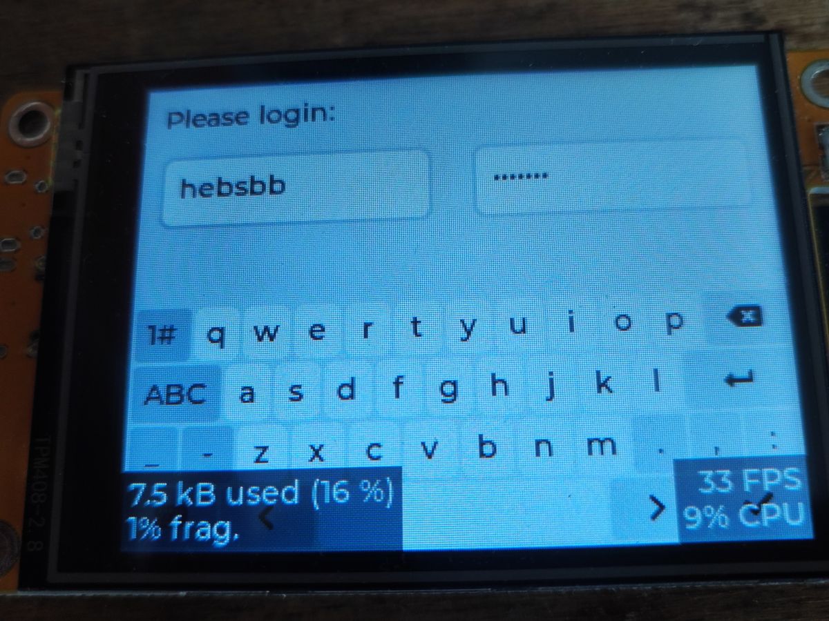

    Uploaded, here is the result:
    ESP32 and touch display - part 7, how to make a keyboard in LVGL? Login. .
    Indeed, it looks like a login form and even the password is correctly covered with asterisks.

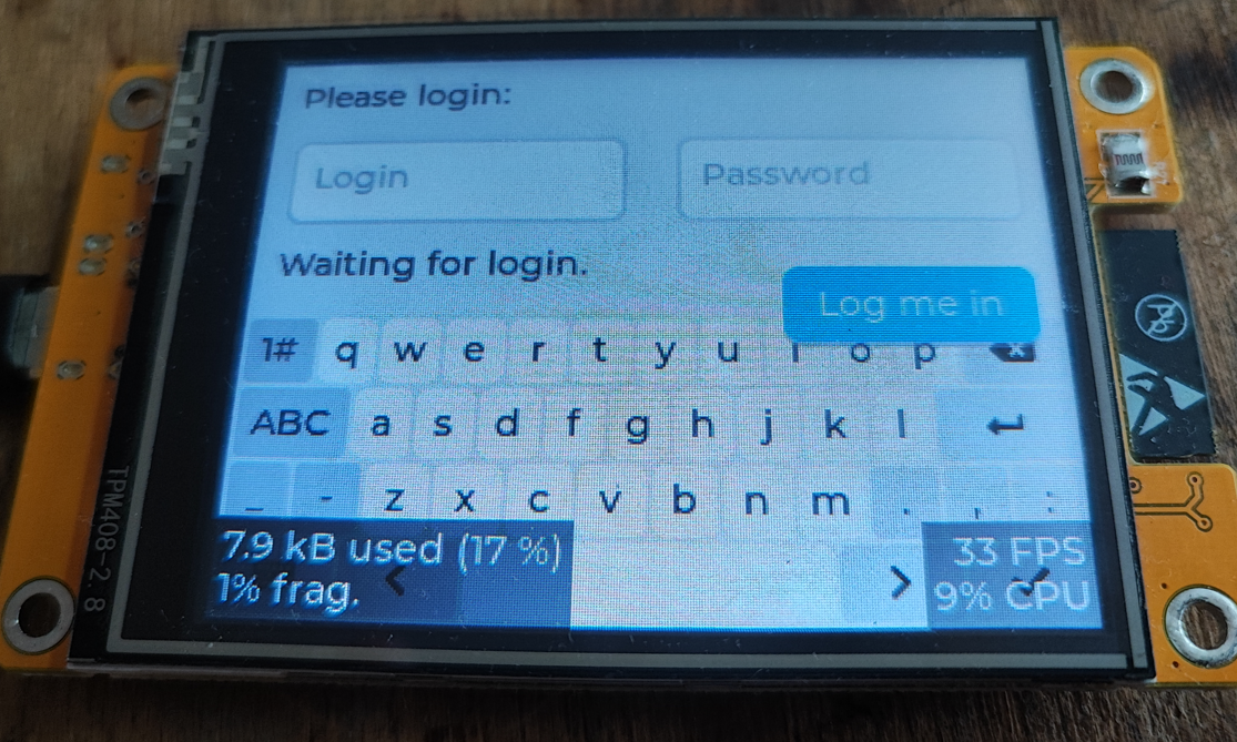

    Time for a minor cosmetic touch - the login button and label.
    Let's add, first of all, some kind of label informing about the login status:
    Code: C / C++
    Then, separately, we add a button with an appropriate caption. You can also set it to handle a click - EVENT_CLICKED event via lv_obj_add_event_cb.
    Code: C / C++

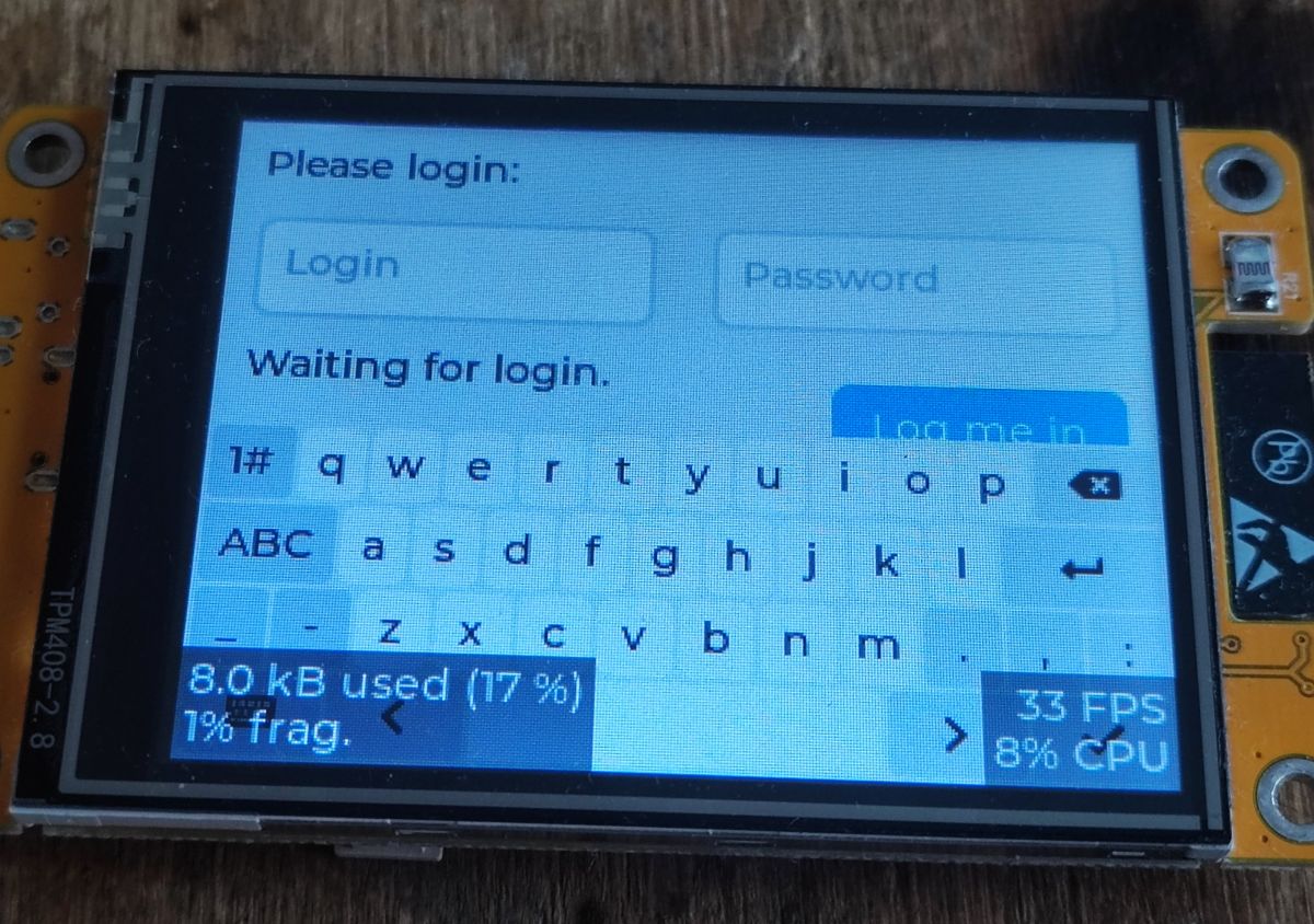

    I have added the event commented out for now. Let's check how the button itself looks...
    Result:
    We have done something wrong! The button is above the keyboard. You can see that the order plays a role. The easiest way is to move the keyboard creation earlier. Or you could use:
    Code: C / C++
    This will move the keyboard to the foreground:

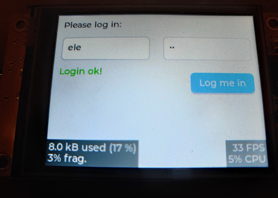

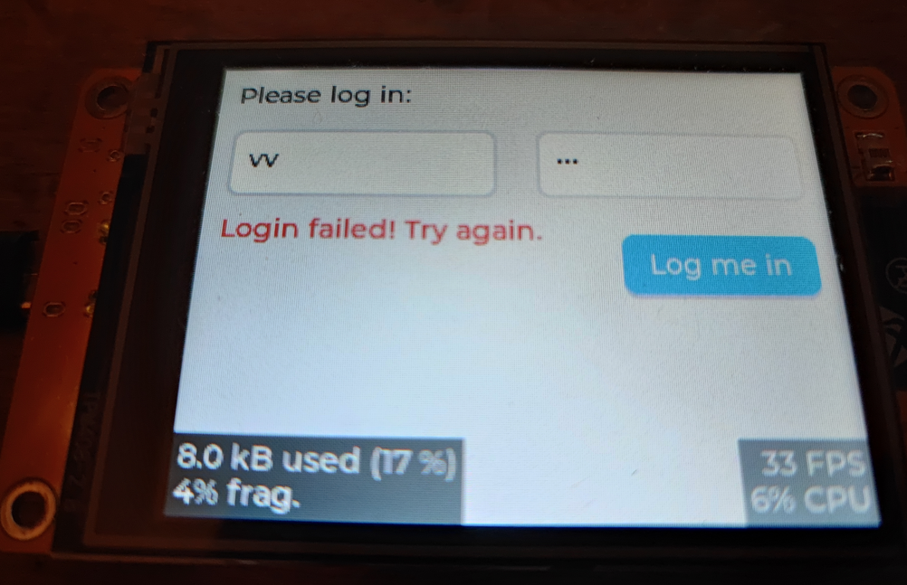

    Then, as a demonstration, we check that the login is "ele" and the password is "12". Normally here would be a slightly different check, perhaps an HTTP request to the server via the API?
    Code: C / C++
    Eventually, depending on the correctness of the data, we display an error or success. A transition to another screen can also be given here.
    Code: C / C++
    All in all, the text could still be coloured.... this way the error message could be in red and the success message would be in green. There is a separate function for this too:
    Code: C / C++
    Time to check our work. The result:

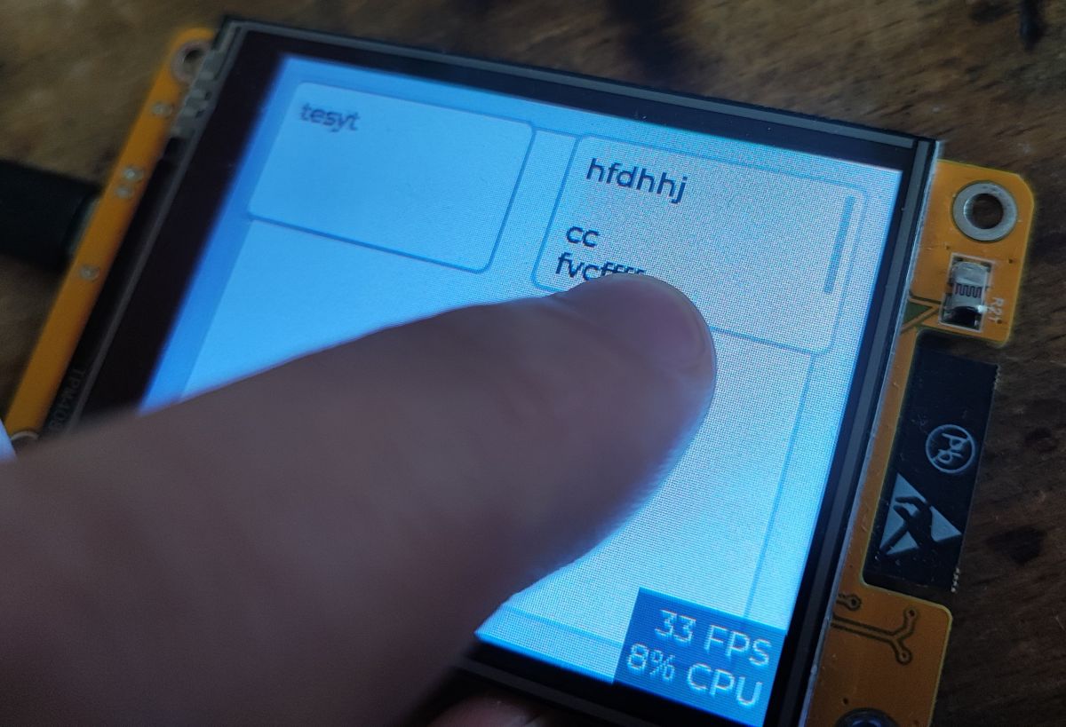

    We can still expand our example a bit and demonstrate vertical scrolling in the screen after login. Let's add a bit more text and make sure the LV_OBJ_FLAG_SCROLLABLE flag is enabled.
    Code: C / C++
    For convenience we will add the texts in a loop, let's say there will be 50 of them.
    Code: C / C++
    I haven't specified the height of the panel here - it will adjust itself to the requirements of what's inside.
