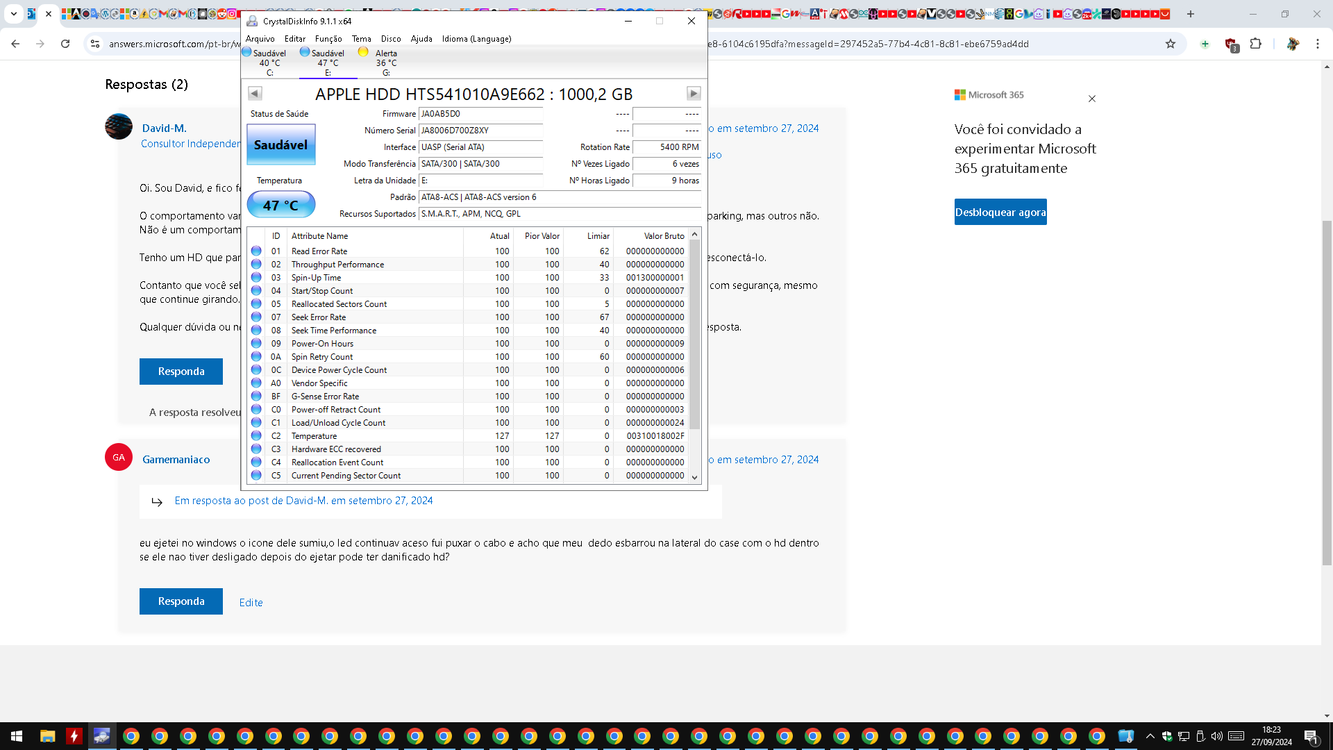

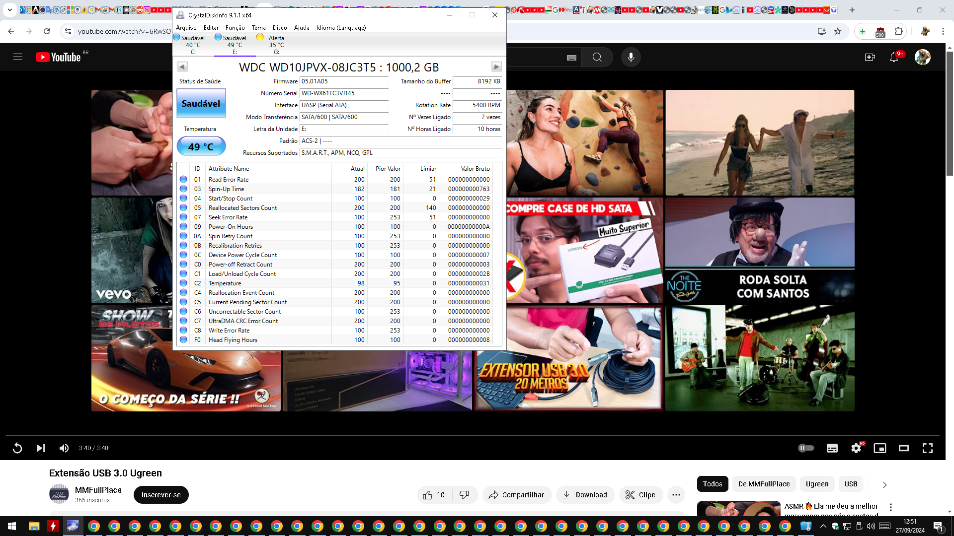

    My drives:
    Screenshot showing CrystalDiskInfo with hard drive details and a YouTube browser view with various video thumbnails. Screenshot of a discussion about a hard drive and use of CrystalDiskInfo software.
    If you eject the 2.5" HDD in Windows 10 and then hit the HDD case with your hand, will it damage it and generate bad blocks? Did the shock move the HDD on the table?
