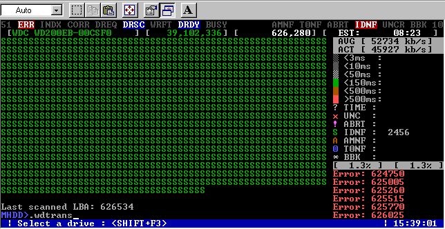

    Right, my words were strong, but it was due to my surprise at the news about this program. What okzo wrote changed my point of view on the matter. My new boot CD will no longer include this software, instead MHDD and Victoria under BartPE. Another thing was that I didn't realize then that I was dealing with the disk.
    I would be grateful to Okz, or to anyone else, if they shared this "wdtrans" script with me.
    He also proposes to change the subject of the entire advertisement to "No for HDD Regenerator", or a similar one. Perhaps thanks to this, many users will save their disks and data from not going away

    Thanks for this code. And I will put it under BartPE because I need it for the PC inspector anyway, and I will have a convenient interface in win

What does the .wdtrans script shown in the thread actually fix?
The six-line script resets the Western Digital translator tables, clearing IDNF errors and restoring logical access without touching user data [Elektroda, Anonymous, post #4808019]
