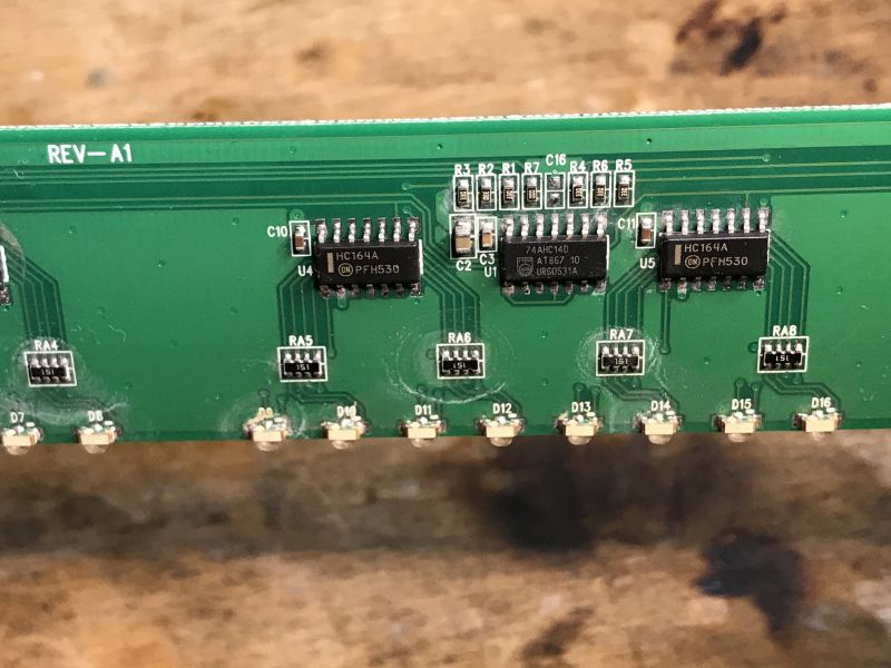

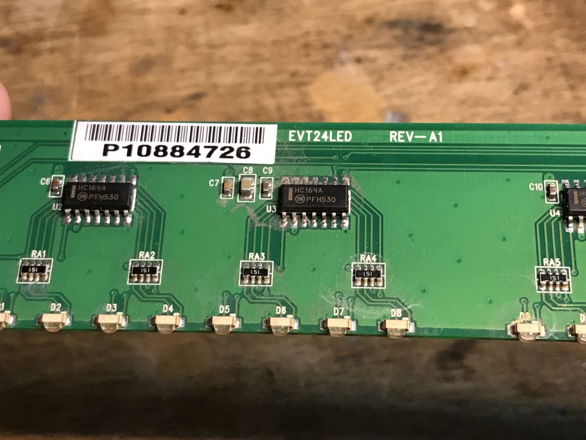

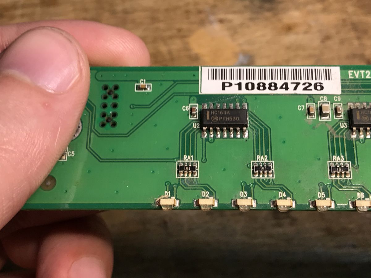

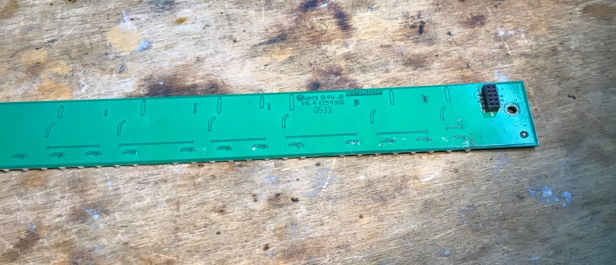

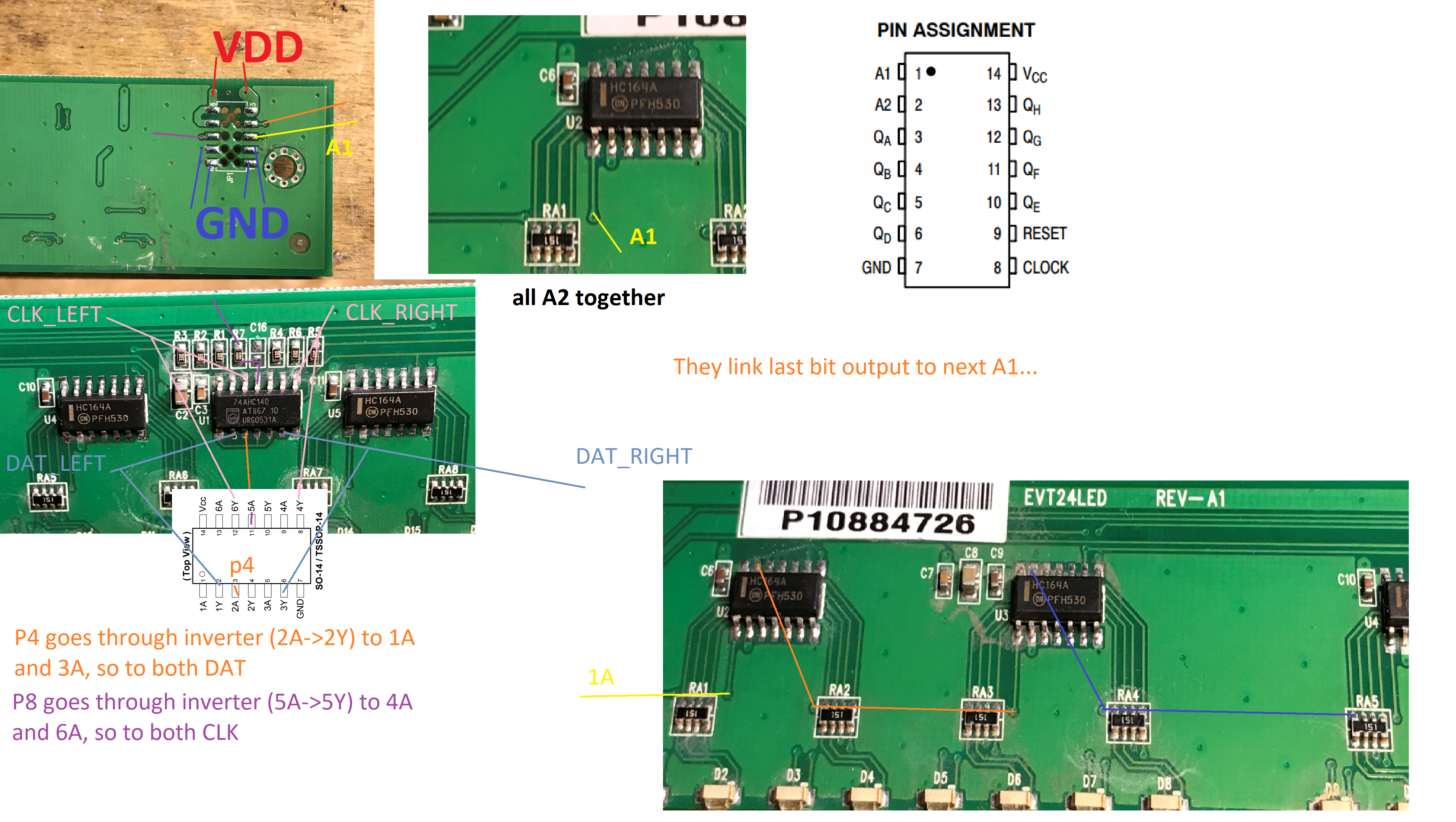

    The scouting begins. There are six HC164A chips on the board and one 74AHC14D:
    Circuit board with integrated circuits and LEDs on a wooden surface. .
    Photo of a green printed circuit board bottom side with markings. .
    Close-up of a printed circuit board with HC164A integrated circuits. Close-up of a circuit board with HC164A chips and LEDs Printed circuit board with HC164A and 74AHC14D ICs and LEDs. .

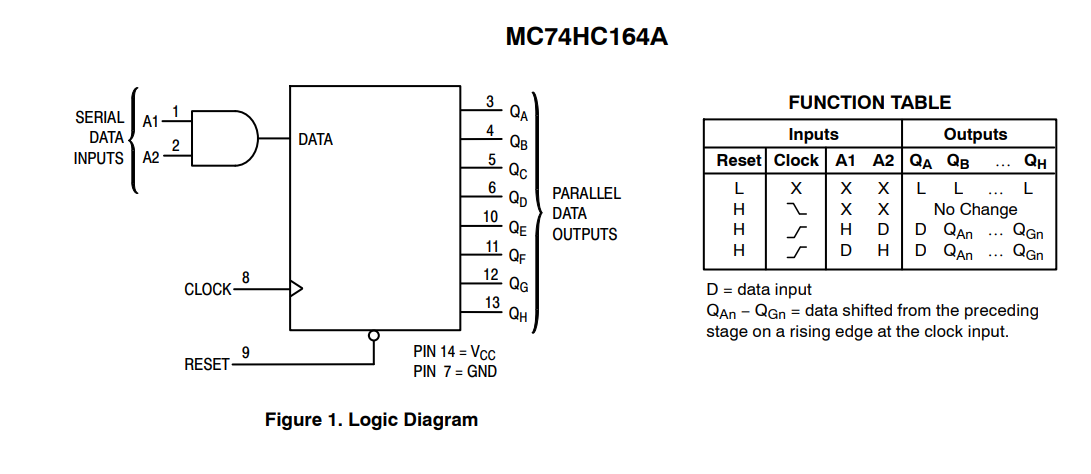

    Check the circuit notes, HC164A :
    MC74HC164A shift register datasheet .
    The first is a shift register. Input in series, outputs in parallel.
    Logic diagram of the MC74HC164A shift register. .
    This shift register has 8 outputs and only 3 inputs. By feeding the right signal to the inputs, we can set the outputs as we wish, so it essentially allows us to get more IO pins.
    The shift register remembers what we set it once.
    To set its outputs, we feed it a clock signal (CLK), the rising edge of the clock causes the remembered values in the register to move a place further. At this point, the next value is taken (to the first place), which is the result of the logical product of the inputs A1 and A2.
    In a simplified application, A2 can be set to high, in which case only A1 and the clock (CLK) are manipulated, and in this way data is written to the next register output pins.
    The clock simply executes successive cycles (we set it to low level, then to high level, etc.), and on A1 we put out at our discretion the value we want to write to the location (1 or 0).
    This will be a little clearer in the code.

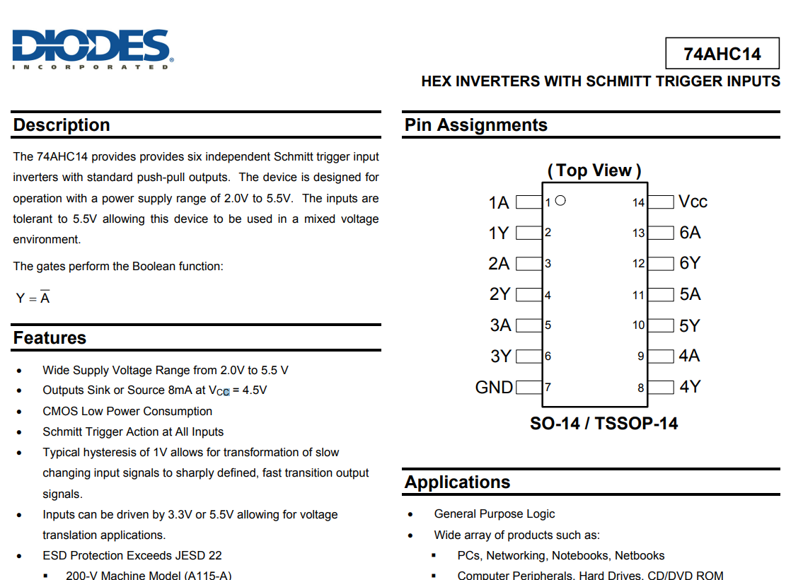

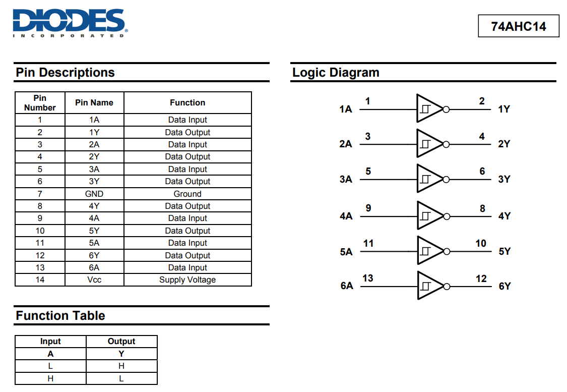

    The second circuit is just the gates implementing the NOT function:
    Section of the 74AHC14 technical documentation with description and pin assignments. .
    There are several of these gates inside it, each outputting the opposite logical state to that on the input:
    Logical diagram and pin description of the 74AHC14 chip .

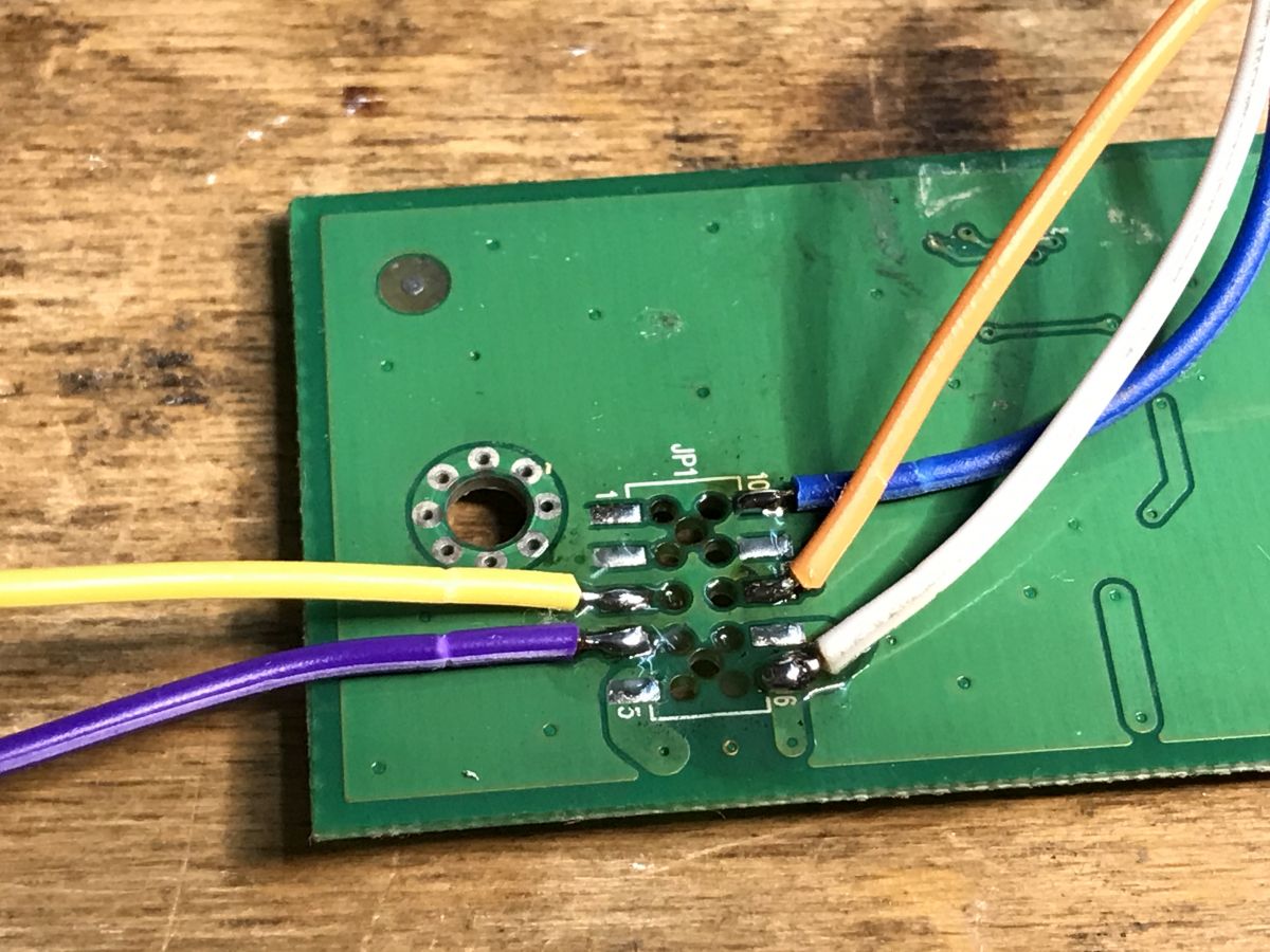

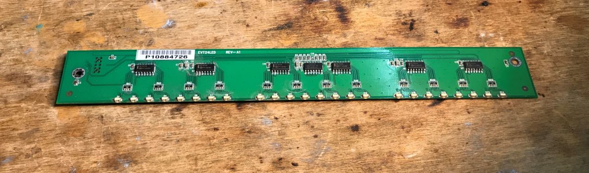

    Now the lead pins need to be examined.

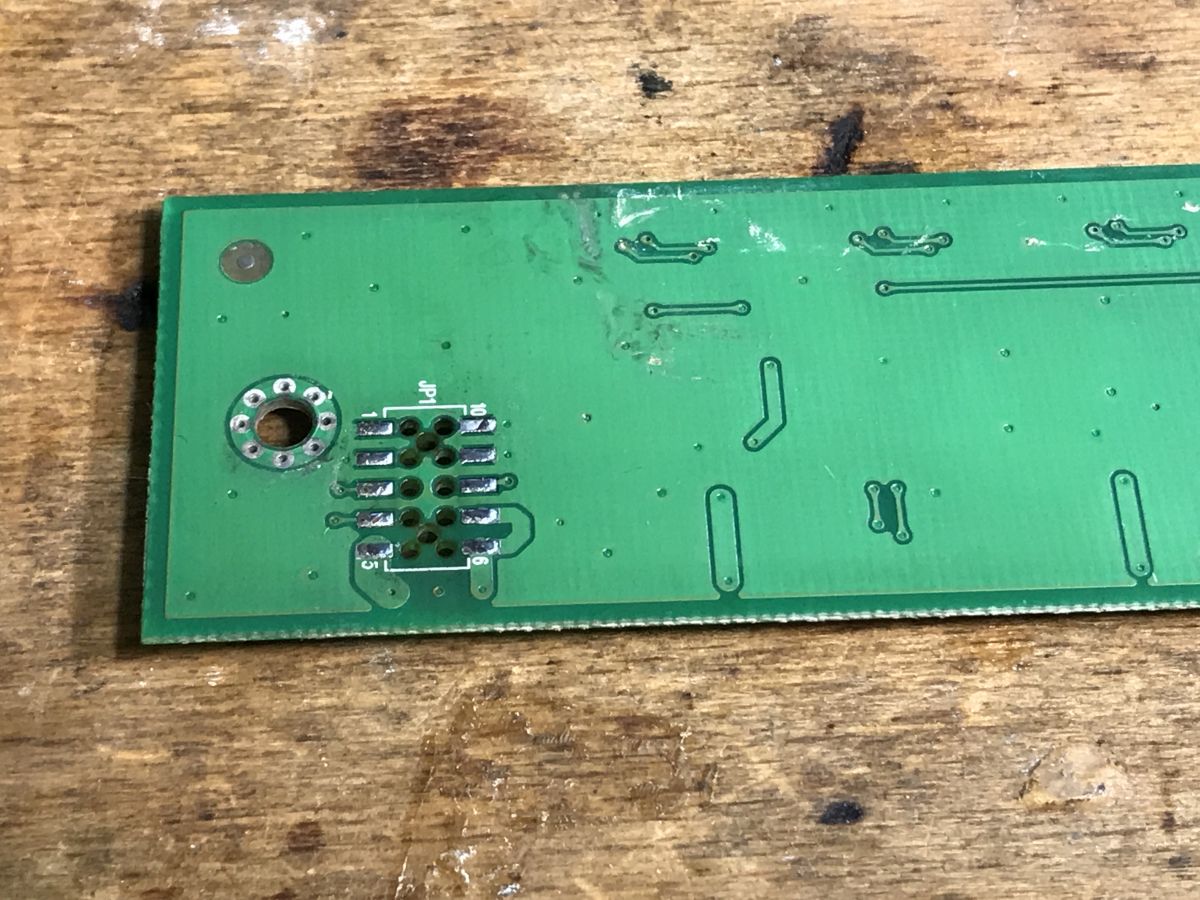

    I have desoldered the connector:
    Image of a circuit board from electronic waste, showing rows of pads and traces. .
    VDD and GND are the easiest to determine - we have the circuit leads after all. In addition, GND is usually a copper spout on the board, the power supply can often be such a spout too.
    We set the multimeter to the continuity test ("beeper") and examine where each pad leads, if by any chance it goes to one of the circuit pins marked VDD or GND in the datasheet.
    This leaves only 3 signals, the connection of which I have also examined with a multimeter, putting my observations in the photo:
    Circuit board with HC164A and 74AHC14D integrated circuits .
    The conclusions are as follows, we have three signals here:
    - a common CLK - this leads to the 74AHC14D, which is in the role of a buffer, and then forks to the combined common clock inputs of the circuits on the right and left side
    - common A2 - like the clock, this leads to the 74AHC14D, which is in a buffer role, and then bifurcates
    - cascaded A1 - this leads to A1 of the first shift register
    Subsequent A1 pins are connected to the QH outputs of the previous shift registers, so that when we sequentially 'insert' bits then the last bit that is 'out' is not lost, it just goes to the next register.
    What we have here is essentially a done "one long shift register" built up from several regular registers.
    There is still the question of why the NOT gate - we could probably do without it too, I suspect it is only there as a buffer so that there is sufficient current capacity to drive the register inputs. Anyway, these signals go through it twice, so they are not negated afterwards (negation negates negation)..

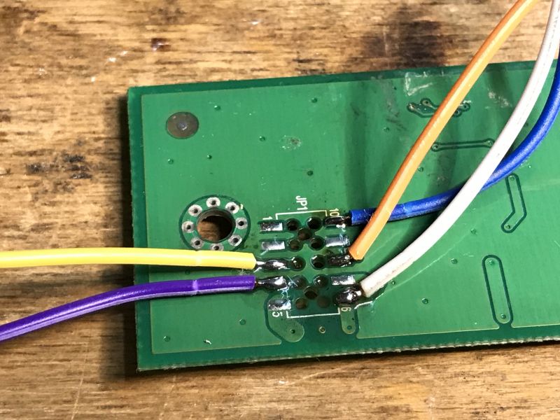

    So we get the Arduino ready, solder the wires:
    Close-up of a printed circuit board with soldered colored wires .

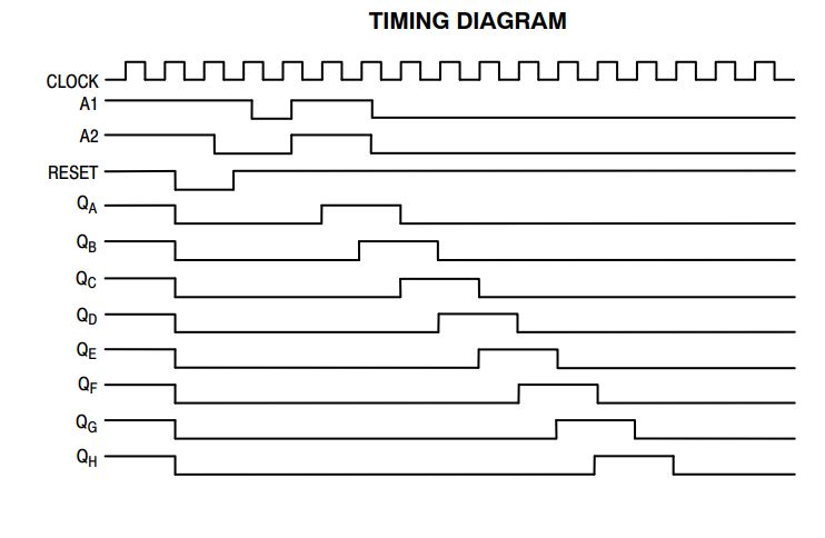

    We take another look at the register's catalogue note to know what to send:
    Shift Register Timing Diagram .
    Let's make things simpler for ourselves - we'll set this additional common input permanently to a high state. We will only operate the clock and the data entry pin.

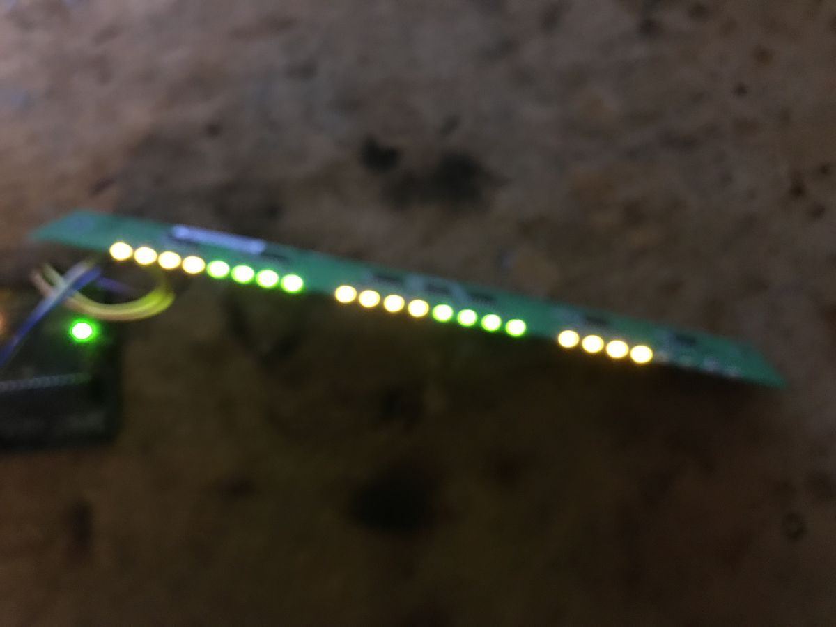

    For now, I'm sending a 32-bit number, in this case -1, which in bit representation is 0xFFFFFFFFFFFF, which is the lit bits themselves, and then I'm sending the lit bits themselves. I want something to blink.
    Apparently something is working, but why alternate?
    And I already know, because, after all, those LEDs there are two colours.... so there's a total of 24*2 = 48 bits there, and I'm only sending 32 bits. Additionally, I don't reset anything, so basically I send bits [0,31] first, then [32, 47] and again [0, 15], and so it loops....
    I was too hasty in making that first attempt, but I already know what's wrong.

    Testing:
    It works!

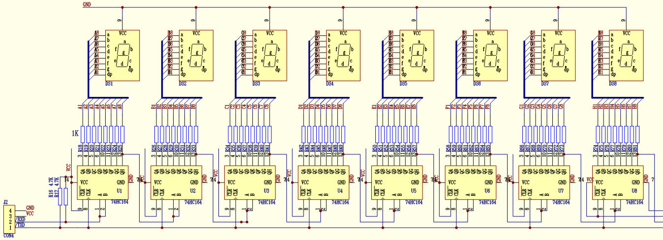

    EDIT: There will probably be questions about the schematic, so I found something fitting on the web:
    Diagram of cascaded 74HC164 shift register connections. .
    Except that in my case all the "B's" are together and I feed a high state to them.
    Source: https://www.amobbs.com/thread-3278926-1-1.html

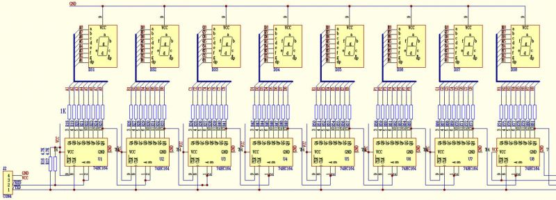

  • CA output should connect to Vcc, not GND
    #2 21289265
    austin007
    Posts: 768
    Help: 6
    Rate: 278
    There is an error in the diagram. The CA output is connected to the rail described as GND. It should be Vcc. I would realise the state latching and display only after loading the target states by just blanking by mounting a P-Mosfet/PNP key in the CA circuit. If the clock is fast enough, blanking will not be a nuisance. If it would be slower, one might be tempted to dim the PWM with this key , loading, brightening. With very fast clocking transients will not be noticed. It is definitely better to use a latch register or multiplex at the display and to relieve the processor use ready-made multiplexers. Such a led ruler is probably the first Christmas project according to the large-scale, commercial, pagan tradition. After All Saints' Day, Christmas decorations go up in hypermarkets.
