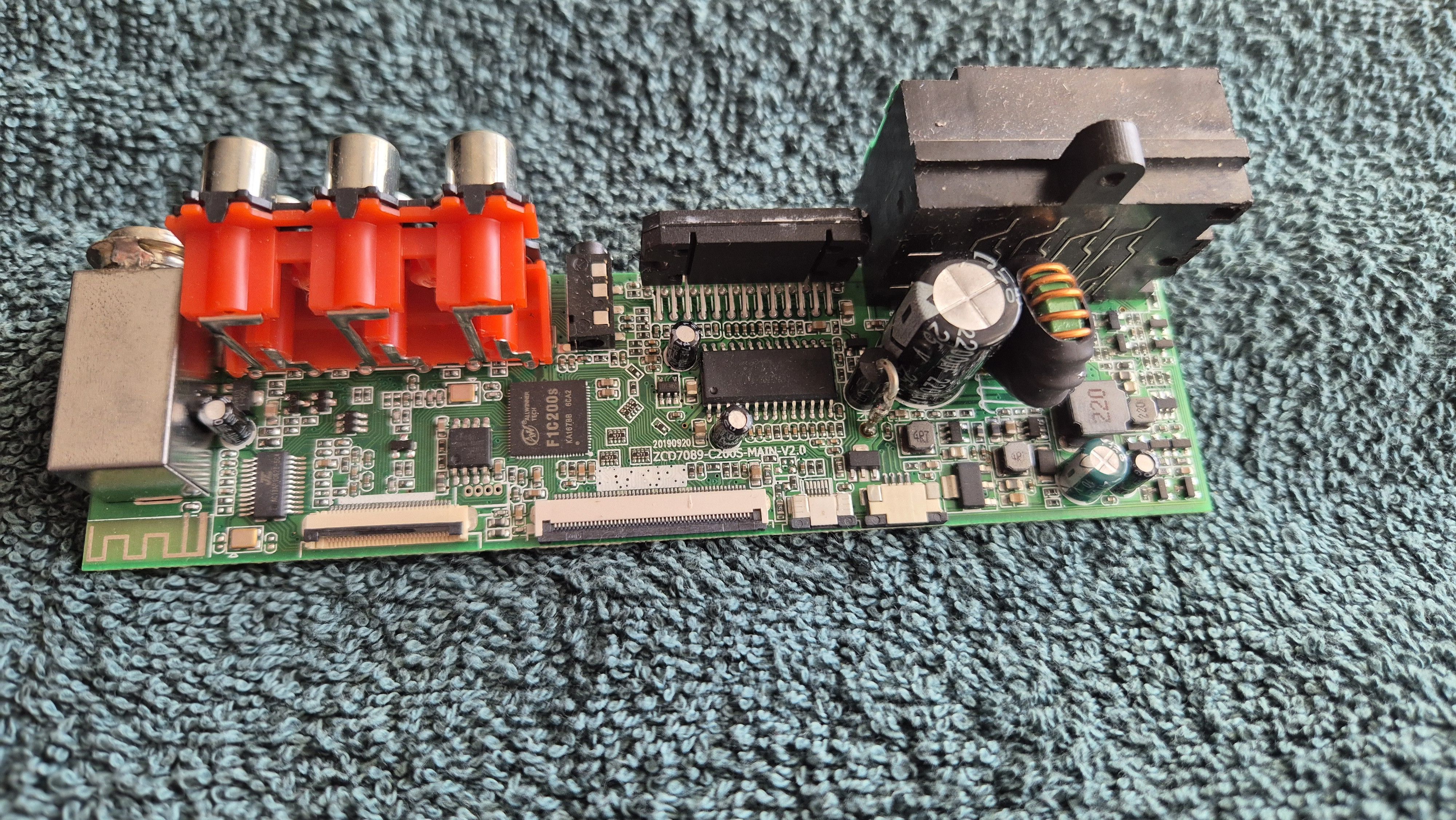

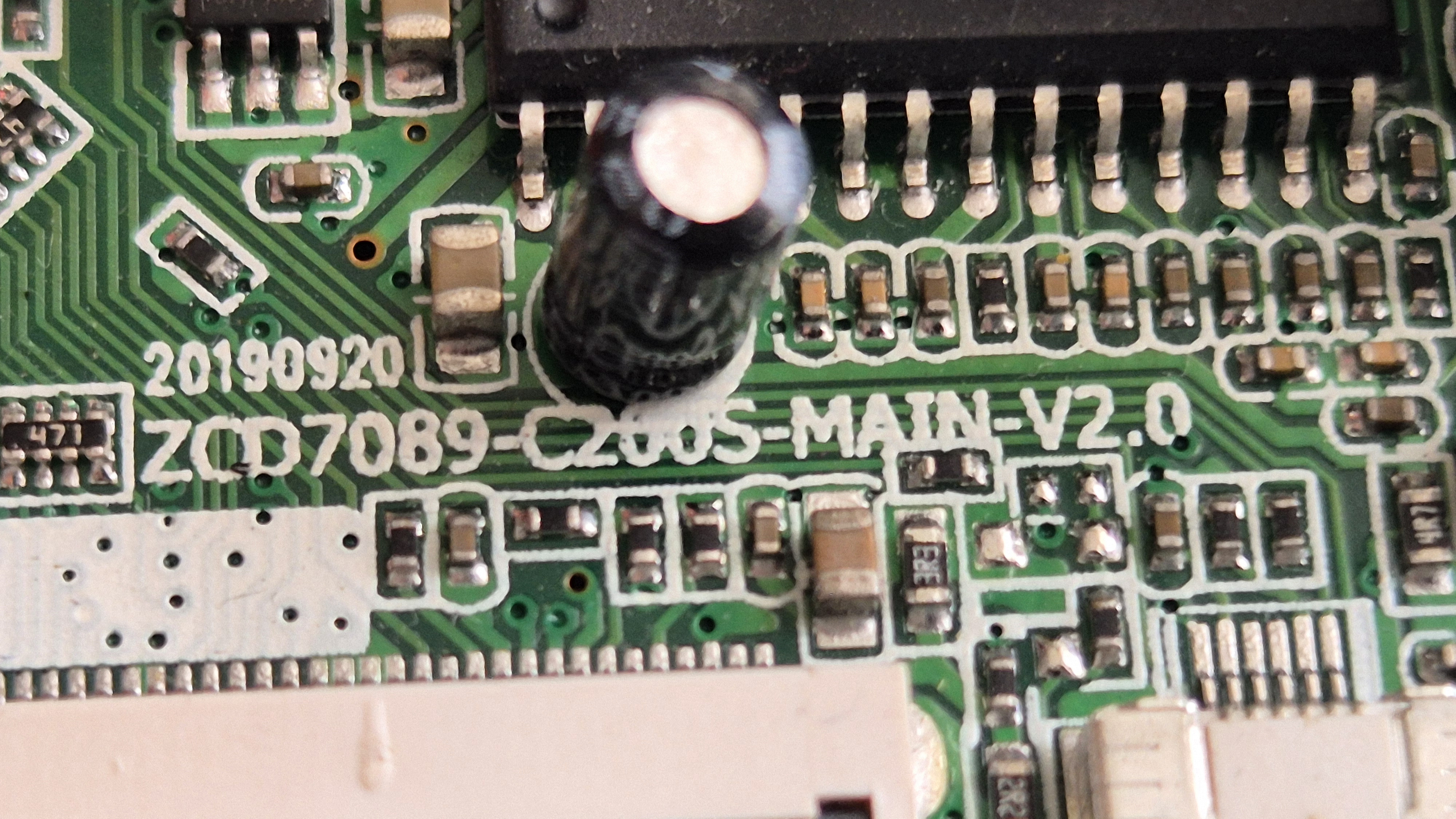

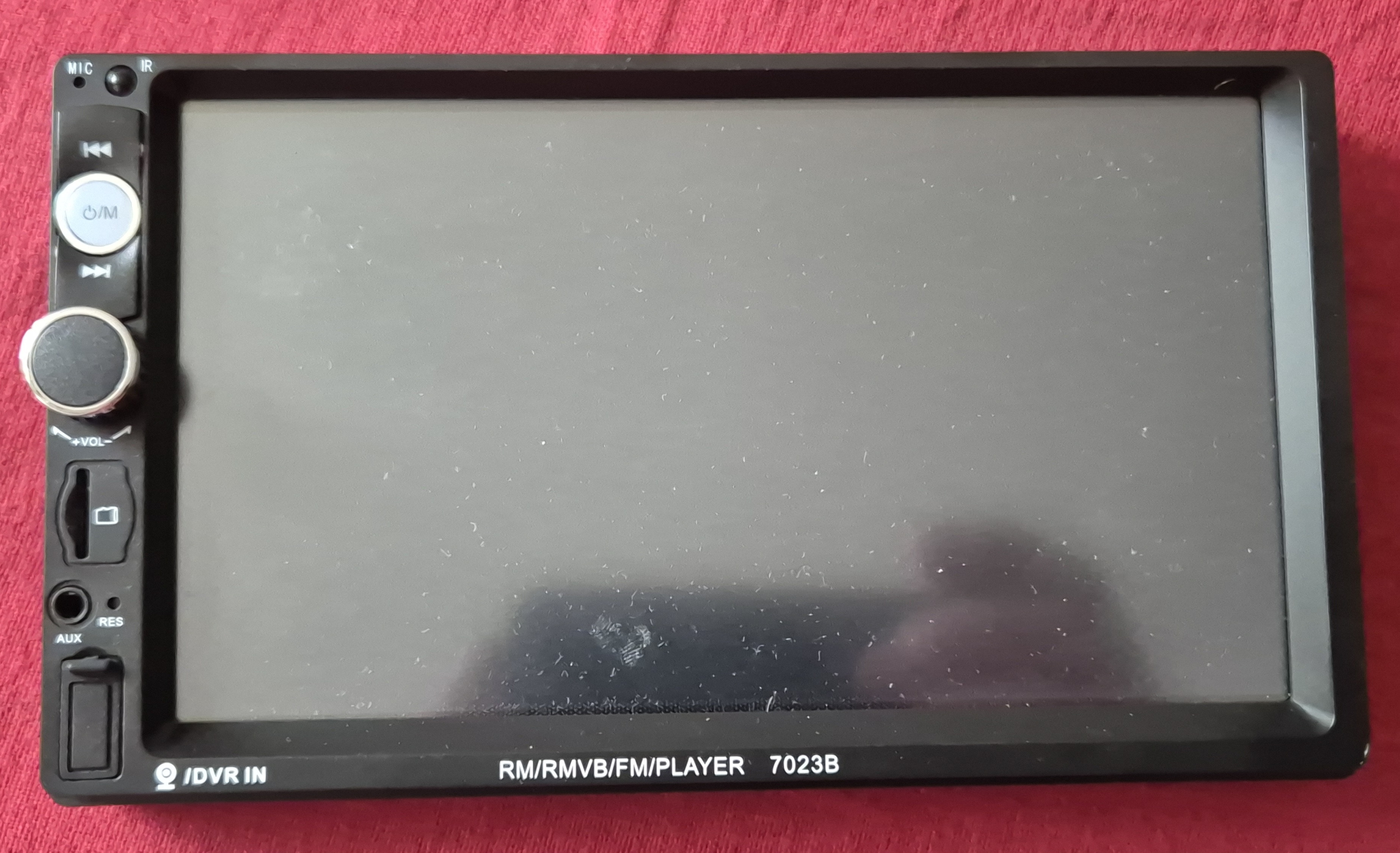

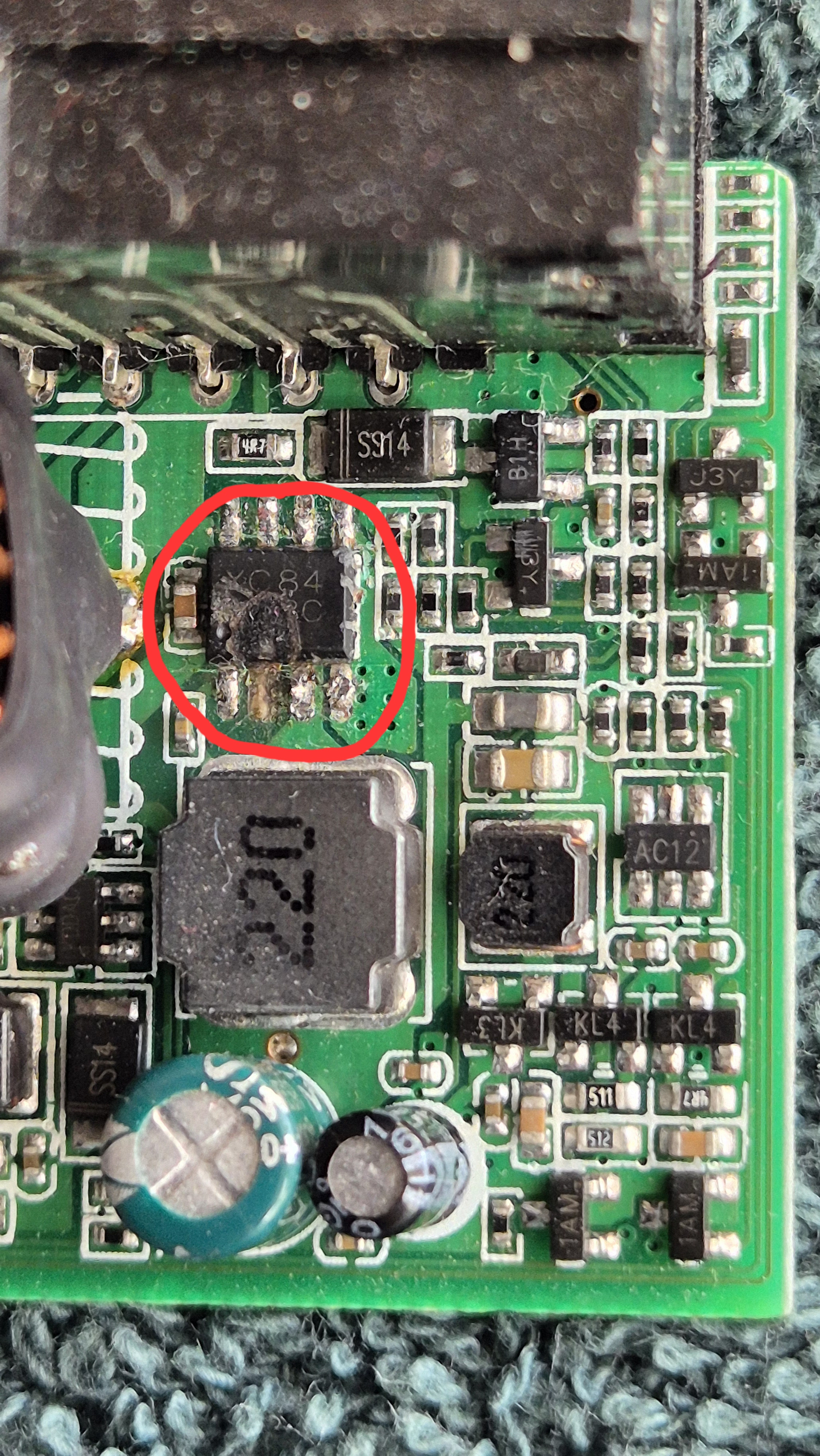

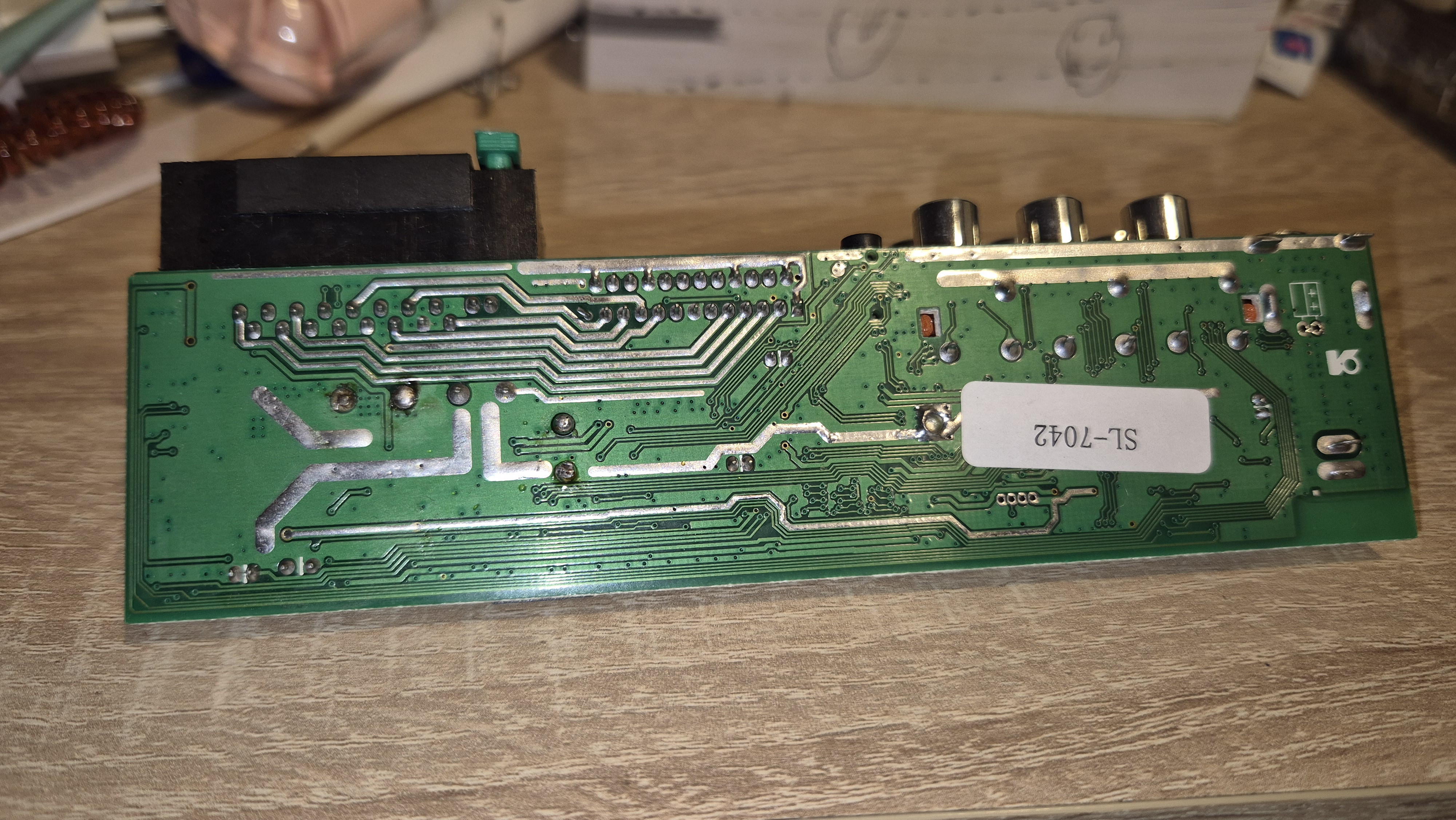

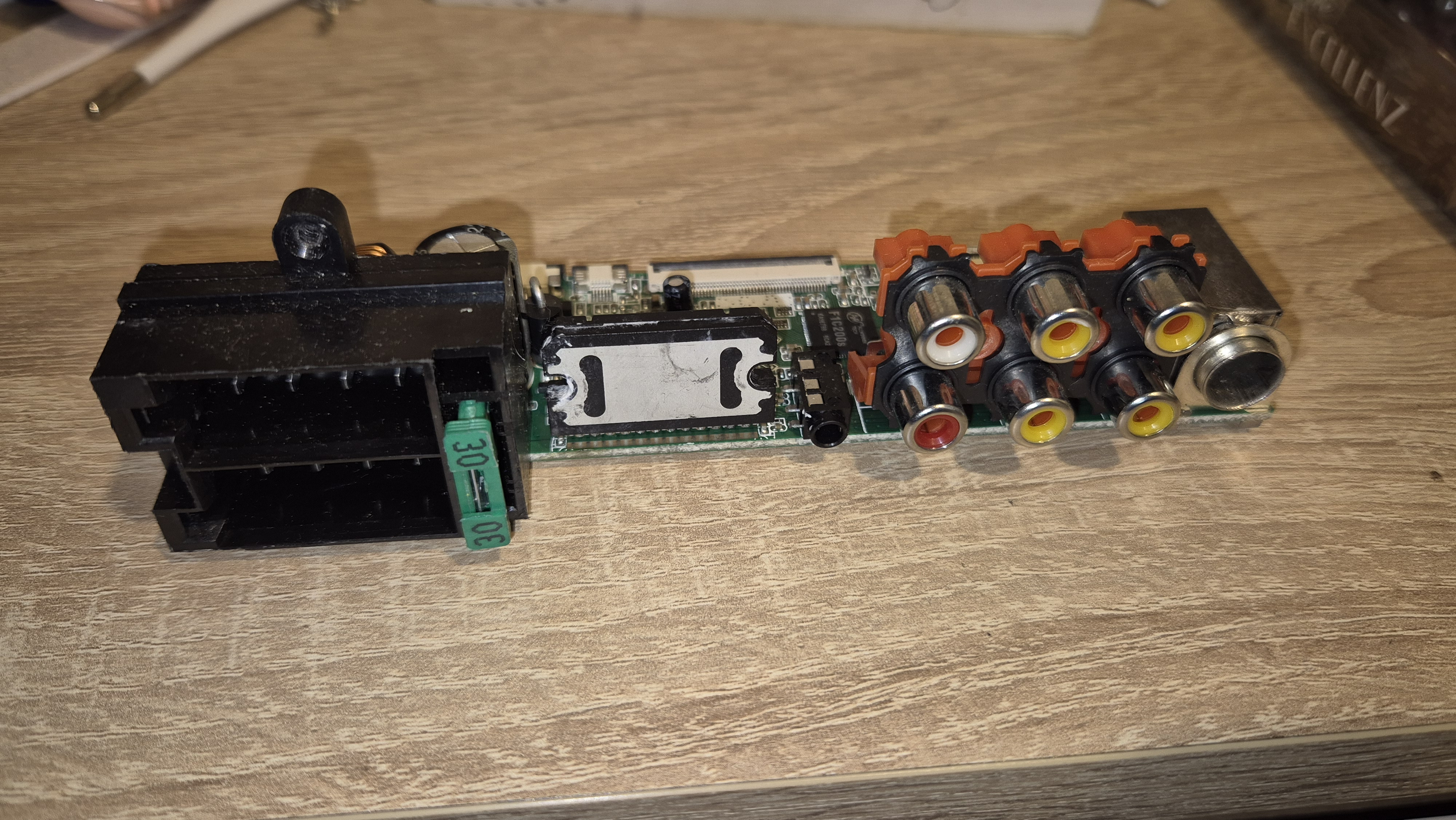

    Hello I have a similar radio and unfortunately accidentally shorted the power pins and burned out the 8 leg circuit marked in the photo. Does anyone have a photo of this circuit on their board and can send the designation.
    It seems to me that it could be a 5V inverter

    External inverter inserted . Radio works
