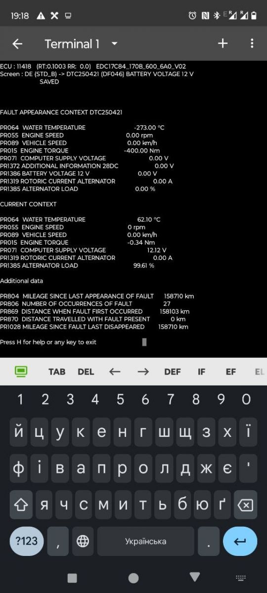

    I have a Renault Clio Mk4 with the next problem. While driving, the battery indicator may turn on and then, almost immediately, turn off.
    I used an ELM scanner to check for error codes and found the following: DTC250421 (DF046). I checked the context and noticed that at this moment, the battery voltage shows as 0V, however there is no difference in car behavior.
    Screenshot of a diagnostic scanner with error data for Renault Clio Mk4.
    The earth straps from the battery were checked and cleaned. However, this did not help. It seems the problem is more likely related to the wiring than to the charging system itself. Do you have any ideas from where to start?

    Hi, first of all it would be worth checking the alternator to make sure it is working properly, preferably switch on the windscreen heater plus the lights (it's all about getting the most current from the consumers) and check that the voltage does not drop too much.
