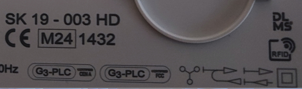

    Hi,
    I have had a GAMA 350 electricity meter in my flat since July this year. Due to my desire to integrate with HomeAssistant, I asked Stoen Operator to activate the local remote reading interface. However, unfortunately, I was only activated the P1 port, which does not satisfy me, as I do not have a cable for remote reading of the meter.
    Looking through the OSD website it came out that they have several variants of this meter model, and unfortunately my copy does not have a wireless interface.
    Link to current PDF: https://www.stoen.pl/files/2024-11/interfejs-sieci-han-w-stoen-operator-v1-0.pdf
    I would like to know if I have any leverage on the operator to replace the meter with one with wmbus, or do I need to buy a wireless adaptor to read after P1?
    Picture of my meter:

    Legally, there is no such leverage. This is because the meter is the property of the operator and in no way can you be "forced" to replace it with the one you want. You can only ask for a replacement and argue that it lacks the features you want. Small chance, but maybe worth a try?

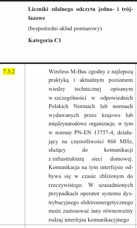

    What I have found is that the Decree of the Minister of Climate and Environment of 22 March 2022 on the measurement system says:
    According to paragraph 7 I am in category C1.
    According to paragraph 18, the measuring equipment is to comply with the requirements of paragraph 7.3.2 of Annex 1.
    Paragraph 7.3.2 of Annex 1:
    How do I force the replacement of a GAMA 350 meter with a wmbus model at Stoen Operator? .
    Mentioned regulation: https://isap.sejm.gov.pl/isap.nsf/DocDetails.xsp?id=WDU20220000788
    Is this not a strong argument, or have I made a mistake in my search somewhere?

    Do you want to 'kick yourself with a horse' by means of regulations? Write a well-founded request for an exchange. If successful, cool. If not, appeal asking for the legal basis for the refusal. Only then will you have something to refer to, this will also be a good time to pull out specific paragraphs.
