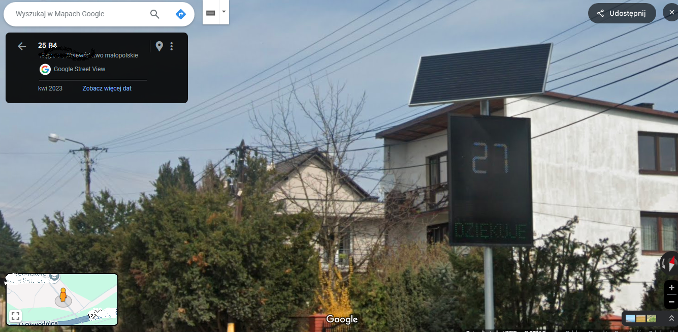

    gerta21w2 wrote:
    I was wondering if we can fully trust our car's speedometer, or if these kinds of differences are normal?
    Most vehicles underestimate (well that mistake of mine, below a colleague pointed out to me, and it should actually say that overestimates ) the actual speed by a few kilometres.
    And this is actually true:
    gerta21w2 wrote:
    I have read that speedometers are designed to slightly overestimate speed as a precautionary measure.
    And verification (no GPS needed) can be done at such roadside indicators, of which there have been quite a few in recent times.
    They are most often located near pedestrian crossings.
    What is more interesting, they show the speed quite accurately.
    You could even say that they show as much as a GPS
    Roadside radar sign displaying a speed of 27 km/h with a solar panel on top.
    5 km/h is quite a lot.
    On mine it misrepresents by 3 km/h

  • One user reported a roadside speed display matching their calibrated electronic speedometer and GPS with about ±1 km/h at 30 km/h, but other users warned that roadside displays also have measurement error. [#21349005]

7. How accurate are roadside radar speed displays near pedestrian crossings compared with GPS and the car's dashboard speedometer?
They were described as quite accurate, but not perfect. One user said those roadside displays often show nearly the same speed as GPS, and another reported about ±1 km/h at 30 km/h. Other posters cautioned that every measuring device has error, including police radar and roadside displays. So they are useful reference tools, not absolute truth. [#21349005]
