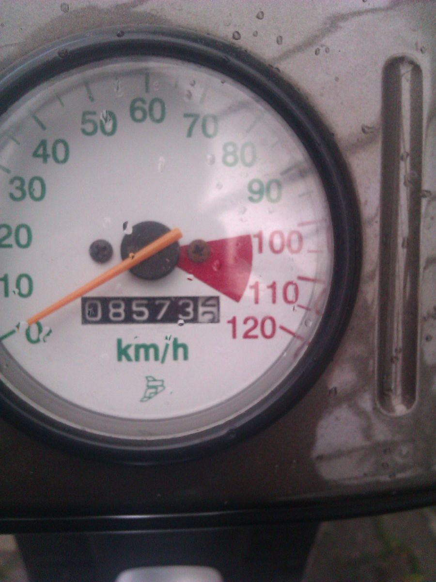

    #44 21368859
    BANANvanDYK
    Posts: 7818
    Help: 1167
    Rate: 2602
    >>21348931 .
    I have read the R39 provisions in detail.
    Interestingly, mopeds should have counters that overestimate by 10% +4 km/h offset, just like in cars.
    In addition, the meters on mopeds must not have a scale exceeding 80 km/h.
    Meanwhile:
    Close-up of a moped speedometer with a maximum scale of up to 120 km/h. .
    This is a 50cc scooter I used to make. The model locked in the worst possible way, that is, structurally in every component, so difficult to unlock. When I rode it, I was surprised to find that it rides like a bike. It's standard for the meters on scooters to overestimate, but I didn't expect it to overestimate so much.
    By the meter it was pulling 50-55, max 60 km/h. I checked my speed with the GPS and it turned out that it was going the legal 45 km/h, max. 50 km/h.
    Basically, the error of the meter readings exceeds the allowed norm, and the red range on the dial of 100-120 km/h not allowed by the regulations is not even possible with this engine.
