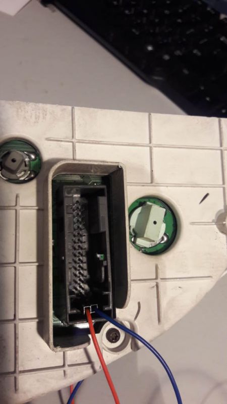

    kordian2
    Posts: 7
    ste wrote:
    This counter (Mondeo MK3) does not wake up CAN. You need to enter the second plus, the so-called "after ignition", which in the car goes from the ignition (terminal 15), pin No. 2 in the meter.
    Thank you for the information.
    At the moment, as you can see in the picture, I have determined the location of the 4 pins.
    The bottom two are + 12V, GND
    The top two are CAN.
    My guess is that for people familiar with the subject, these are trivial questions, but when searching the internet resources I did not find an answer about the pin markings of the meter plug, so I do not even know which pin number 2 is :) Statistically, it's 2-4 possibilities.
    Rather, I try not to give voltage to the system without PCB analysis, so as not to damage it.
    In addition, even if I had to give something to pin 2, I do not know what value of this voltage should be?
    12V or 5V?
    If possible, please ask for a "question to a friend" :) and more information.

    #6 17031670
    ste
    Level 28  
    Posts: 552
    Help: 184
    Rate: 278
    Mondeo MK3 odometer:
    Pin 17 - ground
    Pin 1 - 12V fixed (terminal 30)
    Pin 2 - 12V "after ignition" (terminal 15)
    This along with what you have already determined should be enough for you to turn on the counter.
  • #7 17032275
    kordian2
    Posts: 7
    Pin 17 - ground
    Such an effect!
    Step forward :)
    Ford / Mondeo / MK3 Speedometer - CAN - I need data about the meter pinout
    After connecting pin 2 to 12V, the LEDs light up immediately.
    At the moment of supplying power, the displays do not show anything, only after several seconds they wake up and you can see what is in the picture.
    In addition, the left switch changes the temperature unit from F to C, so it concludes that the microcontroller is working.
    Now I will see if there are any frames on the CAN bus because maybe the meter sends its status from time to time.

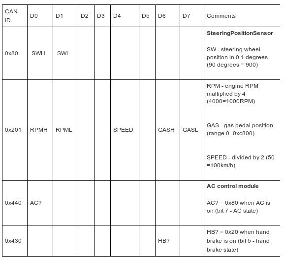

  • #9 17032530
    kordian2
    Posts: 7
    Education is my main goal.
    This thread is a side topic and when I manage to achieve satisfactory results and set the counter, it will serve as a demonstration of the CAN bus for my main thread, i.e. engine control in the BIONX system.
    In my opinion, there is no cheaper (from PLN 10) and more effective CAN terminal than a car meter.
    Further analysis:
    After connecting the oscilloscope, the transmission is visible, hence the conclusion that, as I assumed, the meter is already sending something to the CAN bus.
    After connecting the MCP2515, I got one type of eight byte dataframe with ID = 0x430
    Code: C / C++
    The above frame is repeated approximately 10 times per second.
    Maybe now for the test I will send some data to the above address and see if the meter responds.

    kordian2
    Posts: 7
    szymitsu21 wrote:
    connect any tester and do a selective test of elements.
    You'll see everything you can :)
    It was in this configuration, ie "scanner mode", that I was physically working yesterday :)
    Using a simple program, I performed a scan in the ID range and incremented each of the eight bytes by sending five the same frames to be sure.
    Due to the fact that I always wonder how to make my work easier / more difficult, I thought (idea not yet implemented) that I would connect the IP camera and record changes on the meter display and when there is a change in the image, it will save the current values of ID, DATA from CAN.
    There is probably not much of it, but yesterday I could not determine which register is responsible for controlling the fuel level indicator and engine temperature.
    At the moment, I am able to activate the counters speed and rpm . engine and battery indicator lights and turn on the so-called "odometer", i.e. the two lower displays, the left one shows the temperature of -40oC and the right one the meter reading / Km and TRIP, i.e. the trip sub-meter.
    My guess is that the meter status (kilometers traveled) will not be controlled by CAN because it is closely related to some EEPROM register of the microcontroller and to reset this value you would have to plug into the MC programming pins.
    When I was looking for information about the counter, I found a photo and a video of such "hooking"
    The car has something like 90,000 on the meter so it looks interesting and I don't need to "twist" :)
    summarizing .
    The counter is functional and I managed to wake it up by supplying 12V to pin 2.
    After waking up, the frame ID 0x430 (content in the news above) appears on the CAN bus.
    I can control RPM and SPEED hints via ID 0x201
    The two lower displays were activated, but without activation and the 2 indicators (battery, engine fault).
    I cannot control the fuel gauge and engine temperature.

  • #13 17034119
    ste
    Level 28  
    Posts: 552
    Help: 184
    Rate: 278
    I think that you will not control the fuel gauge via CAN, because it is controlled directly from the level sensor in the tank (information about the amount of fuel is not sent to the meter via CAN). That is, the fuel level sensor is connected directly to the meter (pins 24 and 25). Try to connect some resistors or a potentiometer to these pins and the indicator should rise.
    The temperature is sent via CAN from the engine control unit to the meter.
    Other:
    Closed hand brake indicator light - pin 12 (ground control).
    Oil pressure sensor - pin 8 (ground control)
    Counter backlight - pin 4 (12V)
