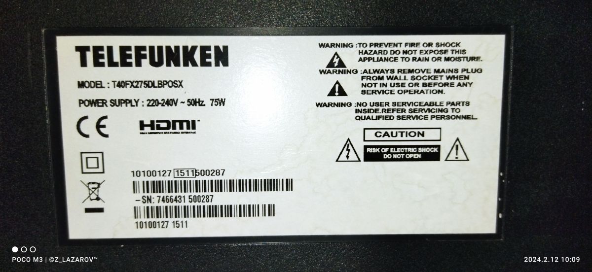

    I have Telefunken 40 Inch smart TV model t40fx275dlbposx
    Telefunken television label with model and power information.
    and after replacing faulty MBMB Vestel 17MB97 (black screen after 1 minute work) with a new, now all works but picture is upside down (as at picture)

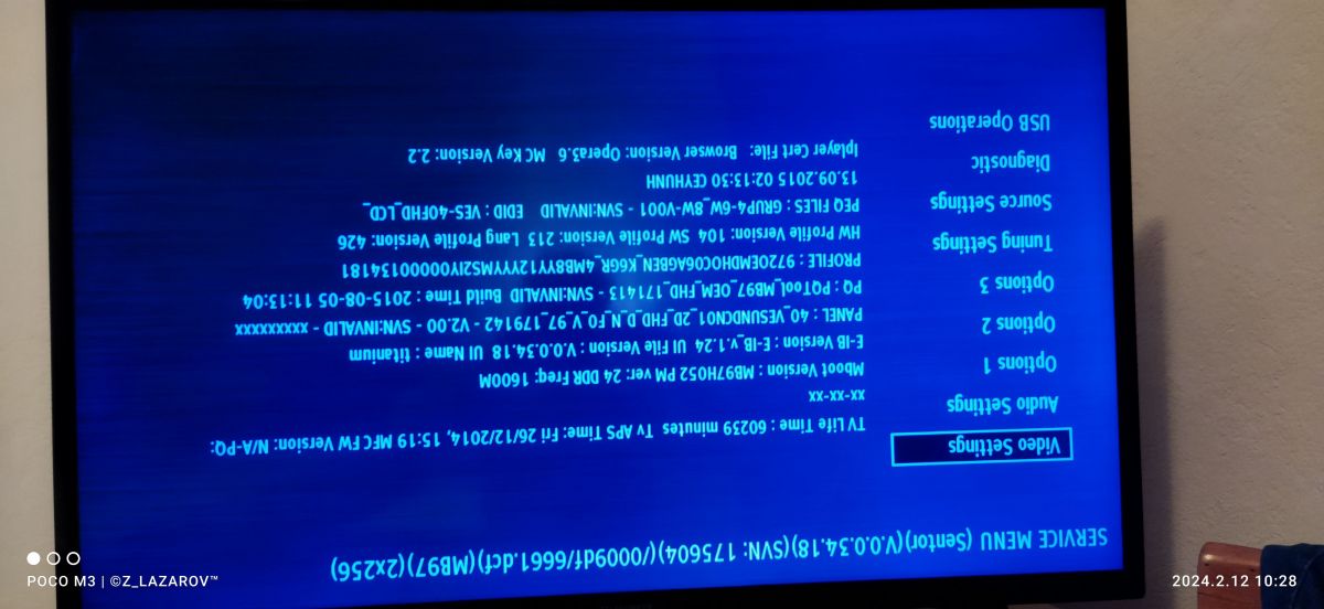

    TV service menu displayed upside down on the screen.
    is there any solution for this problem

    you bought a mainboard 17MB97 for a different panel: for VES395UNDC-2D-N01
    your model should mount the panel VES400UNDS-2D-N11, is this correct?

    1. You need the panel profile for the one in the TV.
    2. Save the panel profile from the TV and post here to return the image.

    Cod main (17MBxxx) ??
    Cod panel (VESxxxx-xx-xx) ??.
  • #6 21535923
    auroryus
    >>21535873
    17mb97,
    VES400UNDS-2D-N11,

    #7 21535927
    yokoono51
    Posts: 817
    Help: 172
    Rate: 316
    auroryus wrote:
    >>21535873
    17mb97,
    VES400UNDS-2D-N11,
    1. Format a stick with FAT32
    2. Create a folder called pq on the stick
    3. Unzip and put the 2 files in the folder
    4. Turn on the TV, USB stick and type MENU 4725
    5. Go to USB Operations and type OK on the remote control
    6. Wait 10 seconds and exit the menu (return, back)
    7. Turn off the TV from the remote control
    8. Wait until the stby LED on the TV stops flashing
    9. Unplug the TV and wait until the stby light goes out.
    10. Take out the stick and turn on the TV.
    If the image is not correct, repeat the operation
