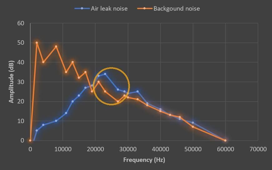

    This is a macro model of our ears' audio imaging in the human audio spectrum not the ultrasonic spectrum using IR sensors where FLIRs become functional with a positive SNR.
    Comparison chart of air leak noise and background noise by frequency.
