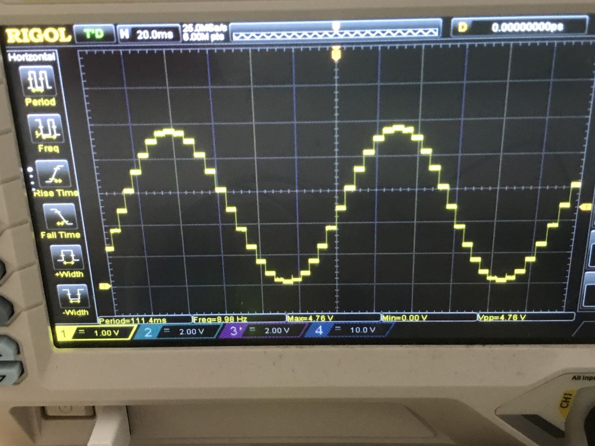

    Arduino R4 has a built-in 12-bit DAC (Digital-to-Analog Converter), which means it is able to generate an analog signal without connecting additional modules. This is a big step forward, because in the case of the older Uno R3 and similar boards we had to connect an external DAC such as the MCP4725 and control them usually via SPI or I2C to obtain a sine wave. And here you can generate it directly from pin A0. In this topic, I will briefly show how to run a DAC on Arduino R4 and take a look at the generated signal on an oscilloscope.
    DAC - sine wave on Arduino R4
    Let's consider an example from the Arduino documentation. This example reads the voltage value from the potentiometer and converts it to the frequency of the generated sine wave on the DAC. The potentiometer serves as a voltage divider, the extreme pins on VDD and GND, and the middle pins on the ADC. Below is its corrected code, because at the time of writing the topic there was an error in the Arduino documentation, the wrong pin was used once - A0 instead of A5.
    Code: C / C++
    The potentiometer is connected to A5, and there is a DAC output to A0.
    The map function, as the name suggests, maps the read value from the ADC, which is in the range from 0 to 1024 (10-bit ADC), to the frequency, the range of which we have chosen is from 0 to 10kHz.

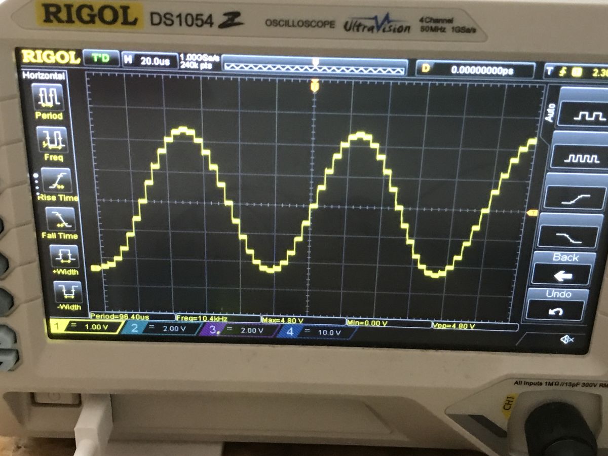

    Here is the result:
    Oscillogram displaying a sine wave signal generated by Arduino R4 on an oscilloscope screen.
    Oscilloscope display showing a sine wave generated by Arduino R4
    The oscillograms show very nicely how the DAC creates an approximation of a sine wave sufficient for many applications. If we want to generate another function, we also have the following options:
