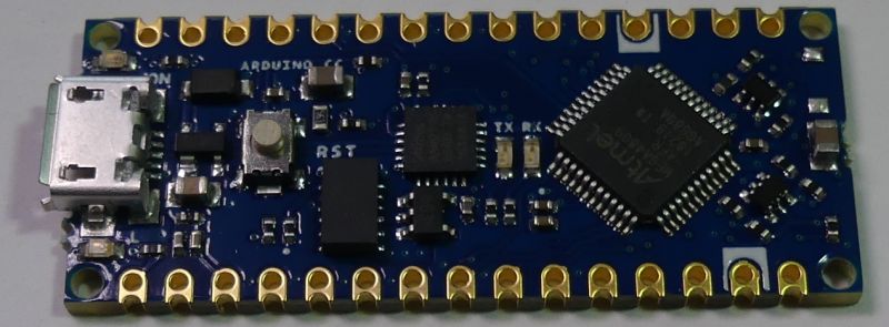

    New Arduino board NANO Every uses a microcontroller ATMega4809 AVR, compared to the previous version nano where it was used ATmega328 . On the Every version PCB you won't find a quartz resonator, due to the clock signal generator built into the microcontroller up to 20MHz. We get more flash memory - 48KB, more RAM - 6KB, and less EEPROM - 256B, input voltage range 6-21V board. USB communication is provided by ARM ATSAMD11D14A. The NANO Every version works with 5V voltage levels as in the previous nano version. The PCB allows soldering glodpin connectors, or surface mounting (SMT) on a larger board (like many RF modules). Pin descriptions are available on the bottom side of the board, which may not be convenient e.g. on a breadboard. The version 1.8.9 of Arduino environment was used for tests with the module.

    In the sketch, we choose the Arduino NANO Every board, and the COM port (emulated on USB), which appeared after connecting the board:
    Arduino NANO Every, review, launch, tests, how to, and.... problems
    We will also find the option of emulating the ATmega328P registers, was it a announcement of possible compatibility problems?
    At the beginning a simple communication test with the board and test LED flashing - the test was successful:

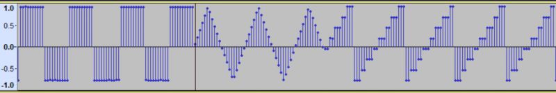

    Let's try to do something more complicated, get SD card and save samples from the analog input, see if there is any problem with library compatibility. We will use RTC interruptions to collect samples from ADC periodically. We have more RAM available, so we will use two buffers alternately filled with data from the ADC, and then saved to a file on the SD card. In this way, a voltage value recorder at the ADC input will be created, with data saved to a file on the SD card. We will sample the voltage quite slowly, 256 times per second. One of the available reference voltages "INTERNAL4V3" was chosen for the test, so we can record voltages in the range 0-4.3V, with a theoretical resolution of 10b.
    The board works with 5V, so we need an SD card adapter matching voltage levels and providing 3.3V power for the card.
    We connect the SD card pins with the module pins:
    CS - D10
    DI - MOSI
    DO - MISO
    SLCK - SCK
    Code: C / C++
    Sine wave voltage 10Hz 4.3Vpp conected to input A0, and the data was stored in the file on the SD card, this can be visualized e.g. in the audio program Audacity. We can import raw data (16bit, big-endian, 1 channel). After standardization you can see a sine wave:
    A simple system for recording voltage changes works:

Edge case: what happens if I enable PWM on pin D11?
AnalogWrite() compiles but outputs only a static HIGH or LOW because the pin’s timer channel is absent on ATmega4809. This silent failure can break motor drivers [Elektroda, TechEkspert, post #18151489] Double-check pin capabilities before deployment.
Which ADC reference voltages can I select?
Options are DEFAULT (5 V), INTERNAL1V1, INTERNAL1V5, INTERNAL2V5 and INTERNAL4V3 [Arduino Reference]. TechEkspert used INTERNAL4V3 to log 0–4.3 V signals [Elektroda, TechEkspert, post #18151489]
