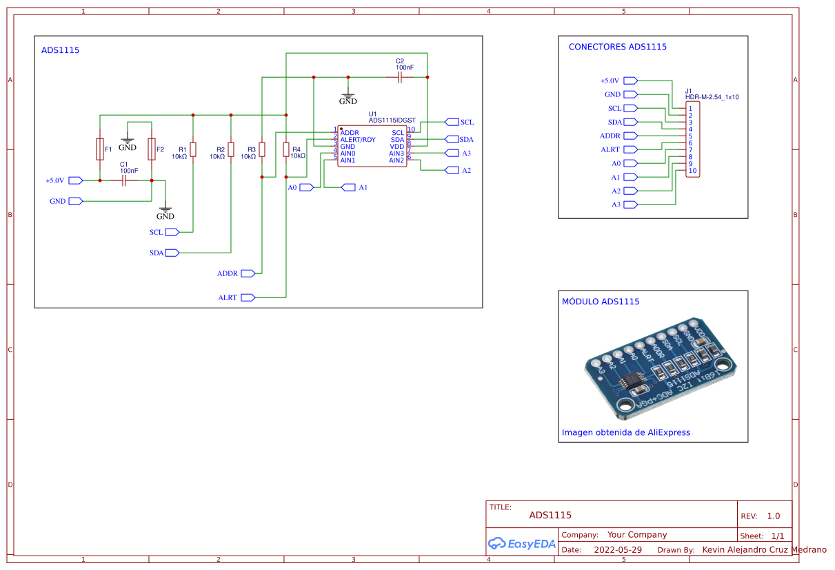

    I have included a diagram of the popular commercially available ADS1115 module below:
    Electrical schematic of the ADS1115 module with visible connections and pin list. .

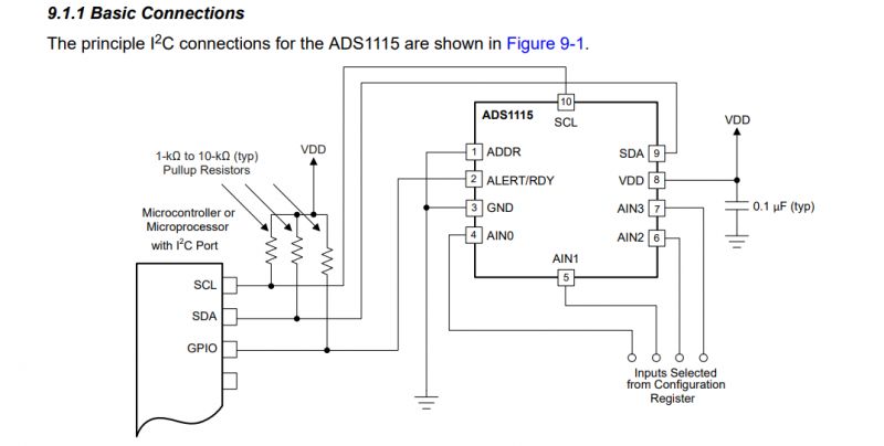

    Connecting the finished module is really very simple, as everything needed is already present on the board. The I2C bus requires resistors pulling up the SDA and SCL lines to supply power, but the finished module has these resistors already present on board. For this reason, connecting the whole thing comes down to using four wires, power (2.0V to 5.5V), ground, SDA and SCL.
    If using hardware I2C, check which pins on our MCU board have this role. The Arduino UNO SDA is at A4 and SCL is A5.
    If you are planning to make your own board, then you can base it on the schematic from the datasheet note:

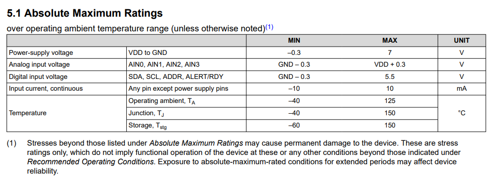

    When connecting the inputs, care must also be taken to ensure that the voltage on them does not exceed the supply voltage of the entire module. This is specified in the catalogue note, section "Absolute Maximum Ratings":
    Table showing the maximum ratings of ADS1115 .
    The commercially available ADS1115 module has no additional protection on the board.

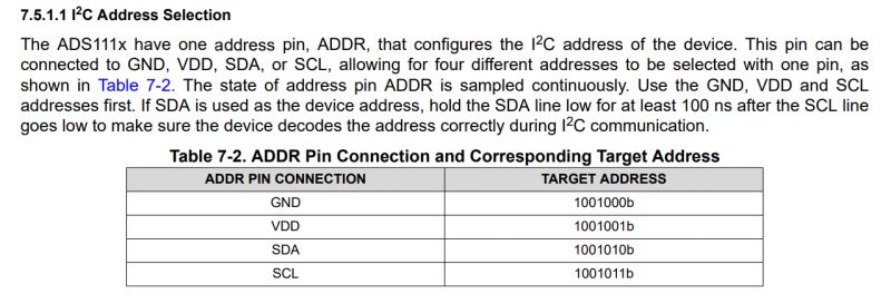

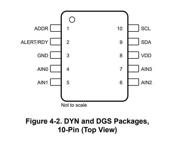

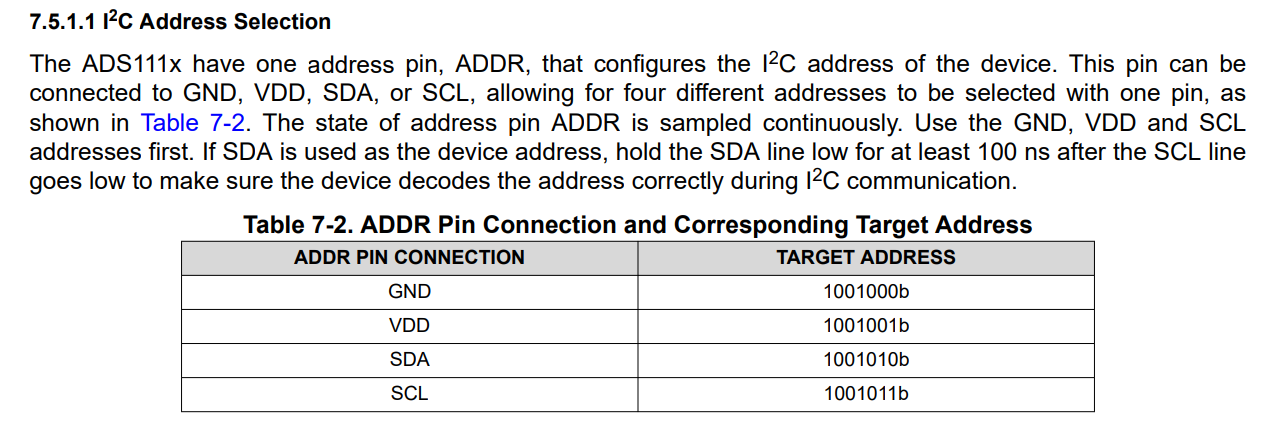

    How to select the address of the ADS1115? .
    It would seem that one ADR pin would be two address options - because it can be connected to either the high or low state - but no:
    ADS1115 package pinout diagram .
    Here we have 4 options - because you can still connect the ADR to SCL or SDA:
    I2C address selection table for ADS111x. .

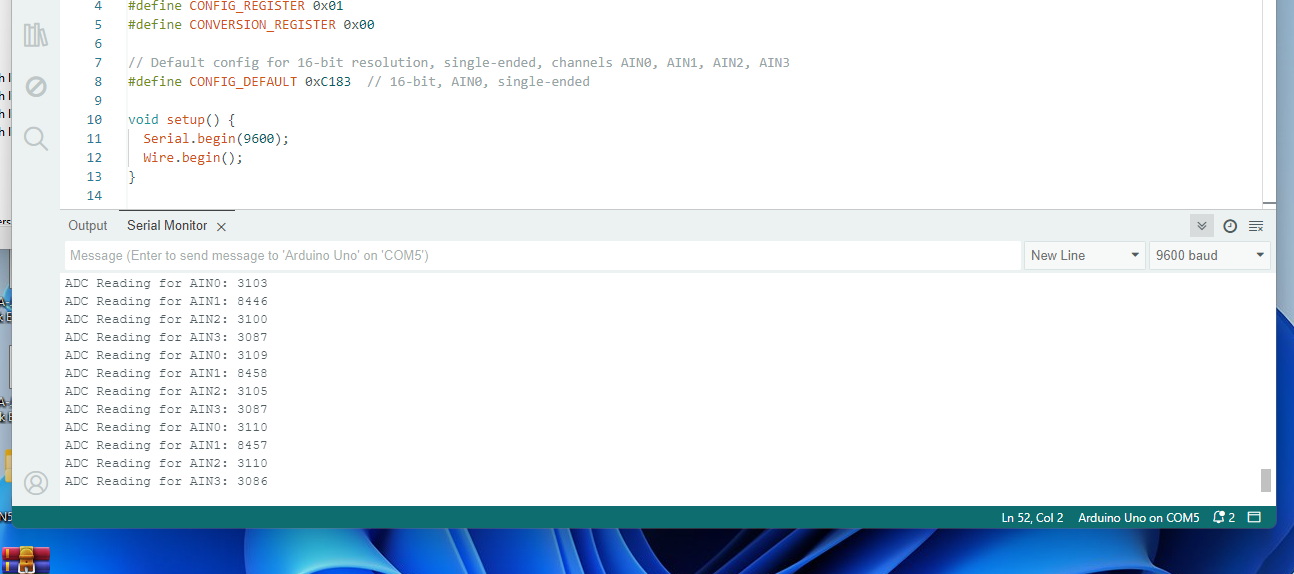

    First step 1 from the documentation is executed, i.e. the writeConfig function. It defines the operating mode and the channel to be read. Then steps 2 and 3 are performed, i.e. reading two bytes from CONVERSION_REGISTER.

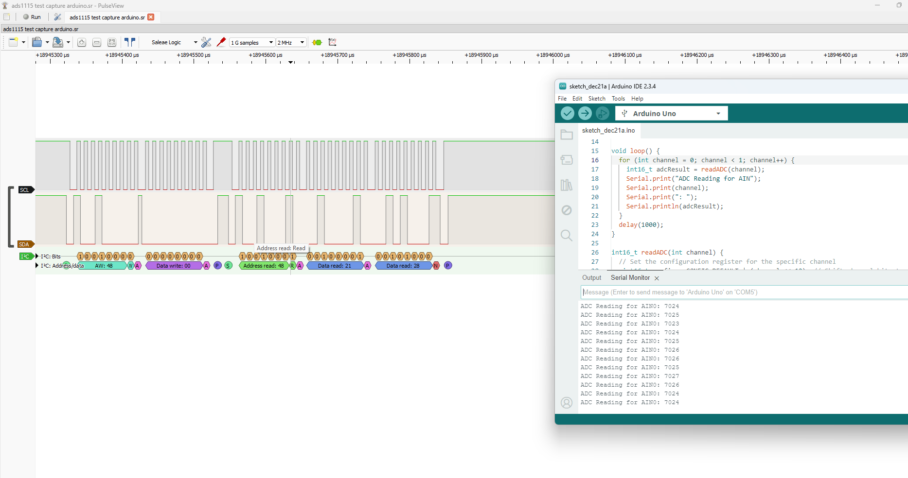

    The result:
    Serial Monitor displaying ADC readings for channels AIN0, AIN1, AIN2, AIN3. .
    Visualisation of communication with ADS1115 .
    The communication can be viewed with the Sigrok analyser:
    Screenshot from PulseView software showing I2C communication with ADS1115 module and view of code in Arduino IDE. .

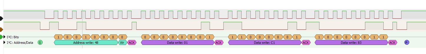

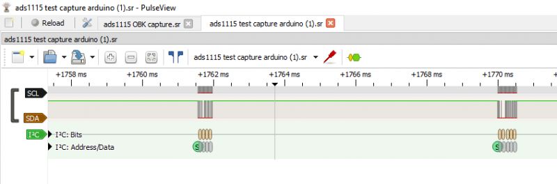

    There is an 8ms interval between stages to allow the module to convert:
    Screenshot showing a captured I2C transmission using ADS1115 in PulseView. .

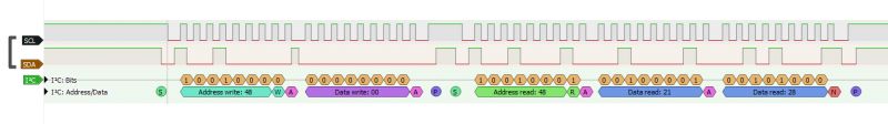

    The first stage is to send data to the configuration register at address 0x01, in this case 0xC183 is sent to it. All contained in a single transaction, preceded by an I2C start condition and ended by a stop:
    Analysis of I2C data transmission from ADS1115 on a logic graph. .
    The second stage is the readout. Here, separately after the start we send the register address to be read (this is a write, so the 0x48 device address is with Write - 0 bit), and then separately (after the stop and start) we send the 0x48 device address with Read - 1 bit and read two bytes. After the first byte read there is an ACK, because we want to read further, after the second one there is already a NACK:
    Screenshot showing I2C signals on the communication bus for the ADS1115 module. .

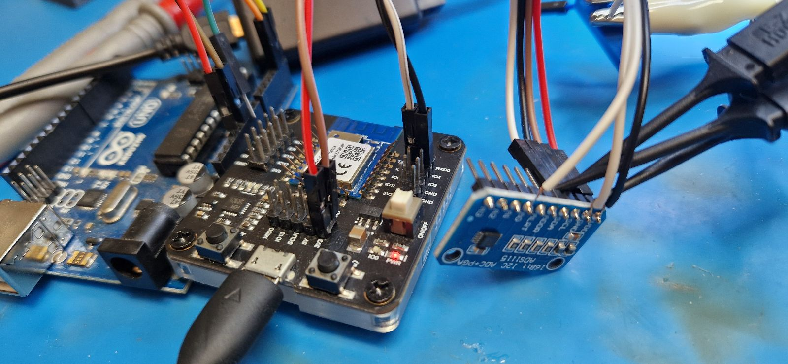

    Running with BK7231 .
    We've also run the ADS1115 with the BK7231, so you can also easily report its measurements to Home Assistant, but I'll put the details in a separate topic.
    ADS1115 module connected to various boards, including Arduino. .
