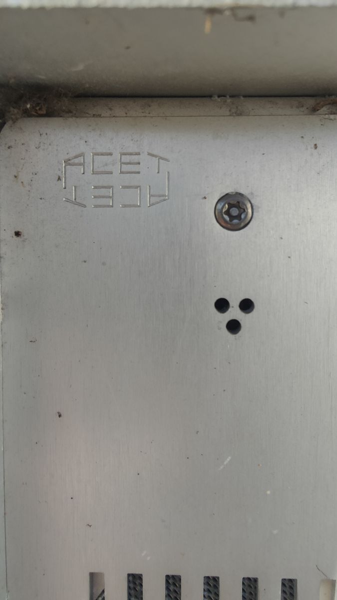

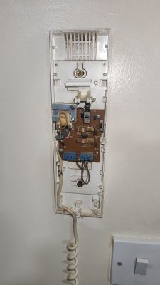

    Acet unifone replacing with Cyfral 2017 version.
    Can anyone help if this is possible, to replace the old ACET phone with the Cyfral 5P it is a 2017 version so somewhat different to the latest ones available.
    The current system has 2 wires connected to the phone for all audio and lock release function, and the buzzer noise I think is created by the master station at the main door rather than the handset? Horrible noise. And there is a second pair that are connected in the wall but not connected to the phone system.
    It also has a trade button which allows post man etc to open the door 8am til 4pm which activates the lock release from a button on the call panel.
    3 flats in the block and a 4 button control panel one button for each flat and one trade button.

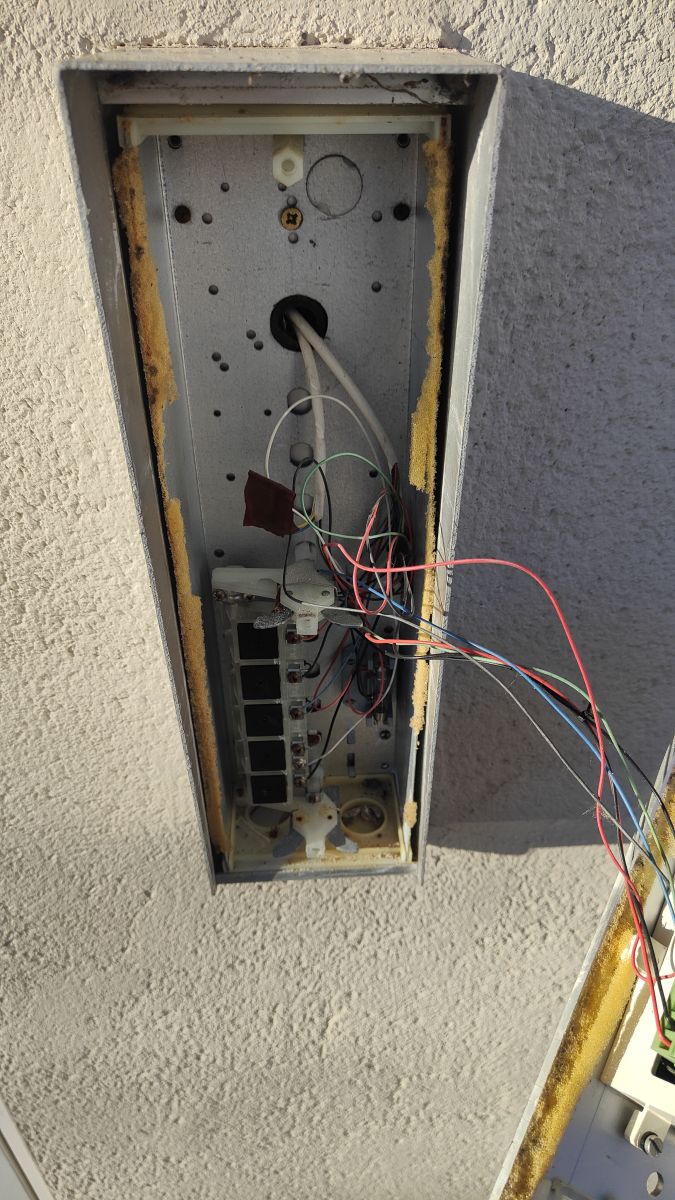

    CONTROL PANEL MAKE
    Close-up view of a metal plate with the inscription ACET and a screw.
    INSIDE CONTROL PANEL
    Interior of a metal intercom panel box with wires and connections.
    CONTROL PANEL WIRING
    Side view of a device interior with connected wires.

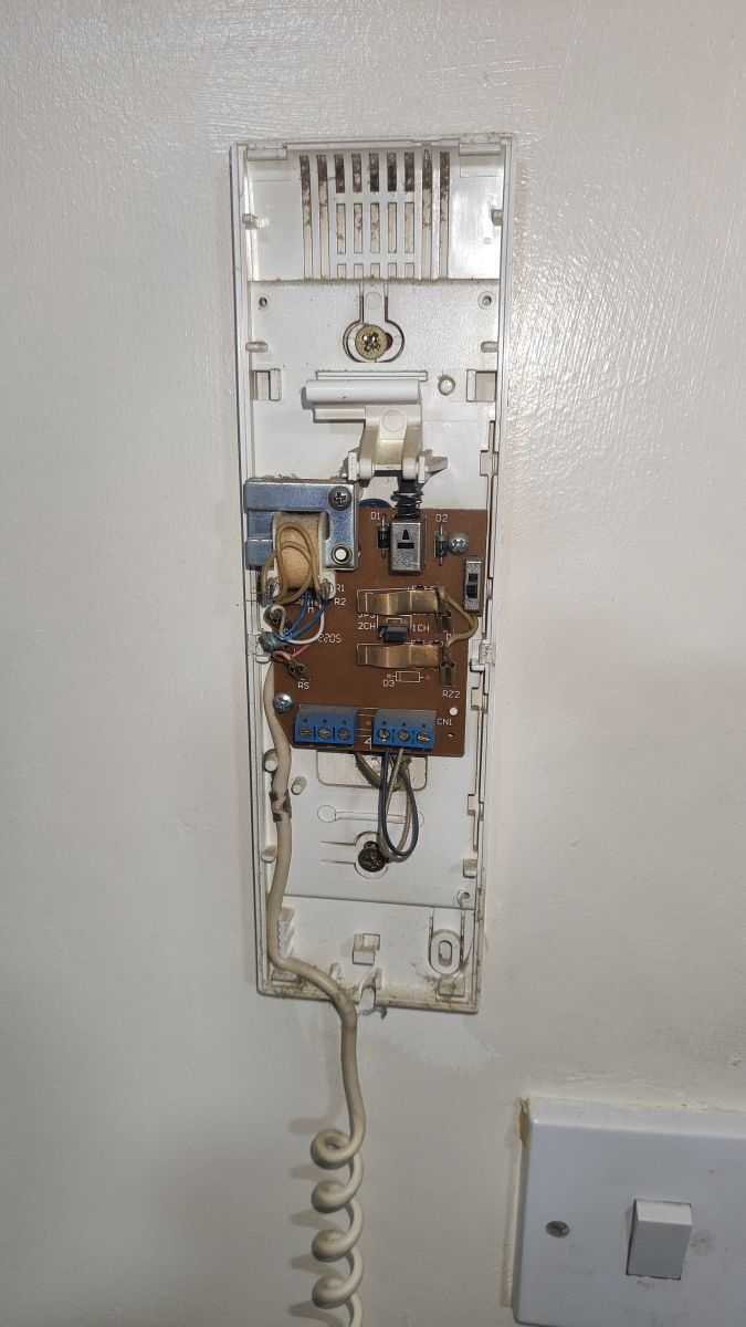

    ORIGINAL UNIFONE
    Interior of an open intercom panel with visible electronic components and wires.

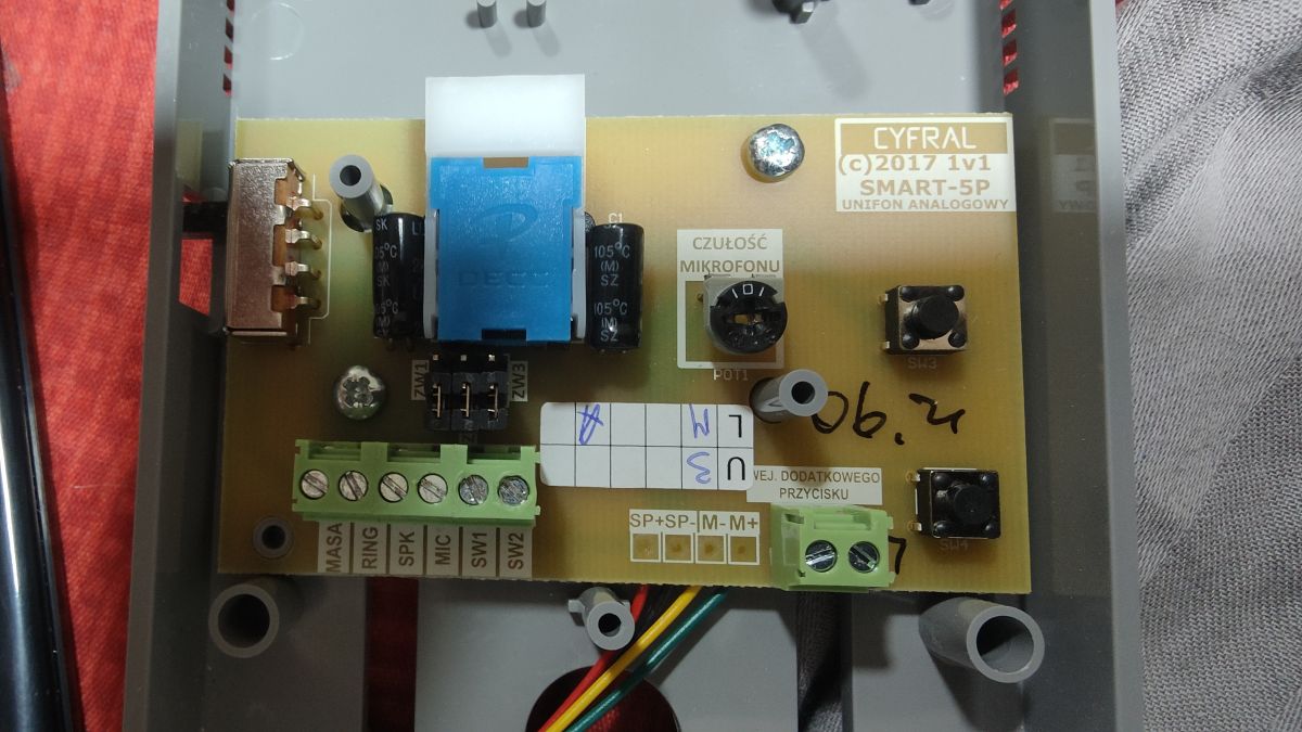

    BOARD INSIDE CYFRAL 5P
    Interior of Cyfral 5P intercom showing circuit board and wiring.
    Is it possible to use this replacement or do I need a different one?

    AI: What is the make and model of the control panel you are using with the current system?
    ACET TONNA 21228 ?

    Is the installation site the UK?

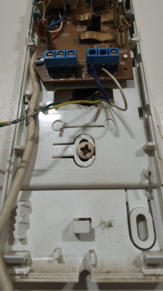

    This could be a pair from 'ringing'. Show close-up photos of the uniphone terminals.
  • Missing terminal 4 indicates a 2-wire intercom system
    #3 21388317
    simcor2010
    Yes it is in the UK.
    It should say there is a pair aka yellow and green in this case that are soldered together but not connected to the uniphone. They are just left inside the hole into the wall as shown in picture I've pulled them out.
    Interior of a technical casing with visible terminals and wires.
    The terminals are literally numbered 1 to 6 and number 4 is missing the connector, I believe 2 wire systems have the 4 connector missing and 5 wire systems have the connector in the uniphone.

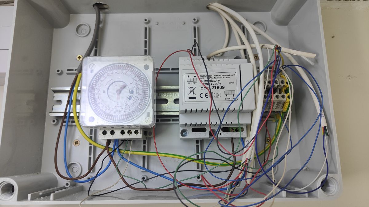

    Non-descript grey box is indeed part of the system but just seems to be a power supply.
    Awful wiring whoever did the wiring should be ashamed of themselves. Built 2006 for info too.
    Electrical box with a timer and power supply along with wires.
    The timer unit is connected presumably so that provides power during the set times for the trade button to release the lock on the door.

    simcor2010 wrote:
    Is it possible to replace the old ACET phone with a Cyfral 5P
    No

    I found the manual for this intercom. In fact, it is two-wire.
    • Acet-22220-_2-zice-interfonska-slusalica-sema-prikljucaka.pdf (1.39 MB) You must be logged in to download this attachment.

    #9 21388951
    Ircys
    Intercoms specialist
    Posts: 6971
    Help: 1342
    Rate: 2085
    simcor2010 wrote:
    Can you elaborate on why not?
    Because it's a uniphone for a completely different system than you need.
    Don't look for a Polish replacement, because there isn't one.

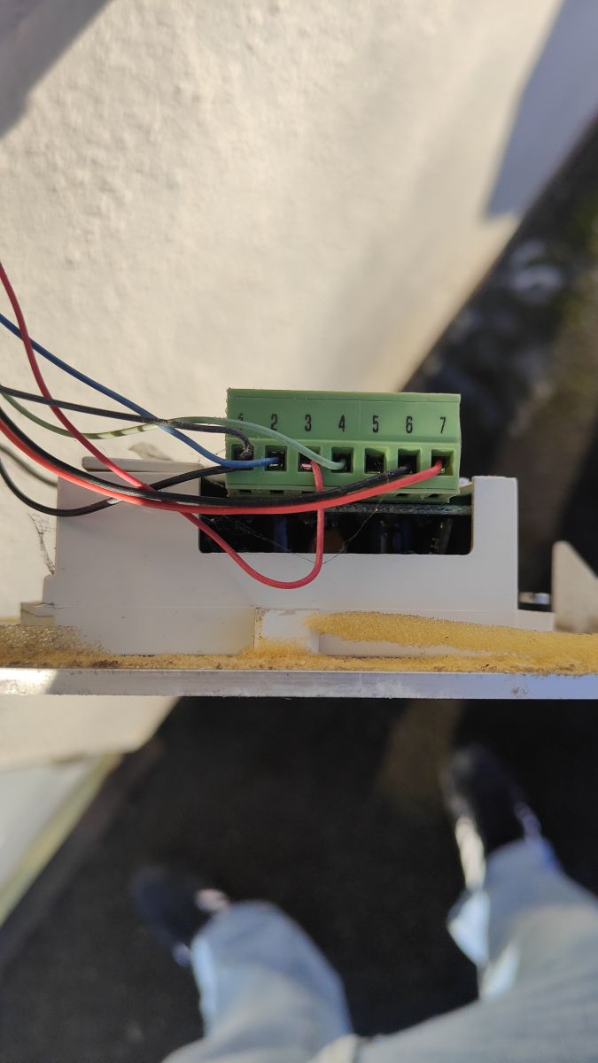

  • Ring intercom works without the unifone
    #10 21389335
    simcor2010
    It isn't possible, so I have to replace it like for like.
    Update on this, I bought a ring intercom interface which wired up allows me to answer the intercom via my mobile phone. That appeased me for a while but I still hated that ugly white/beige uniform. So I decided to try removing the phone completely and see if the ring intercom box worked still, and it does work fine.
    So the unifone is gone, it does have the drawback off
    A power outage or WIFI going down then I won't know anyone is at the door, but that's a compromise I can live with.
