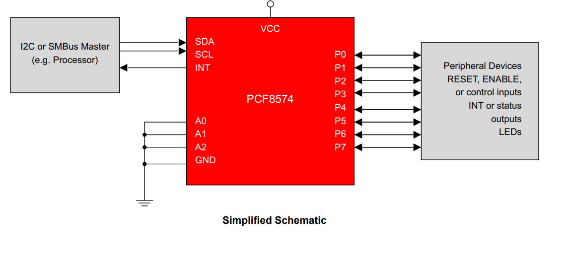

    Consider the leads of the PCF8574:
    PCF8574 schematic with I2C bus. .

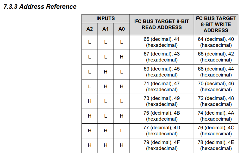

    SDA and SCL are the mandatory I2C lines, this is what we control this chip with. P0-P7 are the legs of the circuit we control, they can be in the role of digital inputs and outputs. Pins A0, A1, A2 allow us to change the address of a given PCF piece, so we can connect more of them on one bus:
    I2C address table for PCF8574 with inputs A2, A1, A0 settings. .

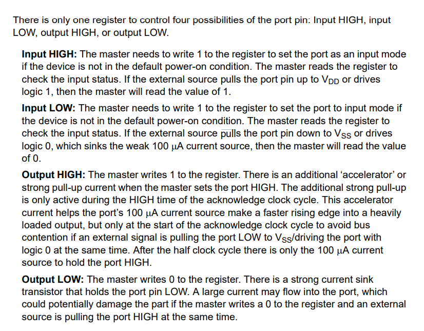

    The PCF offers four GPIO modes of operation:
    Description of four port operation modes in PCF8574. .

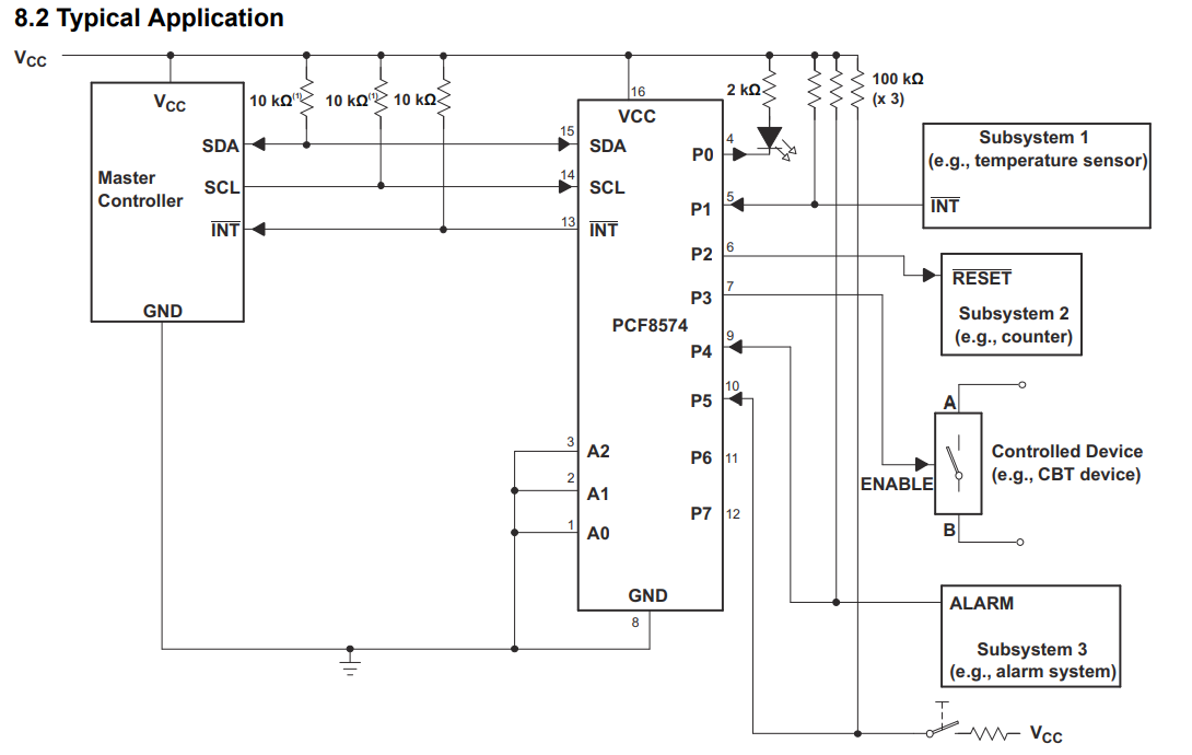

    For more advanced users, it is also useful to provide a more detailed schematic, which also takes into account the line pull-up resistors from I2C:
    Diagram of PCF8574 application with connected resistors and devices. .

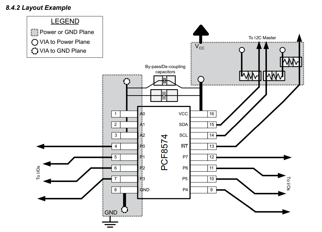

    Out of curiosity, I should add that the catalogue note also proposes a PCB layout for the expander:
    PCF8574 connection schematic .

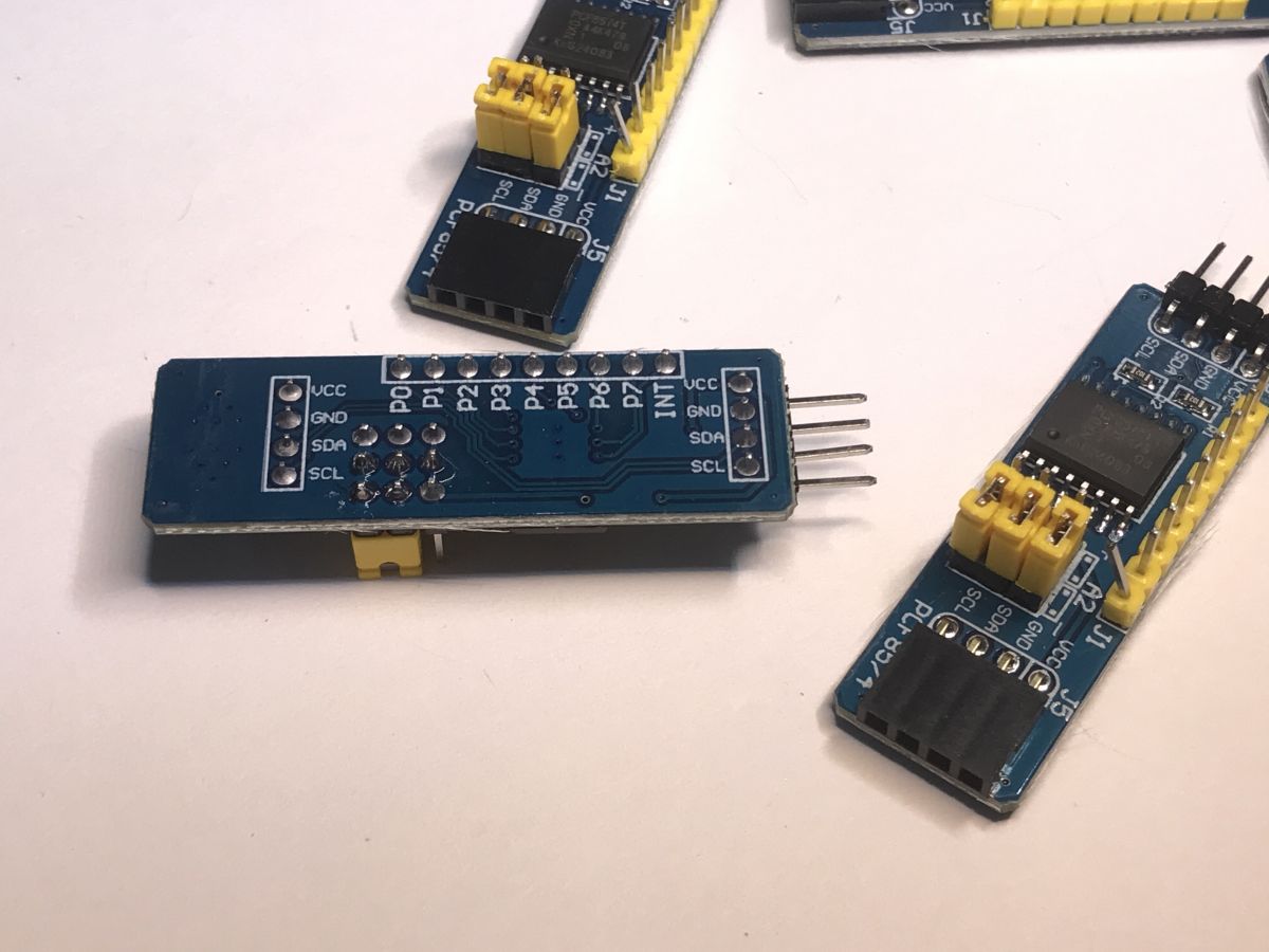

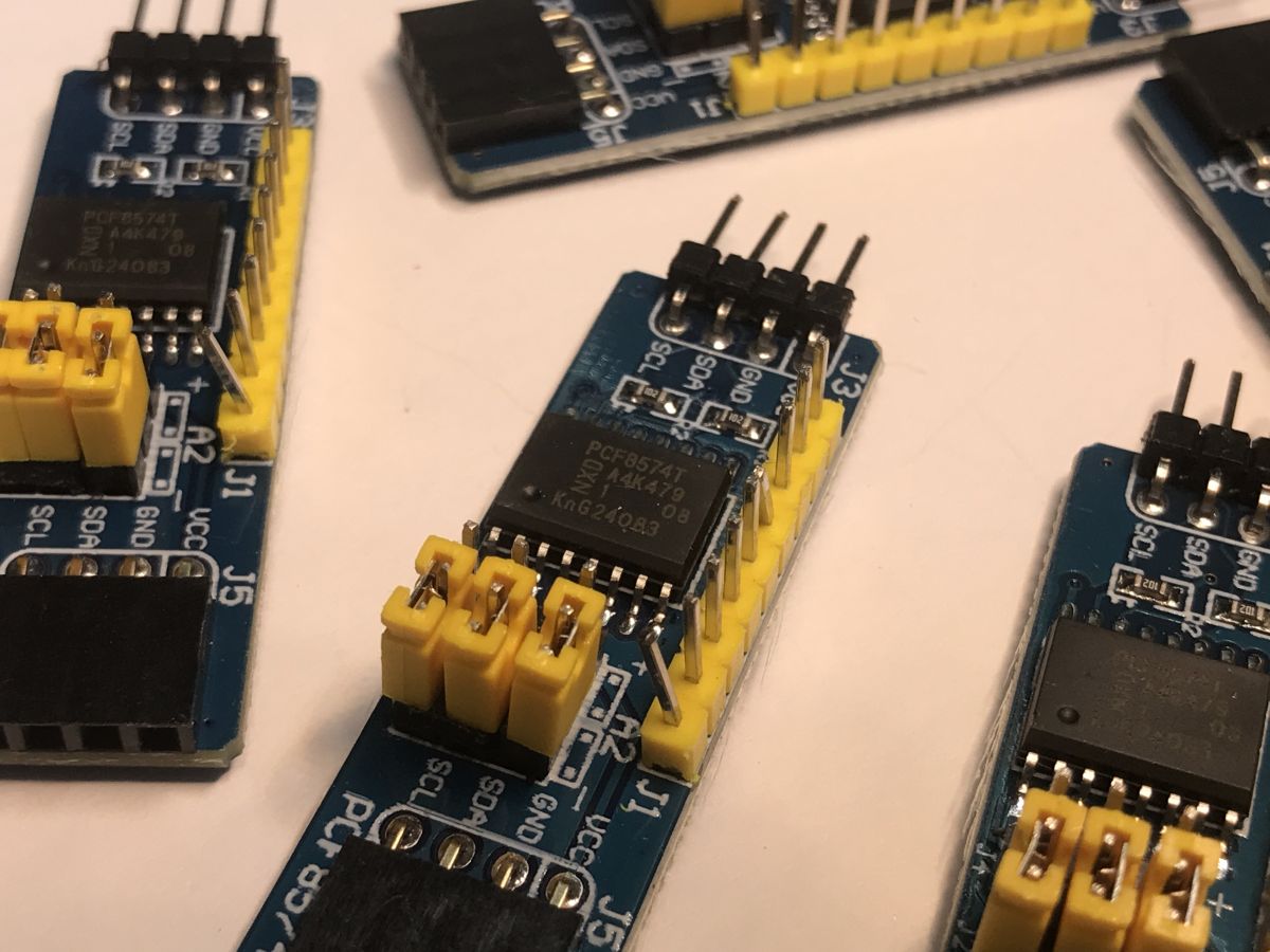

    The commercially available PCF8574 module outputs all its legs on goldpins, which relieves us of the need to solder. All IO, interrupt output, address pins and the I2C bus are routed out - and on both sides. The aforementioned pull-up resistors are also on board.
    Several PCF8574 modules with exposed goldpins .
    PCF8574 modules with yellow connectors on a white background .
    PCF8574 modules on prototype boards. .

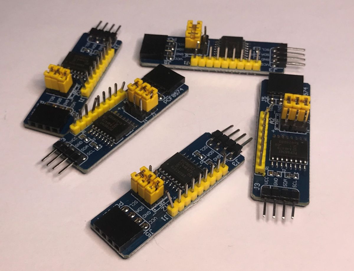

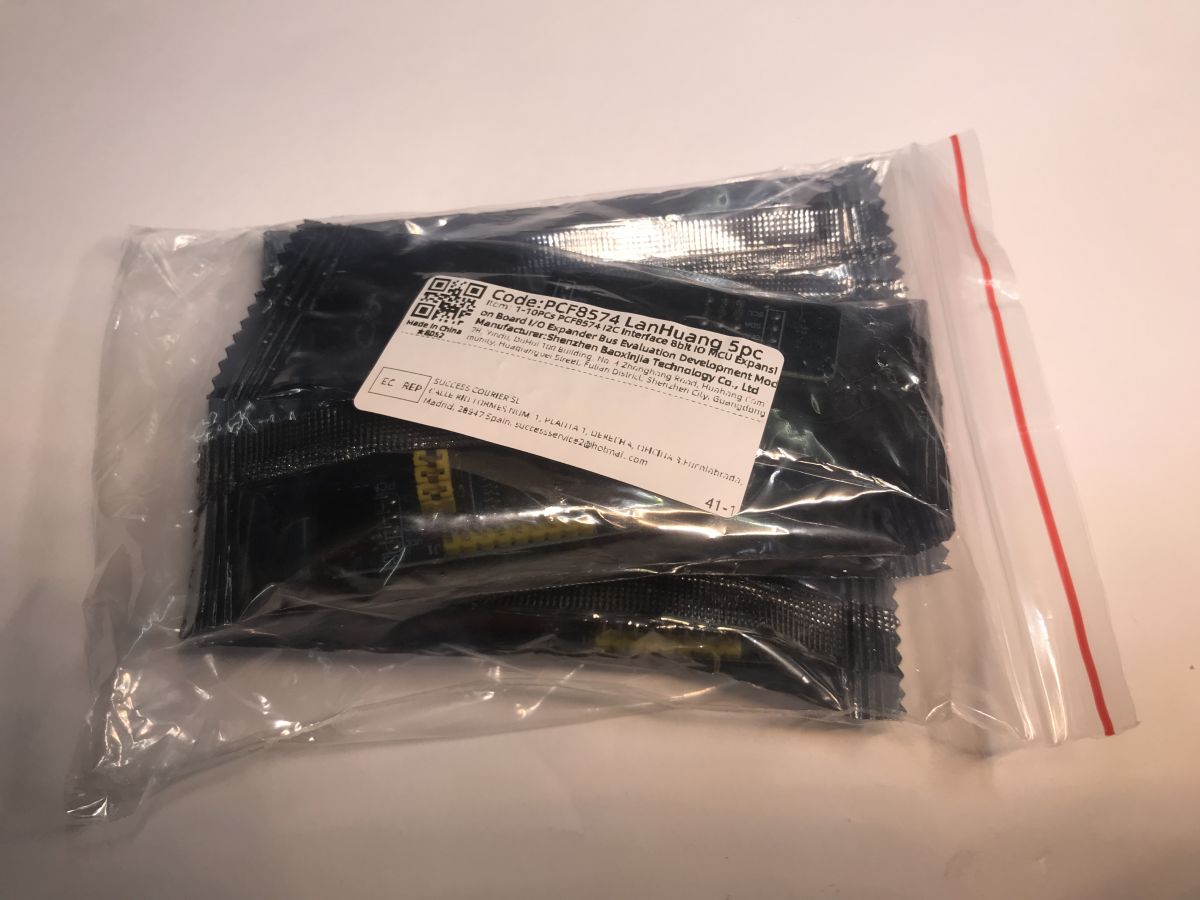

    You can get the module for a few zlotys. By importing from abroad you can even get 5 pieces for 10-20 PLN, depending on the promotion.
    Image of five PCF8574 modules on a white background. .
    Set of PCF8574 modules packed in transparent plastic bags. .

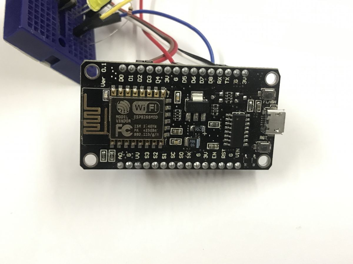

    As a rule, I've done this type of demonstration on an Arduino, but this time I was tempted to use a NodeMCU with an ESP8266. It will come out almost the same anyway, but in my opinion PlatformIO is a bit more convenient than the Arduino IDE, and knowledge of Visual Code is also useful for other languages. Recall the topic where I already presented PlatformIO:
    Clock on ESP12 and MAX7219 display - tutorial - part 1, ArduinoOTA, basics .
    How to program a Wemos D1 (ESP8266) board in the shape of an Arduino? ArduinoOTA in PlatformIO
    Plate used:
    ESP8266 module connected to a breadboard. .

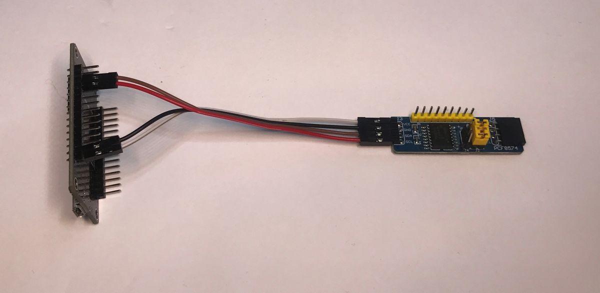

    Using the expander is very straightforward, but users often get lost through the I2C addresses. For this reason I always suggest running an I2C scanner to start with. This simple program will verify our connections and display the I2C addresses of the devices connected to the bus. This will tell us if at least hardware-wise the situation is ok, as it is easy to swap SCL with SDA or connect something wrong....
    Here is my connection:
    PCF8574 module with connected wires. .

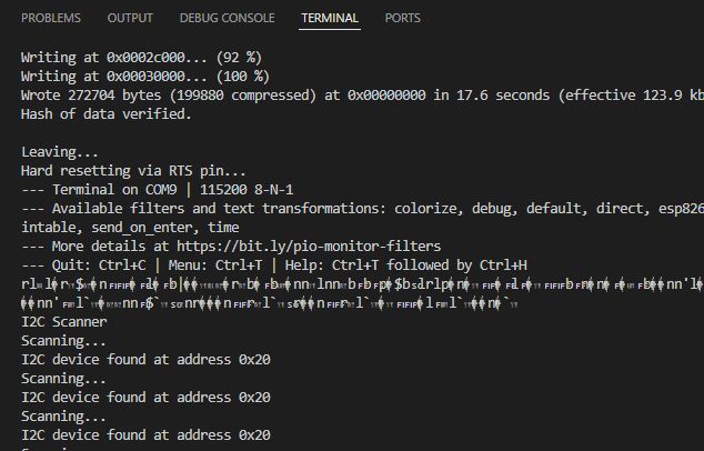

    Well, and the aforementioned scanner:
    Code: C / C++
    It works, the layout address is seen:
    Screenshot of a terminal showing I2C scan results. .

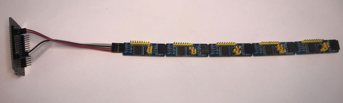

    Now the same thing, but for five expanders with different addresses. The connection is trivial:
    Image of eight PCF8574 modules connected in series. .
    Result:
    Scanning...
    I2C device found at address 0x20
    I2C device found at address 0x21
    I2C device found at address 0x22
    I2C device found at address 0x24
    I2C device found at address 0x26
    All expanders are seen.

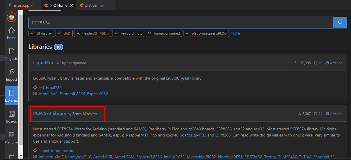

    Add the PCF8574 library .
    I've discussed adding a library in PlatformIO before, but basically it's done via Libraries, just click through. Type PCF8574 in the search engine and add preferably the same result as in my screenshot (by Renzo Mischianti):
    Screenshot from PlatformIO showing the PCF8574 library by Renzo Mischianti. .
    The search engine can also show beforehand a library from a 2x16 LCD controlled by the PCF8574, but we care about the PCF8574 control itself. We will run the LCD another time.
    You can see examples of the library when adding it, but I've also put together some simplified demonstrations myself below.

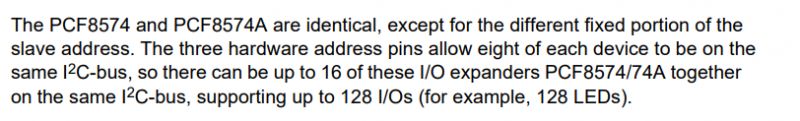

    Can even more outputs/inputs be connected? .
    A version of the chip with different addressing is also available on the market, giving us a total of 128 controlled pins:
    Information about I/O expanders PCF8574 and PCF8574A. .

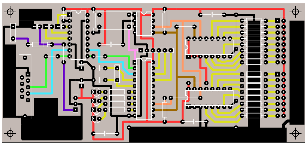

    :) Many years ago tasha developed a very cool ⇨ LXT chip ⇦ I even have a slightly modified board for it ;) .
    Diagram of an LXT electronic circuit with colored paths.

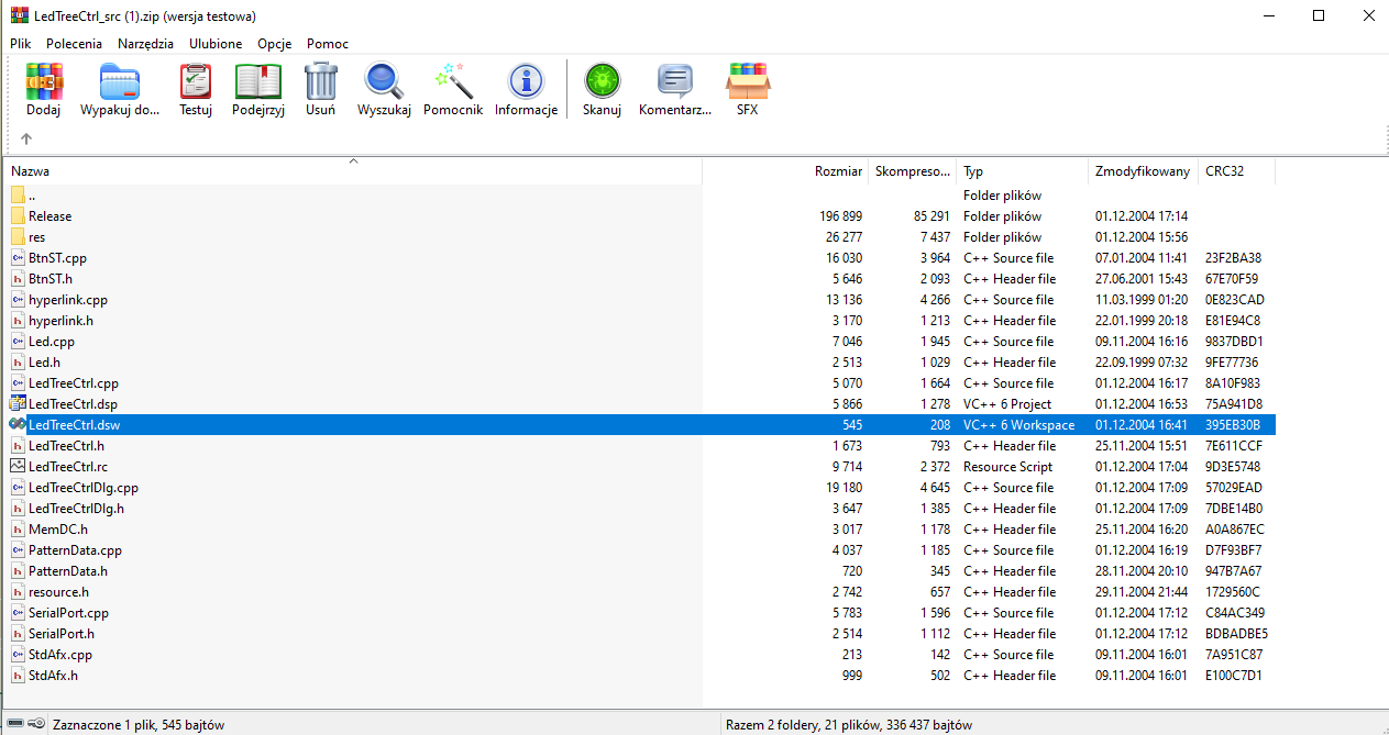

    Nice project, a pure classic. I opened the attachment and see files dated 2004:
    List of source files in ZIP file management software. .
    Still that MAX232... I remember running the MAX232 back in my school days and being surprised by this electrolytic capacitor connection, which is deliberately reversed in polarity. At the time I thought that I might still use RS232 in this form, but since then I have only been riding on USB<->UART converters.

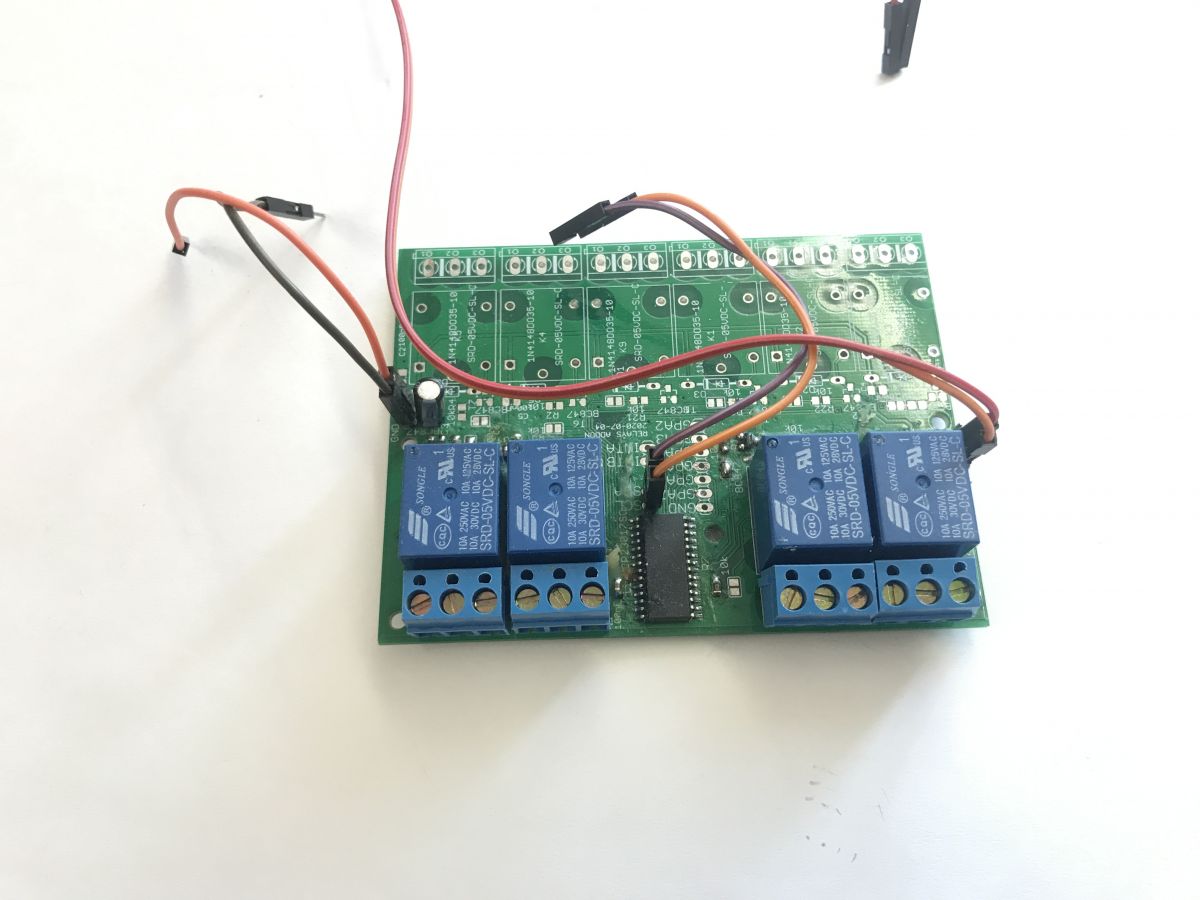

    I myself once did a project based on MCP23017, there are 16 pins there, but the rest is quite similar to PCF:
    Circuit board with relays and wiring. .
    This is the expansion board for:
    Home Assistant/Tasmota HTTP compatible relay controller + housing .

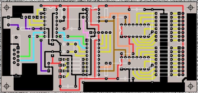

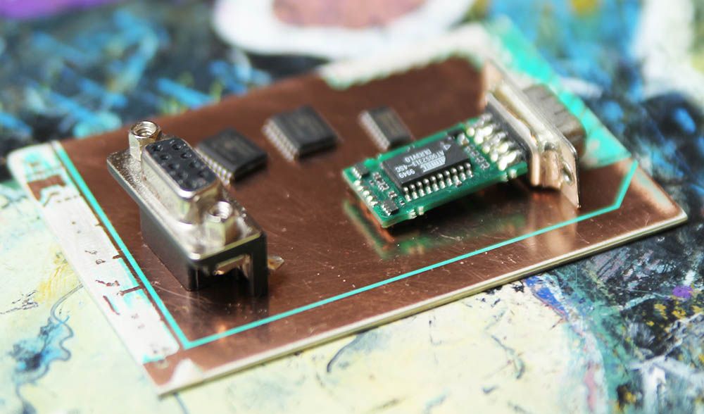

    :) I didn't want to give the exact date because women generally don't like the subject of age being brought up ;)

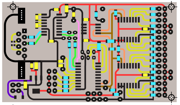

    As it happens, that I'm going to do this layout in a few days :) My version will be SMD . with a choice between MAX3232 and USB ;) .
    Here the almost finished board ⇓
    Image showing a printed circuit board design with colorful traces.
    PCB with electronic components on a colorful background.
    Collected parts and board ⇑ ;) .

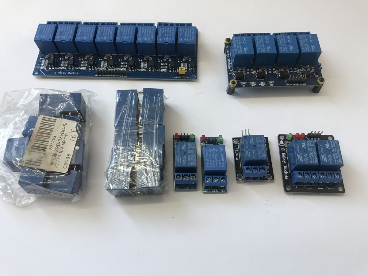

    What method are you using to make the PCB and how do you ultimately want to organise the LEDs? As far as I can see the original design is a bit lacking in some final effect already, where the LEDs are actually somehow arranged in the title "christmas tree", I don't know, on some mini-tree :D .
    Although nowadays it's probably simpler to go for WS2812 and the cheapest MCU anyway, maybe I'll do some project where I'll try to drive it with PIC12F. The PCF8574 I would already see more with relays:
    Set of relay modules of various sizes on a white background. .

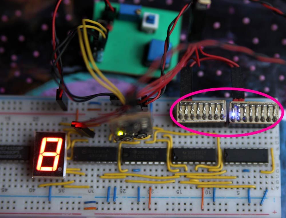

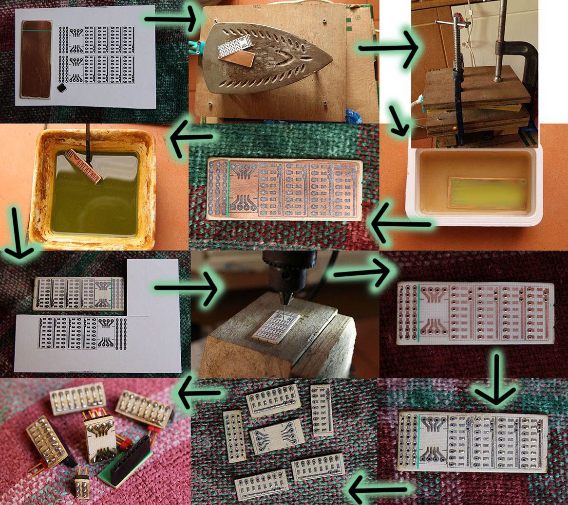

    :) I draw in Illustrator. Then I heat-transfer as shown in the photo ⇓
    The process of producing electronic boards using the iron-on transfer method.
    Breadboard prototype with a 7-segment display and marked I2C pins.
    The layout will be the layout itself for the time being :) The display as in the picture marked with ellipsis ⇑ I have pins I2C , so I can easily view what is happening on the bus ;) .

How do I connect a PCF8574 module to a NodeMCU ESP8266 and run an I2C scanner in PlatformIO to find its address?
Connect SDA to D2/GPIO4, SCL to D3/GPIO0, plus power and ground, then scan addresses 1 to 126. In the shown PlatformIO example, Wire.begin(4, 0) sets those ESP8266 pins, and the scanner prints any responding address as 0x20, 0x21, and so on.
  1. Wire SDA, SCL, VCC, and GND.
  2. Start I2C with Wire.begin(4, 0) and open Serial at 115200.
  3. Loop through addresses and print every device that returns error == 0.
The author’s first module appeared at 0x20. [#21397809]

How do I set the A0, A1, and A2 address pins on the PCF8574 so I can use multiple expanders on one I2C bus?
Set A0, A1, and A2 to different logic states so each chip gets a unique I2C address. The thread explains that these three pins change the address, allowing up to 8 PCF8574 chips on one bus without collisions. In the demonstrated multi-device scan, five expanders were detected at 0x20, 0x21, 0x22, 0x24, and 0x26, showing that not every address must be consecutive. If two modules share the same A0-A2 pattern, the bus will not distinguish them cleanly. [#21397809]

How can I blink an LED from a PCF8574 output using the Renzo Mischianti PCF8574 library in PlatformIO?
Create a PCF8574 object, set one pin as OUTPUT, call begin(), and toggle it with digitalWrite(). The thread uses Renzo Mischianti’s library, creates PCF8574 pcf8574(0x20, 4, 0);, sets P0 to OUTPUT, and then writes HIGH and LOW every 1000 ms. The author also notes using an LED with about 300 ohms series resistance to avoid damage. If begin() prints OK, the address and wiring are correct enough for the blink test. [#21397809]
What does the I2C pull-up resistor do, and when can I rely on the pull-ups already built into a PCF8574 module?
The I2C pull-up resistor holds SDA and SCL high so open-drain bus signals can switch cleanly. The thread includes a schematic that explicitly shows the I2C pull-ups and then notes that the ready-made PCF8574 module already has those resistors on board. That means you can often rely on the module’s built-in pull-ups in a simple single-bus setup, especially when using the exact board shown. Still, the author recommends scanning first, because a working scan confirms the bus is electrically correct. [#21397809]

How many total pins can I expand with PCF8574 devices on one I2C bus, and how does the alternate address version increase that limit?
You can expand to 64 pins with 8 standard PCF8574 chips, and to 128 pins when you add the alternate-address version discussed in the thread. Each chip contributes 8 configurable I/O, and all share the same 2-wire I2C bus as long as their addresses do not collide. The author states that two controller pins can handle up to 8 PCF8574s simultaneously, then doubles that total by combining them with the alternate address variant. That scaling is the main reason the part stays useful for relay banks and larger button or LED groups. [#21397809]
