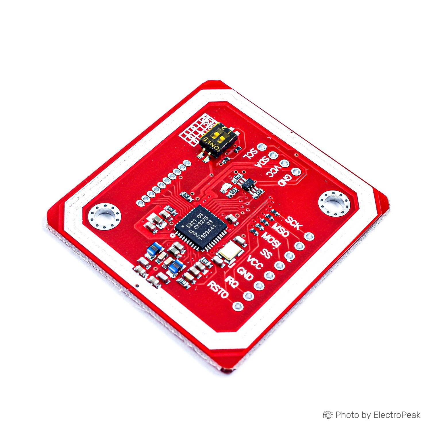

    I have a PN532 RFID reader
    RFID reader PN532 on a red PCB board .
    I have used it before, connecting it to an Arduino Nano. Now I have switched to ESP32, specifically ESP32-S3-WROOM-1, and a problem arises. In I2C mode, the scanner detects the reader, but in no way am I able to read any tag. Example program on I2C:

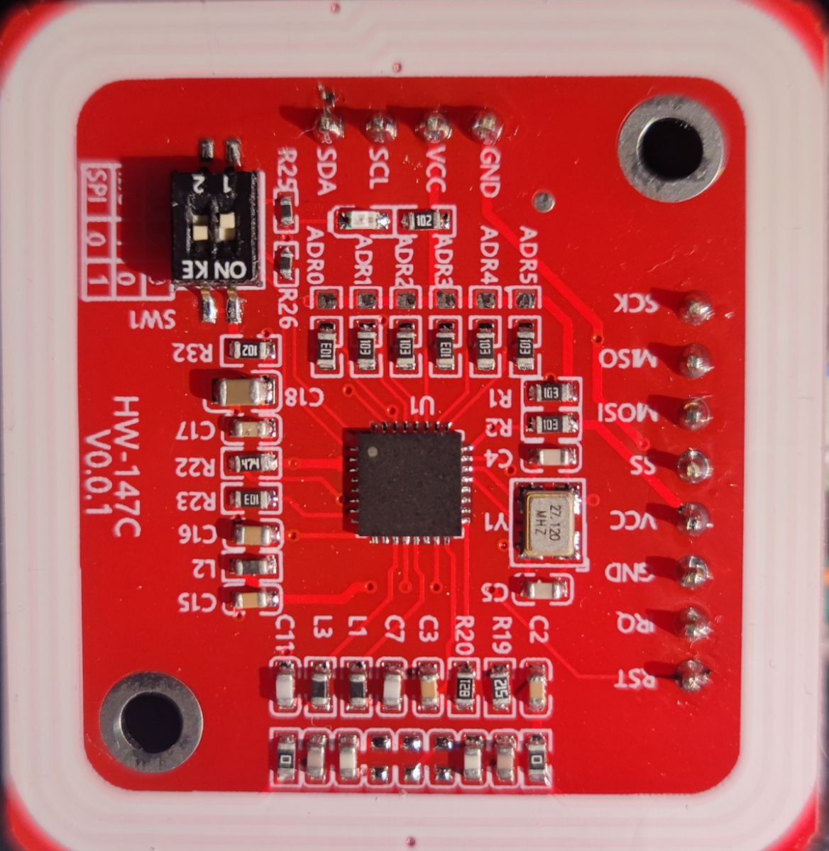

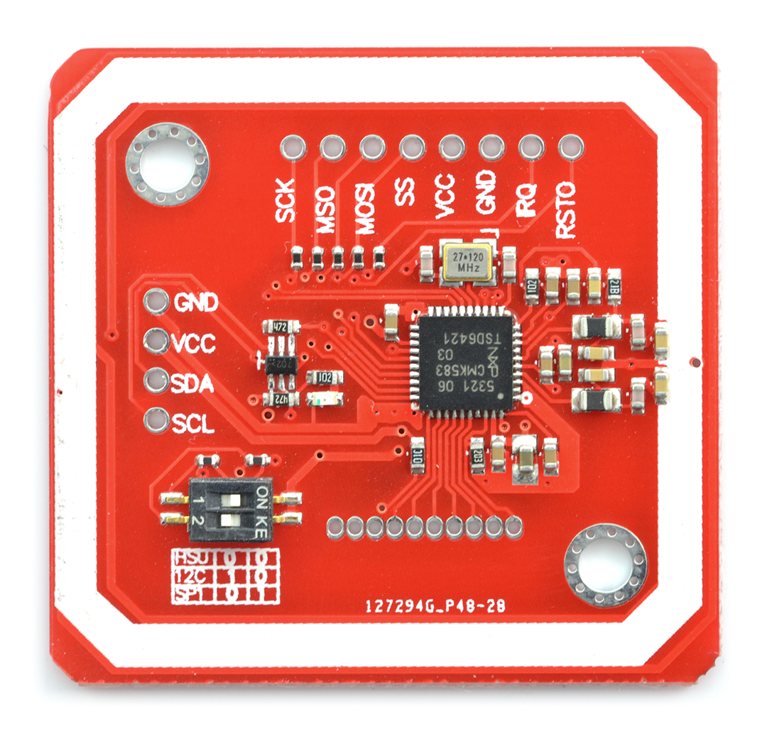

    Here it is straightforward to identify these resistors:
    Electronic module with a red laminate, featuring integrated circuits and connectors labeled GND, VCC, SDA, SCL. .
    However, on my board it is no longer so colourful and it seems to me that the scl and sda go straight to the circuit:
    Red printed circuit board with various electronic components, including resistors and an integrated circuit. .

    Adding the 2.35k pull-up resistors, unfortunately only caused it to stop detecting anything on the scanner. I would like to communicate with this reader in any way possible
