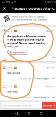

    Here it says which module should be selected in the settings
    ESP32 - Timed out waiting for packet header at BME280
    Then I will try to change the drivers as my colleague Faber writes
