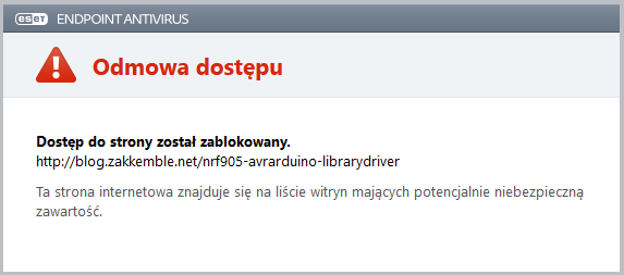

    I found a library to support this module for arduino, from the website
    http://blog.zakkemble.co.uk/nrf905-avrarduino-librarydriver/

    Just as a quick aside, I also tested RadioHead. I don't know which solution is worse. For a while I thought about writing my own library, but I don't have time for that. The solution on the lowest line of resistance. An additional Arduino nano to connect to the Radio. It works...
