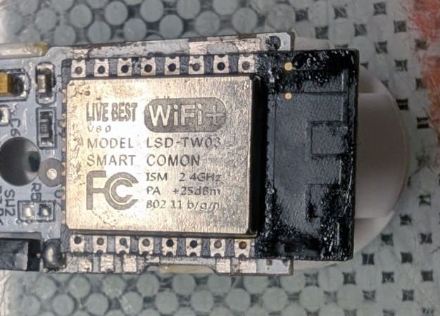

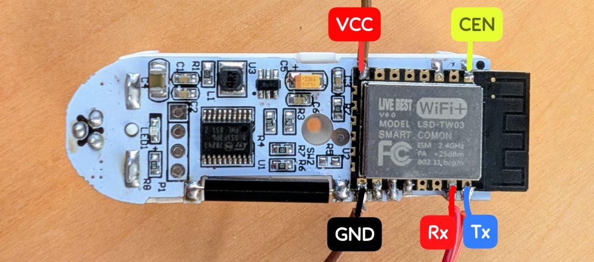

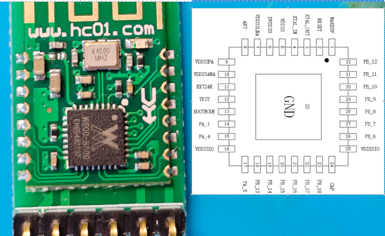

    Hey everyone,

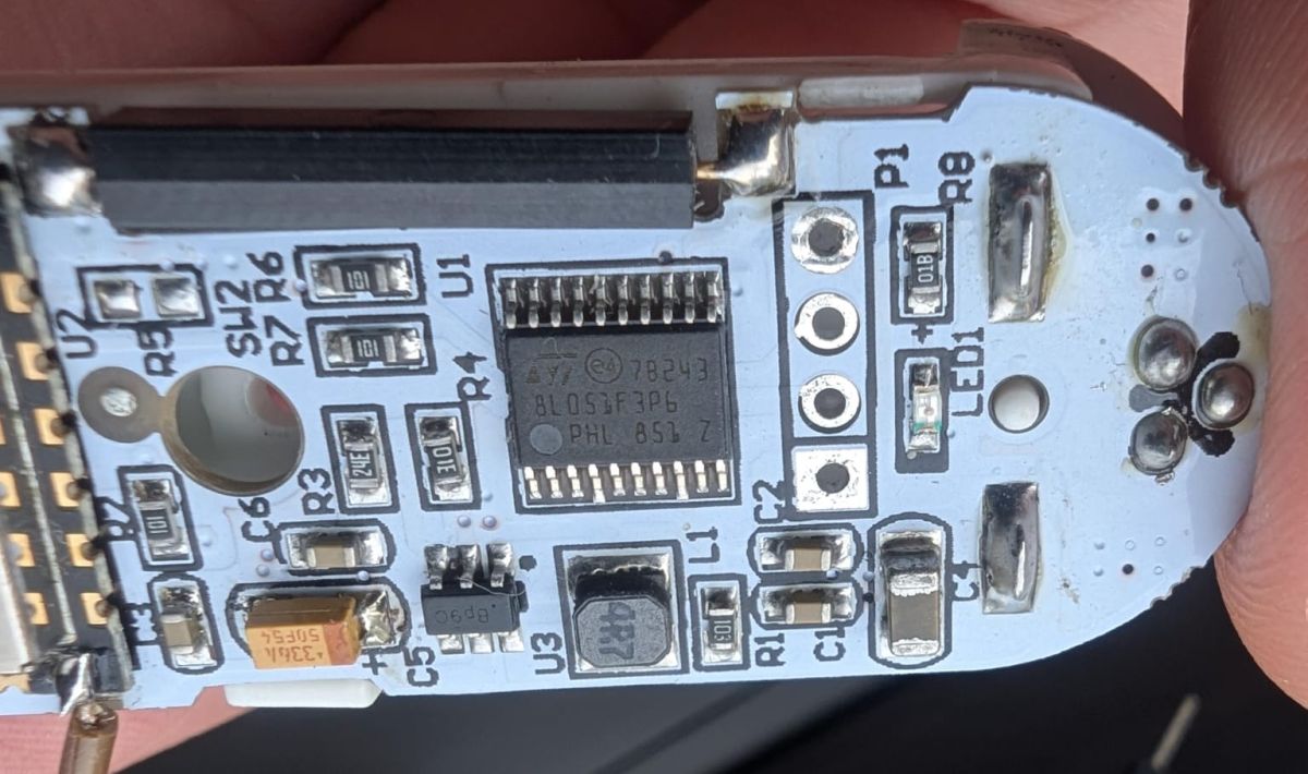

    I'm trying to flash an ancien "Live best" door sensor (LSD-TW03 / W601 chip). This sensor uses a reed switch, not cheap Hall.
    Printed circuit board with LSD-TW03 WiFi module and labeled VCC, GND, Rx, Tx, and CEN pins.
    I mostly followed this (using the GUI tool).
    Flashed OpenW600_1.18.110.fls successfully, but got a bootloop (no AP).
    Did an "Erase Flash" then flashed OpenW600_1.18.109.fls, still a successful flash, but same bootloop (no AP).

    AI: Can you share exactly which flashing tool (name and version) and settings (e.g., baud rate, erase options) you used during the flash process?
    Flashed with "Upgrade_Tools_V1.5.9.exe" from https://github.com/openshwprojects/FlashTools
    Baud rate 115200, tested with and without "erase flash" option.
    AI: What power source are you using to power the sensor during flashing and boot? (e.g., USB, battery, voltage/current specs)
    External PSU @ 3.3v durring flash and normal use. Also fresh LR03 on live test, as intended by sensor.

    interesting. Don't see many W600s appear. Is the behaviour any different if powered from the battery terminals instead?
    But also, is that an ST 8L053F396 (cant really see it) MCU on the board?
    the only Google result for that: https://www.st.com/resource/en/datasheet/stm8l051f3.pdf
  • #3 21571186
    Posts: 14797
    Rate: 12954
    How good are your soldering skills? I would first try to desolder WiFi module and check outside circuit. It's a battery powered device. It may be doing external resets of WiFi module, so it's better to be 100% sure before we proceed with investigating.

    It's an old sensor on duty since 2022. As far as I remember it is Aubess branded. Slightly differs from similar in the external rounded shape.
    However, the behavior is pretty much the same regardless of the power source. I've tried both the external PSU and the battery terminals, and it's still stuck.
    Interestingly, after my last flash (with 1.18.110 again), the log no longer shows the AP creation message, and it's not even bootlooping anymore.
    But still no AP to connect to, so no way to get to OBK.

    And yes, you're spot on about the MCU – it's an ST 8L053F3P6.
    Close-up of a PCB with electronic components, including an integrated circuit, resistors, and capacitors.
  • WiFi module likely needs external reset isolation
    I'm still fairly new to soldering, and my desoldering skills are far from good.
    However, I tried to get the module off the board. I put (a lot) of flux on it and cleaned it with brass-threads, but... No way I can get this thing out.
    [W600 / TW-03] Door Sensor - Bootloop on 1.18.110/109 Firmware
    So, before literally burning out the PCB, I resoldered the pins and added the wiring.
    Then I tested @insmod >>21571493 build.
    The boot process hangs at "secboot(1MB) running V3.9...", but maybe that's expected, Idk.

    #12 21577071
    Posts: 14797
    Rate: 12954
    sevenissimo wrote:
    That's precisely why I tried powering the device with batteries, as intended by its design. I was expecting it to be configurable via an AP, but I'm getting nothing. Is that normal behavior for obk?
    If you put in the batteries, as intended by design, and have WiFi module flashed with 3rd party firmware, but don't configure tmSensor driver, then sometime later the MCU will turnon WiFi module for a short time, it will expect a TuyaMCU packet from WiFi module, and upon not receiving it, it will forcibly turn off WiFi modul again.
    This is why I suggest powering WiFi module directly to 3.3V WiFi module pad to make sure that MCU won't turn it off. I also suggested desoldering WiFi module, because MCU may just reset it via RST/CEN/anything, but I am not sure about that.
    If you don't want to desolder the WiFi module, then there is alternative - desolder the MCU. It's possible but tricky, depending on your toolset. Once you desolder the MCU, we will be finally 100% sure whether it's external reset that causes the problem or is it really a power supply issue.

    There is no mosfet on picture, so module is powered off via CEN.
    As for why i don't think it is suitable, it is because it requires a lot of power. More than twice as much as bk7238, and a little more than BK7231T.
  • CEN trace cut to isolate WiFi module
    #14 21577166
    Posts: 14797
    Rate: 12954
    insmod wrote:
    >>21577071
    Oh, fair point. I didn't notice it/I assumed that MOSFET has to be there, because 100% of TuyaMCU products that I had so far had MOSFET used to control the power of WiFi module.
    Well, so if it's using CEN, then whole "power supply bad" discussion is in my opinion pointless. OP just has to either cut CEN trace, or desolder MCU, or desolder WiFi module. I am not sure if MCU and WiFi module has 3.3V connected together and how would device behave if only WiFi module is powered (MCU is unpowered), but still... testing with MCU in circuit is not a good idea.

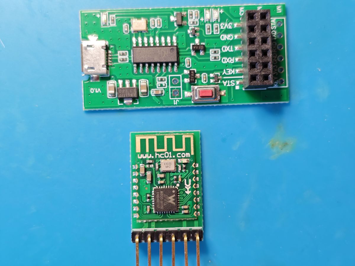

    Posts: 5236
    Help: 450
    Rate: 920
    insmod wrote:
    HC01 W600
    Google search for something I just found and had forgotten about brought me to this thread.
    HC-25 with HC-T TTL adaptor
    https://www.hc01.com/goods/640e91920be12d0114404c99
    is this your module?
    HC-25 Bluetooth module with HC-T TTL adapter on a blue surface
    • HC-25_V1.7.pdf (1.38 MB) You must be logged in to download this attachment.
  • #17 21621517
    insmod
    Posts: 1432
    Help: 168
    Rate: 455
    >>21621485
    This one, but just the module without 6-pin board.
    I will also soon have air602.
  • SWD access on PB6/PB7 and flash dump via J-Link
    #18 21621522
    Posts: 5236
    Help: 450
    Rate: 920

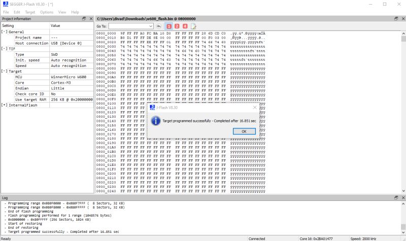

    interesting. PB6 and PB7 are routed out on these for SWDIO/SWCLK
    Electronic module with W600 microcontroller and pinout diagram showing PB6 and PB7
    J-Link Commander connection and dump to file
    • w600_flash.bin (1 MB) You must be logged in to download this attachment.

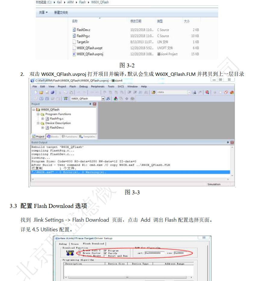

    I notice in the W600 SWD doc there's some flash algorithm file for Keil. Qflash. I wonder if plain SWD read is as good. hmm
    Screenshot of Keil with W60X_QFlash project and JLink Flash Download settings window
    Added after 13 [minutes]:
    https://github.com/RT-Thread/W601_IoT_Board/t...es/Doc/W60X_QFLASH_Driver_for_SWD/W60X_QFlash

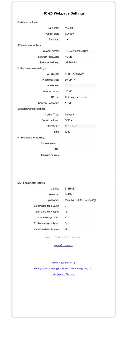

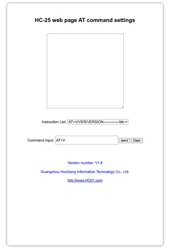

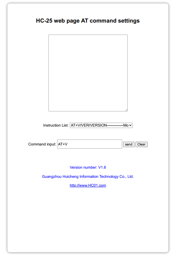

    AT firmware broadcasts AP and a cute little web console
    HC-25 settings page showing serial, Wi-Fi, TCP, and MQTT configuration HC-25 web interface for AT command settings with input field and command list

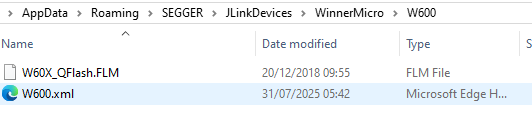

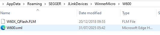

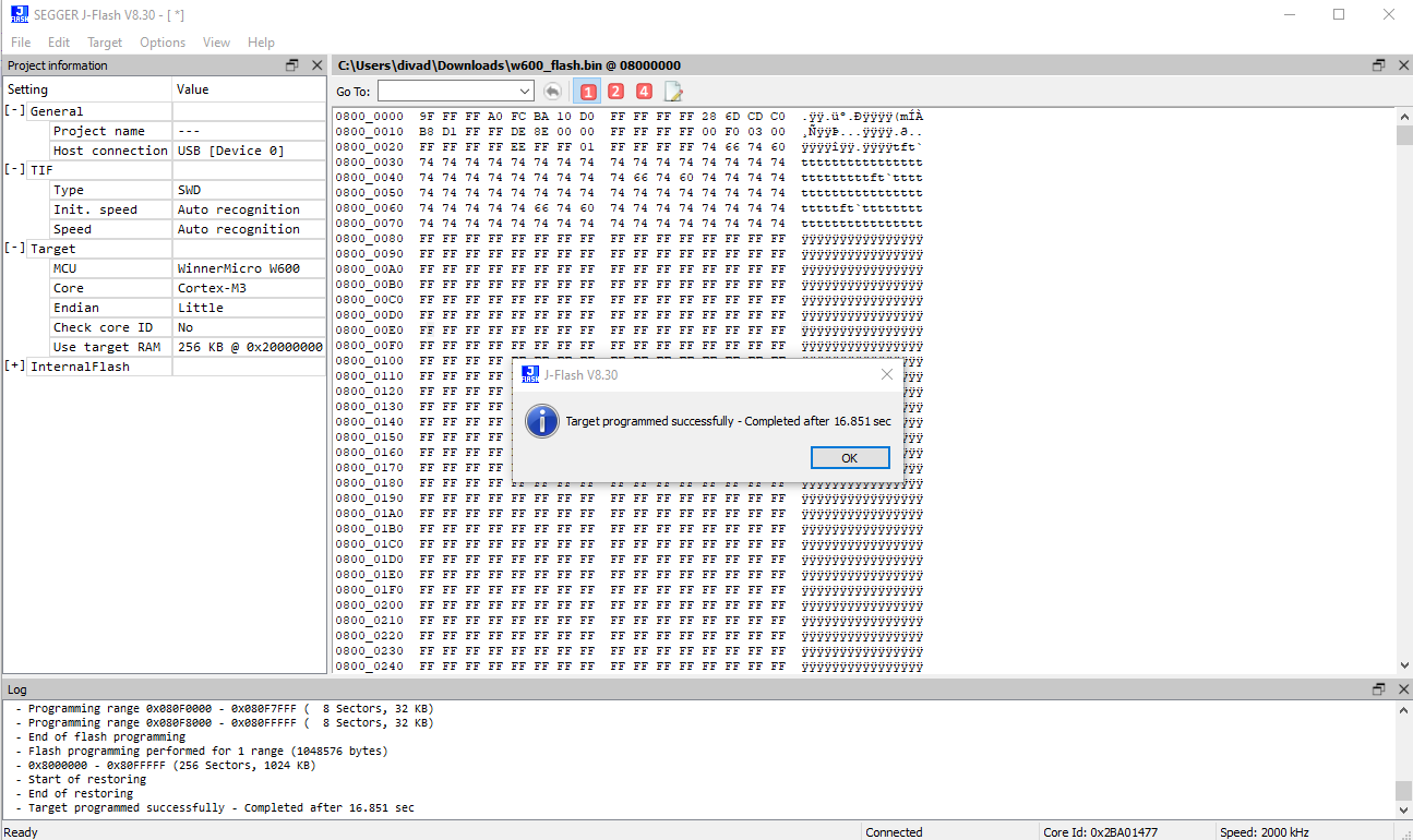

    SEGGER J-Flash window showing successful programming of W600 microcontroller
    Folder showing W60X_QFlash.FLM and W600.xml files for WinnerMicro W600 device
    hmm. write of dump does not appear to result in a restore of working firmware
    Added after 48 [minutes]:
    it's not actually writing. subsequent dumps show OBK code still.

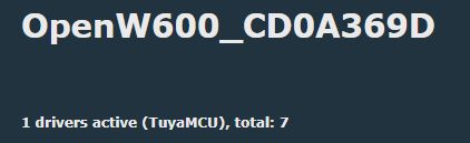

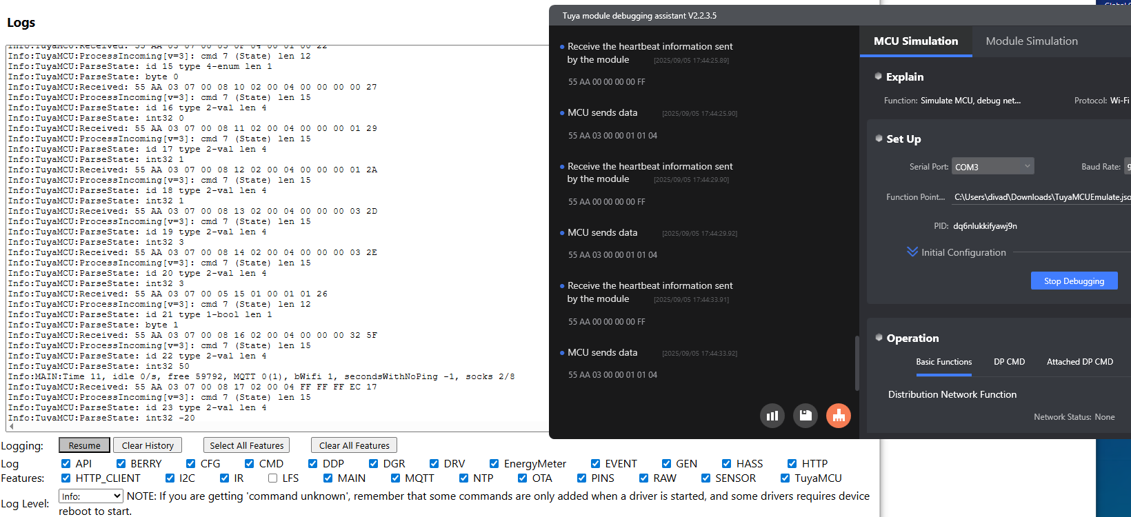

  • TuyaMCU driver starts but no UART responses
    #20 21631550
    Posts: 5236
    Help: 450
    Rate: 920
    regarding the original device in this thread, I was curious to see if TuyaMCU would work. I see the UART column for W600 in platforms.md is a ?
    https://github.com/divadiow/OpenBK7231T_App/actions/runs/16866121168
    driver starts but I'm getting nothing with TuyaMCU Debugging Assistant from either UART, flag 26 or not, using tuyaMcu_sendQueryState. Commands sent from TMDA are not reported by OBK.
    Screenshot of OpenW600 showing one active TuyaMCU driver out of seven

Insufficient 3.3V current during AP creation is the classic cause. Wi‑Fi spikes reset the radio when weak regulators sag. CH340 adapters’ 3.3V rails are often too weak. Use a stronger regulator or an adapter with AMS1117. Keep wiring short and ground solid. Quote: "Bootloop on ap creation means there is not enough power." [Elektroda, insmod, post #21577008]
Why does no AP appear when I power the sensor from batteries?
Your STM8 host likely toggles the CEN line. It turns Wi‑Fi on briefly, expects a TuyaMCU packet, then shuts it off if none arrives. "The MCU will turn on WiFi for a short time and, without a TuyaMCU packet, forcibly turn it off." Power the module directly or isolate CEN to keep it awake for setup. [Elektroda, p.kaczmarek2, post #21577071]
How do I stop the bootloop during AP creation? (3 steps)
  1. Use a solid 3.3V source rated for Wi‑Fi peaks (e.g., AMS1117‑based).
  2. Avoid powering from the CH340’s 3.3V; inject regulated 3.3V at the module VCC/GND.
  3. After flashing, power‑cycle the device before testing AP. These steps stabilize power so AP can start. [Elektroda, insmod, post #21577008]
I’m stuck at “secboot(1MB) running V3.9…”. What fixes it?
Power‑cycle the device after flashing. Use Upgrade_Tools v1.5.9 and try 1,000,000–2,000,000 baud for the download. Ensure a stable 3.3V supply during and after the flash. The maintainer confirmed success at 2,000,000 baud and emphasized power‑cycling before boot. [Elektroda, insmod, post #21576838]
Is “HTTP: Created HTTP SV thread” a real error?
No. Despite the word “Error” in the tag, it indicates the HTTP server thread was created. The log continues normally afterward, showing other subsystems starting. It does not prevent AP creation or Wi‑Fi bring‑up. Treat it as an informational line from this build’s log levels. [Elektroda, sevenissimo, post #21571156]
Which firmware build should I try if 1.18.110/109 bootloops?
Test a newer OpenW600_1629_merge build. Flash with Upgrade_Tools v1.5.9, use 1–2 Mbps, then power‑cycle. A maintainer reported a clean boot with that combination. If power is marginal, the AP step can still fail, so fix power first. [Elektroda, insmod, post #21576838]
Can I use the TuyaMCU driver on W600 right now?
Support was not enabled for W600 in the discussed builds. The host MCU still expects a TuyaMCU handshake, but the W600 build lacked that driver, so no UART exchange occurs. Consider using a BK7238/BK7231T module if TuyaMCU is a must today. [Elektroda, insmod, post #21577053]
What UART pins does OpenBK use for TuyaMCU on W600 builds?
PB6 and PB7 are the default UART pins in the W600/W800 HAL. Choose modules that expose PB6/PB7 or remap in code if your board lacks these pins. [Elektroda, insmod, post #21631725]
What is the CEN pin and how does it affect bring‑up?
CEN is the Wi‑Fi module’s enable/reset. The STM8 can assert CEN to shut the radio down if it doesn’t see Tuya traffic. To keep Wi‑Fi alive for setup, isolate control. "Cut CEN trace, or desolder MCU, or desolder WiFi module." [Elektroda, p.kaczmarek2, post #21577166]
Will the “LFS is absent” message block setup?
No. It means the internal filesystem and autoexec.bat are missing. The firmware still boots other services and can create the AP once power and control issues are handled. It does not cause a bootloop by itself. [Elektroda, sevenissimo, post #21576968]

Can I dump or restore W600 firmware over SWD/J‑Link?
Yes, you can read 1MB over SWD with J‑Link Commander, but writing may require the W60X_QFlash algorithm. A user read successfully, yet subsequent writes appeared ineffective without the proper flash loader. Use the vendor’s QFlash loader when restoring. [Elektroda, divadiow, post #21621529]
