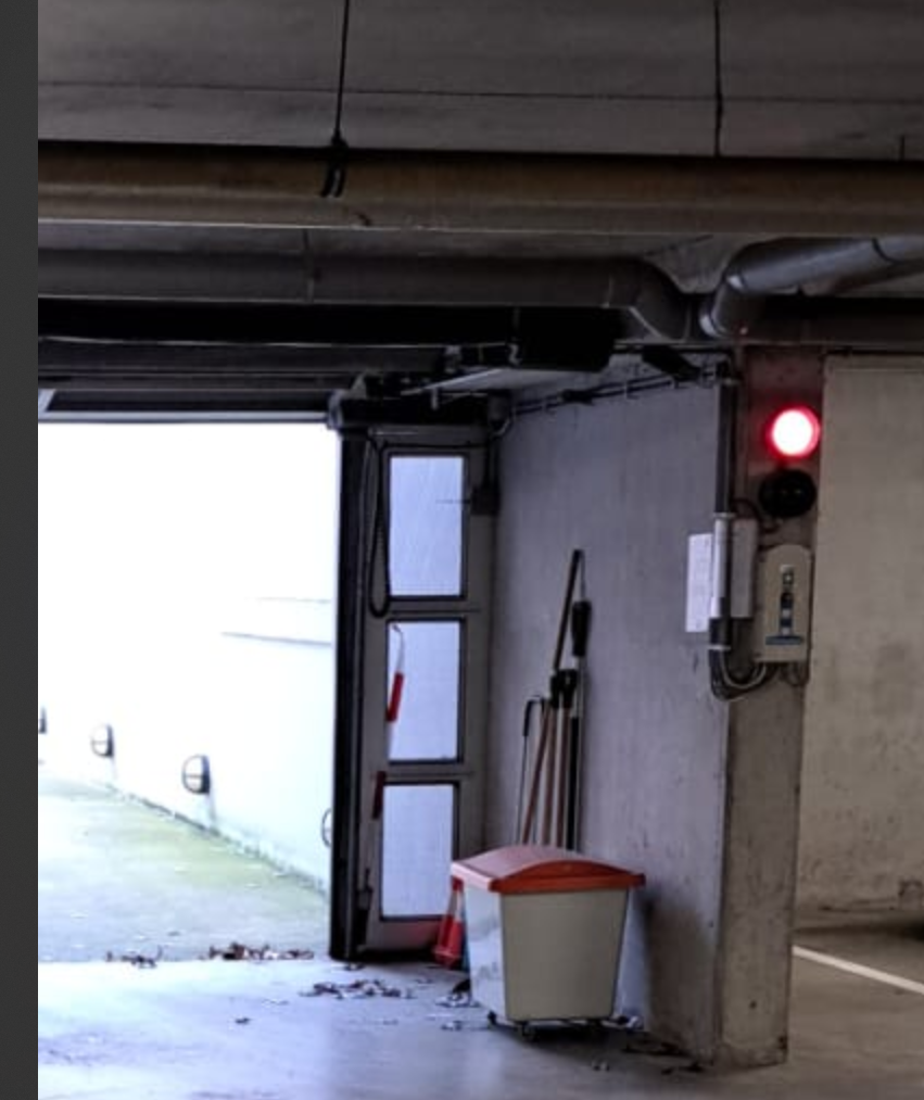

    jvaane
    Underground parking with open doors and red signal light.
    Crawford 930 installation;
