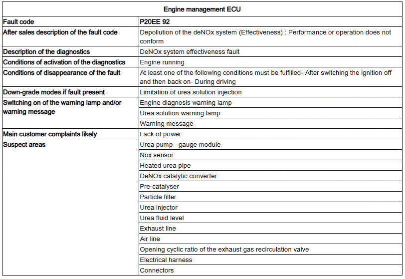

    Dear Sirs,
    I HAVE PEUGEOT 5008 1.5 BLUEHDI with random P20EE? Do you have ideas of software logic that is generating the error, I would disable only error generation
    I saw post regarding boxer. for adblue tank repair.
    Regards
    Vincenzo
    AI: Could you provide more details on when the P20EE error occurs? For example, does it happen under specific driving conditions or after certain actions?
    No particular conditions,
    AI: Have you attempted any diagnostics or repairs related to this error code before? If so, what were the results?
    I ALREADY REPLACED three tanks (used not new) and also all nox sensors.. and fap but same error
    P20EE
  • #3 21516855
    wilmacocci
    The post on the above link is not clear, It seems that the issue could be due to a nox probe its wiring, but not sure it isn't in English
  • #5 21542590
    zi.ko
    Level 26  
    Posts: 685
    Help: 86
    Rate: 336
    I suggest updating the software in the engine computer. The latest version is less sensitive to most of the causes triggering this error code.
