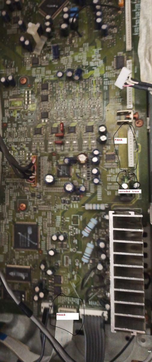

    Hello I have a Onkyo TX-SR602E (European model) that will not show any signs of life the standby light doesn't light up. I have checked all the fuses and they are fine.
    Here's what I have checked
    When plugged in:
    CPU VCC reads 4.7V at the firmware writing port (P701)
    Display gets 5.5V
    When unplugged:
    CPU voltage drops to 3V
    I think the CPU has a problem or the firmware is corrupted.
    Background:
    The last time I used the receiver was in 2022, and it worked fine.
    It was stored in the basement for 2 years.
    Before it went to the basement a factory reset was done.
    I’ve replaced the super capacitor (C704).
    I have the service manual for the receiver and the PDF for the Renesas M16C/62P (CPU).
    Any help is very appreciated.

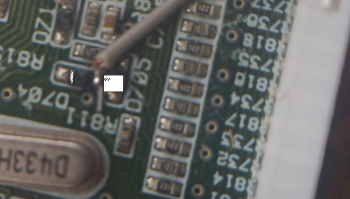

    #9 21551288
    Elektromonterek
    Level 26  
    Posts: 756
    Help: 59
    Rate: 127
    Well, but in the service manual you have that it is active low, and you have a measurement of 0.57V so it should hardly be taken as ok. Here I think the procec itself puts out 5V or 3.3v depending on what it is powered by and if it drops to 0, it is active, i.e. blocking from starting. Do you have 13V there at all from the standby power supply? Prock faults are more likely to be caused by overvoltage only, and here a lot of things are fed correctly, so there was probably e.g. a rise in mains voltage and it burned the zeners which are supposed to lower this signal from the power supply. Alternatively, someone may have been messing around and put the wrong standby trafo, which I have also encountered. At d704 the voltage should be around 5.1V, as this is the value of the diode.
    P. S. You put cole and sticks if this fault is so trivial 🤣.

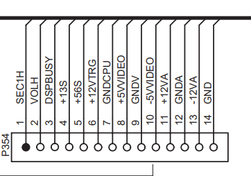

    No one has worked on this receiver except me, which is why I'm confused — before I put it into storage, it was working perfectly. But now, after taking it out, it doesn’t power on at all.
    When you say "13V", do you mean on the connector shown in the picture? I’ll check it tomorrow.
    Diagram of connector P354 with 14 pins and their functions labeled.
    I’ll also check D704 tomorrow.
    One question: during testing, I don’t have the video board, tuner board, or U3 board connected. Could this prevent it from going into standby? I don’t think so,
    Really hoping this turns out to be something simple.
  • Corroded trace between P6931 and P354 found
    #11 21551695
    _car123
    Posts: 16
    When I plug in the receiver (before pressing the power switch), the voltage on P354 on 13S is about 1.2V.
    After pressing the power switch, the voltage remains the same — still 1.2V.
    On D704 I'm measuring 0V.
    Close-up of a PCB section with label D704, a wire, and a 0V note at an electronic component.
    Added after 44 [minutes]:
    11 V get to P6931
    Added after 8 [minutes]:
    I didn't think I would say that ever but I'm happy that I found corrosion on a trace
    Added after 17 [minutes]:
    I will fix the trace and let you know what happened

    #13 21551800
    _car123
    Posts: 16
    >>21551773
    the problem was a corroded trace on the U1 board
    Added after 3 [minutes]:
    that was the issue, then it powered on — thank you so much!
    This receiver means a lot to me, and I really appreciate all your help.
    Unfortunately, I still have to fix another issue on the video board, but I’ll take care of that.
    Two broken pieces of green printed circuit board (PCB) with connectors and electronic components on a wooden surface.
    thank you again.
  • Corroded track on U1 board caused no-power fault

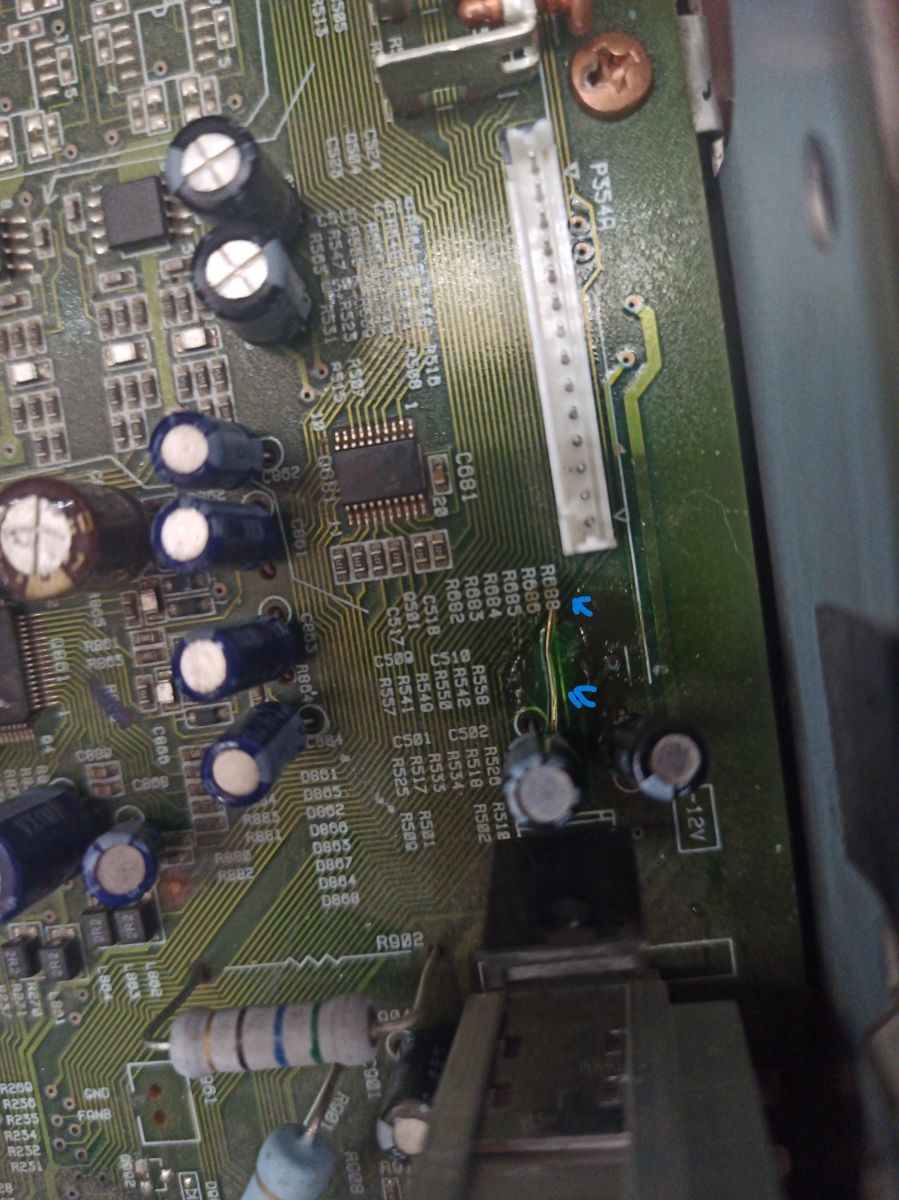

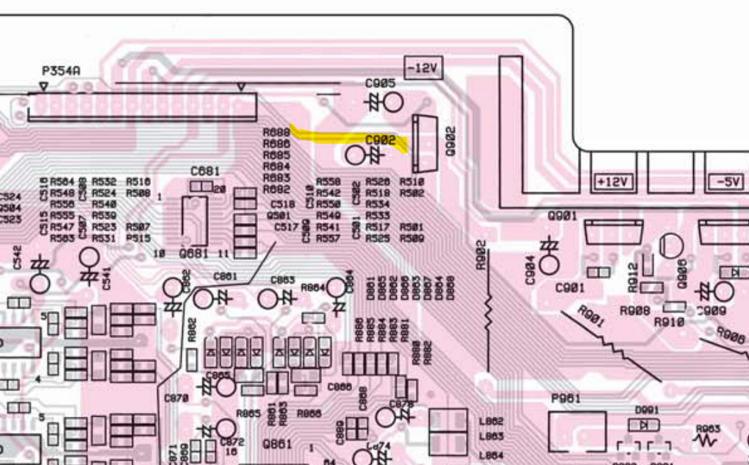

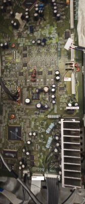

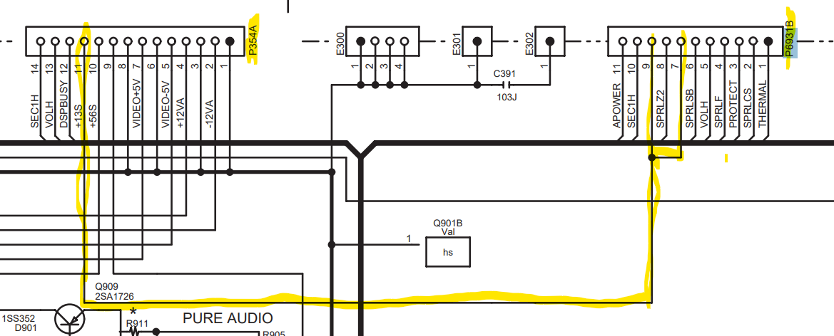

    #15 21552312
    _car123
    Posts: 16
    The problem was a corroded trace on the U1 board.
    The damaged trace was between P6931B and P354A, located near some capacitors that likely leaked.
    A section of an electronic schematic with yellow-marked connections between connectors P354A and P801B.
    A circuit board fragment with capacitors, resistors, and a white connector visible.
    Mainboard of an electronic device with highlighted connectors P354A and P691B, and a corroded trace marked.
    A section of a PCB diagram with capacitor C002 highlighted in yellow.
    The 13S pin wasn’t getting any voltage to the CPU, so the power failure detector was active, preventing the CPU from starting.
    After fixing the trace, the receiver is now working fine.
