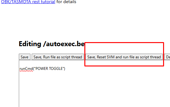

    Screenshot of editing autoexec.be with the Save, Reset SVM and run file as script thread button highlighted.
    I may try to fix it soon, but it's strictly related to berry, I would need to alter berry behaviour itself, more or less.

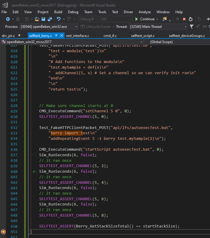

    Verified by self test:
    Screenshot showing source code in Visual Studio, focused on testing berry import module integration.

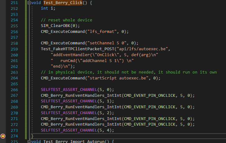

    If you want to have click directly in berry:
    Section of C code with a test function Test_Berry_Click and multiple SELFTEST_ASSERT_CHANNEL macro calls.

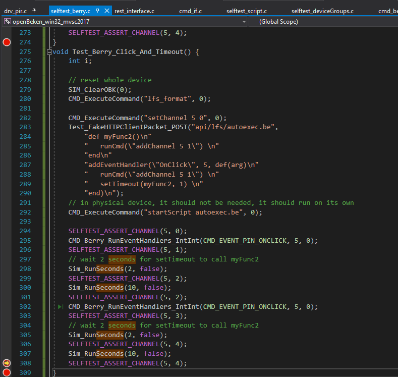

    If you want to add a delay in a click:
    Screenshot of Visual Studio Code with the selftest_berry.c file open, showing a function for testing click and timeout in Berry.
