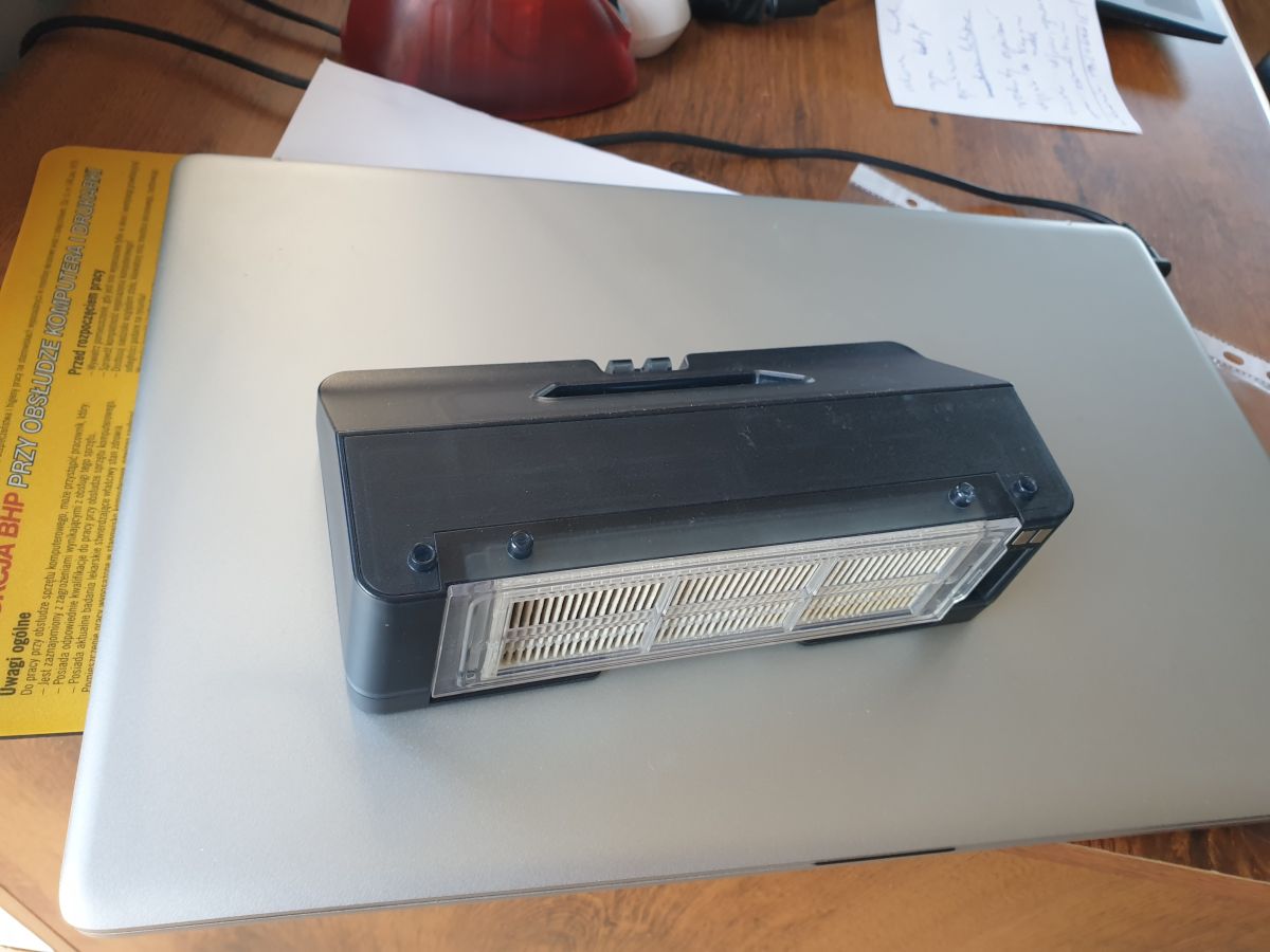

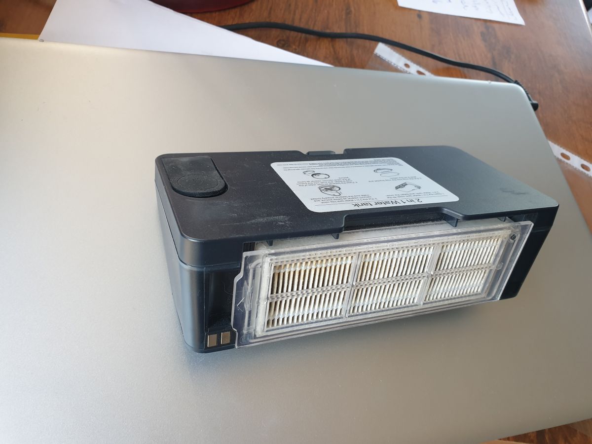

    #6 21555603
    vivaldi_190
    Posts: 17
    And where can they be? I don't see any.
    A dustbin for a robotic vacuum cleaner is placed on a closed laptop on a desk. .
    Xiaomi 2-in-1 vacuum container on a silver laptop, visible filter and instruction label.

    #7 21555735
    DJ MHz
    Level 26  
    Posts: 1167
    Help: 40
    Rate: 254
    That little black dot on the removable filter is a magnet. Put the 2in1 container on without this filter, see if it detects by resistance. If not then it's something with the container. There is probably still a small water pump in it, if you have a higher resistance maybe it is banged up?

    #8 21556000
    vivaldi_190
    Posts: 17
    @D.J. MHz And what kind of robot do you have? Maybe a different one to mine? Mine is a Mi Robot Vacuum-Mop P - the European version, not the Chinese one, and that supposedly makes a difference too.
    I tested it and it looks like this:
    1. when I give the 2in1 tank without the magnet filter, it detects nothing.
    2. when I give a 2in1 tank with a magnet or with a filter that has a magnet, it says that a dust tank has been fitted.
    3. when I give a water tank, it detects correctly that it has a water tank.
    4. when I give a water tank and attach a magnet to it, it said there is a 2-in-1 tank fitted!!!!
    5. when I apply the magnet alone, it detects nothing.
    From this it follows that he must agree both: the resistance on the contacts, that there is this pump can, and there must be a magnet working?
    I'm also puzzled by this resistance of the tank, because my 2in1 is about 12 Ω, while yours @D.J. Mhz wrote that it's about 4.3 Ω, which is just more like mine on water, which is about 6 Ω.
