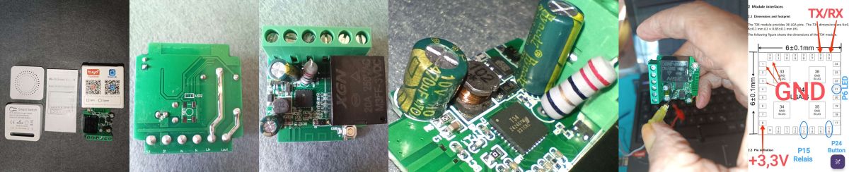

    I also fell into the trap with this board where there's no way to solder anything. But MacGyver almost always finds a solution. 😄
    Finding the positive and negative solder points was quite easy. I was also able to find a solder point for the TX, and for the RX, I connected a hypodermic needle to the pin during flashing. That worked very well, by the way.
    Check out the pictures for the pin configuration.
    A collage of six images displaying a Smart Switch PCB, its electronic components, and a pinout diagram.

    Another T34... luckily you did good job flashing it. Btw, can you attach device template as text, it's easier to just copy-paste json.

    Sorry, I don't have it in my hands so far.
