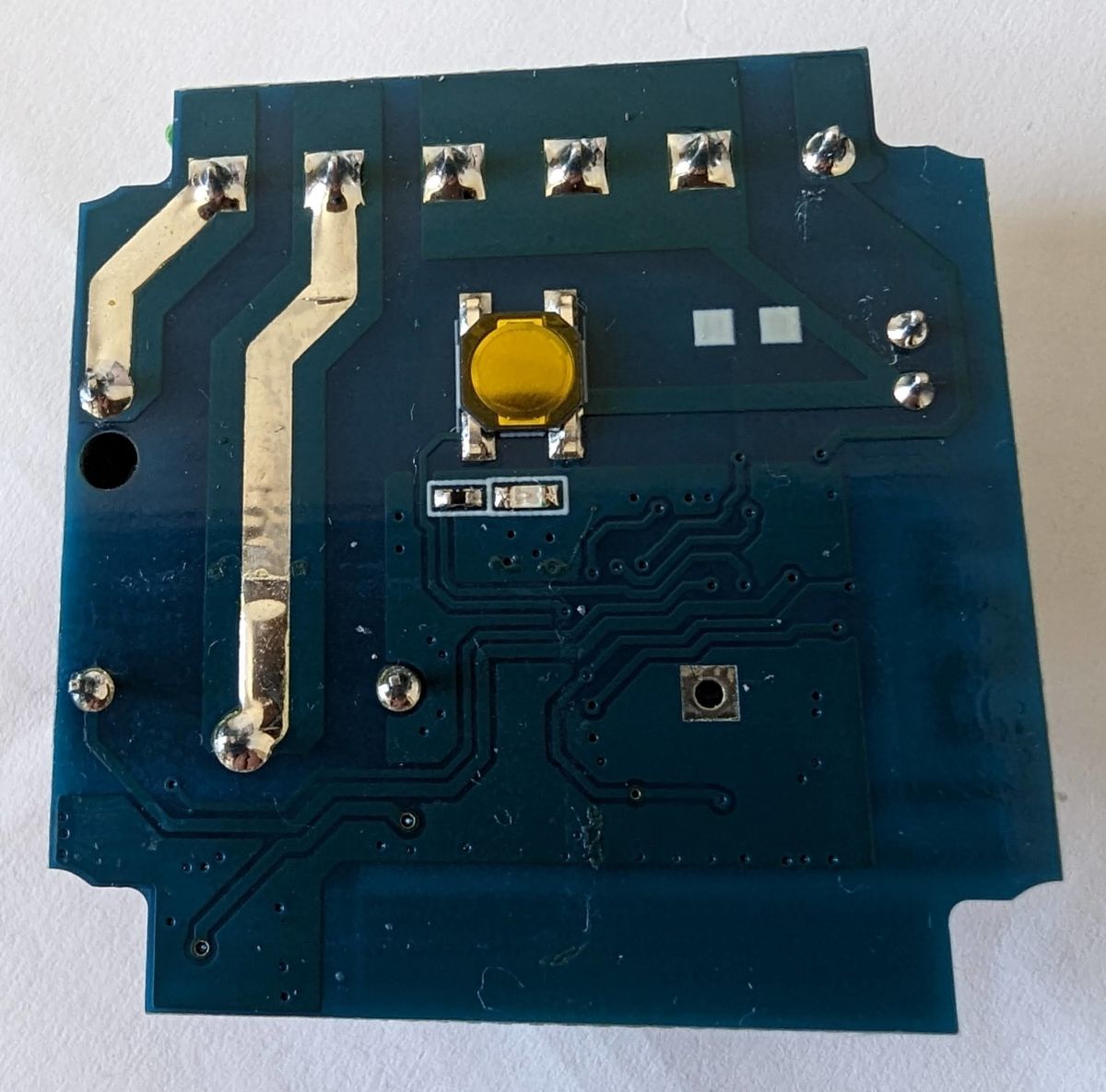

    Here is the module designation CB3S W601 and only 4 pinouts
    Circuit board with soldering points marked. CB3S module on a printed circuit board with visible electronic components.

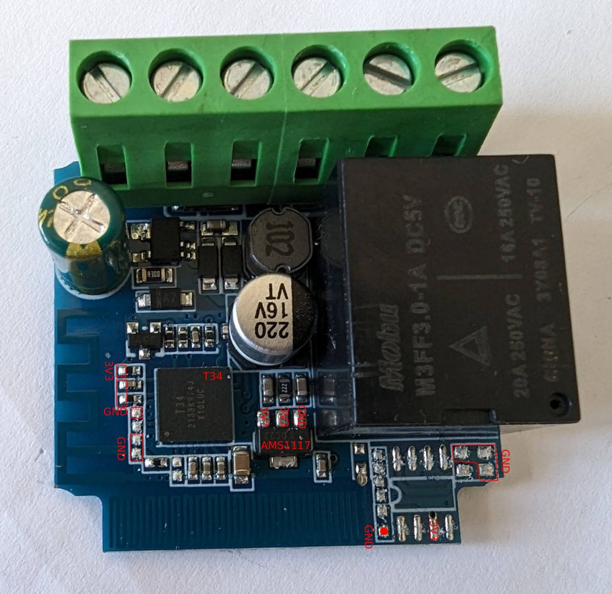

    And here even better, because it is mysterious:
    T34
    2133K9T4J
    X10LUC
    View of a PCB with various components and soldering points. Blue PCB with white components and visible soldering points.

    Here is the module designation of the CB3S W601. and only 4 pinouts

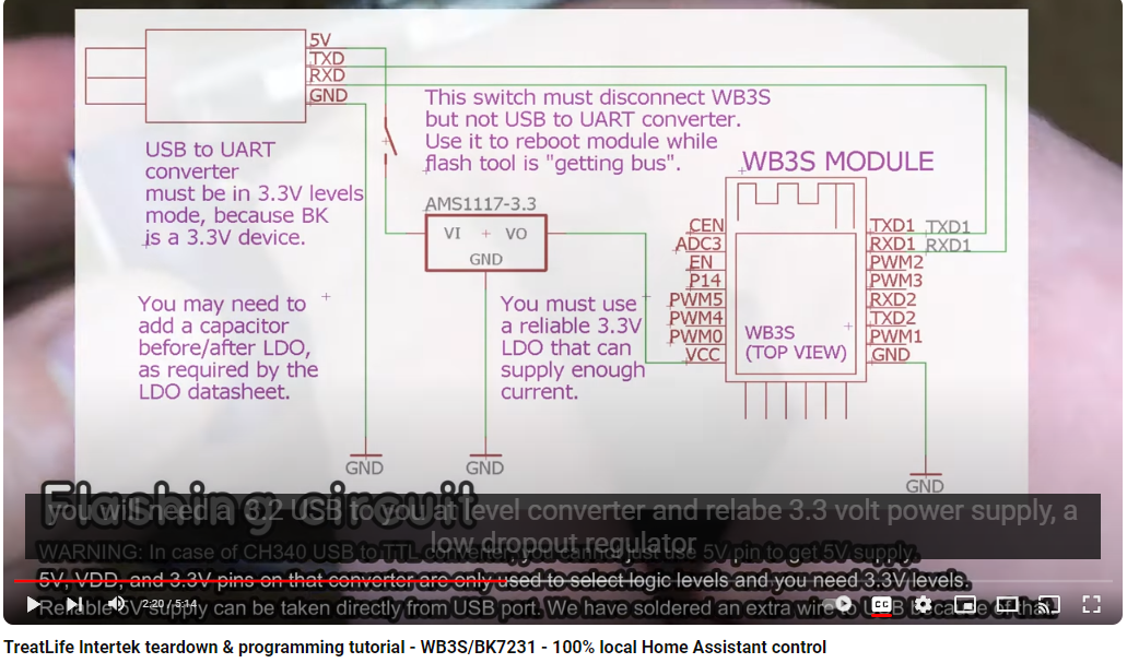

    CB3S is BK7231N. The leads for programming are compatible with WB3S and TYWE3S. You can solder four wires (ground, 3.3V, RX and TX) and upload the OBK, here flasher:
    Similar to here, only you select BK7231N in the flasher:
    Connection diagram for USB to UART converter with WB3S module.
    Before programming. programming watch the entire video

    2133K9T4J
    X10LUC
    T34 is also supported by OBK, you program it as BK7231N.
    To program you have to solder four wires (RX,TX, 3.3V and GND), just not sure where to solder them. But there are 4 soldering points on the board...
    I suggest using the method of elimination.
    1. check where the ground goes from the mother board, probably the ground has a large copper pad, this pad which is connected to it will be ground, GND
    2. then you look for 3.3V, you can find it on the other pole of the capacitor which is between 3.3V and ground or look where from the other board 3.3V is connected, but by eye I can already see that probably 3.3V is here:
    Flipped PCB with marked points for 3.3V and GND.
    3. then there are 2 points left and there's the question which is TX and which is RX - but that's only two options, I'd try randomly connecting RX and TX first and then if the flasher doesn't move, I'd swap them places and that's it....
    Of course, this is only an abbreviated version, as I assume you are familiar with the BK7231 programming procedure in general, and especially with:

    PCB with markings on various pins including GND and 3.3V, featuring AMS1117 and T34 components. A printed circuit board with various traces, pads, and visible soldered components.
    (sorry for the English reply)
    I also have a T34 on a 1CH WiFi smart switch and identified a bunch of pins that seem to be GND or 3.3V. Any hunch what would be good candidates for the TX/RX pins?

    @rumpeltux I have never seen such a switch before. It seems that RX/TX is not routed out anywhere, but you can check:
    https://developer.tuya.com/en/docs/iot/t34-module-datasheet?id=Ka0l4h5zvg6j8 maybe you can access somehow pins of the case?

  • CB3S programming requires soldering or chip removal
    #11 20946108
    ra_dzik
    Posts: 96
    Rate: 7
    >>20942489 Well, I've got quite a bundle with it in the version with CB3S - it requires soldering the chip or, as I saw on some video, the chip next to it, because otherwise you can't program CB3S, because this chip next to it blocks :-( I unfortunately don't have such a skill, to solder one of these two and not break anything :-( I tried without soldering, but it says that it cannot communicate with the chip :-(
    Is there any way to do this?
    With the T34 version - the chip has the leads underneath the chip, you can't see the legs on the side, so geez I can't identify which lead is RX and which is TX, even though on the datasheet it is described as pins 25 and 26, the tracks go from under the chip and I don't know exactly how to identify this :-(
    Any ideas? Help colleagues.

    ra_dzik wrote:
    Well, I've got quite a bite out of that with the CB3S version - it requires soldering out the chip, or as I saw on some video, the chip next to it, because otherwise you can't program the CB3S, because the chip next to it blocks :-( I unfortunately don't have that kind of skill, to unsolder one of these two and not break anything :-( I tried without unsoldering, but it says that it can not communicate with the chip :-(
    Check with a multimeter where this path goes from RX or there TX and find a place convenient to cut it temporarily.
    I have also seen that some people use OTA flashing, but it is per-build (i.e. until someone downloads 2MB of batch from one of the devices of a given series, it will not flash the others).
    Mate @krzbor actually had some other idea for it, but I haven't tried it myself and I don't know if it will work
    ra_dzik wrote:
    With the T34 version - the chip has the leads under the chip, you can't see the feet on the side, so geez I can't identify which lead is RX and which is TX, despite the fact that on the datasheet it is described as pins 25 and 26, the tracks go from under the chip and I do not know exactly how to identify it :-(
    As I wrote - as long as these 2 pads are RX and TX then you can forcefully, by trial and error guess. You determine VDD (e.g. from the mother board), determine where the ground is, then you are left with two options, if it doesn't move then you swap RX and TX and then it must move.
    Worse, if it's not RX/TX at all, then it's a very hard situation.
