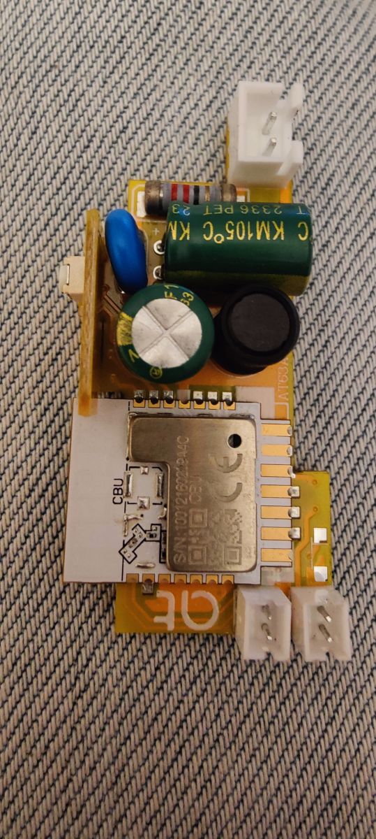

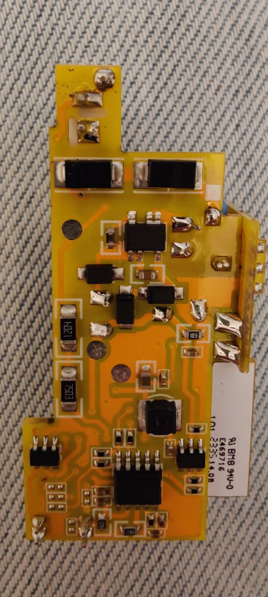

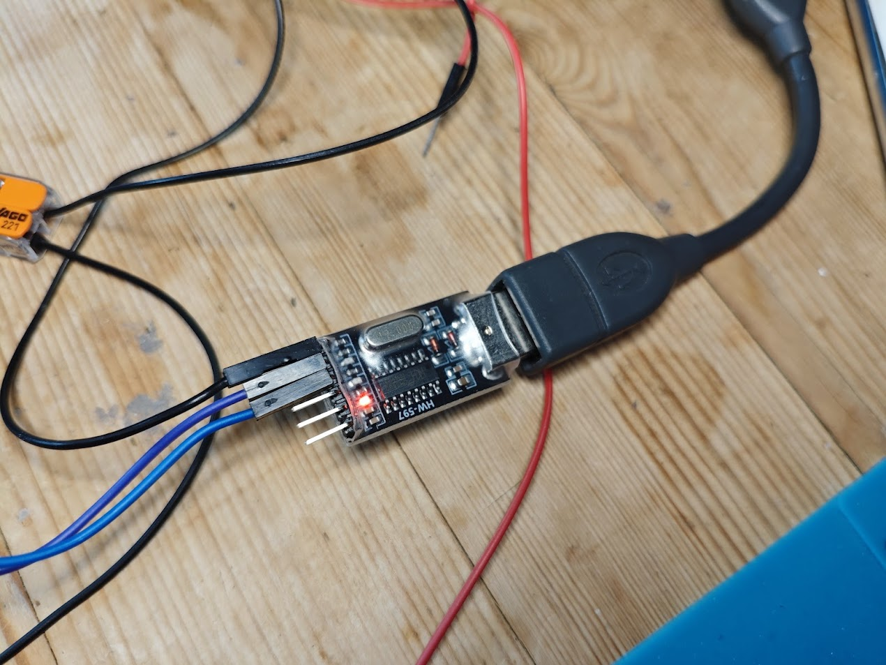

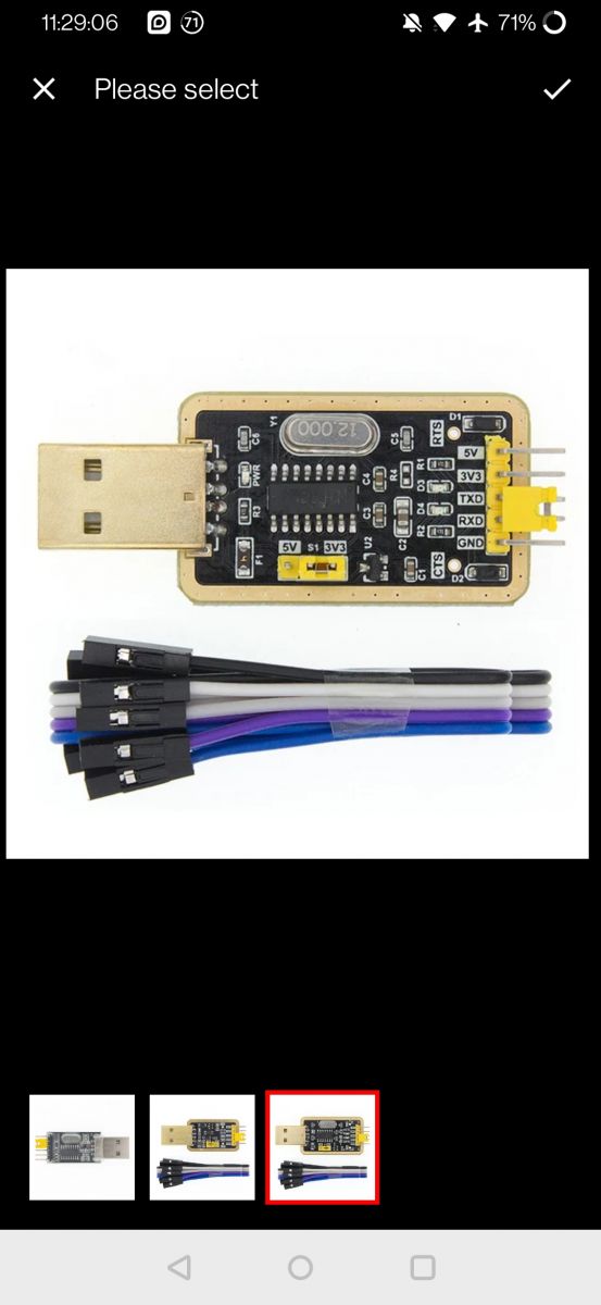

    Hello, I have a question about this Tongou TO-Q-SY1_163JWT 63 Amp Breaker.
    I am having difficulty flashing it with Openbk. I am familiar with the process and have successfully flashed other switch devices eg: [BK7231N] Aubess Mini Switch 16A.

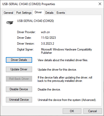

    I use a USB / TTL serial device from China CH34
    USB to TTL CH340G adapter with connecting cables.
    0G-2 which has worked well in the past plus I swapped it out with an identical spare to confirm functionality.
    I am using the latest flasher bk7231flasher_1.3.3
    Attempts at flashing in place were unsuccessful so I decided to remove the CBU from the main board but still unsuccessful! Resetting the module by earthing CEN does not start the flash sequence (have tried many many times). Also trying another 3.3 v power source, swapping rx1 and tx1 on uart1 just in case but to no avail! I have a log output from uart2 but won't post it here as it may contain private details!

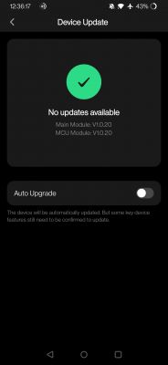

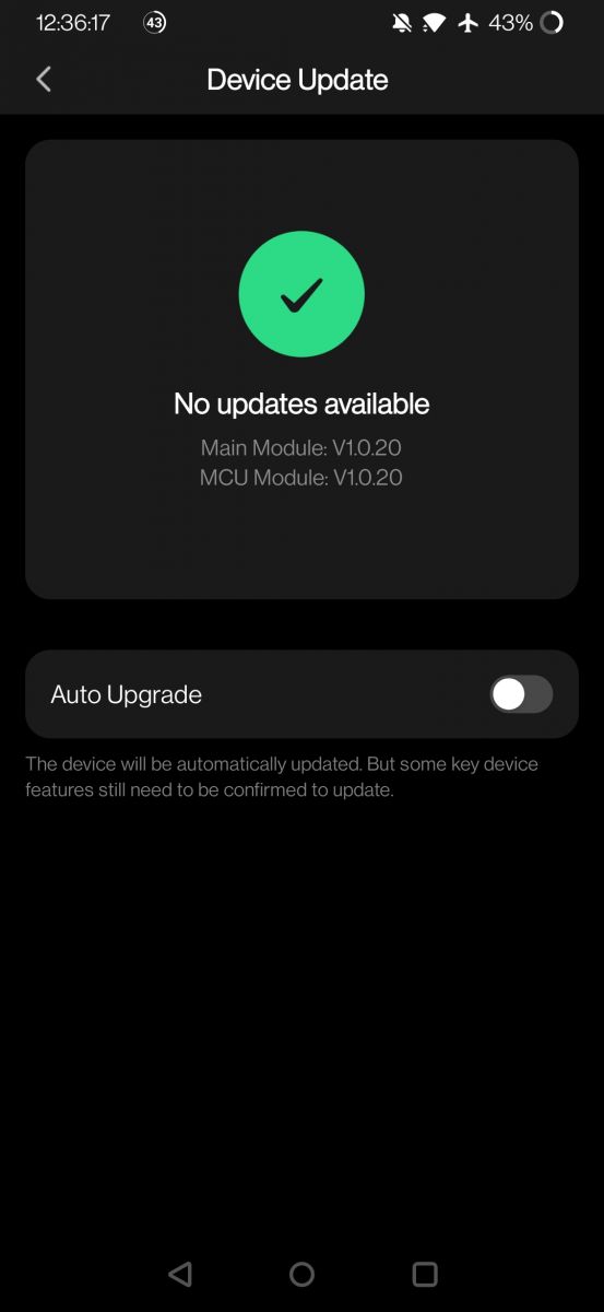

    Attaching it to Tuya Smart app all works OK, noticing the firmware is V 1.0.20. Is it possible that Tuya have disabled flashing (bootloader rom) somehow? I do notice on their web site "Flash and Authorize CB Modules"
    https://developer.tuya.com/en/docs/iot/CB-series-module?id=Kbruyciad6154

    Tongou TO-Q-SY1_163JWT 63 Amp switch circuit board with visible capacitors and CBU module. Close-up of the circuit board from the Tongou TO-Q-SY1_163JWT 63 Amp switch. Device update screen showing no updates available for Main Module and MCU version 1.0.20.
    #2 21168693
    Posts: 14771
    Rate: 12914
    I think this device may be using RX/TX to communicate with another chip. What is the marking on the SOIC chip on the other side of the board? Is it BL0937?
    Can you check with multimeter where RX/TX connects?
    Maybe you need to desolder either CBU or the SOIC chip...

    Thanks @p.kaczmarek2 and @divadiow
    As mentioned I have tried a different 3v3 power source.
    What USB-TTL adaptor do you suggest?

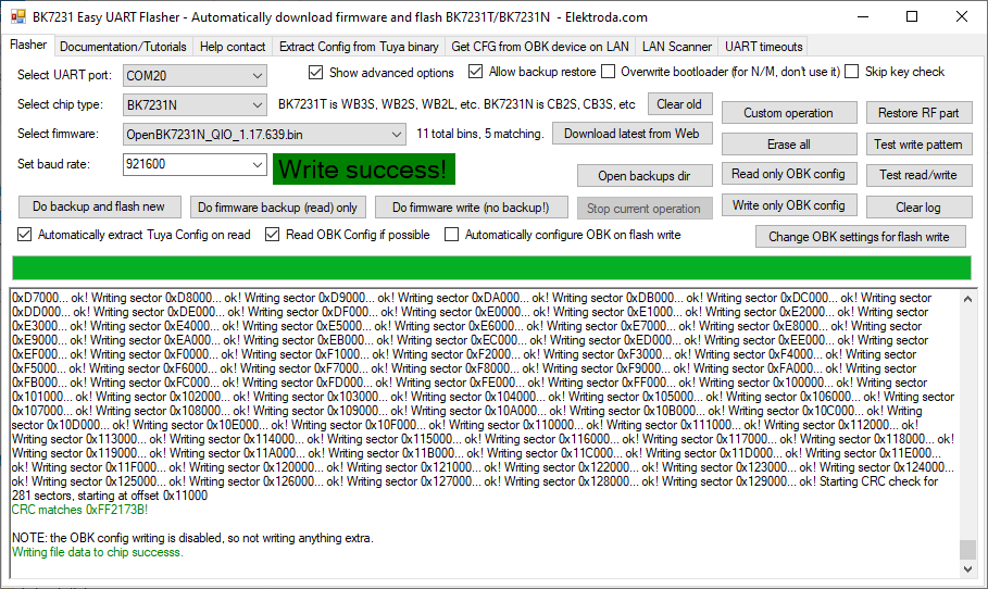

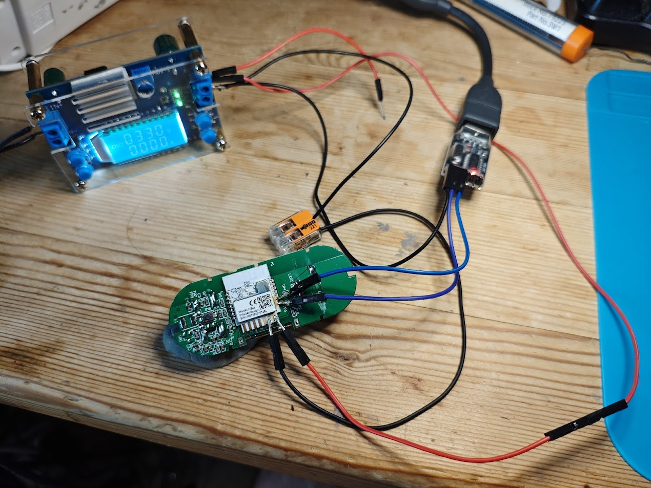

    Added after 58 [minutes]:
    here's a backup/flash I've just done from CBU using a CH340 USB-TTL and external 3.3v PSU

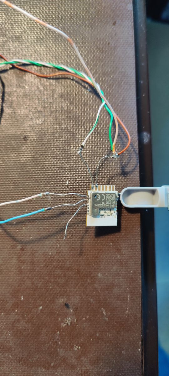

    Wobbie
    Posts: 8

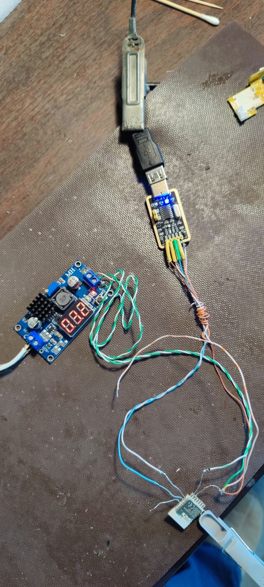

    Well my flasher just ignores the fact that I either earth CEN or re-power the CBU! (multiple times)
    I'm using the same driver
    PSU is an adjustable one set to 3v3 (using a multimeter)
    Here is my setup
    Electronic setup with a microcontroller connected to several wires on a dark surface. Electronic setup with power supply, cables, and module.
  • #8 21170739
    Posts: 5220
    Help: 449
    Rate: 918
    Ah. Are you able to shorten your wires as much as possible?
  • #9 21170837
    Wobbie
    Posts: 8
    Yes, I tried that this afternoon with no luck.
    I also connected a tuya IR Blaster which I converted a year ago successfully and did a firmware read or backup using the same hardware, went perfectly.
    Not sure what's going on!
    Is it possible tuya have upped their game more? Locked the bootloader somehow?

    Use shorter wires, especially for power, and you can also use higher 3.6V voltage

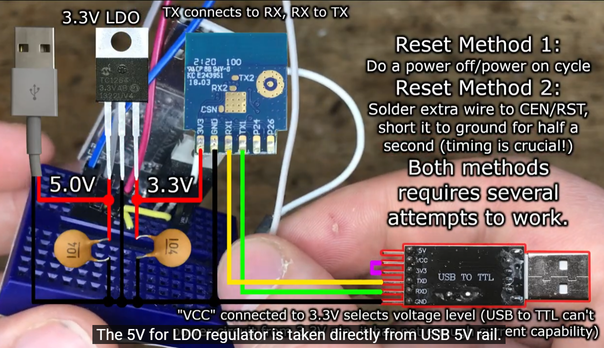

    I'd suggest trying the USB to UART converter that I use:
    Wiring diagram for USB to UART highlighting reset paths.
    Try alternate RESET method:
    - connect only RX, TX, GND and 3.3V
    - start flasher
    - disconnect 3.3V from CBU
    - temporary short the GND to the 3.3V pin of CBU
    - disconnect the short of CBU 3.3V to gnd
    - connect 3.3V from supply to CBU
    It may sound strange but it worked for me in some cases where the little current sinked by TX/RX lines alone (without VDD) was enough to keep CBU alive so it didn't reboot on power off/on

    Thanks everyone, found my problem; RX connection got broken going into the CBU when removing from the main board (not enough flux I think)! Managed to fix it so happy ending.
