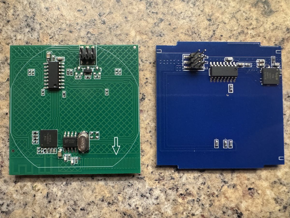

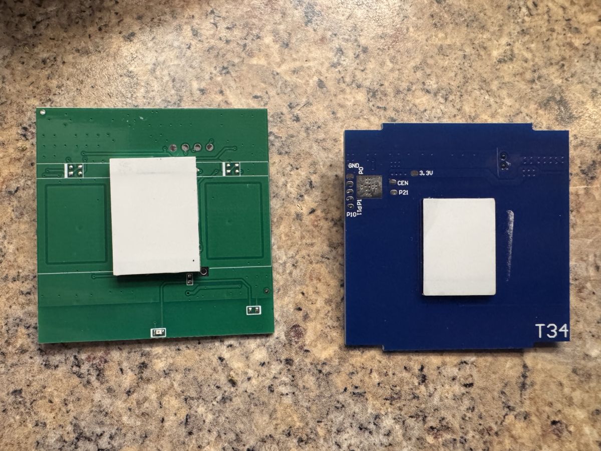

    Do you think there is a chance of easily flashing these?

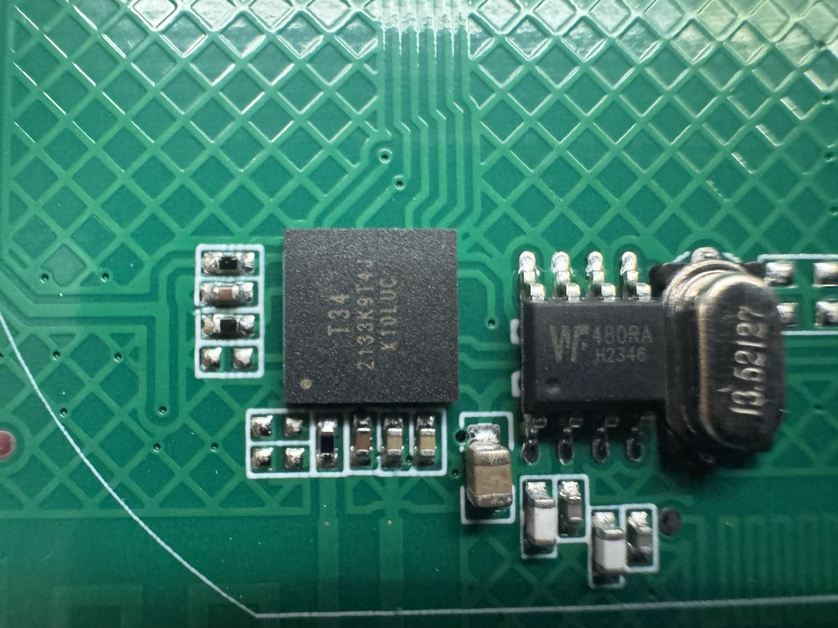

    By easily I mean for a soldering novice like myself, soldering direct to chip is with it being so delicate beyond my comfortable skill level.

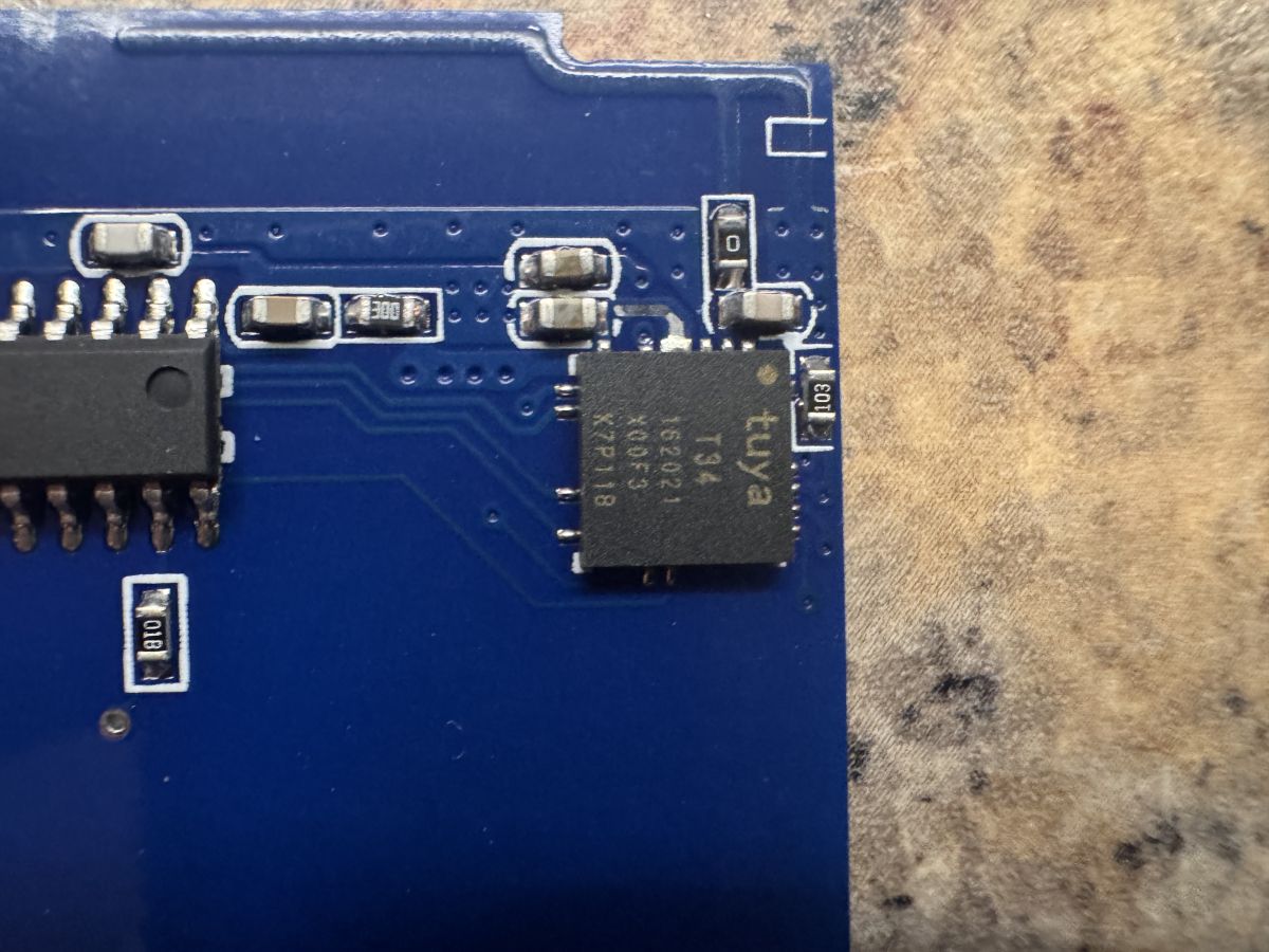

    The blue one I suspect has a high chance of rx/tx pins being presented however the green one I’m not so sure about as there is no silkscreen or labels except the 4 unlabelled pads

    On blue, P10 and P11 are UART1 pins, so you can solder just to pads. Check the guide here:
    https://www.elektroda.com/rtvforum/topic4112776.html
    For green one, it doesn't look good... it seems it has trace fr RXD, but not for TXD.

    Posts: 99
    The blue one was super easy to flash, the green one not so much. Far too tiny for me to do I’m afraid with the tools I have and did attempt it but got no where
