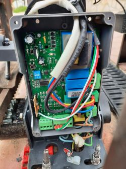

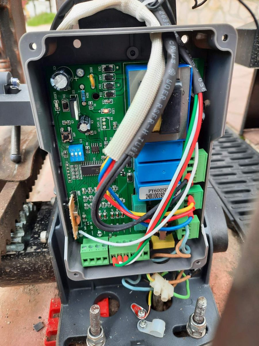

    When the gate opens, a switch next to it turns off the motor, and after 30 seconds, it automatically starts moving in the opposite direction. Why does this happen?
    But this does not happen when the gate is opening – only when it's closing.

    You have the motor wired the other way round. Opening is closing. And you also have automatic closing after 30 seconds switched on. As the drive works in reverse - automatic closing after 30 seconds is automatic opening for you.
  • Disable the 30-second auto-close/open function

    In this case, even though the motor is reversed, I do not want any automatic closing or opening after 30 seconds. How can I disable that function?

    Try different combinations of DIP SWITCH 2 and 3 settings (blue or red microswitch assembly).

    If you have photocells, the correct connection of the motor is very important! Otherwise, the gate may start to close when there is an obstacle!
