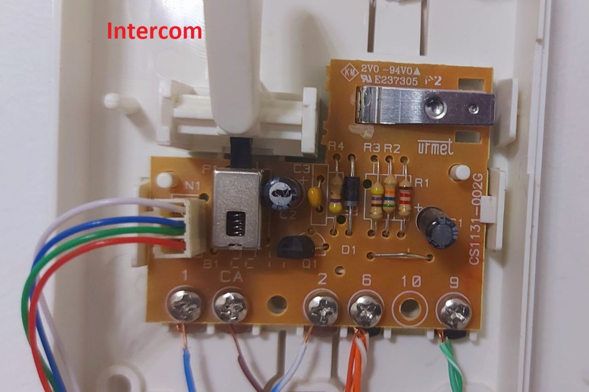

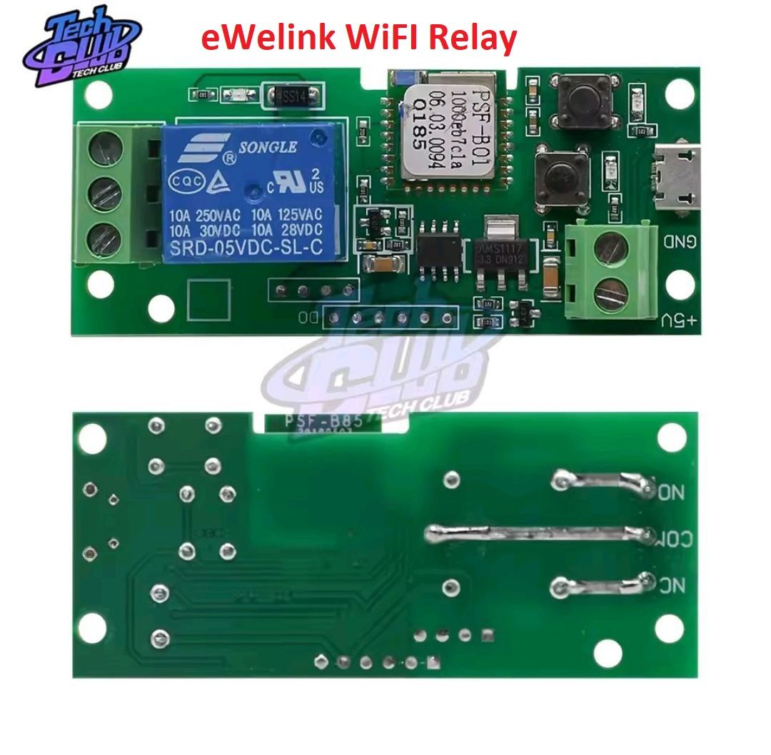

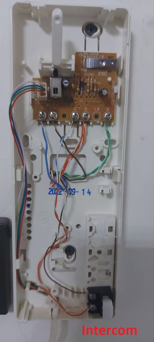

    Would you kindly help me to wire my eWeLink wifi relay to my Urmet intercom to open the gates through the wifi

    COM under 6
    NO under 9

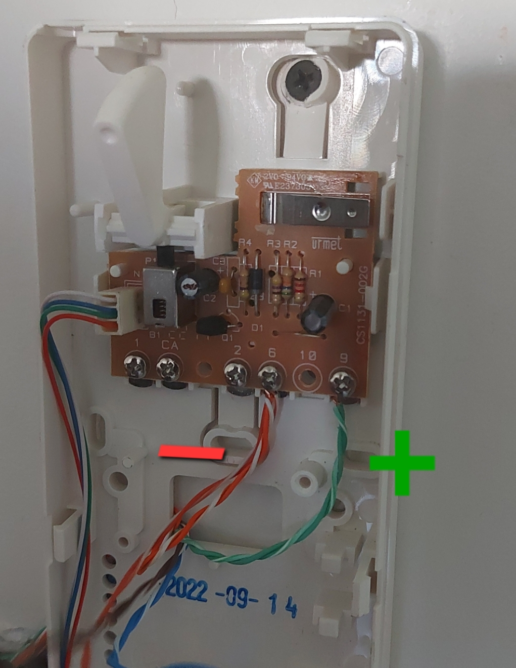

    The guy who installed the intercom told me that 9 is the positive source of electricity (live) for my intercom handset and 6 is negative (neutral).
    I know that the relay just closes the circuit just like the silver part (top right) with the 2 edges, when pressed they close the circuit.
    So, is it correct to wire COM to 6 and NO to 9? Or, I should connect the COM and NO to the 2 edges of the silver part?
    Besides, should I have a separate source of electricity for the relay or get it from the intercom?
    Thanks
