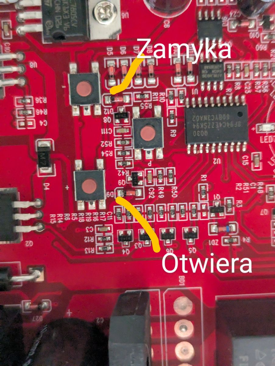

    Good day,

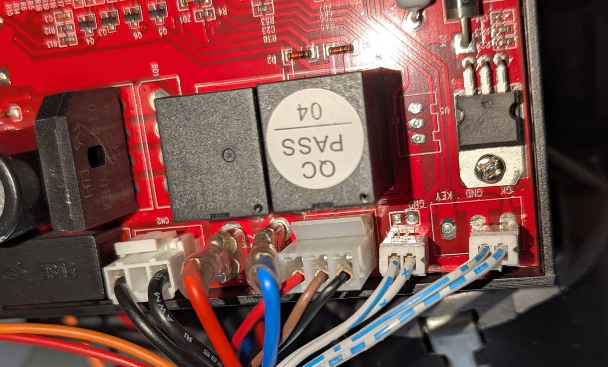

    I want to connect (wire/solder) a garage door Wi-Fi switch (e.g. Tuya).
    I would like to connect to the opening and closing buttons. I have included a picture of the buttons below.
    Is this possible? Please give me suggestions.
    Close-up of a circuit board with marked buttons for opening and closing. .
    Model ZTGD800, company VEVOR.

    And the gate controller doesn't have a dedicated input for controlling the gate with a single pulse?
    Please specify what model of this controller you have.

    Well, according to the manual, page 82, you have a dedicated input under which you can connect an external control, a GND and KEY connector.
    Only the relay has to be voltage-free, dedicated to such applications.

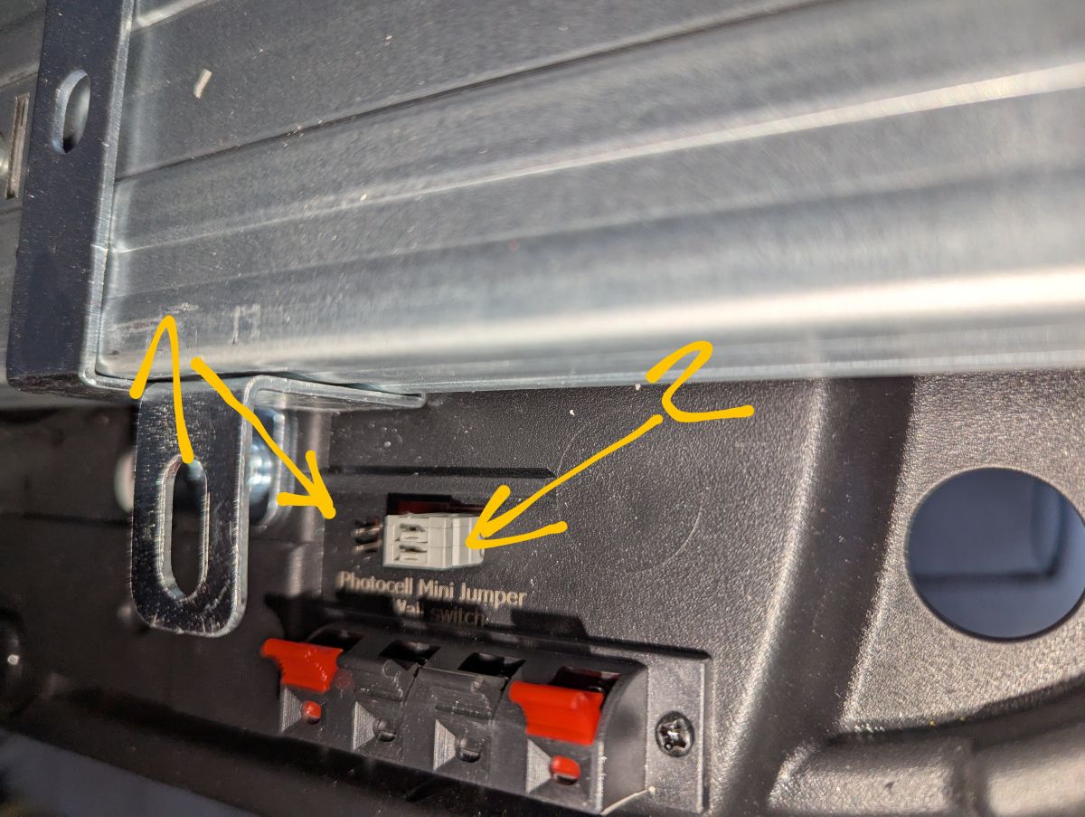

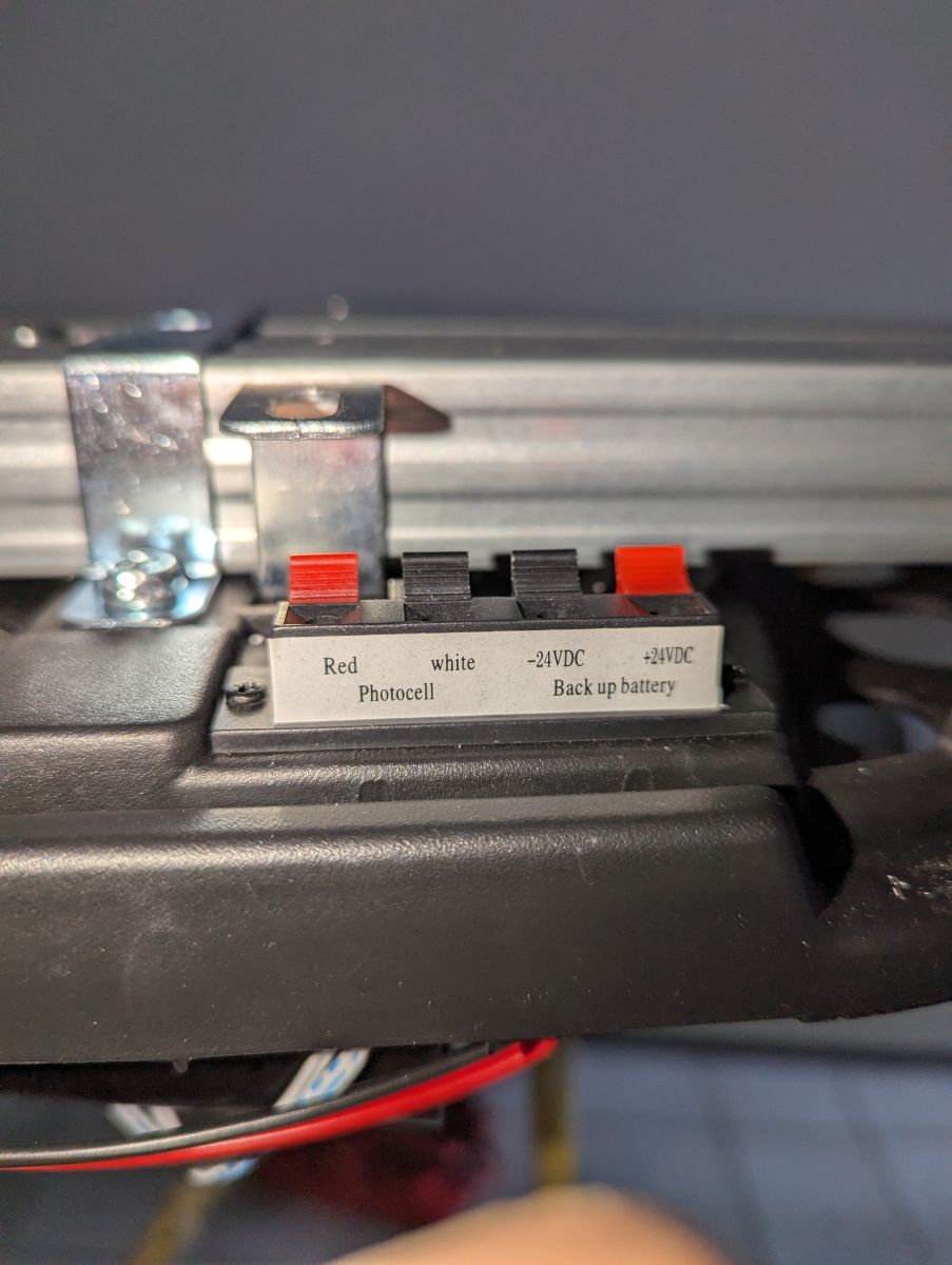

    At the top I have an output for a "wall switch", just which one is it? ( 1 or 2 )
    Those inputs at the bottom are the photocell and the battery....
    Close-up of an electrical panel with two marked connectors. .
    ... and now if 1 or 2 then they open/close, and the wall switch or this wifi switch of mine must have power given to it (phase and N) ?
  • #6 21514603

    These are the jumpers from the photocell, don't touch that.
    Don't you have a connector on the motherboard like the one shown in the manual?
    The wifi relay must of course be connected to the power supply, but as I wrote earlier it must be a relay designed for such a function, i.e. with a voltage-free contact.
    The best thing to do is to give a photo of the relay you have.

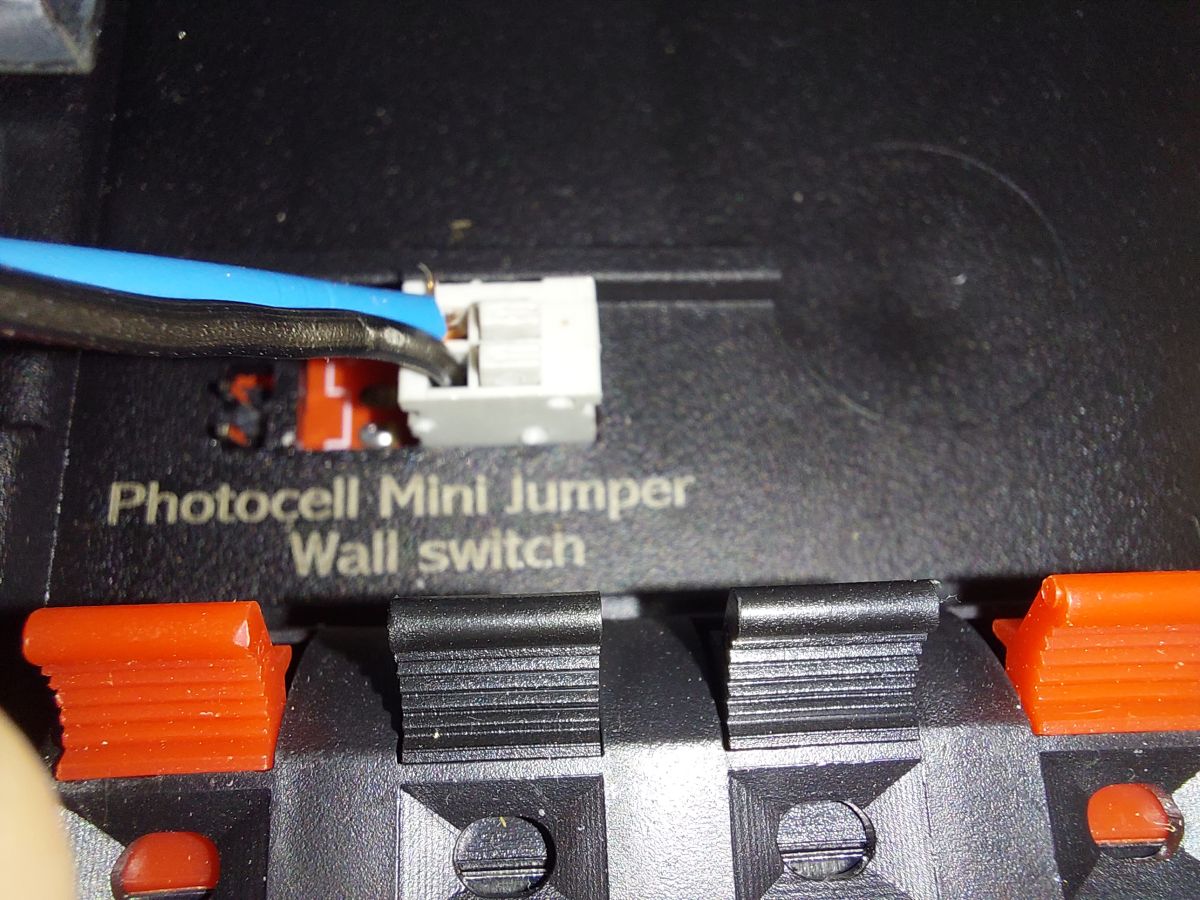

  • Identifying gnd and key terminals on opener board
    #7 21514627
    rfa_rafal
    Posts: 6
    Close-up of an electronic circuit board with multicolored wires connected to terminals. .
    According to the manual gnd and key are used for the switch, only that the key is empty (solder in?).
    In my case behind the picture the first two wires on the right are connected to the photocell, the gk one to Red.
    Close-up of an electrical connector with a label describing various connections. .

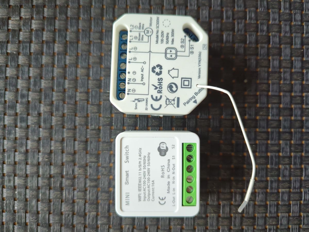

    Wi-Fi switch I don't have yet (I have a few for switching lights and roller blinds)
    Two smart switch modules with labels and connectors on the surface.
  • KEY input test and relay modification needed
    #8 21514643
    bubu1769
    Posts: 8062
    Help: 1177
    Rate: 2368
    This means you have a different version of the board.
    You can check if this KEY input works at all by short-circuiting it with a piece of wire to GND, it is possible that there are some elements missing on this KEY line to make it work.
    The relays you have without modification will not be good for controlling this gate.
    If it turns out that the KEY input is not active, this roller shutter controller could be connected to the buttons so that it controls the gate, but you will have to modify the connections inside the wi-fi relay or add external relays.

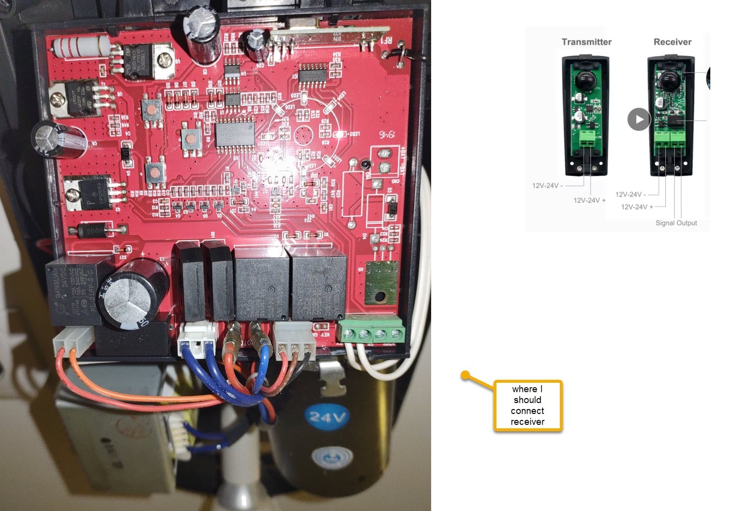

    silvaelio
    Hello All. I have board and I would lke to conect photocell, but I don't where to connect output ports from receiver of photocell. The other question is about jumper for photocell that seems that mine board don't have. Do you know how can be find that jumper.
    Thank you in advavce.
    Control board with indicator showing where to connect photocell receiver

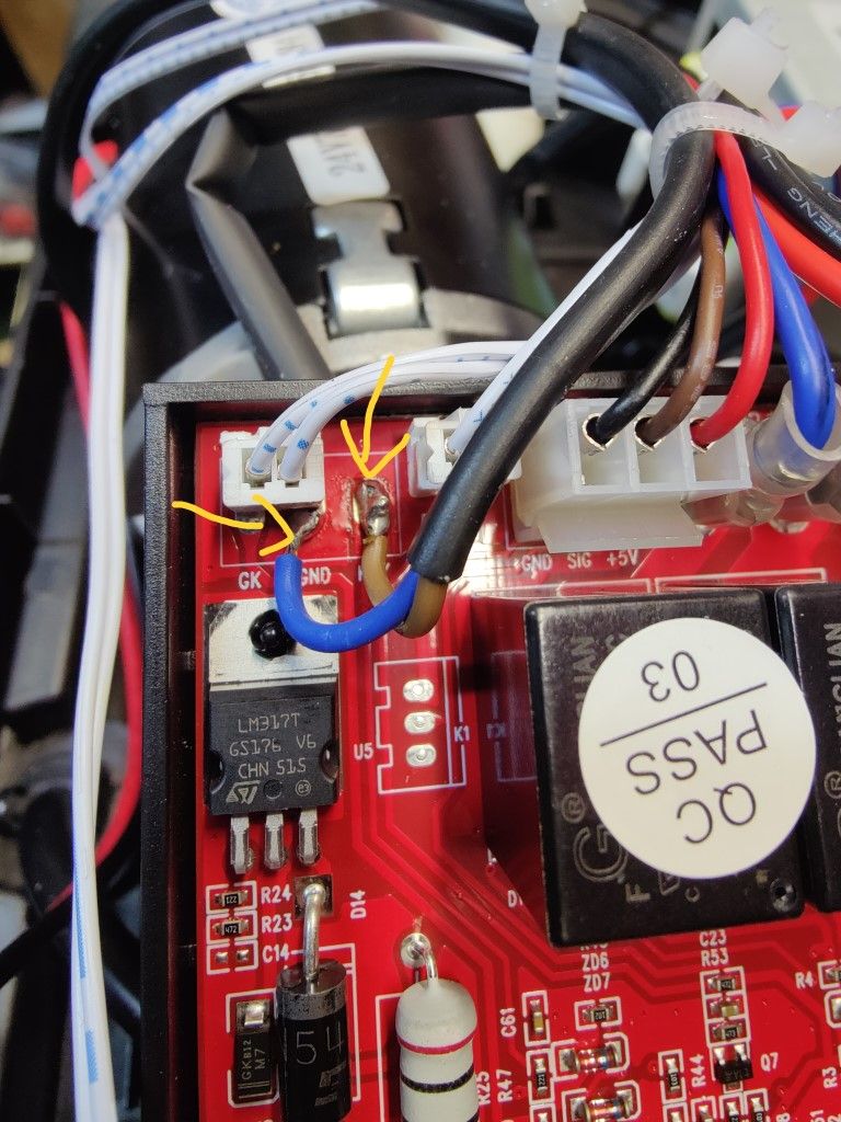

    #18 21809134
    robertke
    Posts: 13
    Czesc
    Do czego ci potrzebny czas otwierania bramy?
    - Jak ustawisz bramę to ustawisz do jakiego momentu ma sie otwierać i do jakiego mometu ma sie zamykac .
    - Dodatkowo mozesz ustawić po jakim czsie ma sie sama zamknąć ( bardzo dobr funckcja, - nie musiz zamyć samo sie zakmnie po kilku minutach).

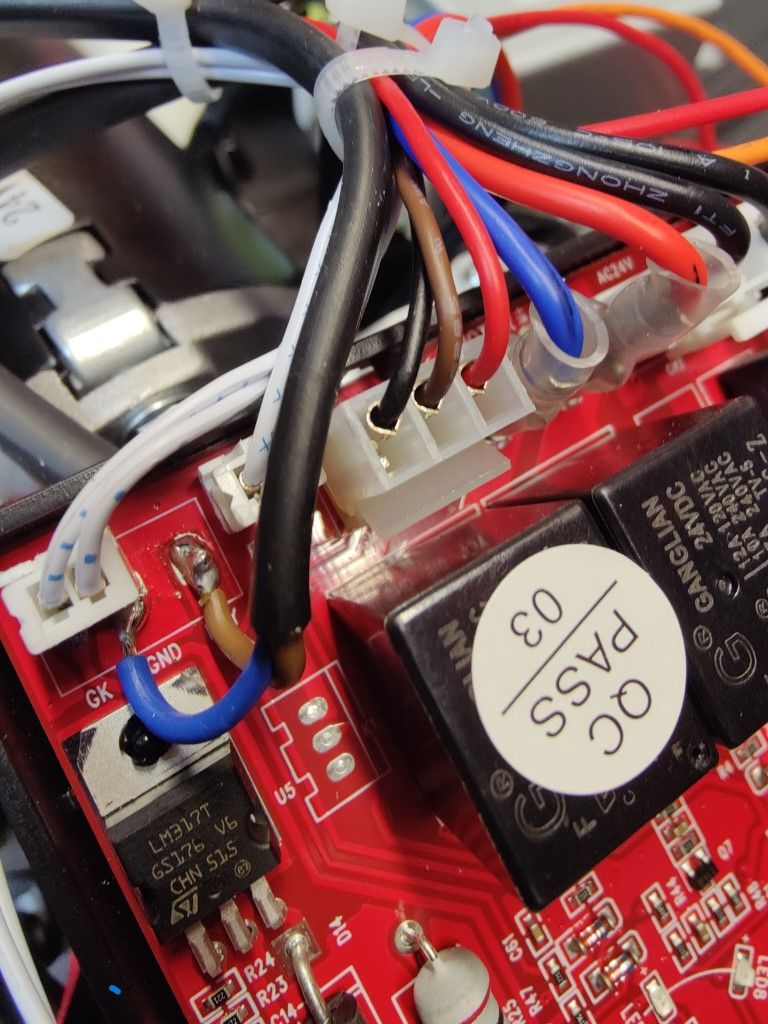

    Ja dorbiłem siobie przycisk na scianie i moge nim otwierać i zamykc i dzial to tak samo jak bym przyciskal pilotem .
    Załacze zdjecia gdzie trzeba wlutowac kable jeden do GDN drugi do KEY
    Close-up of circuit board with wires, connectors, and LM317T voltage regulator Main circuit board with connected wires and highlighted connector section Close-up of a circuit board with relays, wires, and connectors
    https://obrazki.elektroda.pl/1017570900_1768434822.jpg
    https://obrazki.elektroda.pl/9417852000_1768434822.jpg
    https://obrazki.elektroda.pl/1718930300_1768434822.jpg

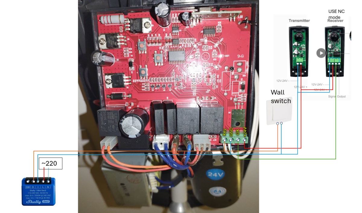

    #19 21809368
    silvaelio
    I'm sharing the wiring diagram for the motor boards:
    VEVOR ZTGD1000 ZTGD800
    SROMMA 600
    RT800 RT1000.
    I did a lot of research and couldn't find a complete diagram, so I did some testing at home with what I had and arrived at this wiring diagram which is working. It has options for a wall switch, options to add a Shelly to open the gate by phone, and I also added the complete diagram for connecting photocells.
    Control board with connections for power, wall switch, and photo sensors
    Garage door opener with a rail section visible in the lower right corner
  • #20 21810104
    robertke
    Posts: 13
    Super to pokazałeśc.
    Ja zrobiłem dokladnie tak samo , poza fotokomurkami, ale chyba odrazu dorobie sobie kabel to bedzie juz gotowe by kiedys podłaczyc.

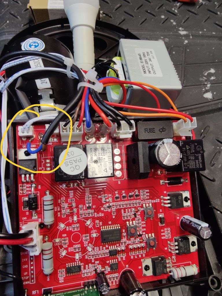

  • Tuya switch wired via photocell and stop terminals
    #21 21821780
    robertke
    Posts: 13
    I have to disagree with Silvaelio - with me such a connection does not work.
    I solved it in the following way
    Wiring connections between photocells and gate actuator control board
    1. Connect the 24V voltage (+ and -) to one and the other photocell - in the actuator preferably to the battery input.
    2. Let's connect the photocell control cables to GND (it doesn't matter where we plug into GND - it's easiest in the RED approach).
    We need to connect the other control cable to STOP and this is where we need to solder in.

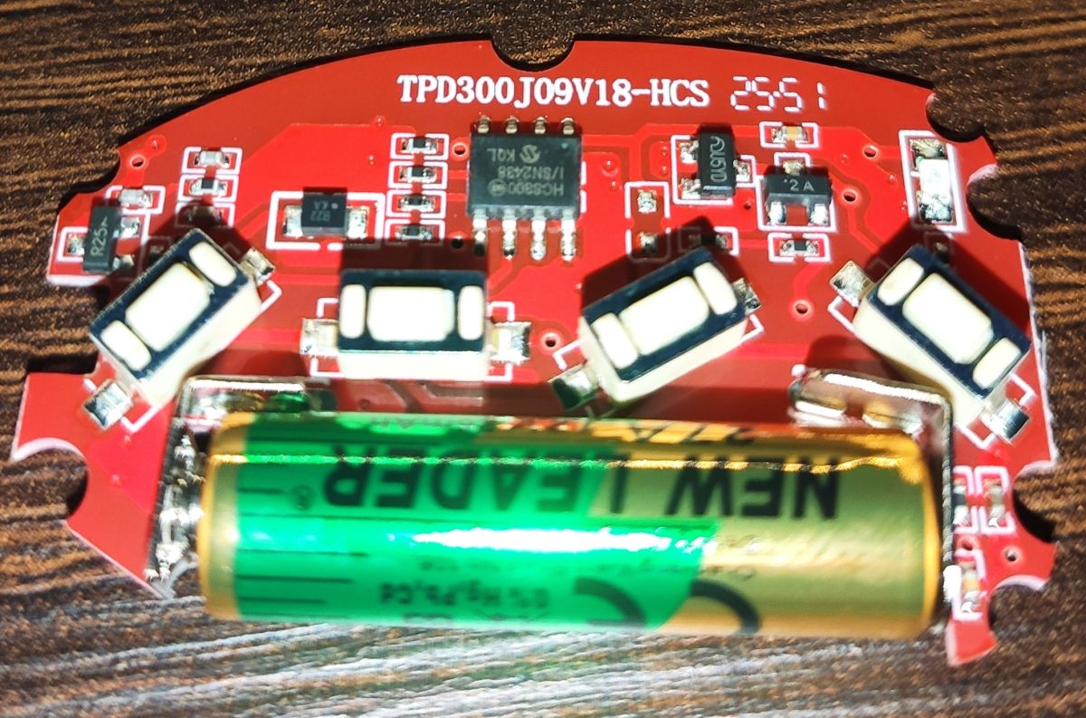

  • Seeking compatible 433 MHz remote for VEVOR opener
    #22 21909997
    romekb343
    Hi, I'll link to the topic. Has anyone worked through the issue of adding additional remotes to the drive? I've tried probably 10 different ones on 433 and 433.92 MHz and none of them want to work. I am adding a remote according to the instructions: https://www.youtube.com/shorts/tK37GeADqZI
    I am adding a picture of what the inside of the original remote looks like.
    If anyone has managed to find a matching remote, I would appreciate a link to purchase one.

  • #23 21910132
    robertke
    Posts: 13
    It's unlikely you'll add an extra remote (or the cost of a new remote will be little less than the whole gate operator). Buy an extra module to which you can add as many remotes as you like, and still have Wi-Fi: https://youtu.be/JkFK8qNj8lo
